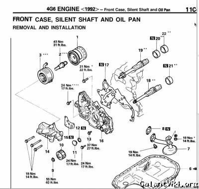

I was looking for the Oil filter housing TQ spec in the OEM manual I can not seem to find it. Anyone know it or have a copy of it in the manual?

^ yea thats what I was looking for where did you find those numbers?

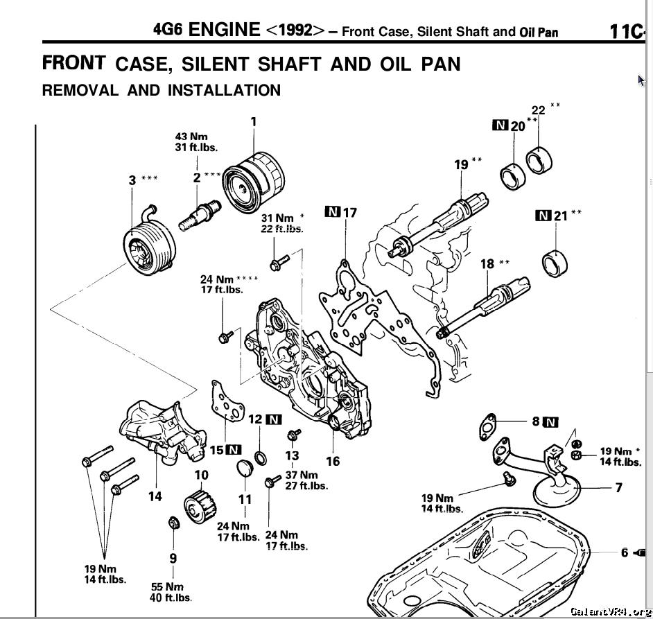

I found "oil filter bracket bolt" listed at 14 ft/lbs in mine, could be a transration issue tho.
I have the FP DSM CD that has all the service manuals. I think FP still sells it for $15.

I have that and the OEM manuals and still didn't see it /ubbthreads/images/graemlins/banghead.gif
What page number is it if you don't mind me asking?

Thanks I am not sure how I missed it but I did /ubbthreads/images/graemlins/tongue.gif
