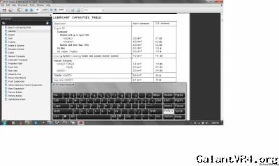

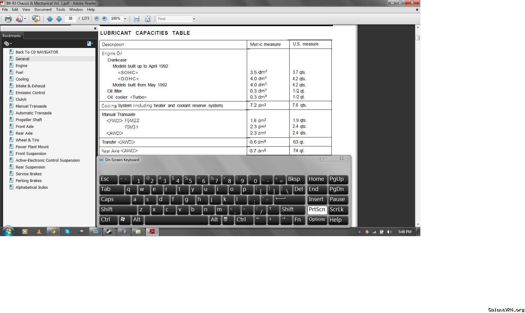

As long as the oil pump is packed with grease properly, it doesn't take many cranks with the starter with the MPI fuse removed to get the oil pressure light to turn off. At that point, yer good to go. And engine assembly lube will provide added protection if it's a new motor. For a car that has been sitting, there should still be oil in there. But for good measure just do what I do.
As far as oil changes go, I don't even fill the oil filter. I screw that bish on empty. Otherwise it makes a mess since it screws on sideways.
