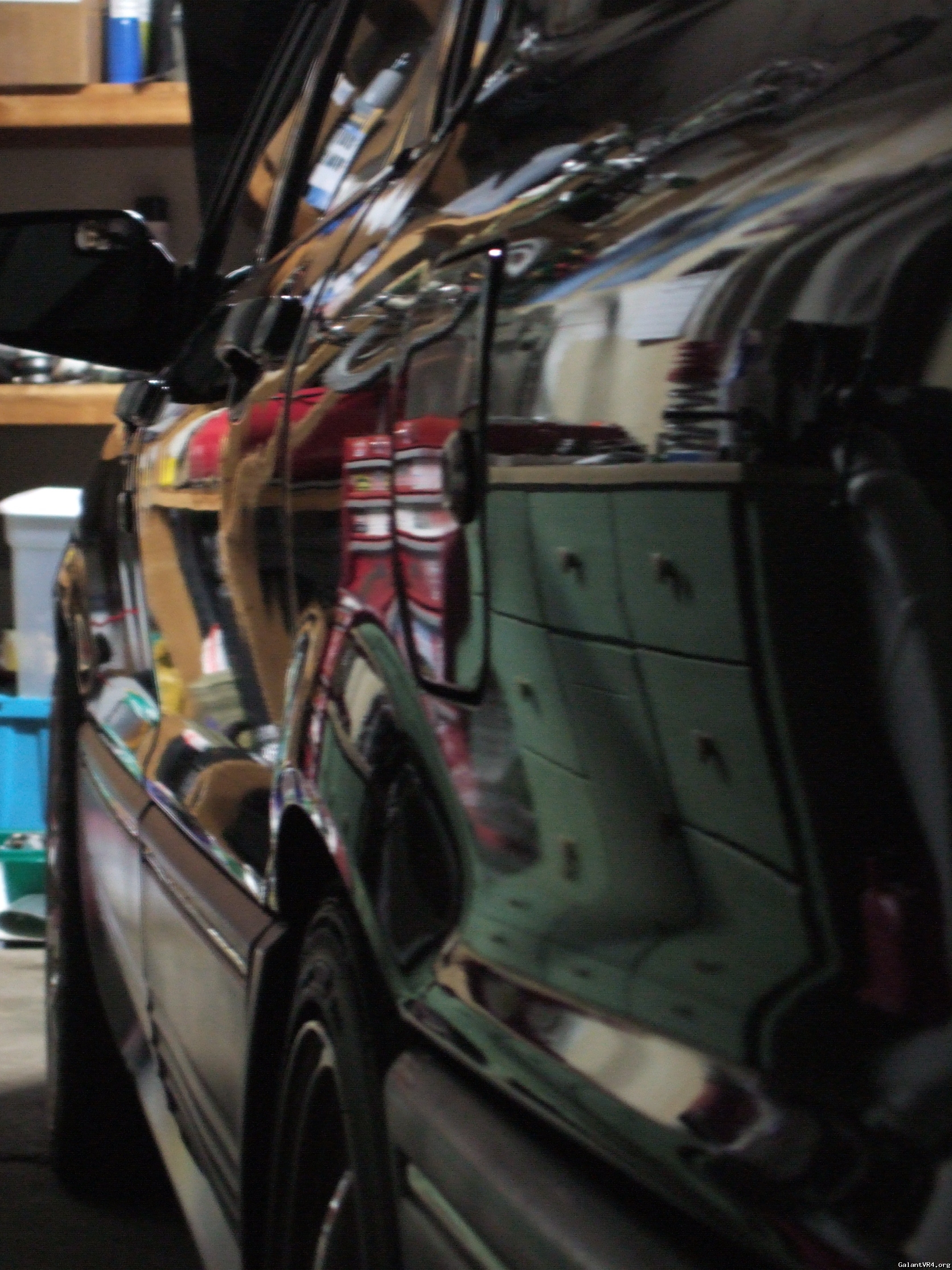

they're definitely 8" wide, and they're definitely not +38 or +35 since I have stock front suspension and they don't stick out at all /ubbthreads/images/graemlins/dunno.gif
I could be misremembering the exact offset but given that they hang out the fenders without 2* of camber /ubbthreads/images/graemlins/wink.gif
Why don't you just look at the wheel instead of guessing based on the possibility of tweaked suspension or fender or whatever. If its a 4x114 and 8" wide then its a +35. No doubt about it unless someone was into the wheel enough to have something custom made.....but IIRC those wheels came from DFR's car? If so, yes they are a 35, not really sure why you'd think they are a 42 /ubbthreads/images/graemlins/dunno.gif
11,993
Werd. If those are DFR's wheels, then they're a +35, Sluggs. Maybe you don't notice them sticking out in the front as bad because your car doesn't sit as low? You also posted a pic of one of your back wheels, which doesn't suffer from the same problem as the front does when it comes to getting wider combos to tuck.
slugsgomoo
Oct 16, 2003
3,781
Tacoma, WA
odd, I'd have to look, but then i'd have to go out and unbury the car /ubbthreads/images/graemlins/uhh.gif
he told me they were something higher, which made since with them not sticking out- especially since the +38 evo wheels seem to stick out a ton on 1g's and gvr4's with the 5 lug swap /ubbthreads/images/graemlins/dunno.gif
maybe i'm just going crazy, and really, I haven't exactly had the car out in quite some time. /ubbthreads/images/graemlins/wink.gif I'd post front wheel gap but I don't have any with weight in the front of the car, so I can't. /ubbthreads/images/graemlins/rofl.gif

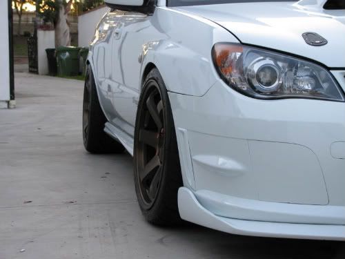

I just like wheels that fit, rather than sitting all sunken in like stock wheels do.

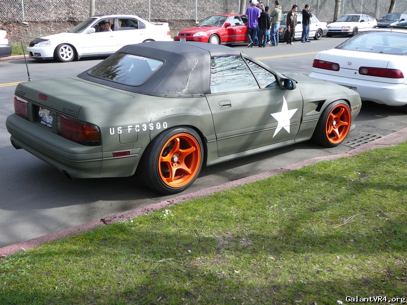

this is what i'm talking about.
11,993
Sweet, that's a Subaru. /ubbthreads/images/graemlins/goyou.gif Not exactly the same dimensions as the cars we're working with as far as clearances. Parts and body panels are also easily available for cars like Imprezas and Evos to fit wider wheels/tires. Our cars are a bit more difficult and I don't think we'll be seeing too many people going in and bulging out their fenders or welding on additional panels to fit wider stuff.

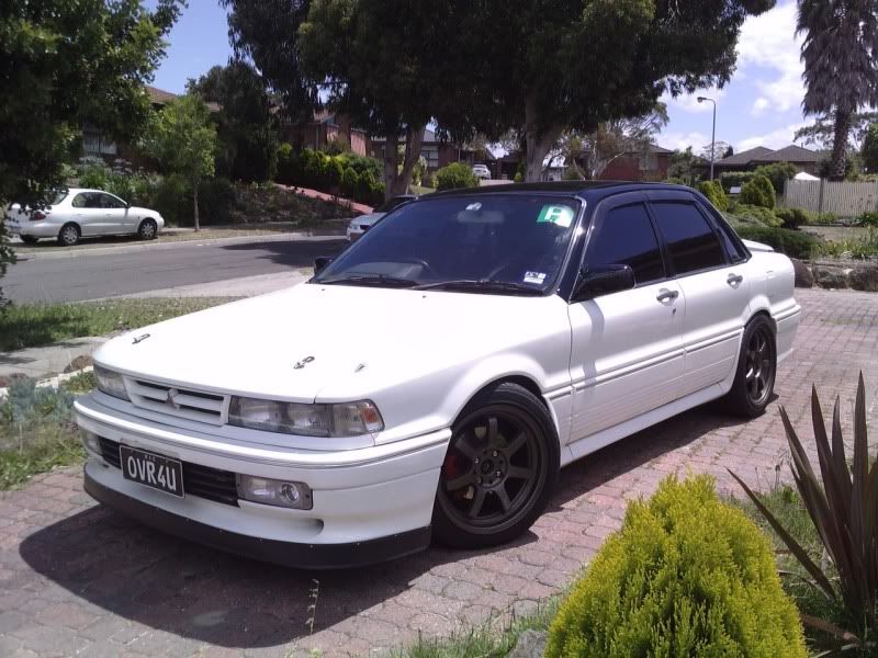

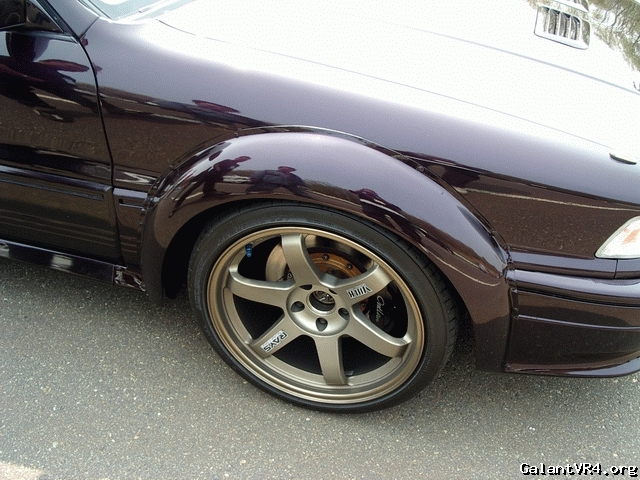

Quoting mean_green:
^ Ya thats the same link I posted earlier that I've been refering to as well.
I want a really aggressive look with the offset though, close to the look drift cars achieve. I know some might not care for this but Im just figuring what might work and look good. I love the FN01R-C's with a really low offset and similar rim styles.
Maybe you need to consider this if you want that aggressive look like turbowop said
Quoting turbowop:
You won't be able to achieve the look you're going for without fender flares. The offset that makes the spokes angle like that is too shallow for our cars.

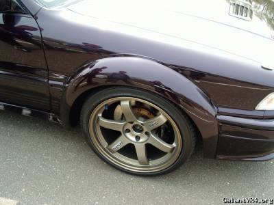

^ Nice, at least I get to see a few more pictures of that interesting Galant.
Im with H05TYL in rim choice and what I would like to accomplish, he hits it spot on. But the thing that comes into play is if Im going to be able to work something out to have low offset work. I dont really want to change the look of the body with flares and that seems like alotta work. But at the same time I REALLY want a car to be able to pull that look off and make it worth while, which my Galant is that type of car to me.Hmm

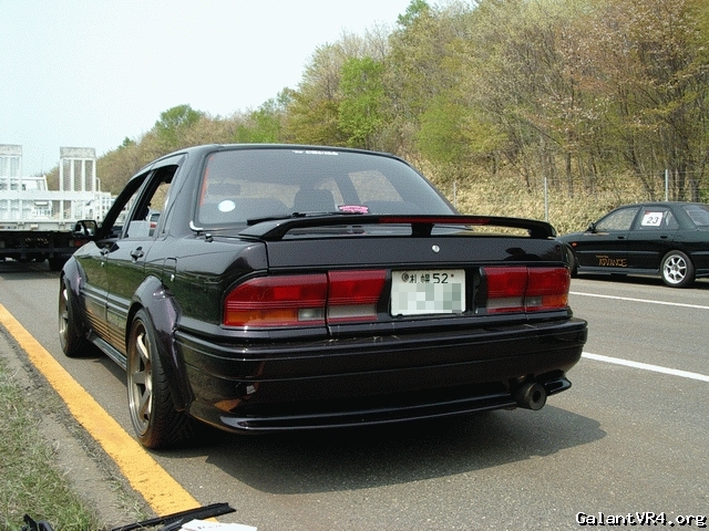

You can 'pull' stock sheet metal a long way ~2" is possible on most cars, just work slowly, bit by bit, a heat gun will help minimize damage to the paint (though, if you pull that much there's going to be some).
I'd suggest getting a spare front quarter panel, fitting it to the car and having a go on that before starting on the good ones.

it's not much harder - same principal, but you just keep going - you could stretch all four an inch or so in a day quite easily (rears get tricky after that because of the door).
Haven't had a chance to do my vr4 yet, but i've done a few other cars.
9" with +30 offset will fit in the rear with no mods at all, so rolling the lip up to match the curve of the guard would clear a 9" +15 which will give the look he's after.
The front will require more work, depending how much camber he wishes to run.
