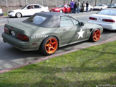

mitsuturbo
Jun 2, 2008
3,551
Near Seattle, Washington
Your link directs me to 404
Not Found
The requested object does not exist on this server. The link you followed is either outdated, inaccurate, or the server has been instructed not to let you have it. Please inform the site administrator of the referring page.�Ž
and i'm pretty sure that's a seattle car. i believe i've seen it around. /ubbthreads/images/graemlins/cool.gif
