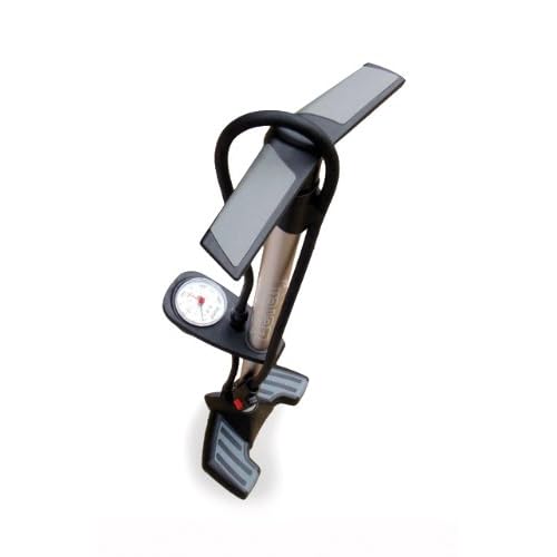

Ok its back! I am going to try and find a boost leak later, no air compressor but I will do my best.
citymunky
Sep 22, 2010
1,761
Chesapeake, VA
use a bike air pump
