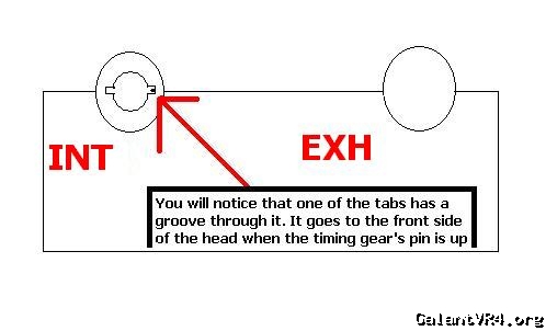

OK, bought a brand new temp sensor...the 2-prong one on the underside of the thermostat housing... & installed it along with re-wiring the connector using a plug from the rear speakers. Still no start! /ubbthreads/images/graemlins/banghead.gif I also disconnected the fuel pump, sparayed starting fluid in each cylinder, got a couple coughs & sputters, but still no start. I took off the CAS & checked the alignment as per the diagram & it was fine. Someone mentioned the FPR, I'm not sure how to check that. My lines, rail & FPR are completely stock & have never been changed. There is no question I am getting fuel...every time I take a plug out it is soaked with fuel. So the question is, is it too much fuel, or a spark issue? I think my next step is to replace the ECU just to make sure. I pulled it out & visually inspected it, no signs of leakage or smell. As I posted earlier, it's a rebuilt E-prom. But when my original ECU failed a couple years ago the symptoms were exactly the same as they are now. I just need to find someone hopefully close by with a good ECU I can swap in. Otherwise I'm not sure what else to do..... /ubbthreads/images/graemlins/confused.gif
