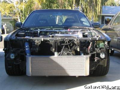

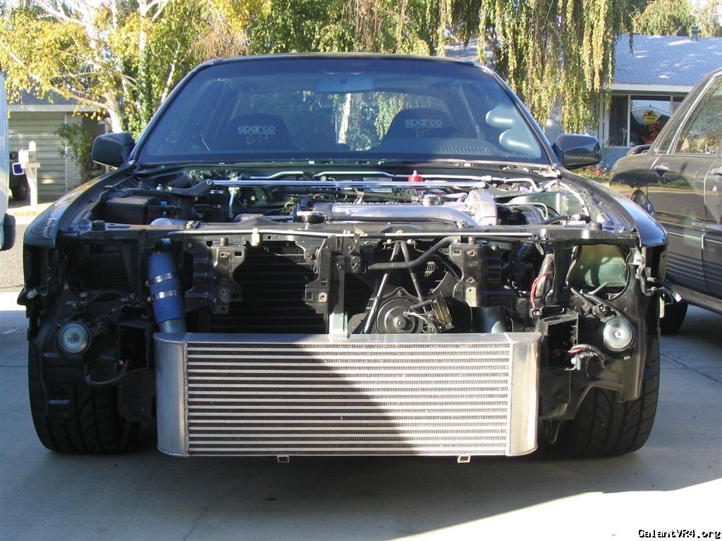

I was finally going to pull the plug and pick up an ETS kit this Christmas as they traditionally have a Black Friday or X'mas sale but I would definitely be interested to see what you have planned. I would be interested in the tried and true Spearco 216 core or whatever it is called. If I had my way, I'd copy Turbowop's kit pictured below:
That's definitely a doable setup, those cores are quite expensive, but do flow very well. Im suprised that size intercooler fits so well, ill look into that design a bit more.
