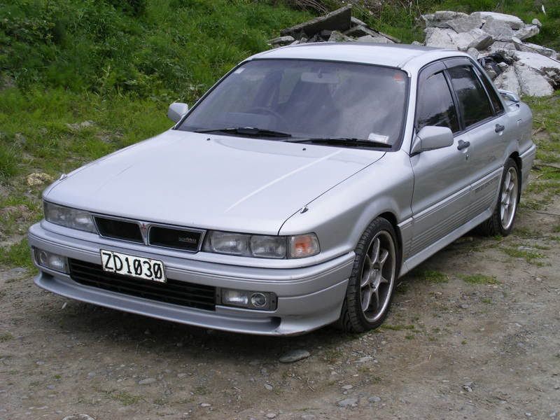

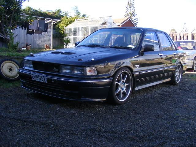

I'm running 17x7's with a +32 offset and some 5mm spacers I had lying around (so effectively +27 offset) and they STILL aren't quite flush with the guards at the rear (car is lowered 30mm or so).

This is the best pic I have on this computer, the wheels your looking at will sit about an inch further in than these.
and here's a pic on my other one, which is much lower

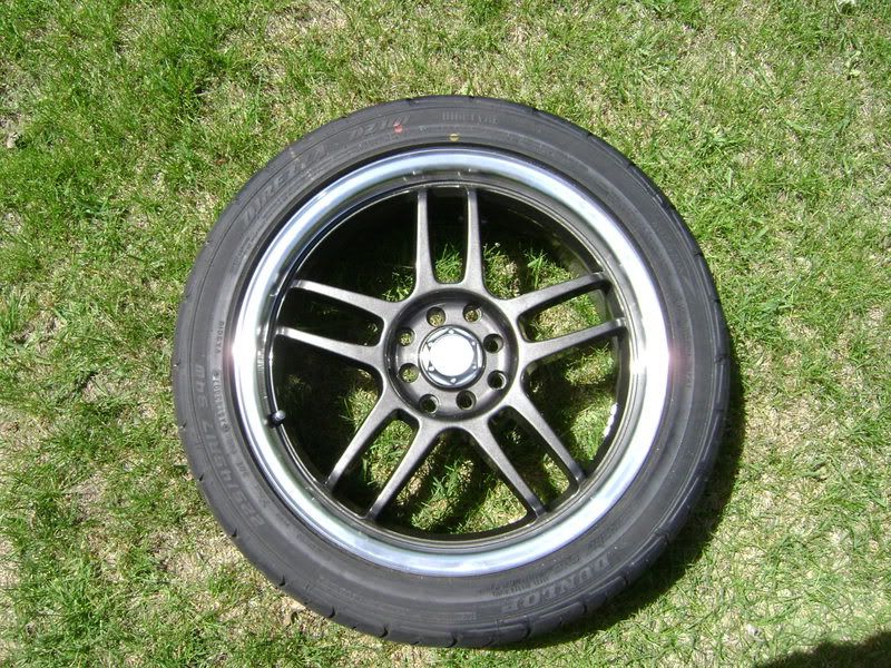

that's exactly the rim offset I had on the galant for a day. I shoud have taken pictures! /ubbthreads/images/graemlins/banghead.gif oh well. The fit perfectly on stock suspension and will not rub. i also ran 225/45/17 Dunlop Direzza DZ101 tires also. The rims will stick out a bit though....If i remember correctly, it's almost about half an inch.

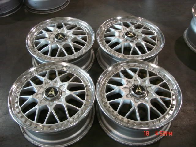

these are the wheels i was referring to... just wish it had a better offset.
old school Work Mesh wheels...

are they 2 or 3 piece? if they are 3 piece you can replace just the outer part of the rim quite cheaply with an extra inch and a half of lip giving you an 8.5 +28 wheel.
depending how much width you add at the lip you could end up with:
8" +34
9" +21
10" +9
firstly though, check there is enough room for the 148mm backspace these rims have (from the hub face in towards the strut in the front, and the trailing arm in the rear).

Sorry, I was referring to your specs. Those rims are pretty cool looking though.
here were the rims I had before selling them. they were +47 offset. stuck out just a bit on me.
