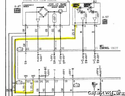

No injector pulse, no power on pin 102
alik
Aug 8, 2006
357
Boston, MA
the car starts, but won't run.
I've put a test light on PCM connectors, and I've got no power on 102 & 107, and no ground on 106.
Could someone confirm that the MPI relay is the culprit?
Thanks!!!
thomcasey
Sep 24, 2014
907
Indianapolis, IN

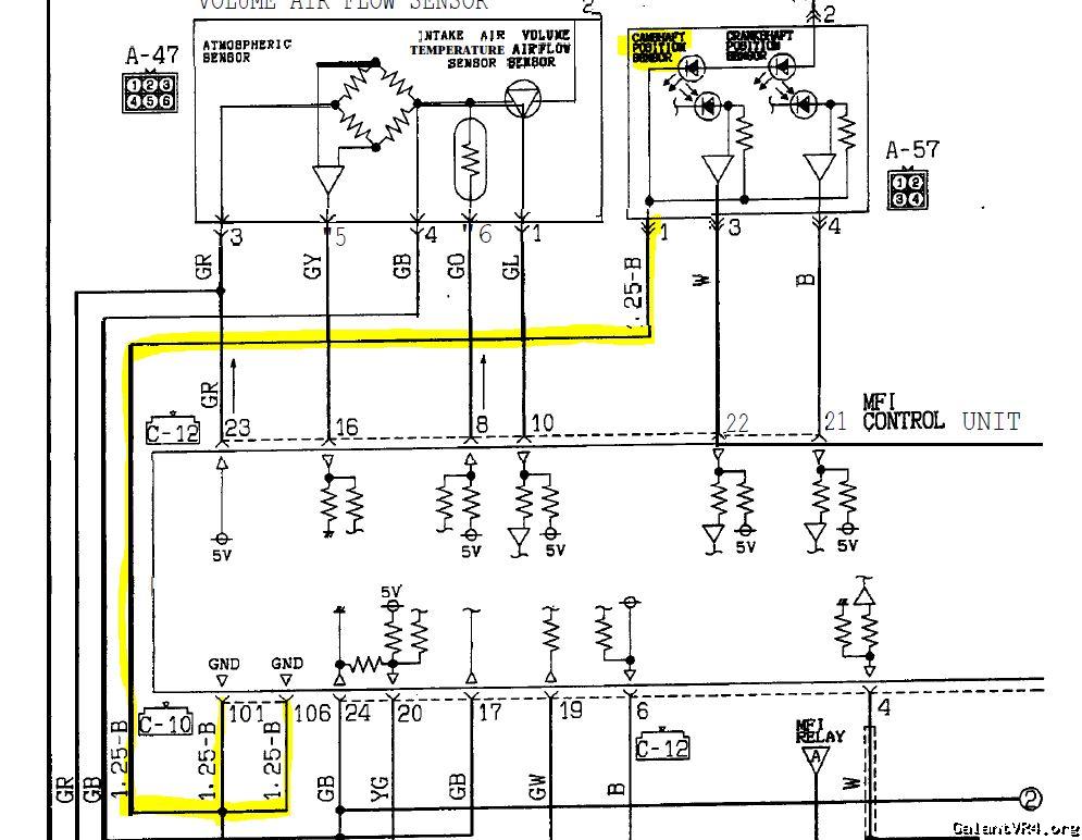

106 is Chassis ground. Have you tried correcting that problem to see is the symptoms change? Pin 106 feeds the Camshaft Position Sensor ground. Also check Pin 101 as it is also ties to pin 106.
