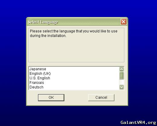

Choose "English UK", click OK

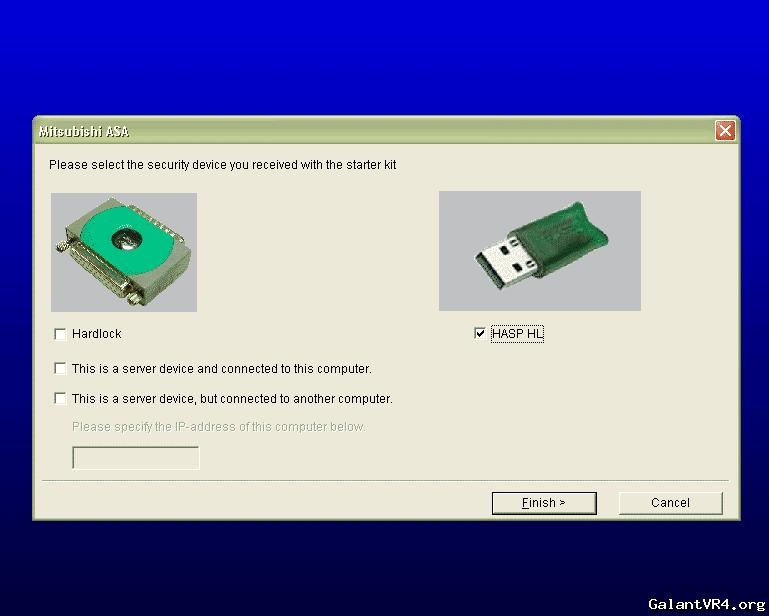

Check the "HASP HL" box, make sure nothing else is checked.
Click FINISH

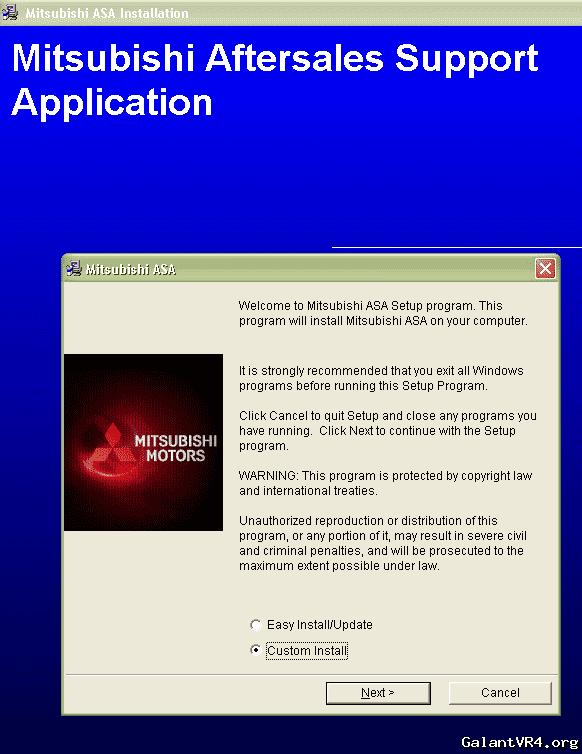

Choose "Custom Install"

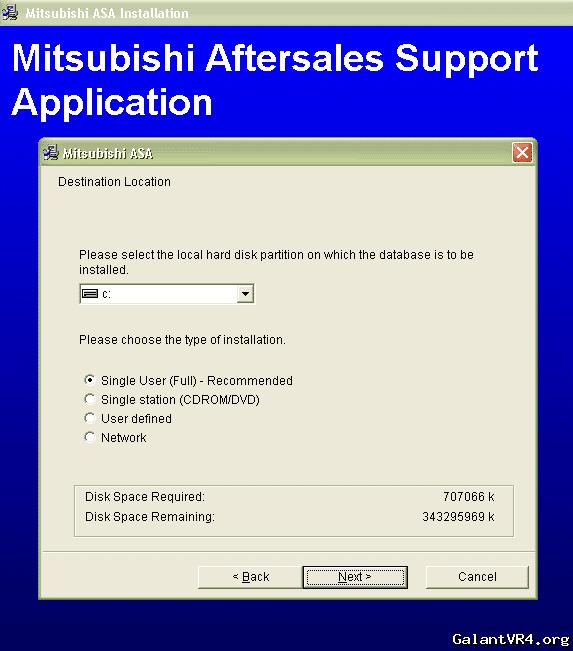

Next screen:
Choose your hard drive to install to, then check "Single User (Full) - Recommended"
Click NEXT
The program will install.

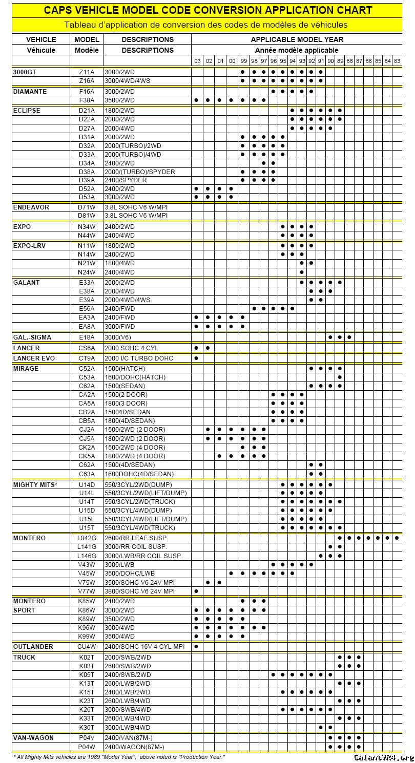

For anyone looking up vehicles using chassis codes versus direct input of the VIN, here is a handy visual guide.
This appears only to have models from a particular region, possibly just North America, as I do not see C58 Mirages from Germany, C70 Mirage/Colts from AUS/NZ, etc, etc. I'm sure people from Europe and the JDM belt will notice this too.
Regardless of this fact, I have never seen this compiled so nicely before.
