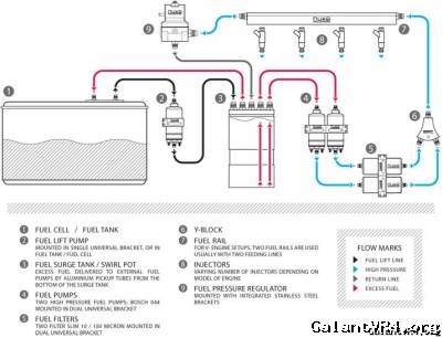

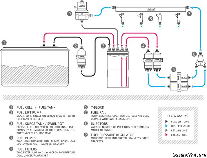

FCR, how did you plumb the return back to the surge tank? I see a hose/port for it on the surge tank, but only see the feed line routed in your undercarriage pics.
FCR
May 17, 2008
121
Orlando, FL
Right now I have a 6an line from the fuel rail for the return line and that feeds the surge tank too and then the over flow goes back to the main tank so basically whatever is not use in the motor from the 044's feeds the surge tank too plus the walbro

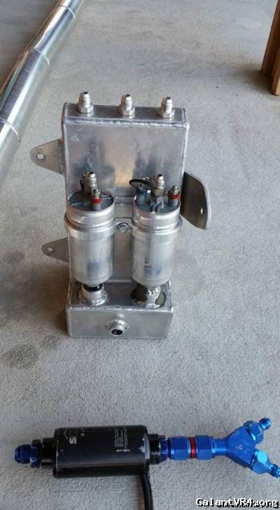

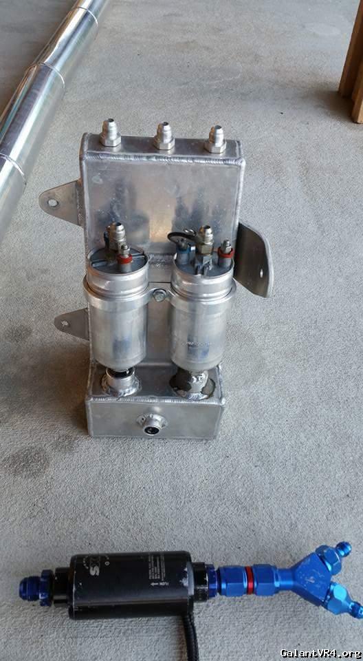

Basically this is the set up that I have in the car rigth now and another view of the surge tank... from left to rigth I have the feeding line from the walbro in the middle the overflow going back to the main tank and the 1 in the rigth is the return line from the fuel rail so as you can see you have the 255 and the return line feeding the surge tank all the time ..
3,478
Awesome, thanks for that. What's the port on the surge tank just below the pumps?
