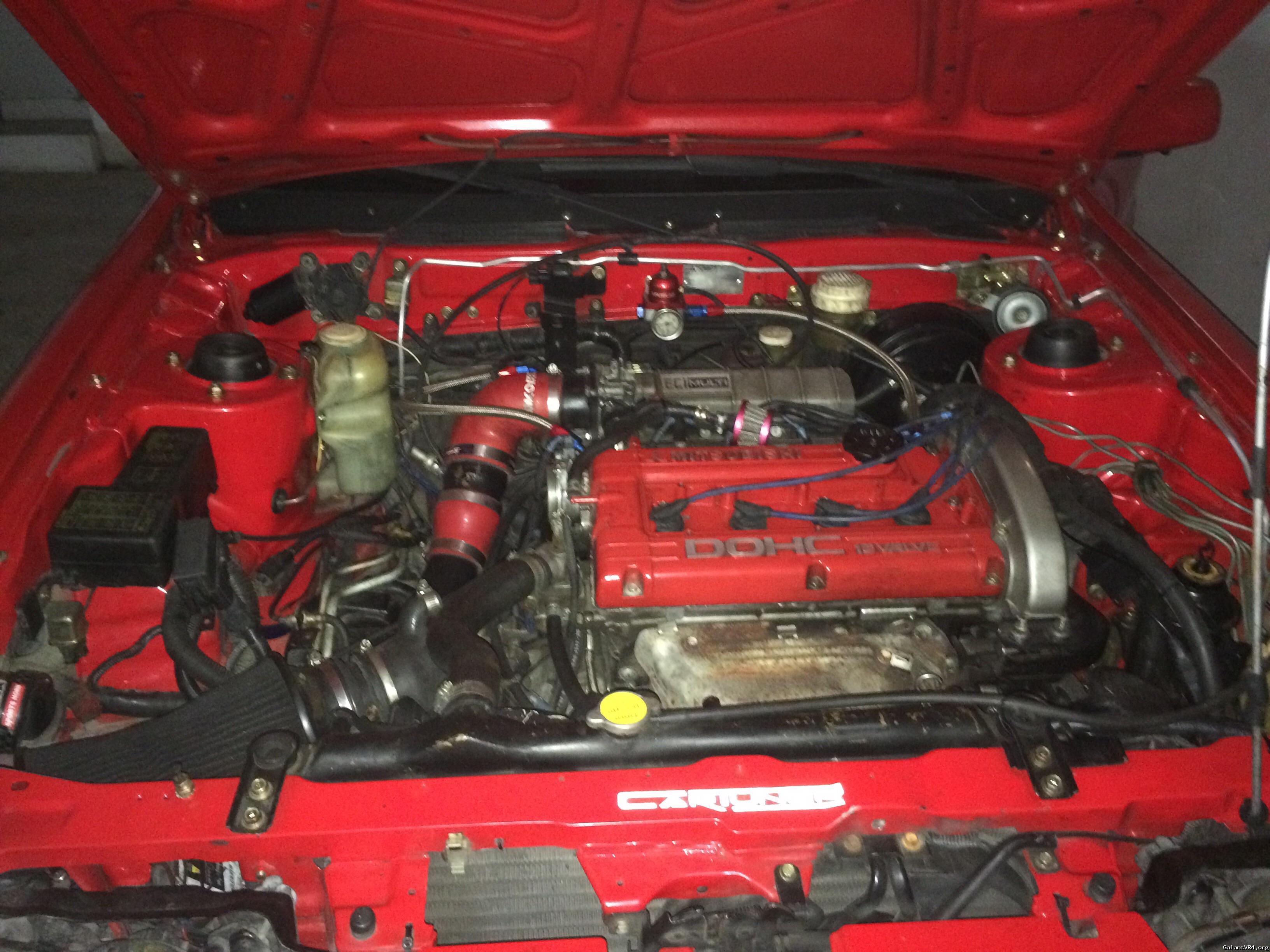

Hello everyone so ended up buying the red originally green galant vr4 I asked you guys about. It was three weeks ago, I live in Colombia, so I bought the car 3 weeks ago in bogota which is almost 9000 ft high and everything checked ok for a 23 year old car, had it shipped to my hometown Cartagena by truck which is at sea level. So when getting her off the truck the battery died and it smelled like gas. Ok new battery but no spark, just flooded. So I called the seller they said I saw get put on the truck they don't now. The car has haltech platinum 1000 so called the guy that installed it and says altitude shouldn't affect it. I say ok, start towing and by half of mile going 30 it sputters back to life and start running but spitting raw fuel and get it to my house. Long story short there's only 3 haltech techs in the country so ended having to fly the guy to do a new fuel map and the car started running better. He count finish the tune because the car is bogging at 5500 rpm and he says the software isn't showing anything unusual. There were some other important thing to look like small oil leek,alternator wasn't charging properly after some research figured out it must have been the steering pump leaking on it too, a coolant leak on turbo hoses, the Ac is not working(that's a must were Iive). So that's we're I'm at.

Beside the color which I wish was green, it's pretty straight. By now I'm waiting on some new plug wires and looking fir a good reference for an alternator, read some stuff online but not sure which one. I'm thinking remanufactured couse those look the best online

Car specs that i now. It has a haltech platinum, graveyard block (not sure which,) but a 2.3, the turbo is g20 not really goodie, I think that's the origina head, 3 inch exhaust , bad his bov but kinda works and I'll be learning mor about the car in coming days. But picking a good alternator is my priority right now does this car really need more than the 90a version, or more is better?

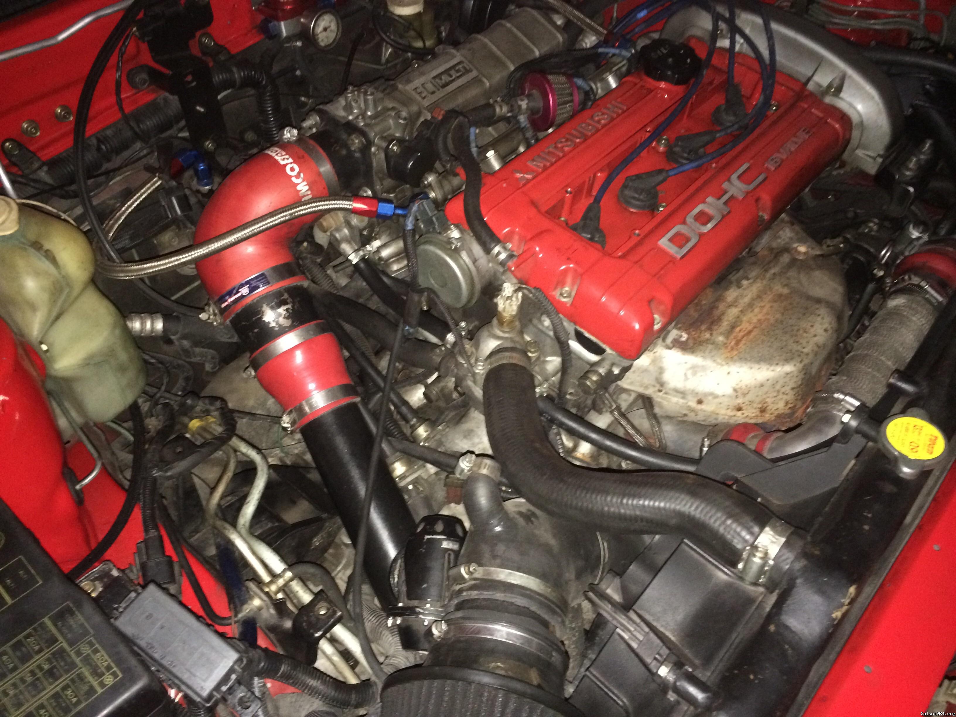

Cheapo voltage regulator is generally the weak link in most reman'd alternators. The proximity to the turbine outlet and downpipe gives it a tough life. Denso would be near the top of my list if I wasn't able to score a Genuine Mitsu part.

Wrap your downpipe with heat tape. Since the Mistu alternator pulls air from cooling from the rear, it will give the alternator much better chance of life if you keep the air it take in kinda cool. I have been running cheap parts store alternators for a couples years with no issues since wrapping the downpipe.

you need to make 2 shields, one to block the o2 housing and downpipe from putting heat on the alternator and one that goes under your power steering pump and covers the top of the alt. that way if it leaks it wont drip onto the alternator.
