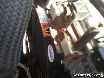

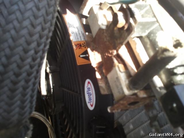

Ill try to post pictures soon of the engine bay and the various mangled wires it has. Me and my brother just replaced the radiator fan with a new one since the old one seemed to be all rusty and didnt even spin when we took it out! But the thing thats kinda ghetto rigged is that we didnt know if the temperature sensor for it still worked so we hooked it up to one of the unused foglight plugs! That way I can just turn it off and on as I please, but not without turning on the main headlights lol.

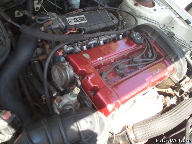

Just remembered, Im sure there isnt suppose to be a hole in the valve cover is there? Its a very small hole on the left side that is blowing out air lol.
There should be a line attached from the side of the VC to the Intake.
You can see in one of my old engine bay pics that line is flipped in the air, not really suppose to be flipped up like that but you can tell where it go's to.

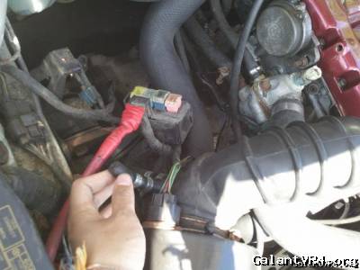

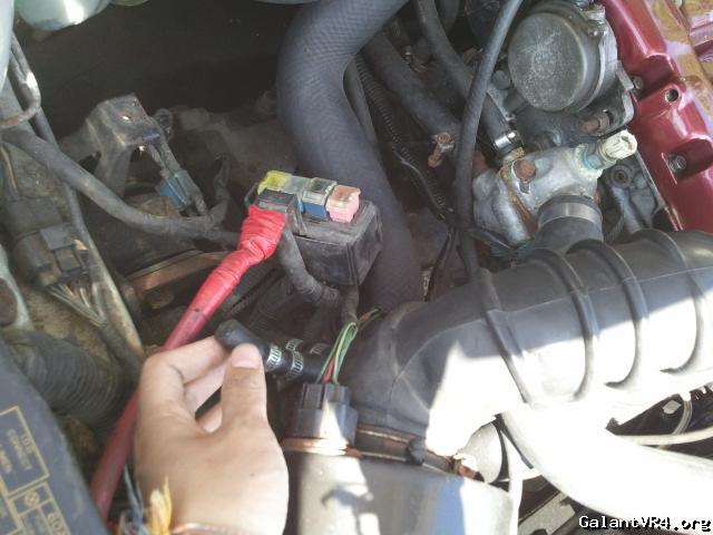

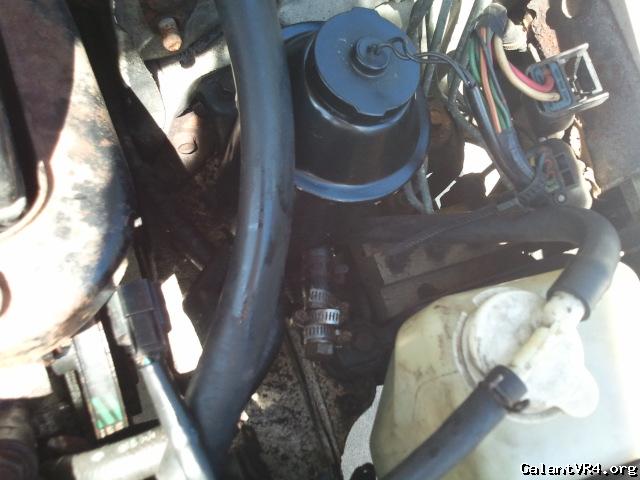

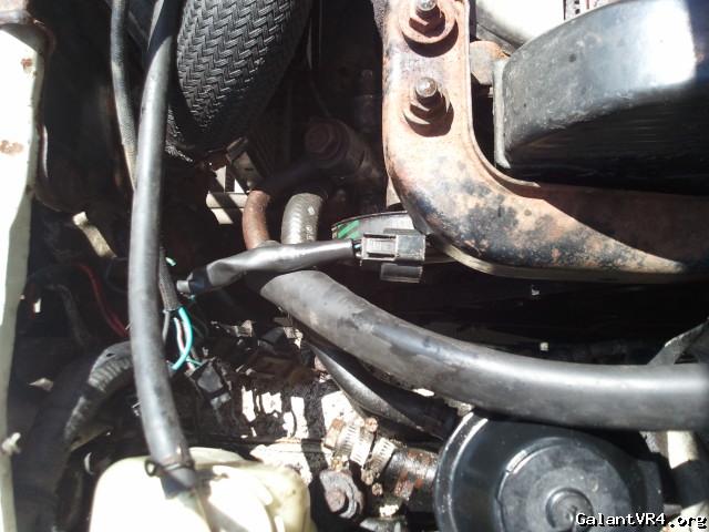

Random wires!
The hole on the valve cover goes to...
here??
Ghetto rigged plug with a bolt!

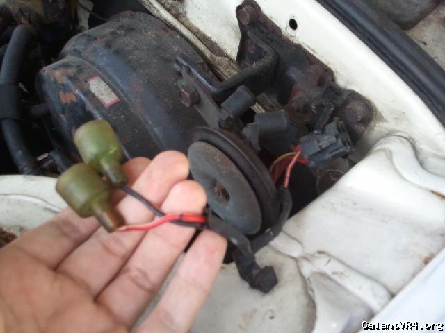

Unplugged horn. I tried plugging it in but theres no wires behind the steering wheel to plug it into the aftermarket wheel.

Also, what is this? My guess is its a temperature sensor for the radiator fan.. atleast thats what my friend told me who was a previous DSM owner. Im not sure if it still works or not and if I connected it properly to the new radiator fan.
Well i can help with the last three pics. First the intake that is plugged just remove the plug, and run a line from the intake to the VC, you will need the small metal tube the goes from the line to the VC, if you don't have one you can post up a WTB thread, I’m sure you can find one for a couple bucks, if i can find an extra ill pm you and send you one.
Second to last pic someone may have blocked off the AWS, and rather than using a T/E/L reservoir they just blocked off the stock one.
Last pic is your factory alarm horn. The horn for the steering wheel mounts on the front of the car behind the front bumper.
Hope it helps

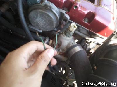

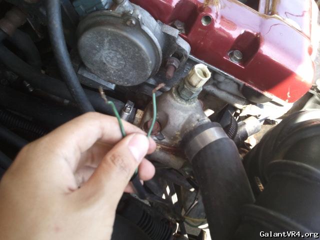

Are these wires suppose to be connected to the white plug? The car came with them just hanging and the white plug is the closest connection I could find. What would the other half of the white plug be called?

That's the a/c temp sensor or something to do with the a/c but mines not connected and from the diagrams I've seen it does not matter unleashed u have air conditioning
dlesser
Jun 26, 2011
61
Westminster, CO
For the thermostat housing wires:
Blue/Black, single wire sensor, A/C Condenser Fan, Normally open
Green/Red and Green/Black, 2 wire sensor, A/C Clutch lockout, Normally closed
Green/Black and Yellow/Green, 2 wire sensor, ECU Temperature sensor, variable ohm reading
Yellow/Green, single wire sensor, Cluster temp gauge, variable ohm reading.
Plug on the top is the two wire AC Clutch Lockout
Plug towards the firewall is the single wire A/C Condenser Fan plug
Plug towards the front of the car, that is two wires is your ECU Temperature sensor.
Plug towards the front of the car, that is 1 wire is your Cluster temp gauge.
Hope this helps. I found the wire color info on this forum and I looked through the service manual to determine which sensor went to which wire. I hooked mine up two days ago because I had it wrong and now my AC fan works correctly. I removed my radiator fan and went slim so I have a switch for that.
