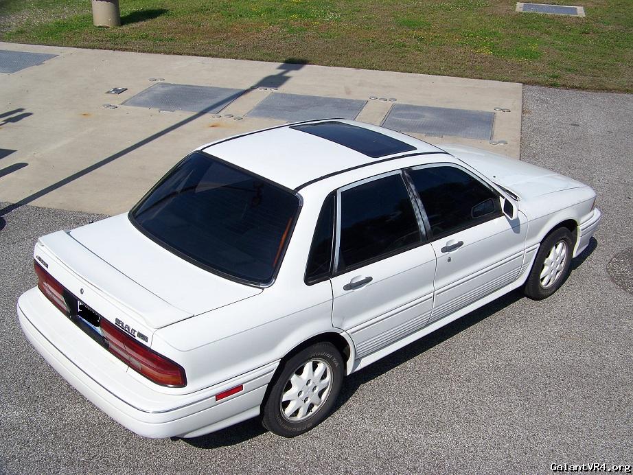

What's up GVR4'ers? My name is Andre and I bought #1899/2000 two months ago. Since this is my intro thread too, I guess I'll tell you guys a little about myself. I'm 24, been snowboarding for 13 years, grow over 200 orchids and plants, have a Norwegian Elkhound (3 yrs. old), and keep two aquariums (30 gal. mixed reef and 3 gallon freshwater). I keep myself pretty busy without a job. Recently graduated college and decided it was time to get a project car. Currently D/D a 96 Camry, but I needed something to enjoy driving again. This car is going to be my collector car too, so it won't see the harsh MN winters that it has faced in the past. I love Japanese cars, but I don't know much about how cars work. Luckily I have help and am always learning something new. This is my learner car.
Method grab
30 gal. mixed reef (Fish - Black Ocellaris Misbar Clownfish pair, Blue Mandarin Dragonet, Carpenter's Flasher Wrasse, Cherub Angelfish, Green Chromis, and two Yasha Hase gobies; Inverts - Skunk Cleaner Shrimp, Porcelain Crab, Sexy Shrimp, and asst. Snails and hermits)
Schoenorchis manipurensis - super tiny Vandaceous orchid from India.
Neofinetia falcata 'Benisuzume' ('Red Sparrow') - Vandaceous orchid from Japan/Korea. 'Benisuzume' is the cultivar name of the species. Smells like bubblegum and jasmine. Extremely fragrant.

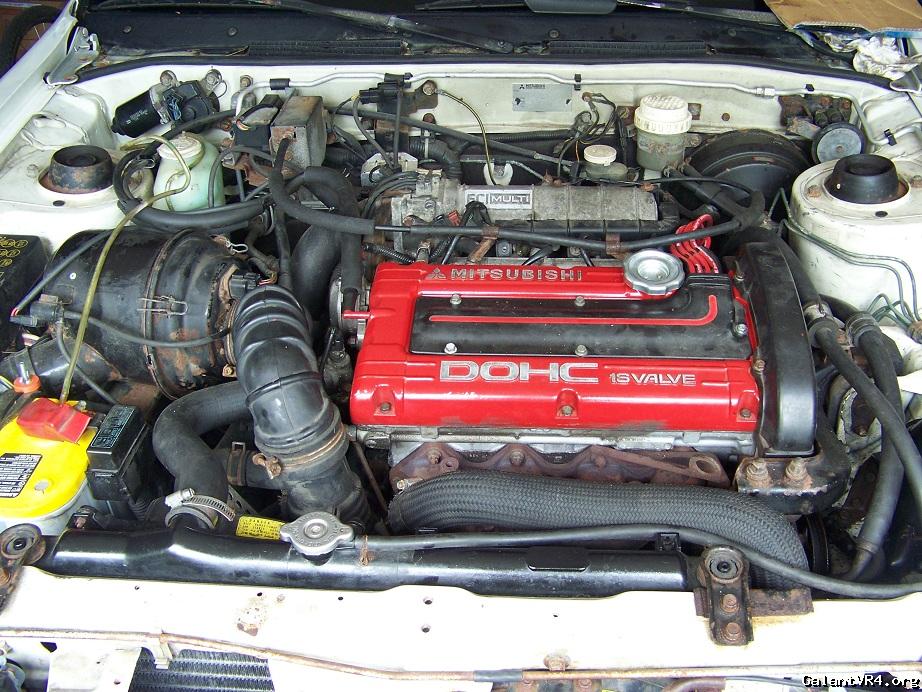

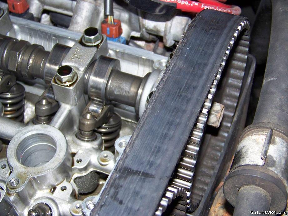

Alright, now some info on my whip. Currently has 189K on the odometer and the engine was rebuilt at about 186K. I Bought the car with the major obvious flaws being a "lifter tick" problem and power steering leaks. Timing belt was also abnormally worn considering it was fairly new. Inside was 8.5/10 and body is about 8/10. Good looking car for being in MN for all those years. Clear coat is fading, slight surface rust, few dings/scratches. Will need to be painted. Also came with ametallic blue pinstriping on top of the clear coat. Is this a factory add-on or aftermarket?
-1991 A71
-Rebuilt Engine (complete long block rebuilt, bottom end and cylinder head) (OEM)
-New timing belt (OEM)
-New water pump (OEM)
-New oil pump (OEM)
-New headgasket (OEM)
-New Clutch
-New sparkplugs and wires
-Every gasket has been replaced (OEM)
-New Optima Yellowtop
-New Alternator
-New tires

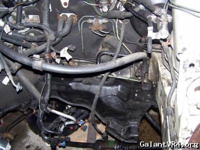

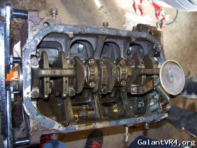

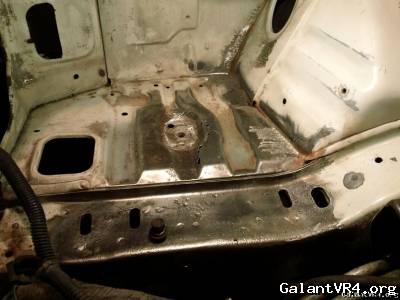

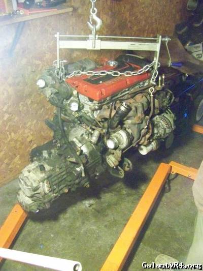

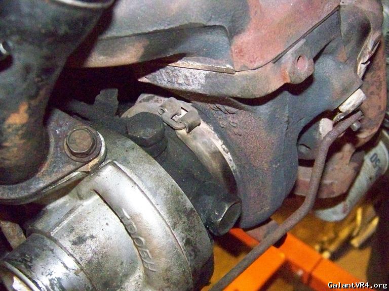

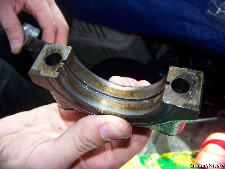

As soon as the car got back to my place, we put it on jack stands. Next day we worked on the lifters. I replaced with ITM revised lifters. Got them all in and put the cover back on. Started the car and there was still a knocking noise. Saw the saddest look on my friend's face because he knew what was up. It was either a spun rod bearing or bad wrist pins. I was then told I would have to rebuild the short block. This made me very angry at first, but now I'm optimistic about getting this going again. To makes things worse, I never got to drive the car. I've driven manual once in my brother's EP3, which is pretty forgiving. When I looked at the car, I had three friends with me, 2 of which are tuners. I rode shotgun the whole way back. The transmission shifts real clean and the clutch is solid, so I'm told.

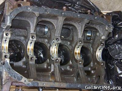

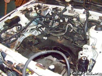

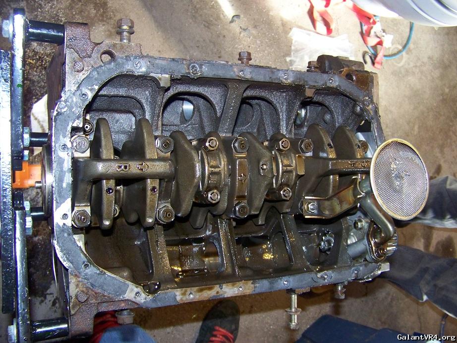

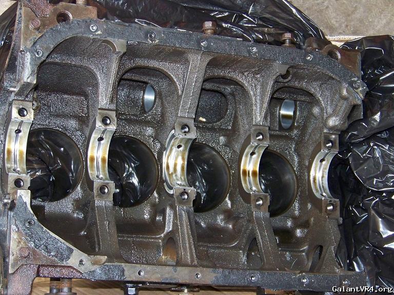

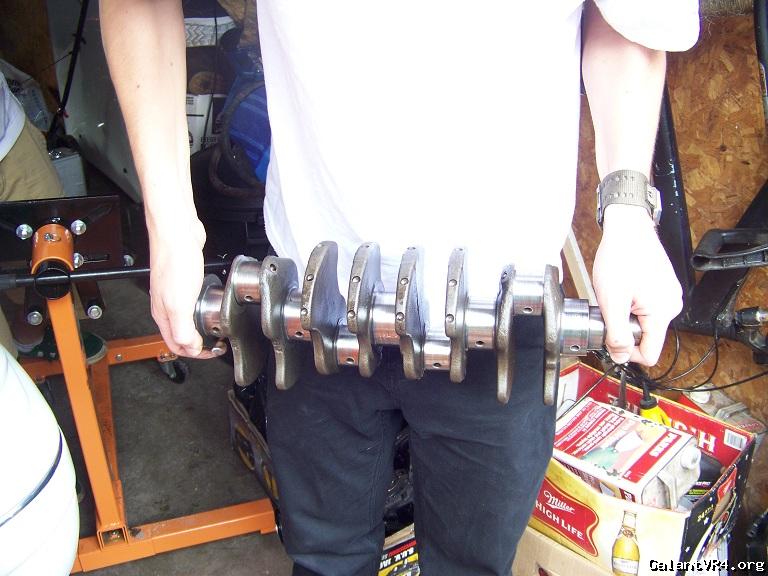

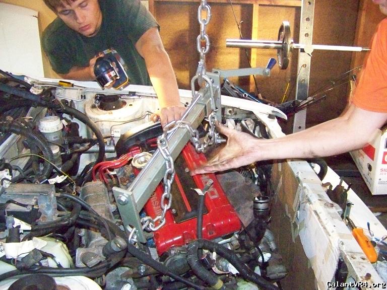

Over the past few weeks, I've had help getting the motor out. It's almost completely disassembled minus the crankshaft. Along the way, I found out that the 14b, which had been replaced already has shaft play and cracking. When we took the oil pan off, we noticed a lot of metal shavings. Friend said that is a spun rod bearing. Spun the crank and heard a popping sound from #1. The piston pops on the way up and back down.

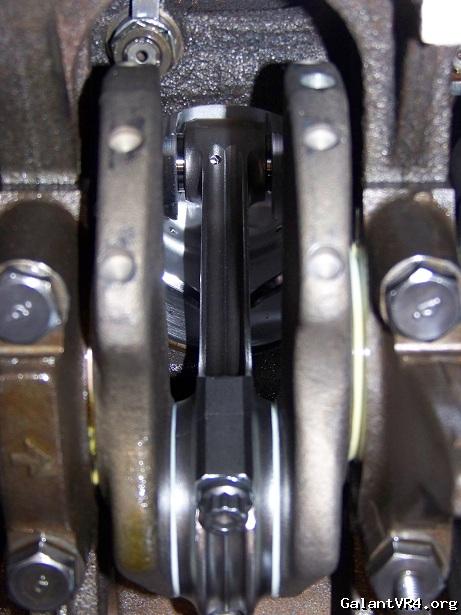

For the rebuild, I have decided on going with the Modern Auto 2.3L stroker (stage 1). Do you guys suggest using ARP main studs and align honing? Kiggly girdle? Not planning on running high boost, but insurance is nice. I'm going to eliminate my balance shafts with the AMS kit or machining instead of having them do a stub shaft. Will need a 4g64 crank too.
-Hot Tank/Boil Block
-Polished Crank
-Balanced Rotating Assembly
-ACL Race Series Main and Rod Bearings
-Overbore with Torque Plate
-Fully Decked Block Surface
-Wiseco (8.8:1 CR)
-Eagle Connecting Rods
The cams will need to be replaced too for this build and I'm going with FP3x's made by Comp Cams. Also going to replace the turbo with an EVOIII16g. Hopefully within a week or two, I can get the block sent in.
Any input and advice along the way greatly appreciated. I'm glad to be a part of this community. Hopefully by spring I can get the car working again.

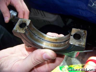

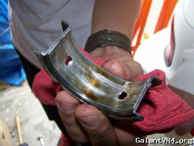

Nice VR4, welcome to the board, sorry to hear about your problems. You should get all arp hardware and the balance shaft eliminator is a nice safey mod so u don't ever have to worry about that belt tangling up in the timing belt.
11,982

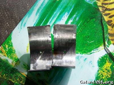

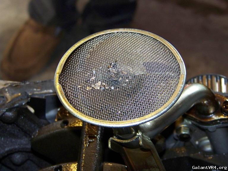

Looks to me like the balance shafts were already removed on that engine. You can tell because the front case cover and oil pump are still mounted but the shafts are missing.
Don't use a paper gasket for the oil pan when you re install, use only sealant such as mitsu "bond" sealant. The oil will eventually soak through the paper gasket causing a mess.
I redid mine with just sealant and no leaks thus far.

Awesome method grab! Welcome to the site! Besides the knock, it looks like you had the SAME groove in the timing belt like I just had to deal with. Stupid too long bolts in the oil pan....

GSX_TC - I decided not to go with ARP mains and align honing. Going to go with MAP's stub shaft kit. I think the stub shaft I have is the OEM one.

Alright, so my block is at MAP. Going with the Wiseco 9.0:1 CR, 85.5mm, and .020 overbore. Like I mentioned to Mike, not going with ARP mains and align honing. They are supplying the 4g64 crank for me, but I'm trying to buy a 4GCS block and crank for $300. I'll save $150 off the core-charge and have a spare block. Added a new front case and oil pump too. Total price with labor is $2800. Since I paid with a cash deposit, they took off $152. Core charge is $450 and that's why I want to supply and old crank. Manager said they can rebuild my 14b later on into an EVOIII16g for about $350, so it seems like a good option. Also said I should upgrade the oil pan because it will be too hard to get all the shavings out and for performance. Mentioned oil cooler too. Will have to explore that a bit. Right now the shop is backed up and the turn-around time is 4-6 weeks. Time to clean the engine bay.

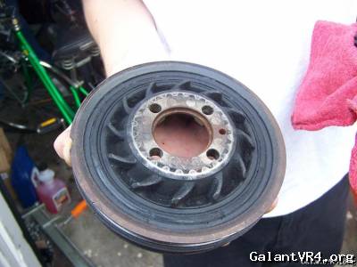

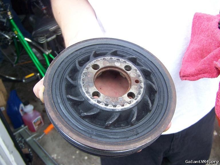

Need to replace harmonic balancer. Friend's roommate has one laying around in good condition that I'm trying to get at.

Was there no shop in your area that could do the work for you? It just sounds like a very retail price point to me but if you're rolling in it then by all means, go with what you want.
The MAP balance shaft stub is an OEM one. You'd be replacing a part with the same part. It's not a lot of scratch in the grand scheme of things but still
You don't appear to be an idiot which is nice. What type of normal duty and performance requirement are you looking to get out of the car?

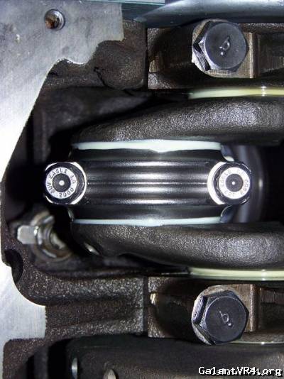

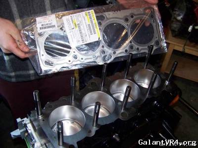

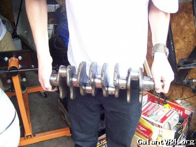

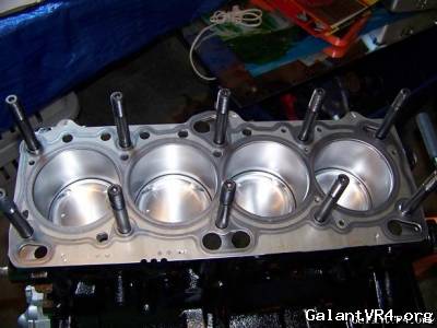

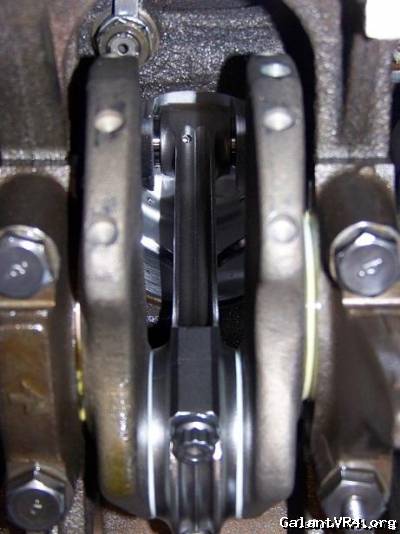

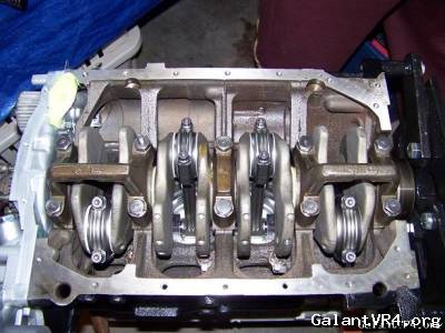

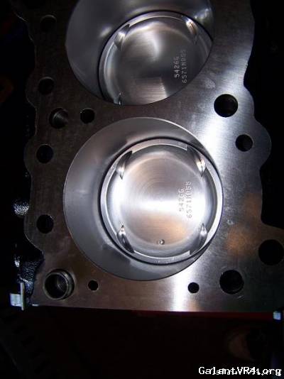

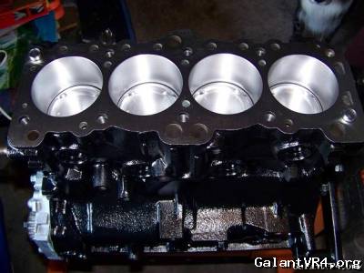

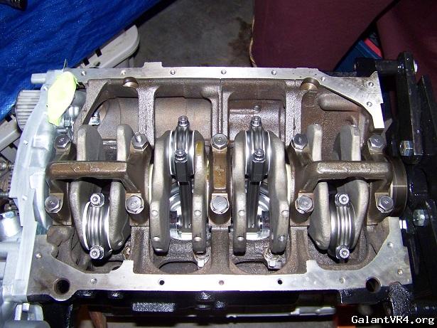

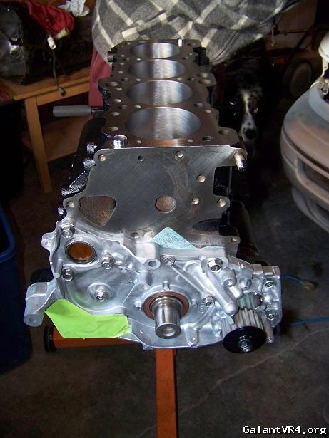

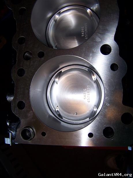

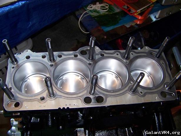

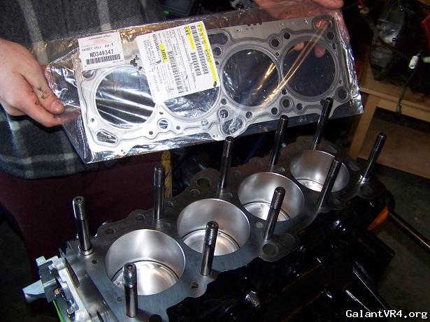

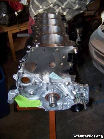

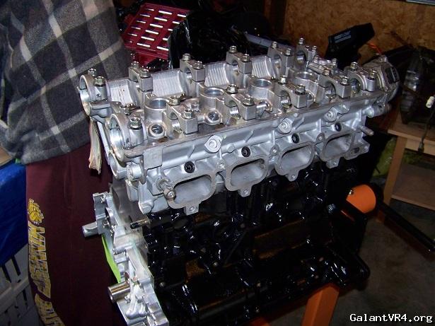

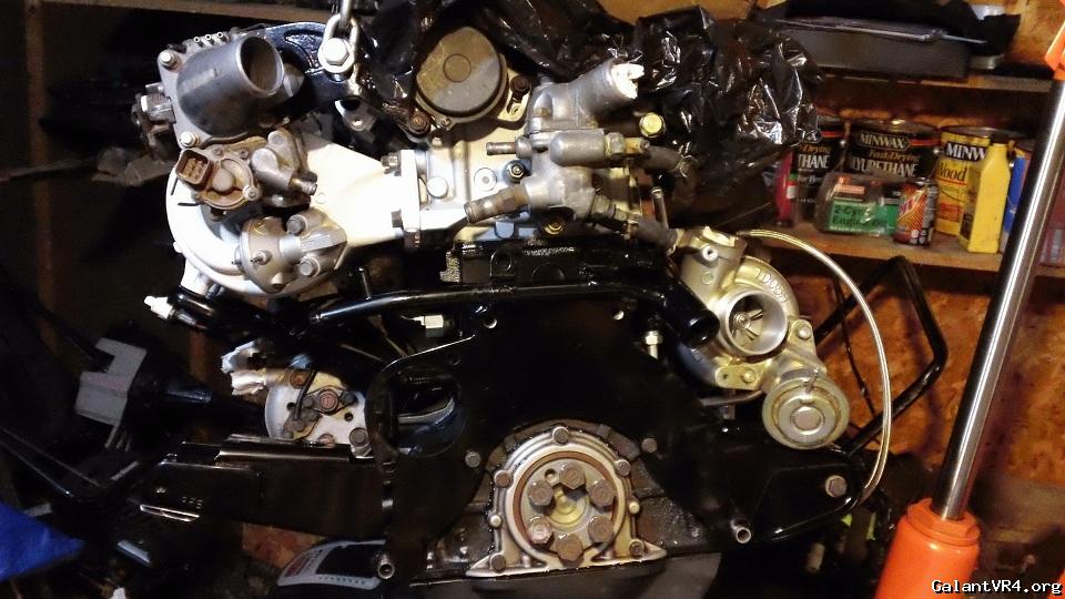

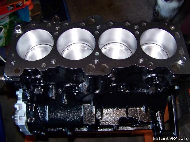

Been a while, but a little has happened. Got the block back from MAP over Thanksgiving weekend. I did decide to go with the 2.3 stroker rebuild. Took the head to the local machine shop to get flushed, cleaned, decked, and checked. Stock cams were considered unusable, so I still need to get cams designed for the stroker. Other than that, head is all good. Talked to Comp and they said they can make the FP3's for me.
Block: 2.3 stoker (Stage 1)
Wiseco Forged Pistons - 8.8:1/85.5mm + .020 overbore
Eagle 150mm H-Beam Rods
ACL Rod Bearings
ACL Main Bearings
2.4 crank
New front case, oil pump installed, and BSE kit
OEM Main Studs
ARP Rod Bolts
New Stuff (All brand-new!):

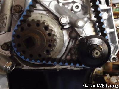

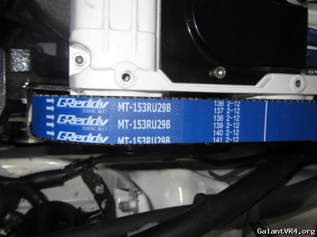

Gates timing belt

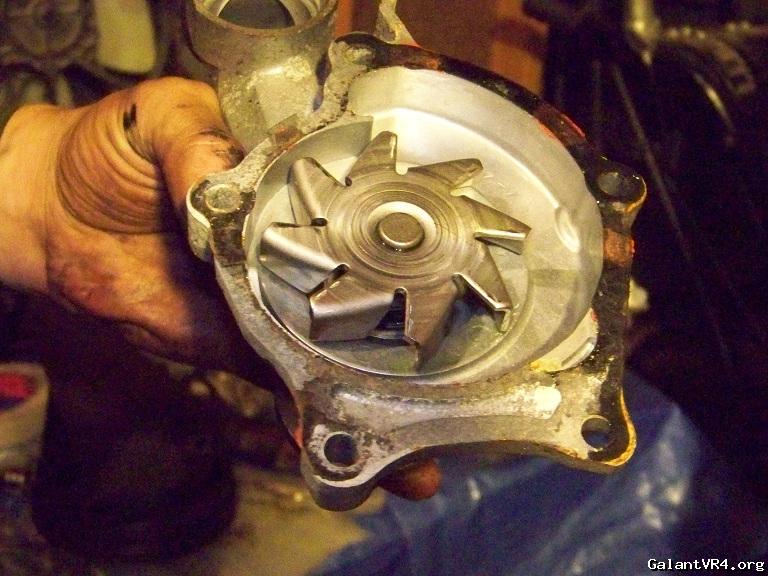

OEM tensioner
ITM water Pump and STM bolt kit
OEM engine overhaul gasket set
1990 Air-cooled oil filter housing
MAP Oil cooler kit with push lock lines and B&M cooler
OEM oil strainer and gasket
OEM MLS headgasket
OEM harmonic balancer
ARP headstuds
STM oil feed line kit
Spectra Oil Pan and STM stainless bolts
Stainless valve cover bolts
Stainless master to slave line(thanks 4nmuscle)

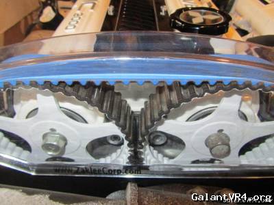

Zaklee clear timing belt cover
Replaced:
Turn signals

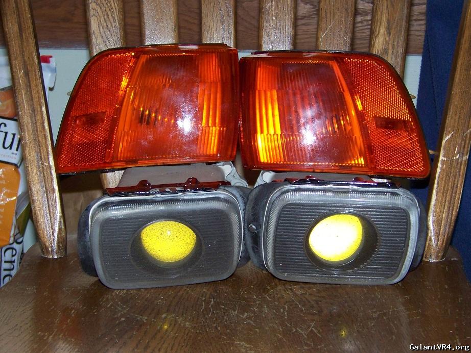

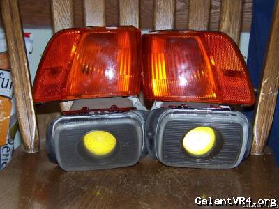

Foglights (Curtis cleaned these up, painted the housing black, and installed Lexus yellow fogs)
Corners (Curtis painted amber to match AMG corner look)

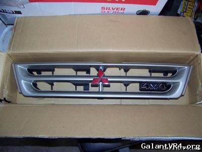

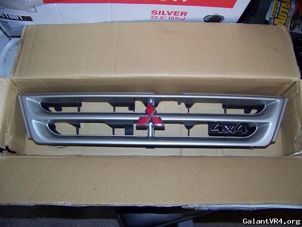

BNIB Eterna ZR-4 grille with 4x4 badge(Thanks Dennis.)

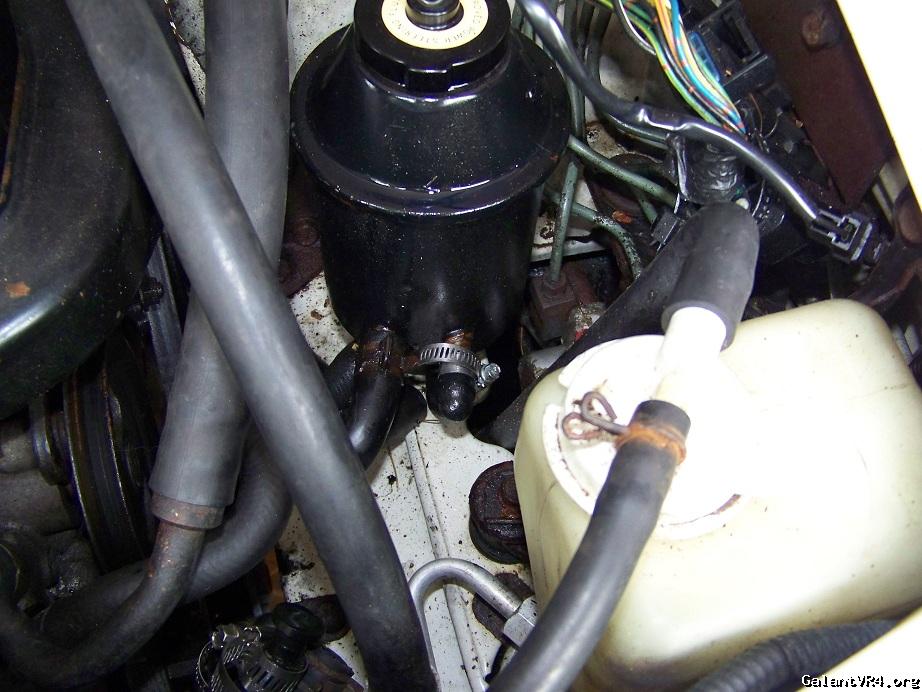

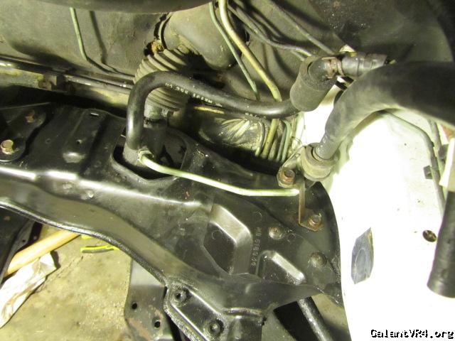

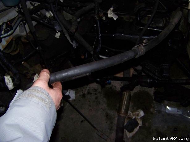

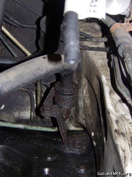

Here's where the PS is leaking really bad. I may be looking into getting the lines all re-made at a hydraulic shop.
Still need to get new idler and tensioner pulleys. Intercooler piping, brackets, valve cover, intake plenum, and more went to the powdercoater. Have not sealed oil pan yet. Engine bay needs cleaning up and rust removal where the battery tray area is. When it warms up more, me and the homies will be attacking the engine bay assembly line style. Got most of the missing interior pieces except one little circle clip. Thanks to GSX_TC, 524of1000, Alpha Male, Diego, 4nmuscle, Curtis, galantgti, Cutlass Jim, MMCVR4, and anyone else I forgot who helped me out with parts and such.

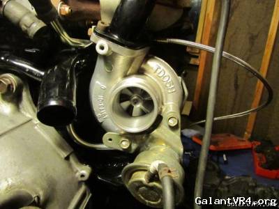

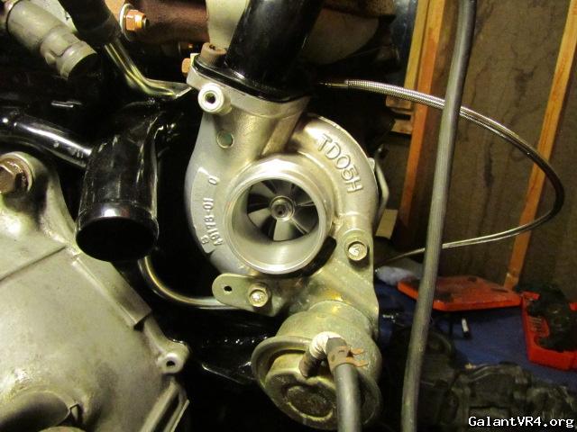

The 14b that came with the car was junk, so I replaced it with a rebuilt MHI Evo III 16G with a ported turbine housing as well from TSITurbo95 off of DSM tuners. He has a good rep on there and is listed on the freelance section as well. There was a hairline crack near the flapper, but he tack welded it.

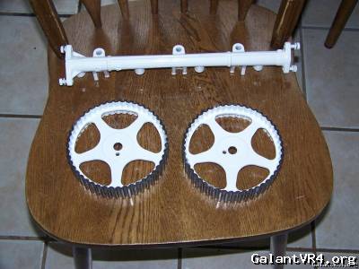

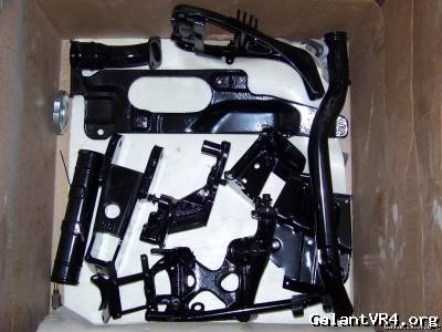

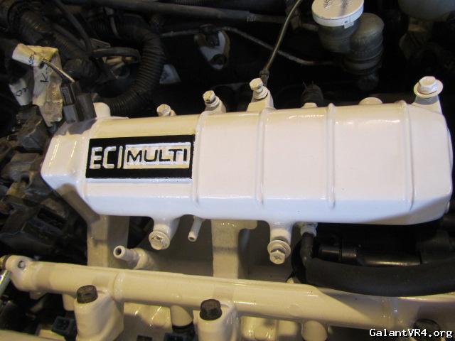

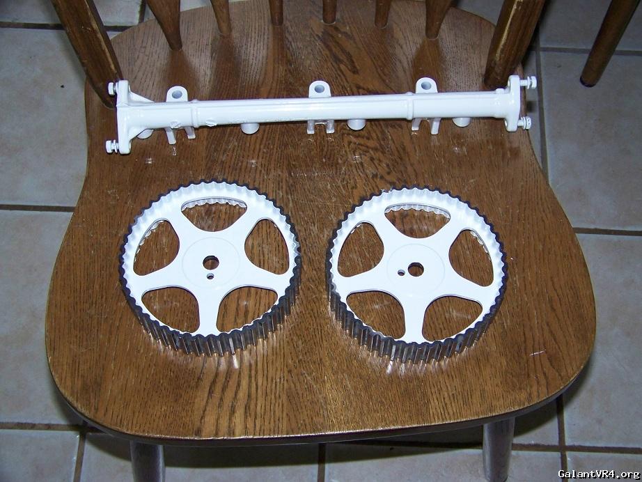

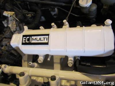

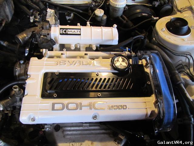

Got a bunch of things powder coated. Chose gloss black for everything except the intake plenum, VC, and fuel rail, which are gloss white. My Galant valve cover got ruined from media getting in the baffle, but I replaced with another powder coated DSM style one for now. A couple things I forgot to take pics of that were coated were the starter plate and a RRE spark plug cover

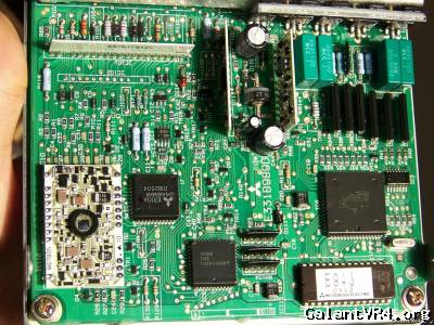

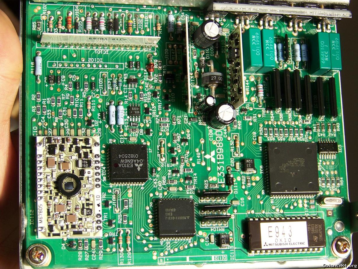

Even though the ECU that came with the car was super fresh, I still had Terry replace the caps and socket it for when I am ready for DSMlink. Well worth the small investment.

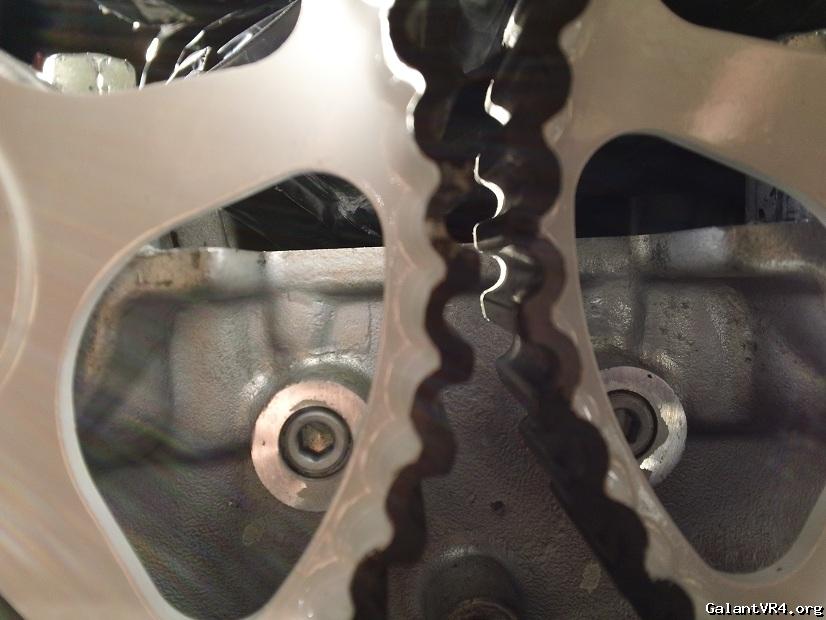

Here's the fuel rail and cam gears. I painted the spokes of the gears to give it a cool look since they will be visible with the Zaklee timing cover.

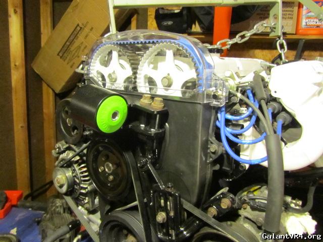

Drop Engineering motor mount kit(black w/ 75A lime green inserts)
Torque Solution front motor mount

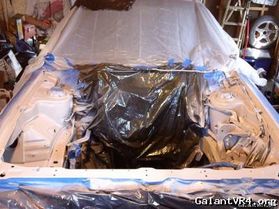

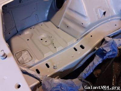

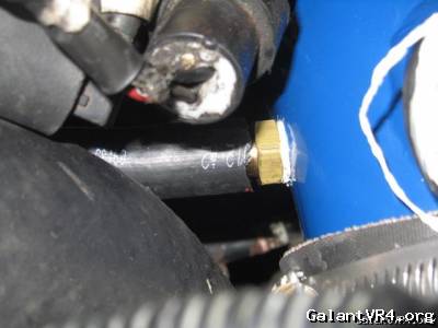

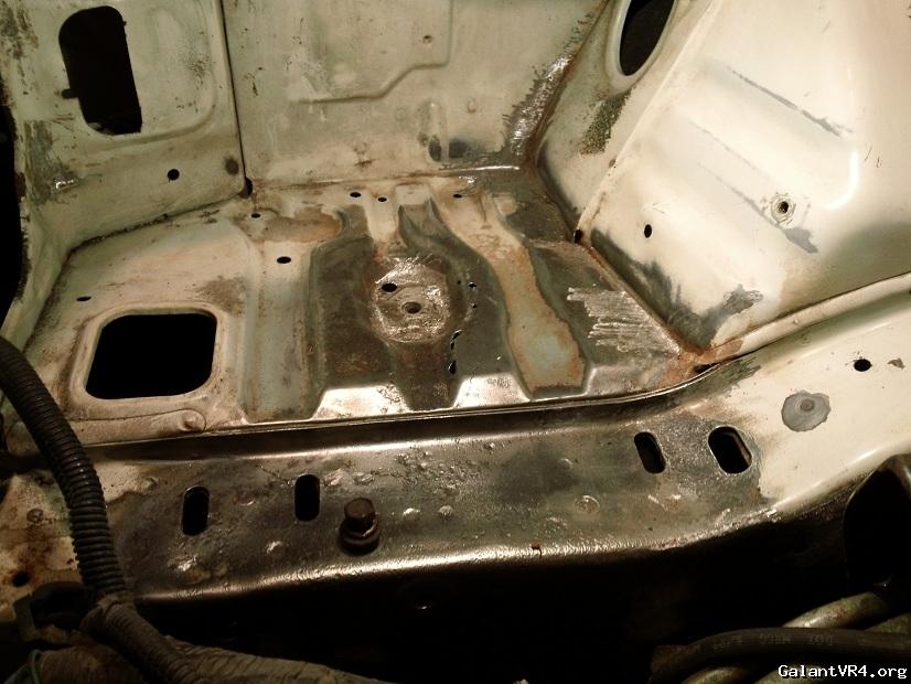

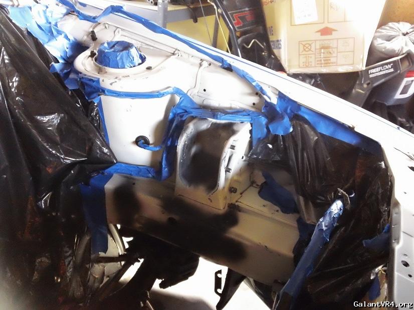

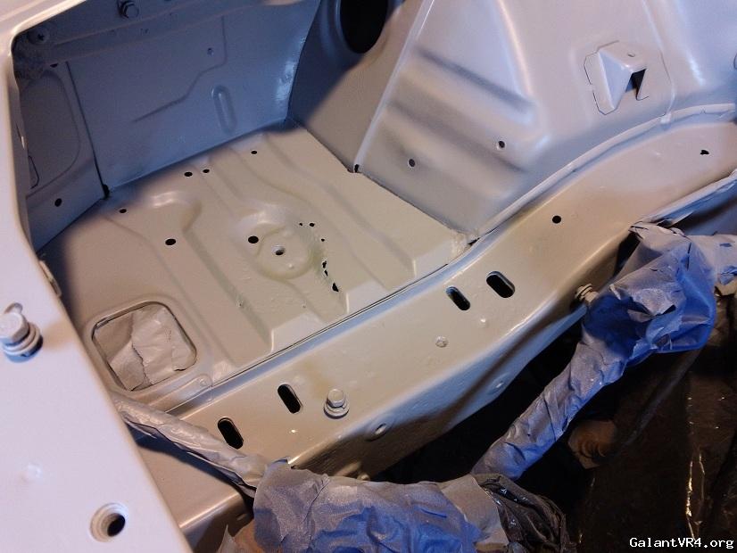

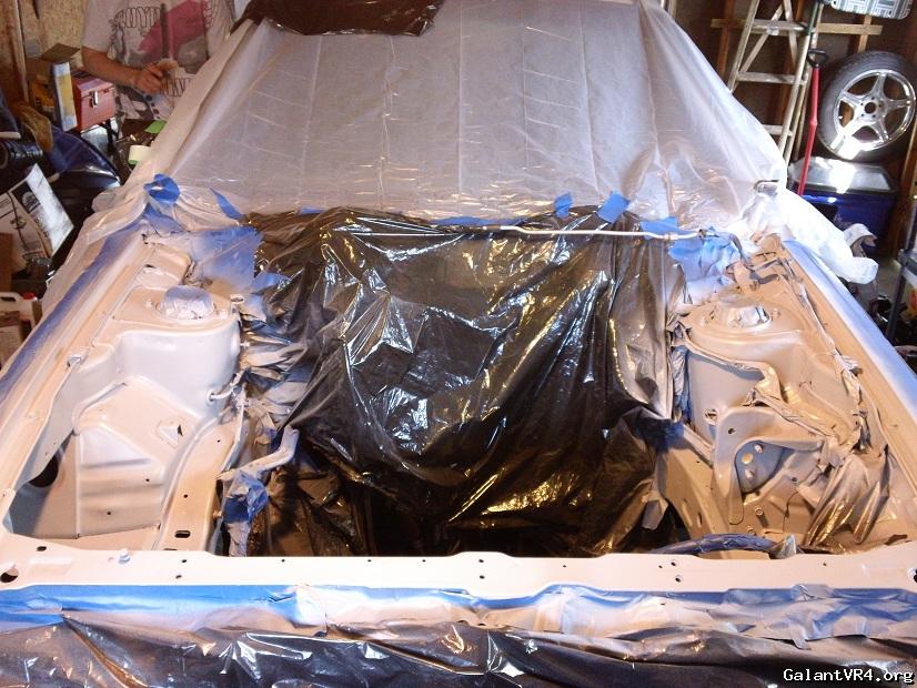

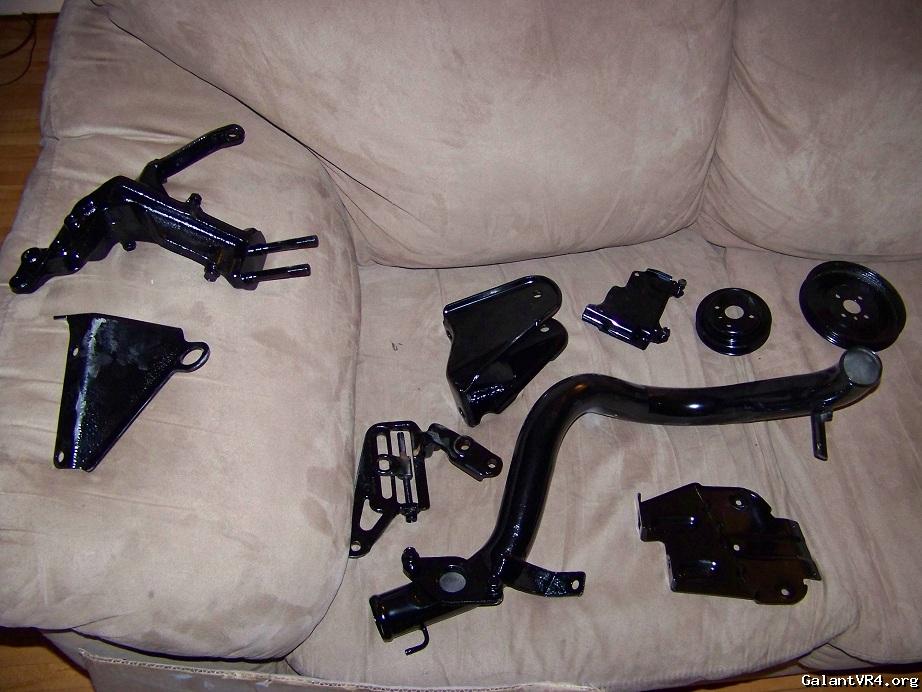

Since I am running the '90 OFH, I had the nipple on the water pipe welded that ran to the old OFH. Forgot to take pics.

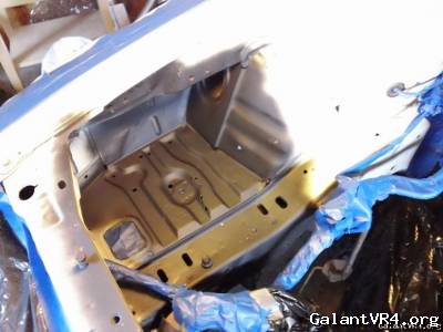

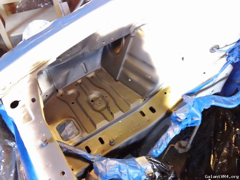

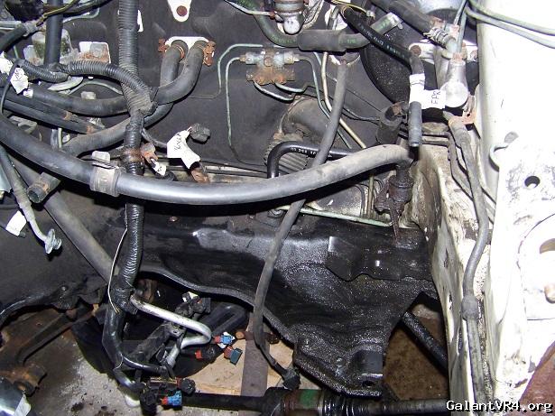

Painted a few things like the door trim, windshield wiper arms, fuel filter bracket, and a few misc. brackets I can't remember now. Also went through and decided to get rid of the rust where the battery tray sat and along the frame where the corrosion dripped. Paid one of my roommates in sushi to grind it out.

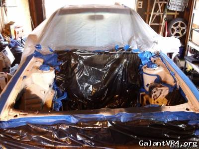

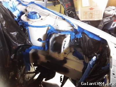

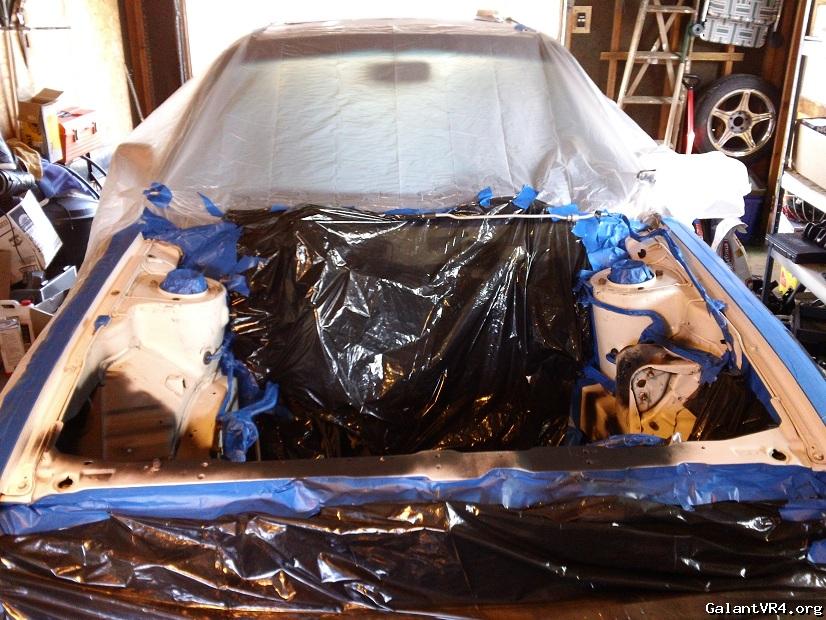

Then we went through and taped up the bay from about half of the strut towers back including the firewall. I would like to have stripped the whole bay, but the from the strut towers back, it doesn't look bad. Rust was the main issue and I wanted function over form. Hit the rust with Rust Reformer, went through with self etching primer, painted the bay in spray-canned Summit White, and finished off with clear. Looks a lot better than it did before. I forgot to take pics when it was all done in Summit White, but it was done, trust me.

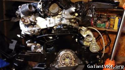

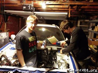

Here's me doing something. Mainly just a shot of the new stuff that will be covered by the lower timing cover.
Shot of the passenger side.

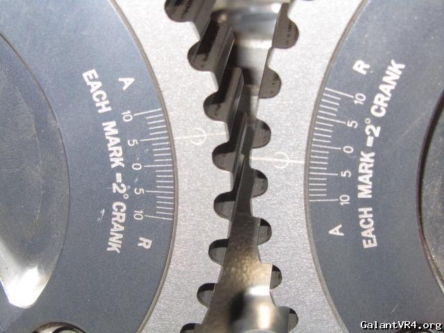

Timing marks. My friend Matt said this would be important to document.

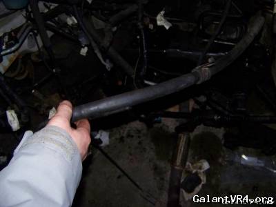

Replaced the leaky high pressure PS line thanks to Pot.

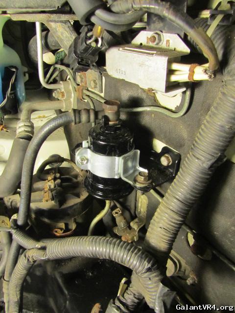

New fuel filter. Apparently the one I took off was not OEM and had been replaced before. It was gold instead of black, but at least it is OEM now.

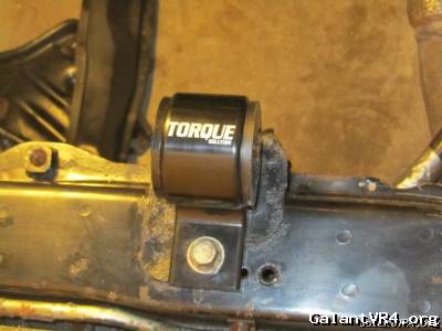

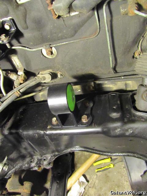

Could not get the DSM Drop front engine motor mount to fit, so I had to order a Torque Solution GVR4-specific front motor mount. It still has the same 75a hardness as the Drop rear, which is good.
Here's a side shot of the engine and the Drop driver's side mount. Much lighter and sleeker than the stock mount.

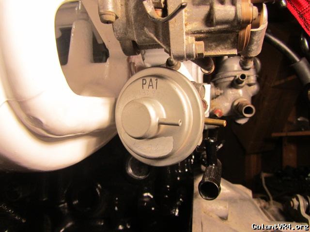

New EGR.
Rebuilt and ported Evo III 16G.

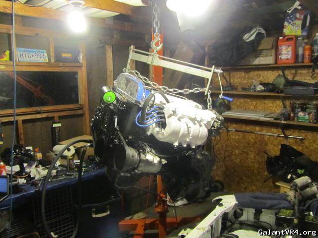

Dropping the engine in.

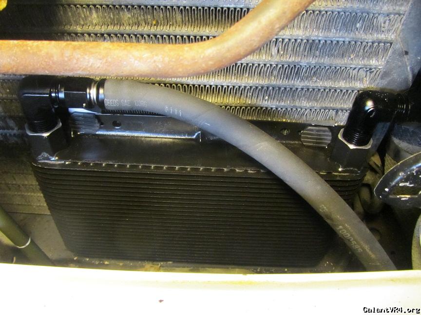

Installed the oil cooler where the A/C fan was. The fan came right out without having to take off the bumper with a little effort. Condenser stayed in too. The oil cooler is installed using radiator fan zip-tie-like things and is held to the condenser. Still have the A/C obviously, so will need to get a pulling slim fan on the radiator side.

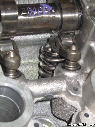

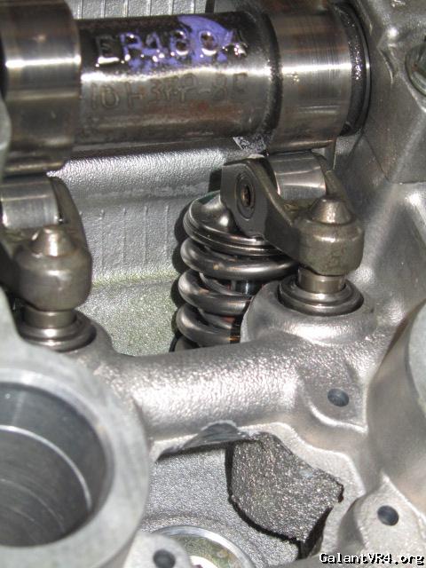

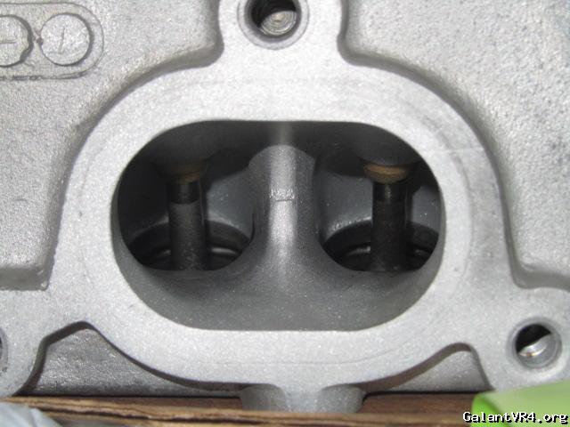

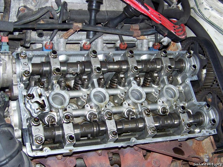

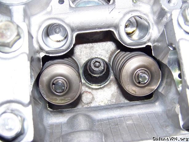

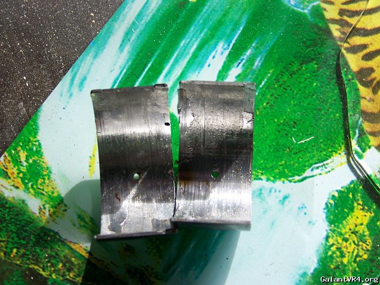

Well, I posted in the technical thread, since I got my 2.3 going. Long story short, it had an idle at 2500, took her out to seat the rings on a short 3 mile drive before the battery died. Didn't charge it overnight. Took her out again with the high idle problem and all we heard was engine clunking. Stopped the car immediately and the damn intake cam gear had sheared off the pin on the intake camshaft. My Zaklee clear timing cover revealed the devastation. Skipped a bunch of teeth and bent some valves on the stock head. Towed the car from only a few houses down and back to JSB.

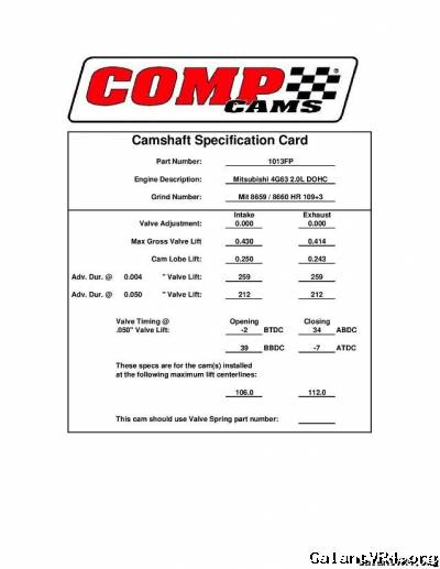

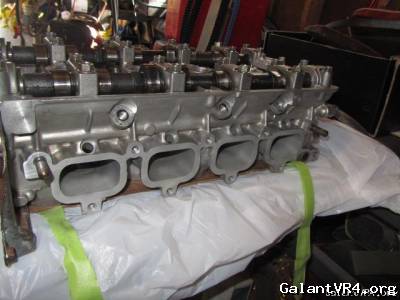

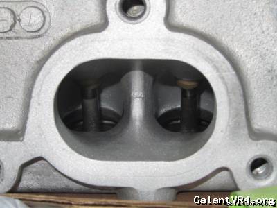

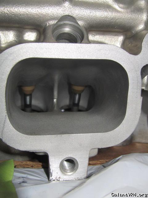

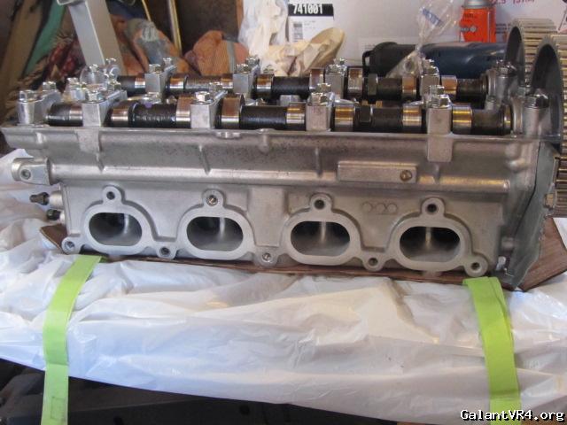

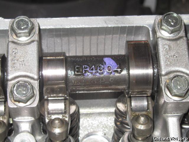

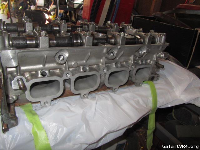

Luckily, I had bought a 1G ported, polished, and gasket-matched head with about 15K on it off of a built 2G GSX. The head is absolutely loaded. I had been meaning to get FP3x cams through COMP because the are NLA through FP, but the head came with them. Also with Supertech dual valve springs, Supertech titanium retainers, valves (Ferrea or ST), 3G lifters, cheap Onsuku (ebay) cam gears already degreed, and newish seals and seats. It had dynoed 480 HP on E85 at MAP's Boost for Boobies this past spring. Car was running a 2.4 stroker setup. I believe the car blew a HG, so he decided to part out the car and work on his turbo LSx FC.
Took the head to a local well-known machine shop to get it looked over. Some of the valves were sticking due to the E85, so I got the head hot tanked, resurfaced, valve job, new seals, and a couple helicoils for the exhaust manifold studs. The owner told me he couldn't identify some of the aftermarket parts, but that they were indeed aftermarket since they see a lot of these heads. I paid $575 for the head and $380 to the machine shop.

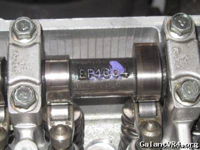

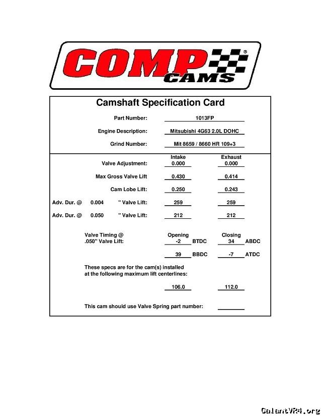

FP3X Cam Card

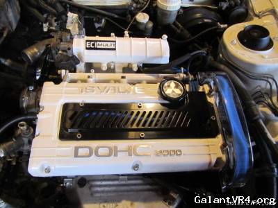

Decided to go with a 2G MAF and Dejon 2G air intake pipe with BOV recirc nipple. No charcoal canister nipple or valve cover vent nipple when I ordered it. I am venting the CC line to the ground and added my own valve cover vent barb fitting in an orientation that is convenient. Dejon FAQs say that venting the CC is fine and will not affect drivability. The stock air can setup uses a boost control solenoid vacuum nipple. I will be using a GReddy Profec-B Spec II boost controller, so I didn't have to make a nipple on the Dejon. Air filter is K&N FIPK 2G with MAF adapter. That sucker is huge!

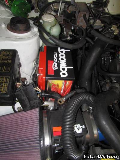

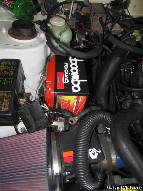

Since I am using the Dejon, I got a "Blingin' Tray" and Odyssey PC925 battery. With the Drop Engineering mounts except for the front (Torque Solution), the trans motor mount does not have a mounting for the air can like the Galant one does. Had to fab up a bracket because the tray requires the mounting point on the Galant trans motor mount.
Janky BOV hose is just temporary. Going to remove the stickers too and keep it clean.

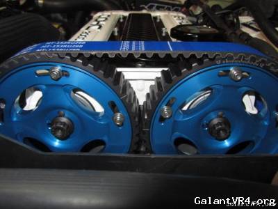

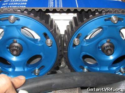

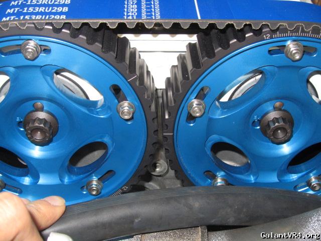

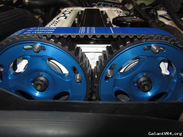

I took the Onsoku ebay cam gears off and replaced with Fidanzas. The stock gear that sheared the pin off the old head was totally fucked. The pin was holding on for dear life! That's why I decided to replace with blinging ones that could be adjusted later on. Also got ARP cam gear bolts to hold those suckers down. Timing belt had a groove because some STM jabroni did not label the short bolts in the "kit". They were all the same damn size. Replaced the gates with a new GReddy unit. It cost a little more, but it is very high quality from what I can tell. Replaced the bolts and no groove. Had to get another Zaklee cover too.

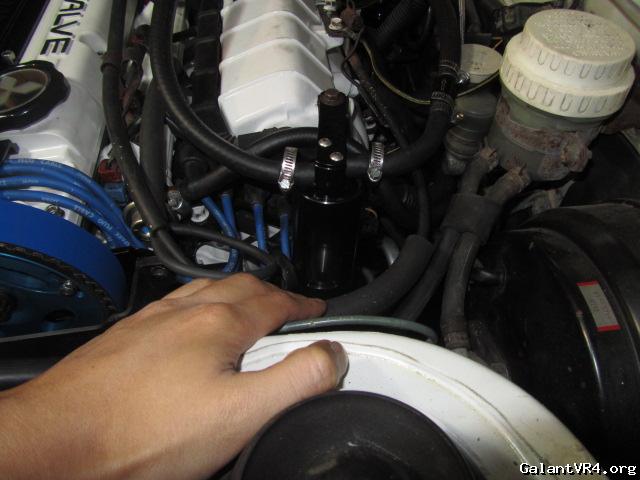

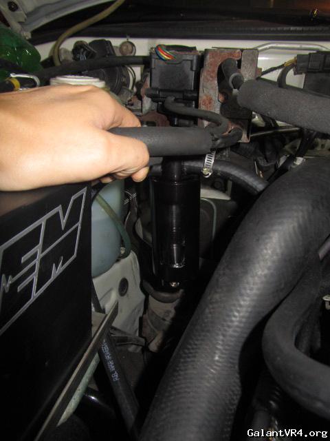

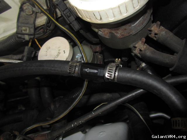

Spent some time reading on VFAQ about the PCV system, so I can keep blow-by to a minimum. It was lined all over my stock intake snorkel. I have made my catch can setup exactly like the ideal "Improved Factory Setup" for street and part-time track. VFAQ PCV System The cans are sealed Boomba Racing units with a clear window for visibility and 3/8". Instead of using the US plastics check valve, I decided to get a Boomba Racing 3/8" check valve to tie in the whole setup.
PCV hose to catch can to check valve to intake manifold.
Check valve.
Valve cover vent to catch can to air intake pipe. Mounted on the cruise box for now.
Valve Cover Vent nipple

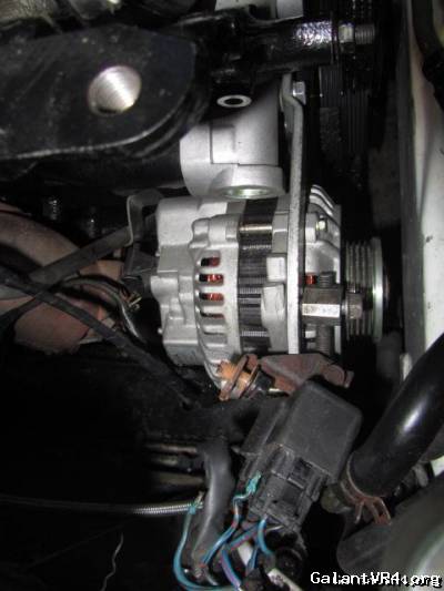

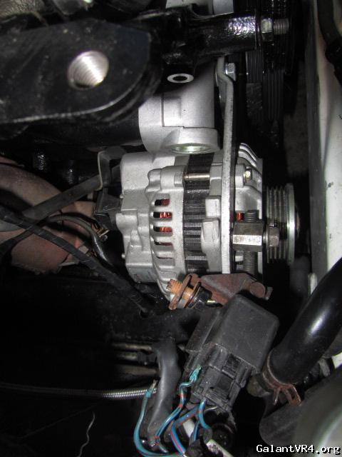

Got a new NSA alternator from Nate Crisman. It was mint and apparently was only mocked on. Had a hard time getting tension right. It squeals and my friend thinks we may have fried it. Need to figure that out still.

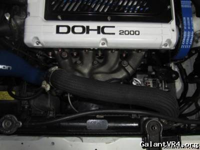

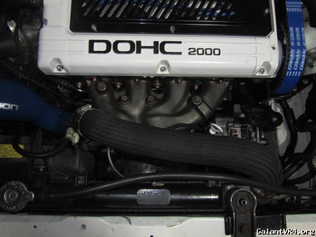

Replaced my stock exhaust manifold with a new OEM Evo III manifold. Decided against the FP because I wanted to stay OEM and keep the heat shield. Also replaced the already new exhaust manifold gasket with the 4-layer version. I want to coat the heat shield black on top, but leave it normal underneath, so that it doesn't absorb too much heat.

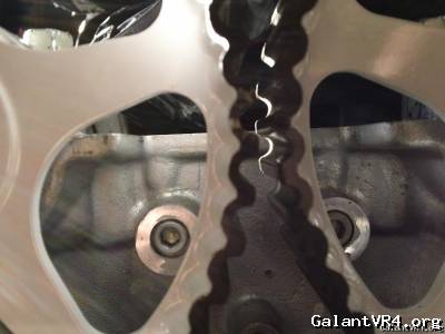

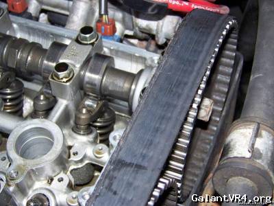

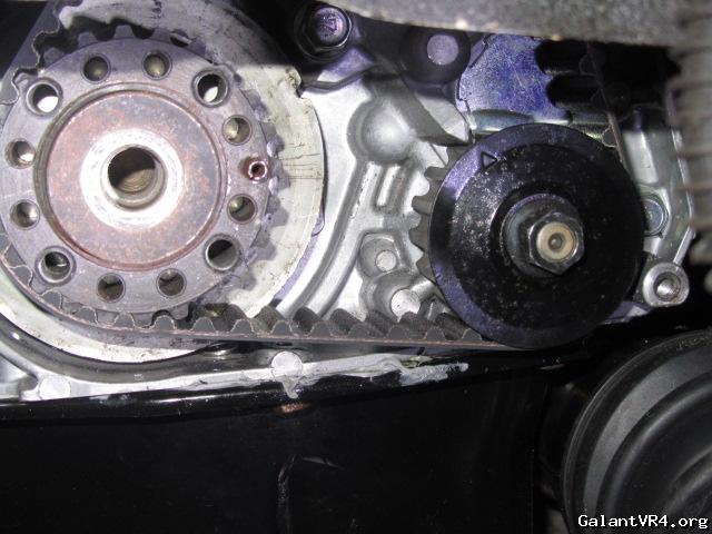

So I think something is off. The crank mark is in the right spot, but the marks on the cam gears are off. Notice how the pins are lined, but the degree marks aren't at the top. Are my teeth not zeroed out?

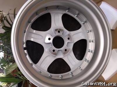

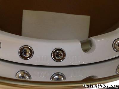

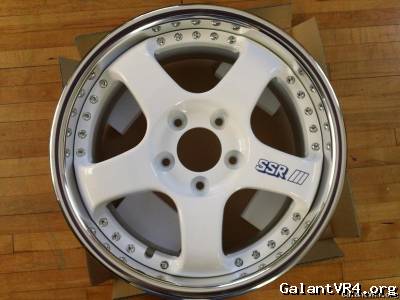

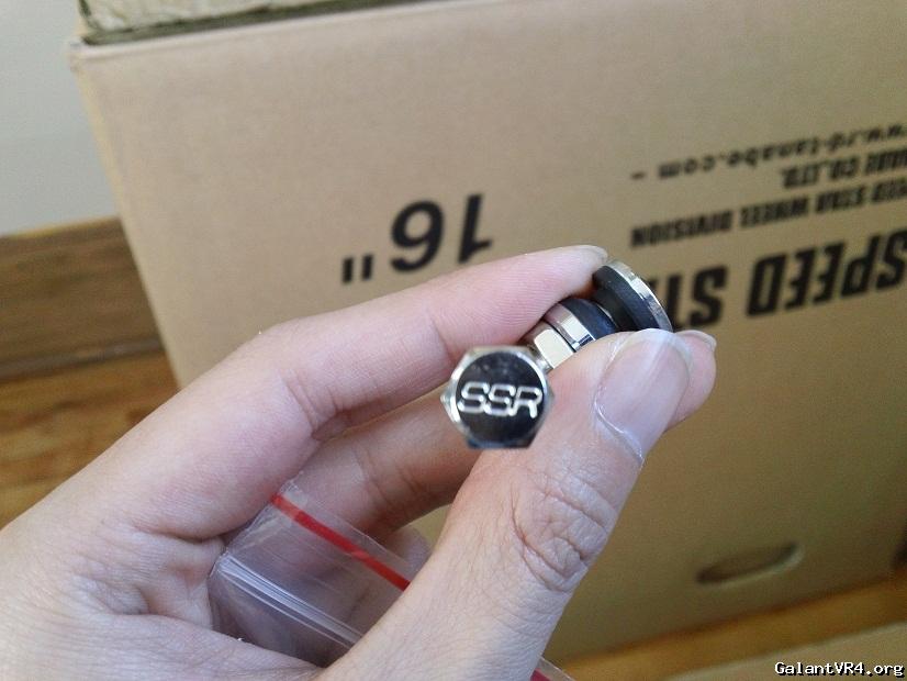

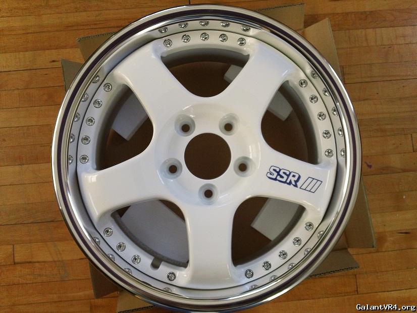

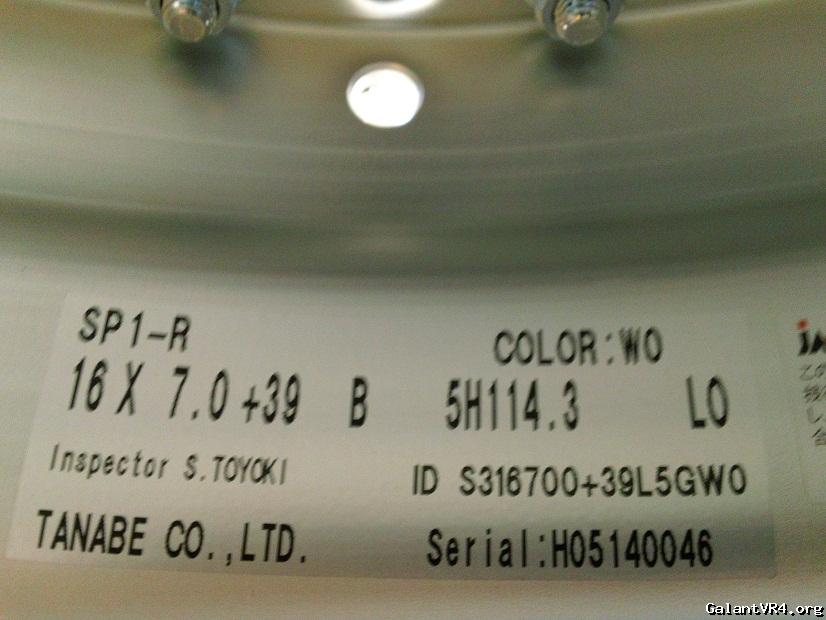

Ended up with my brother's wheels since he needed the money more. He was going to put them on his black '03 EP3 Si, but never did. They are BNIB. For $1300 with Rays extended duralumin lug nuts anodized blue, I got a great deal considering they were $450/each plus the $200 lug nuts. Best to go to family then some other JDM fanboy /ubbthreads/images/graemlins/wink.gif. They make them in 4x114.3 too, but these were just too good to pass up. 5-lug swap time. Probably going to be hard for me to figure out, but I'll have help. Will have to get a weight posted later. I want to get some center caps for these as well. The stock wheels have kind of the same them going. I think the chrome trim on the car with the polished lips will flow nicely. Clean, simple, awesome.
