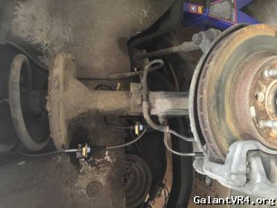

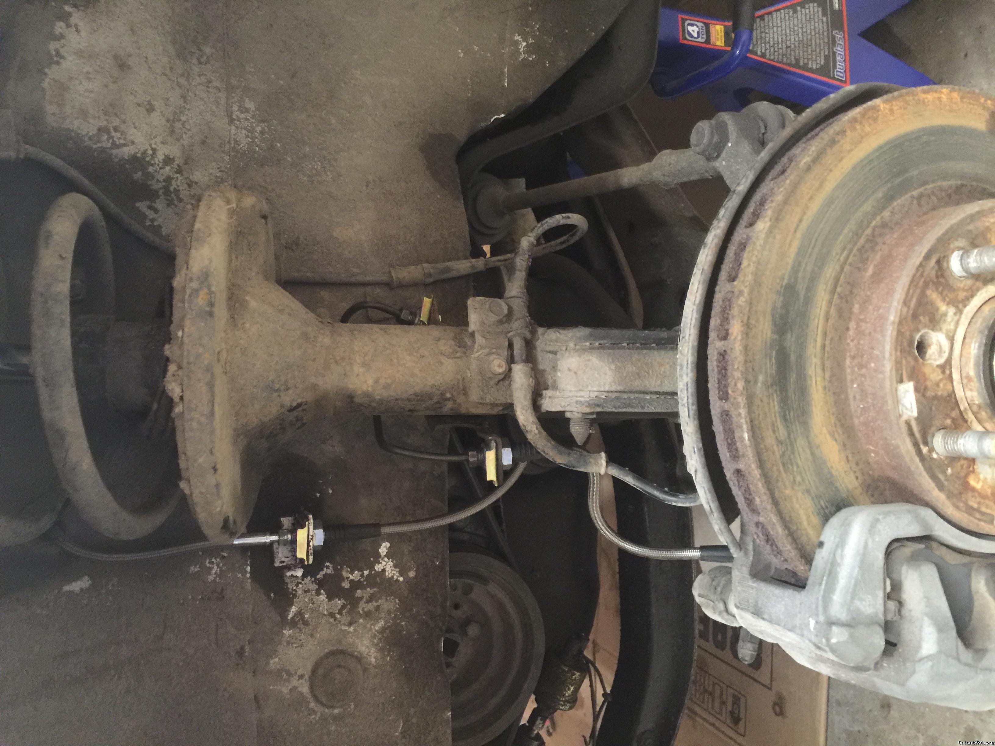

I am about to install some Technafit brake lines just as you have pictured, but for a different chassis (same connections minus the 1/8x27NPT fitting on the Wilwood caliper).
Yohler, questions for you.
How did you get the technafit fittings to mate into the holes on the metal tab at the body and on the strut bracketry where they are held in with the horse shoe clips?
Did you grind down the tabs that provide the 2x extra girth for the fitting to keep from rotating once inserted into the hole?
Reason I ask, is because the factory style horshoes have too small of an internal diameter/U-shape to fit the Technafit lines.
Also, the fittings won't fully seat into the tabs because they are physically wider in the machined channel than stock lines fittings. (Horseshoe grooves).
If you could elaborate, I would greatly appreciate it.
Ninja edit before my thoughts even had me pressing the Add Reply button; parts answer my own question.
Are these the horseshoe clips you ordered, that fit all of their end fittings that a Mitsubishi would use?
Brake Line Clip
Yohler
Feb 26, 2016
70
New Lenox, IL
The lines are from JNZ tuning, everything bolted right in without any fuss, retainer clips and all (which came with the lines). click

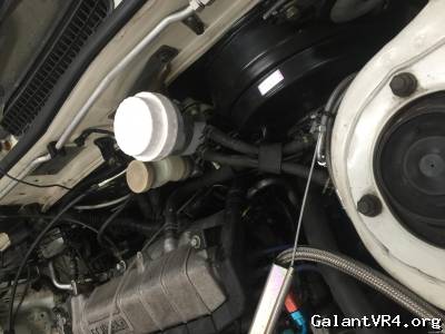

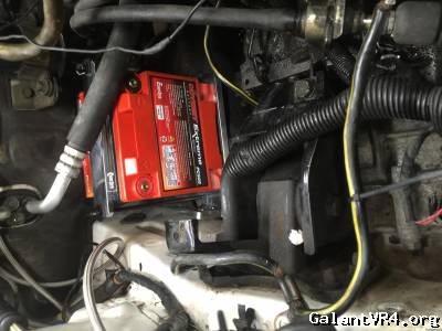

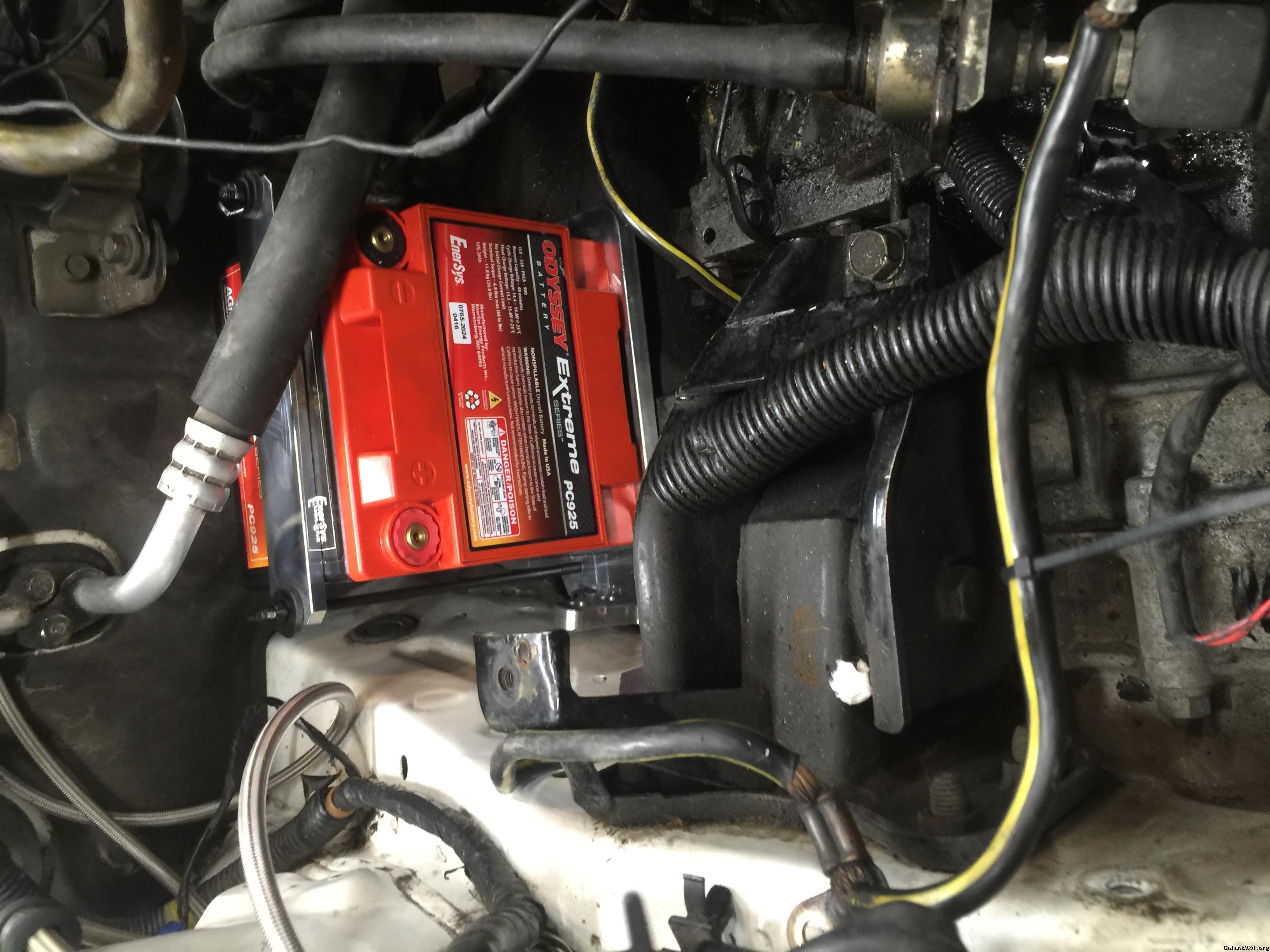

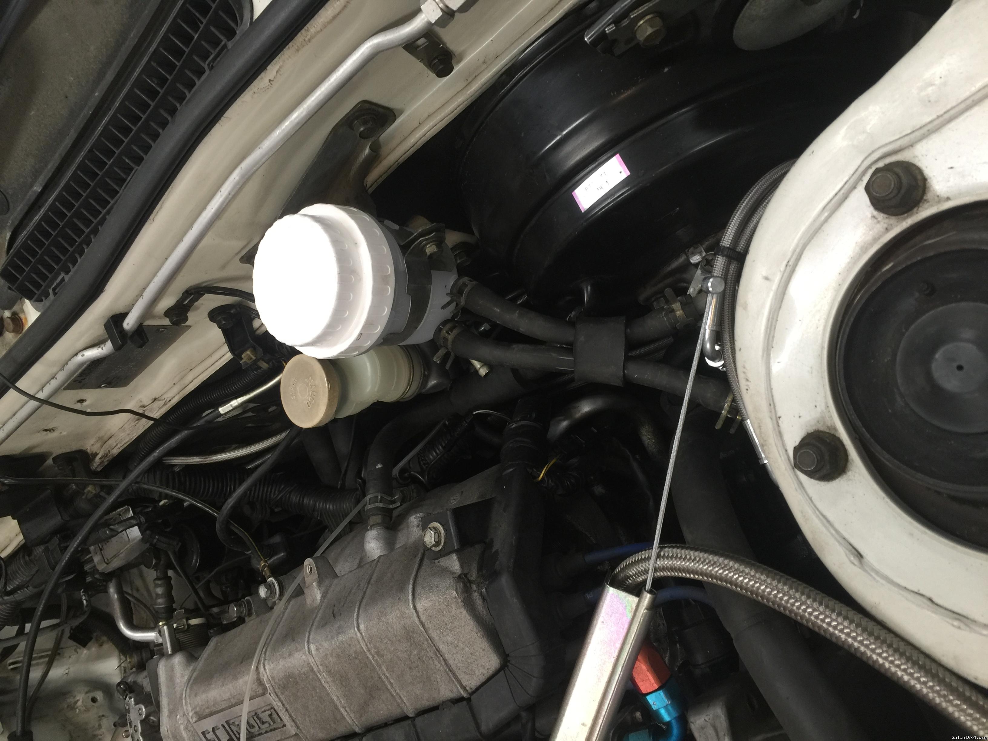

Spent a little time in the garage. Brakes have been bled, clutch has been bled. Also got the battery in the car at the expense of having to start removing the 4ws and nobody was lying when they called that the messiest job ever.
thomcasey
Sep 24, 2014
907
Indianapolis, IN
That it is for sure. I kinda cheated on mine. I left the HP lines on the rack. I just drained the system for a couple days, left some metal line after the rubber flex fitting, crushed them and welded them shut. They hold and don't leak with the PS filled and working and it helped me avoid messing with the rack to remove the lines.
Yohler
Feb 26, 2016
70
New Lenox, IL
That would be nice if I had a welder. Not there yet so I went with some AN adapters with caps. Then hopefully I can take this thing for a cruise.
