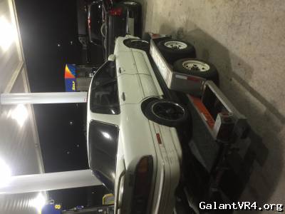

Bringing her home from Virginia to Chicago.

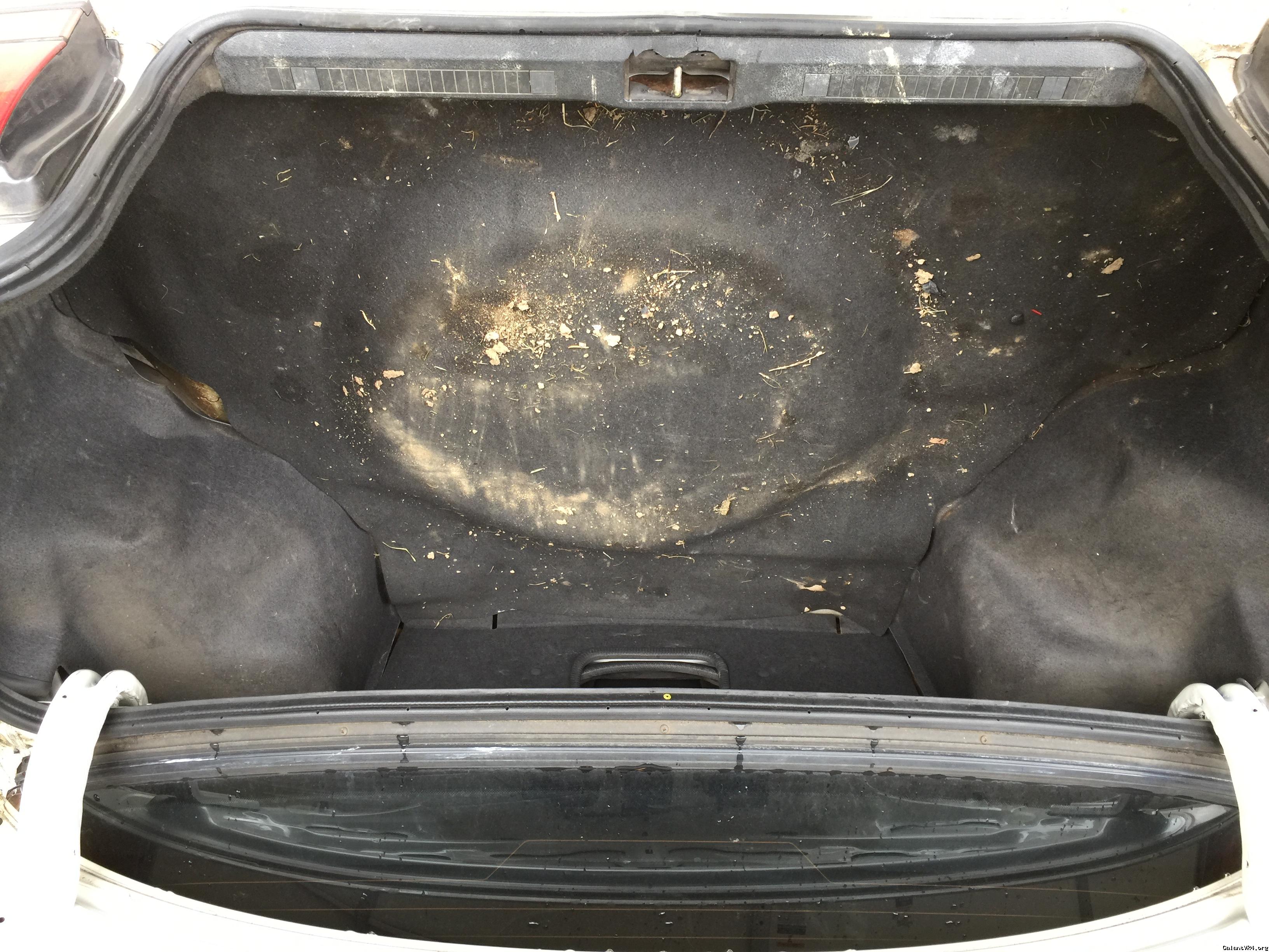

The car had been sitting for a few months and it showed even on the interior. With it being pretty cold the last few days, the exterior hasn't been touched but I spend several hours on the inside. /ubbthreads/images/graemlins/jawdrop.gif

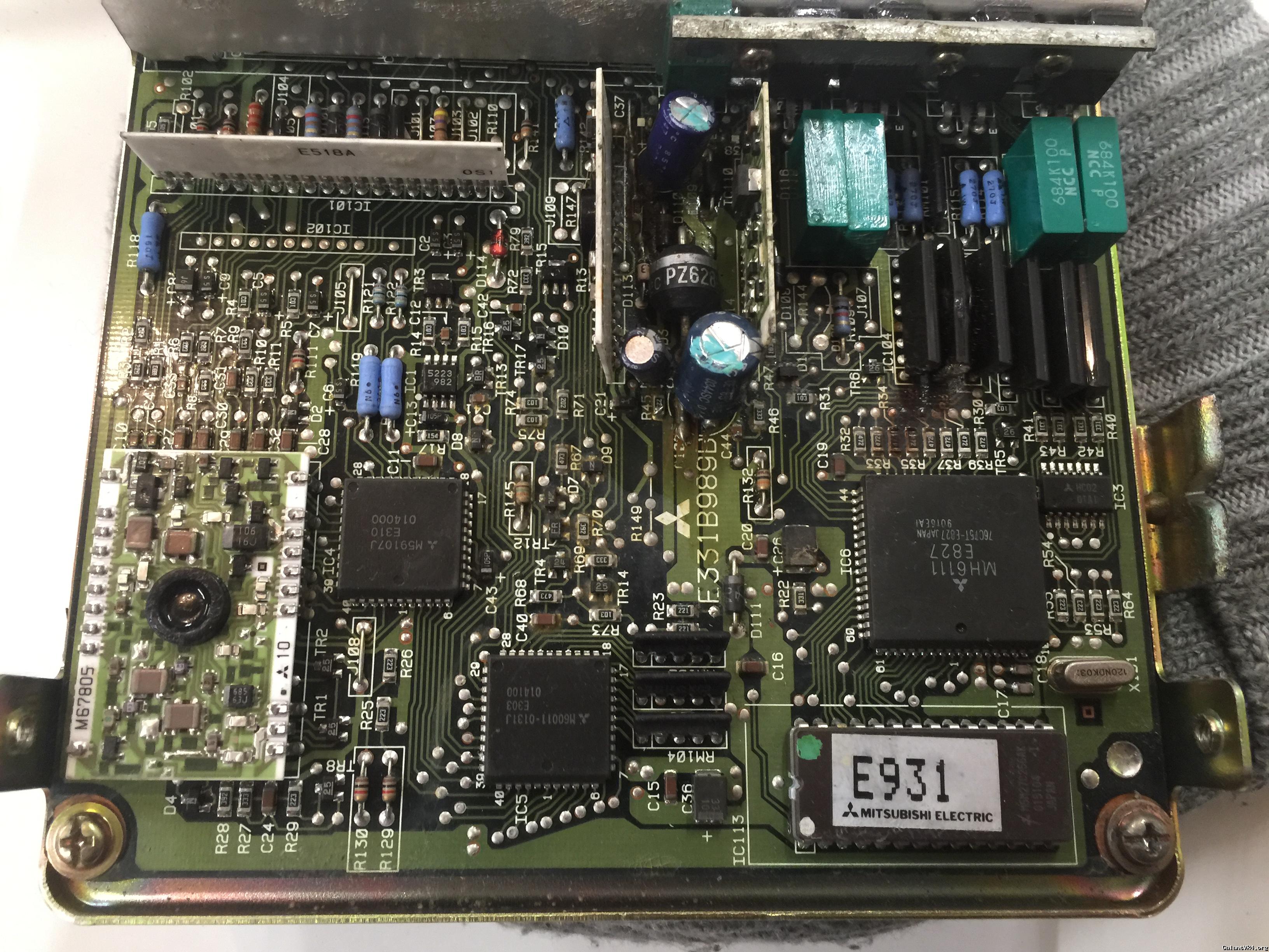

Well today I got time under the car to assess the brake line issue and the only rusted area on the line I could find was very close to the rear. Trying to decide on running the line completely new or just doing a fresh double flare on the remaining good part of the line and going from there. That was the only good news of the day. Since I started cleaning out the car once it got home I had a bad feeling about the ECMlink V3 not actually being in the car, and it seems my fears were founded. Nothing but a stock ECU with some melting parts. /ubbthreads/images/graemlins/banghead.gif

ECU has some damage and will need repairs when sent out.

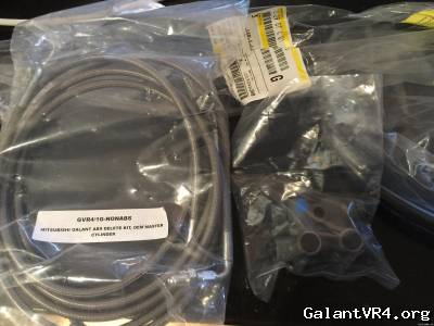

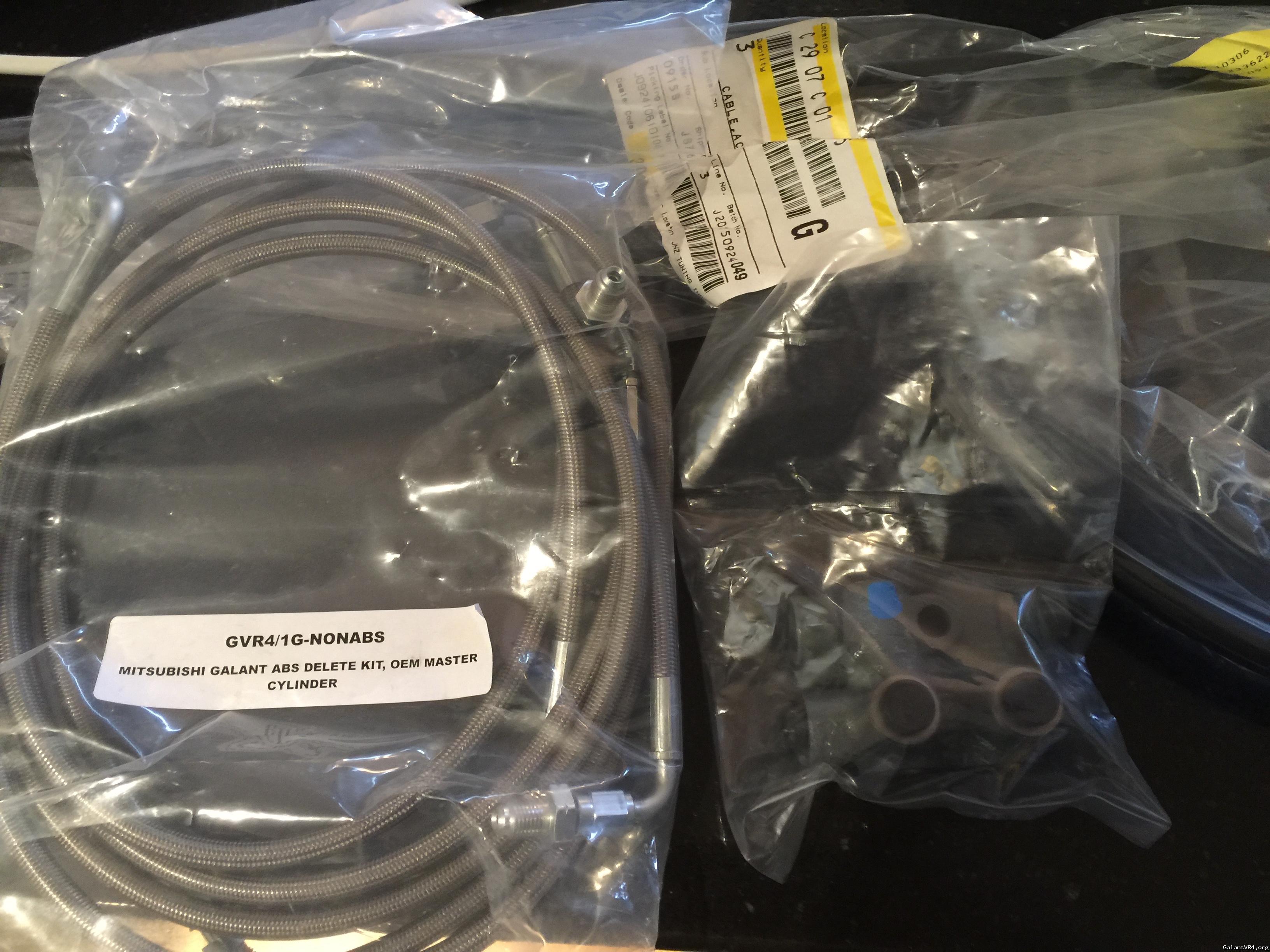

New Brake fluid reservoir, ABS delete kit, and a non cruise control cable from JNZ.

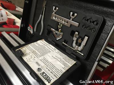

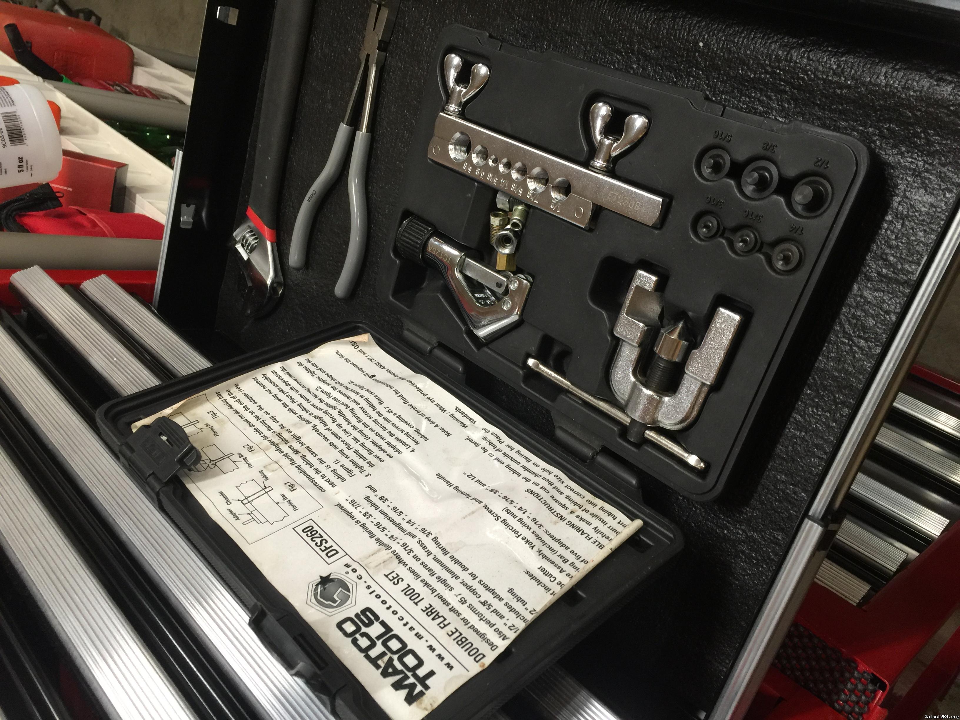

Tools to do the lines. Having a friend who spends big money on every tool he owns is a good friend to have /ubbthreads/images/graemlins/worthy.gif
Does anyone have any experience with NiCop brake lines? It's been said to have been used for a long time on some higher end cars, and seems like it will be less of a pain to bend than steel. I'm admittedly not the most patient persion when it comes to stuff like this and have to keep reminding myself of the story of the two bulls. For those of you not familiar with the story.....https://www.youtube.com/watch?v=zXYu7E8HHxo (skip to about 1:15)

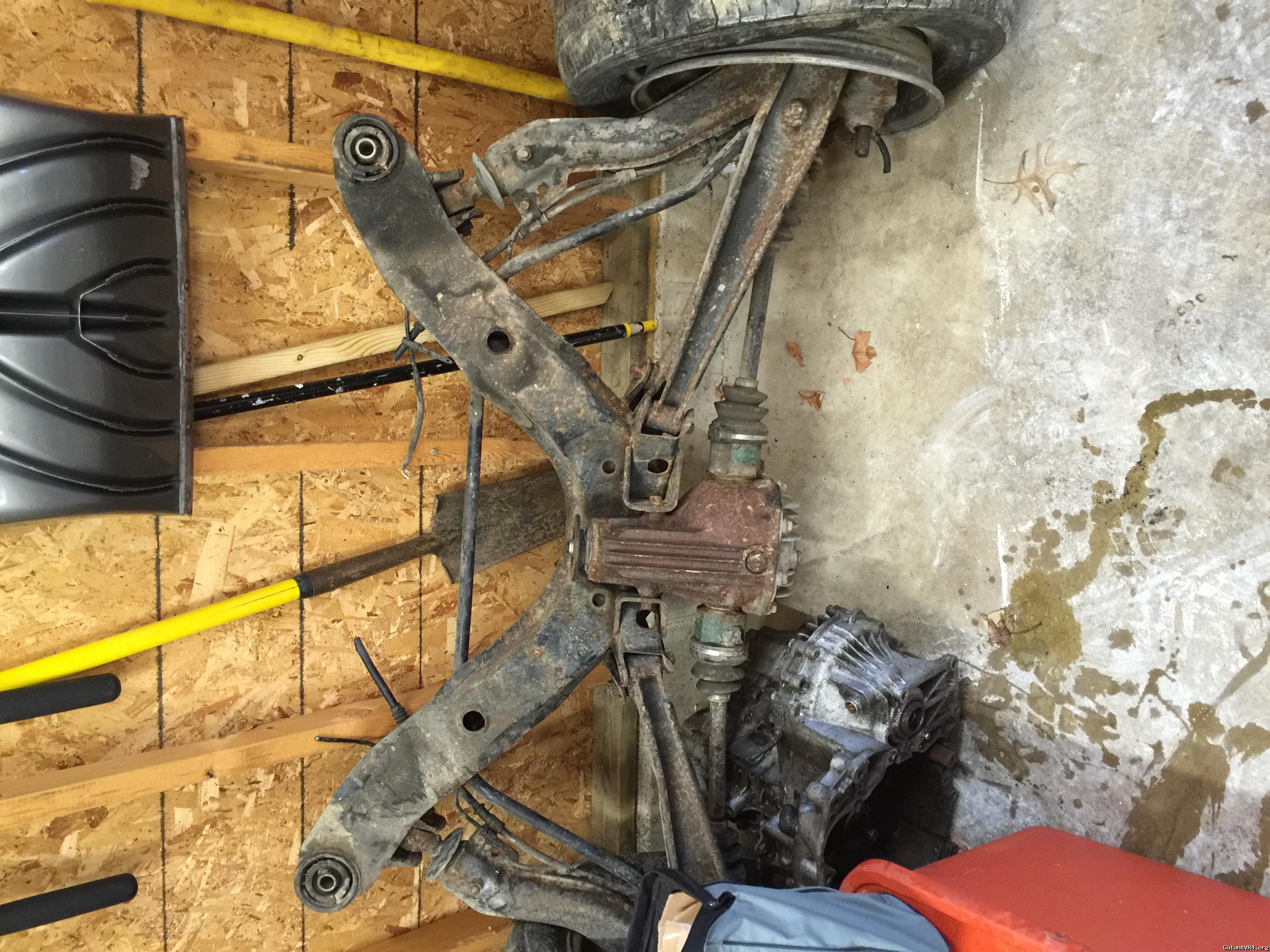

Also forgot to mention, got the 4 bolt out of the DSM rear subframe and no longer have this monstrosity taking up room in the garage. I thought she'd put up way more of a fight, but it came apart pretty easily all things considered and I only had to cut two bolts.
Debating on selling it since it is in pretty good condition, but I'm not sure it's worth waiting until I have enough posts to post it on here. /ubbthreads/images/graemlins/dunno.gif

The brake lines may be double the price but as far as ease to work with they are well worth it. Minor missbends are easily straightened by rolling it on a flat surface. One thing to be careful with however is because they bend much easier than steel, if you accidentally bump a nice straight section with a tool or lean on it, whatever, once it's in place, it can bend a bit and may not easily straighten out once in place.

I ended up going with steel, autozone was out of the Nicop stuff and made some good progress today, The bending tool I borrowed seems to make easy work of the steel line and should last longer than the car anyhow.

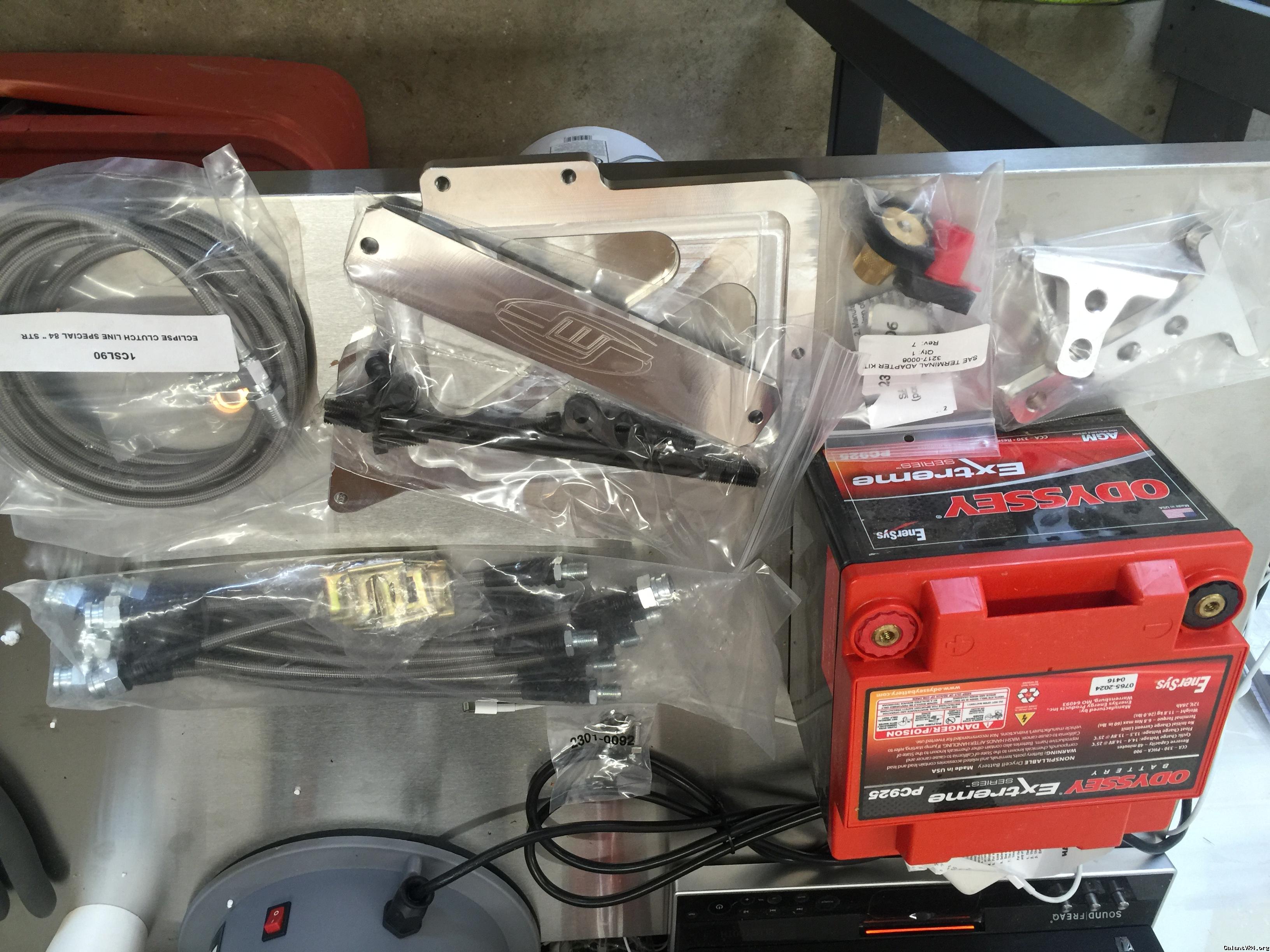

More parts. Doing my best to keep UPS in business.
Odyssey Battery w/ Terminal kit
Battery tray from JMFab
SS lower lines
SS clutch line
This should get the car into non JSB status so I can at least get it clean fully. /ubbthreads/images/graemlins/barf.gif I read somewhere on here you can get away without any sort of tuning with a 2g mas and evo injectors, but I doubt I'll risk it until I can get that taken care of. As far as the battery situation goes, how do most people secure the smaller fuse box that connects to the positive terminal on the battery in the stock location after moving the battery? I only found one mention of it being cable tied to the main fuse box in one thread. Seems like a decent idea, but the casing on mine is pretty beat and cracked.
thomcasey
Sep 24, 2014
907
Indianapolis, IN
I bought an Insulated power post and bolted to the passenger strut tower (on the side using an existing 10mm bolt hole. So, that mini fuse holder bolts there, along with the 0-gauge to relocated battery. No zip-ties needed.
