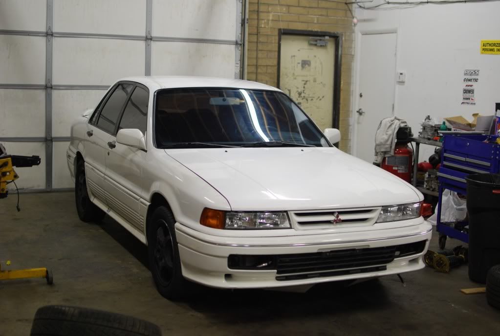

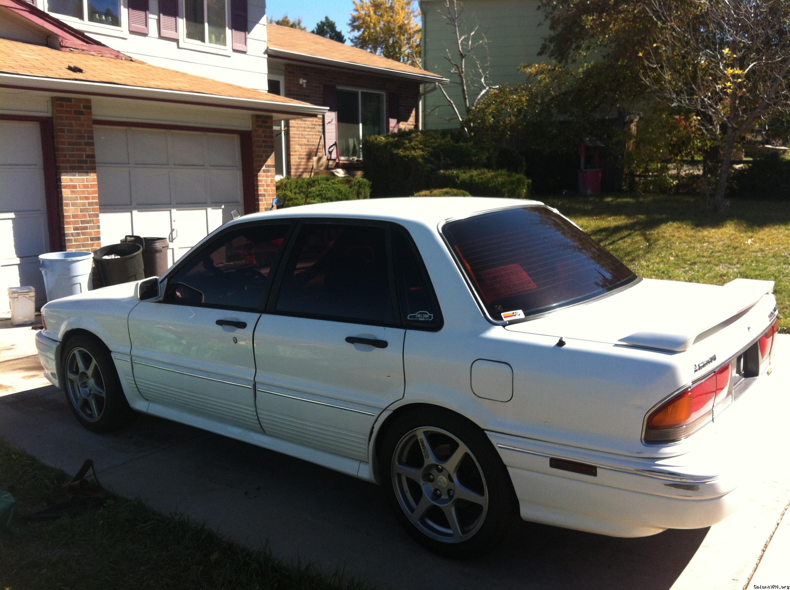

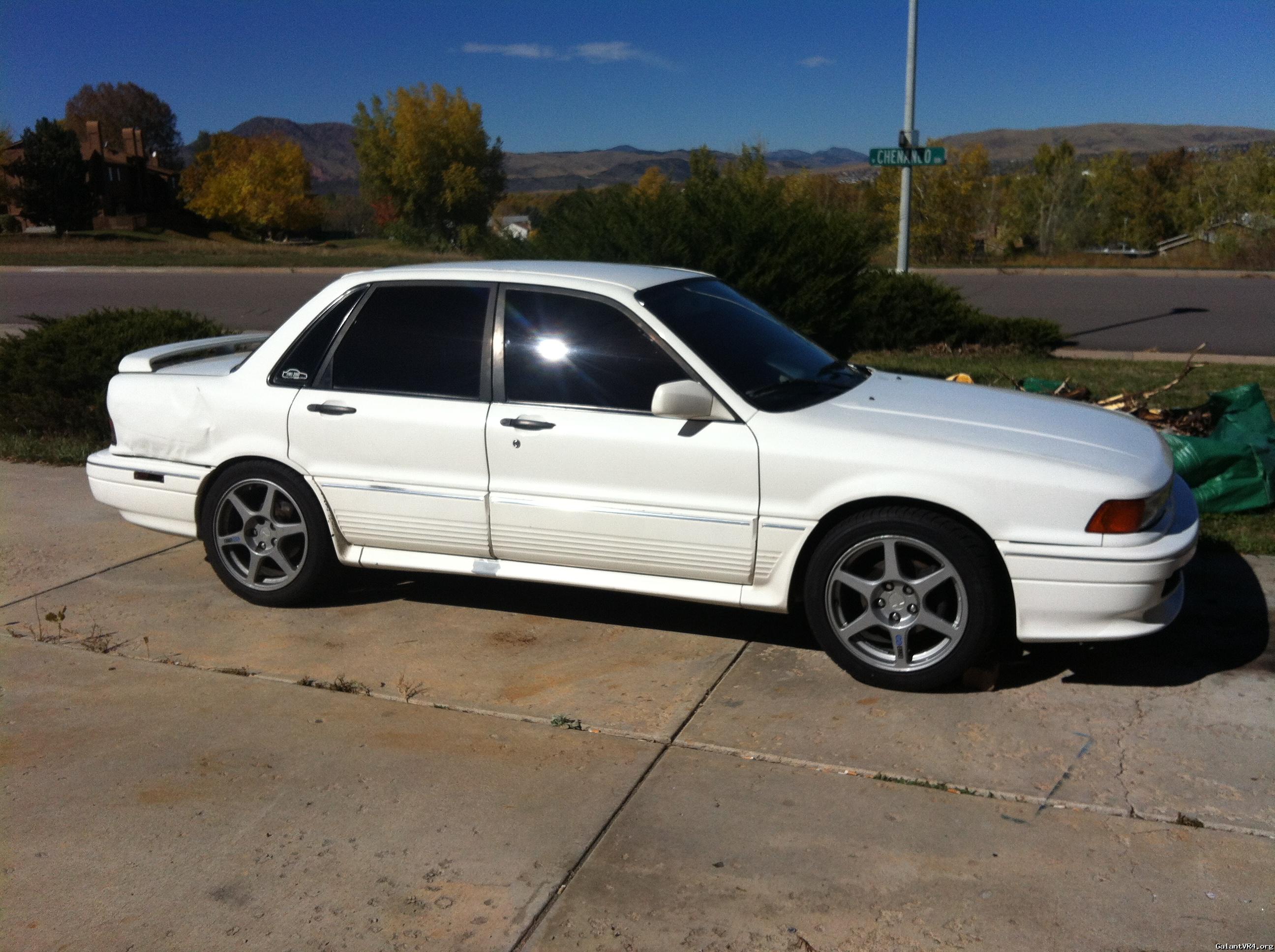

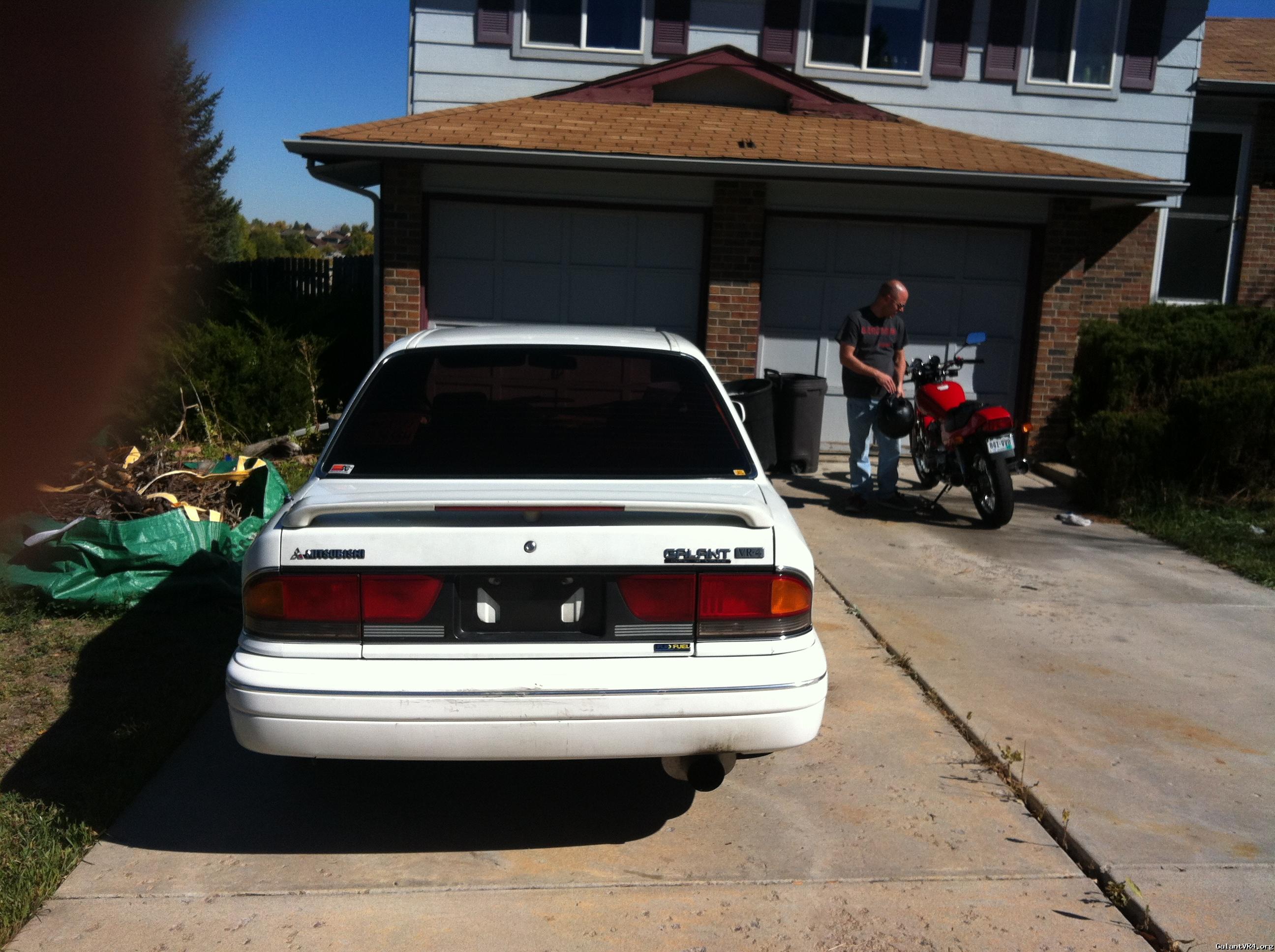

Was wondering if anyone could tell me what front and rear bumper are on it. They don't appear stock and my searches just come up with some kind of JDM bumpers. Also unsure about the grill and the headlights. I think the lights are 93.
Welcome front bumper looks like jdm without the fogs and rear bumper stock. Someone correct me if I'm wrong.

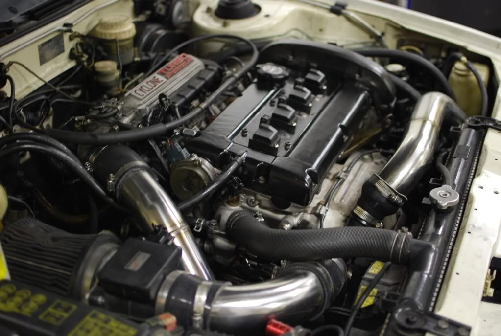

The bov came like that. Definitely not my idea. Lots of stuff to do still but at she runs good now. Hoping for a new intercooler and intake setup with recirculated bov by Xmas time. Then some tuning. I may go speed density or I might just snag an evo Mas. Still unsure. I'll get some engine shots up tonight, but she ain't real pretty under there right now.

Our cars are practically twins, pretty sweet! Whats-his-face above is correct in saying you've got the JDM front bumper, also looks like '93 headlights and grille, along with amber corners. Definitely looks clean though, I like it!

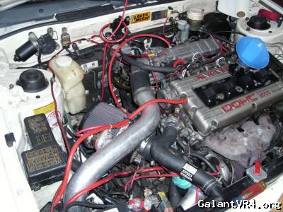

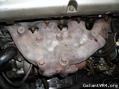

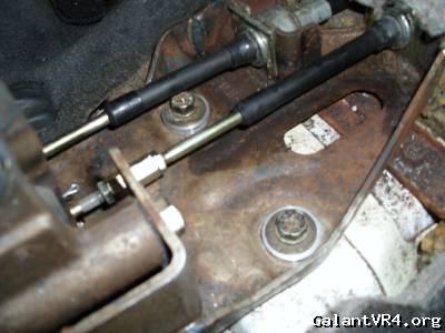

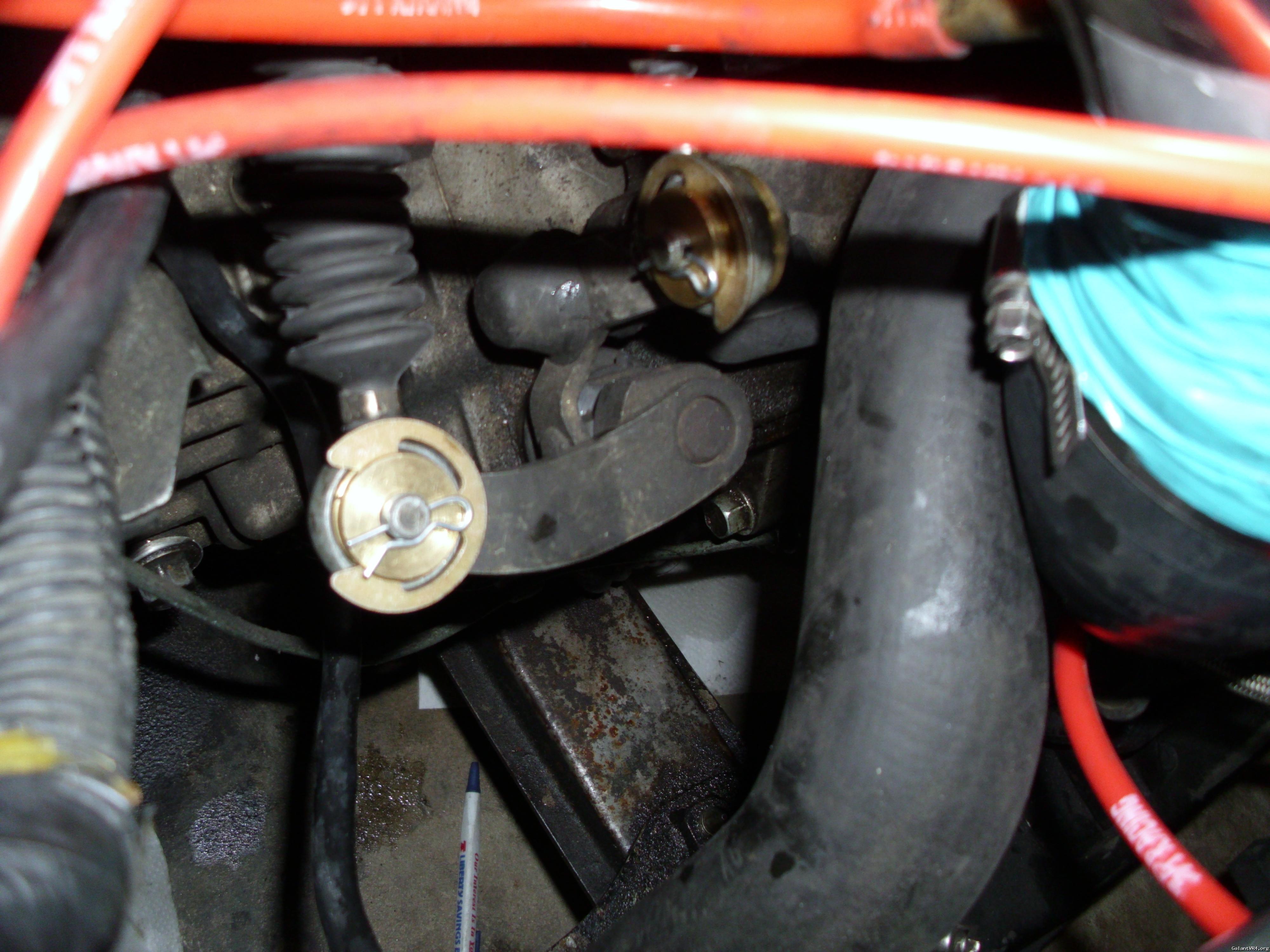

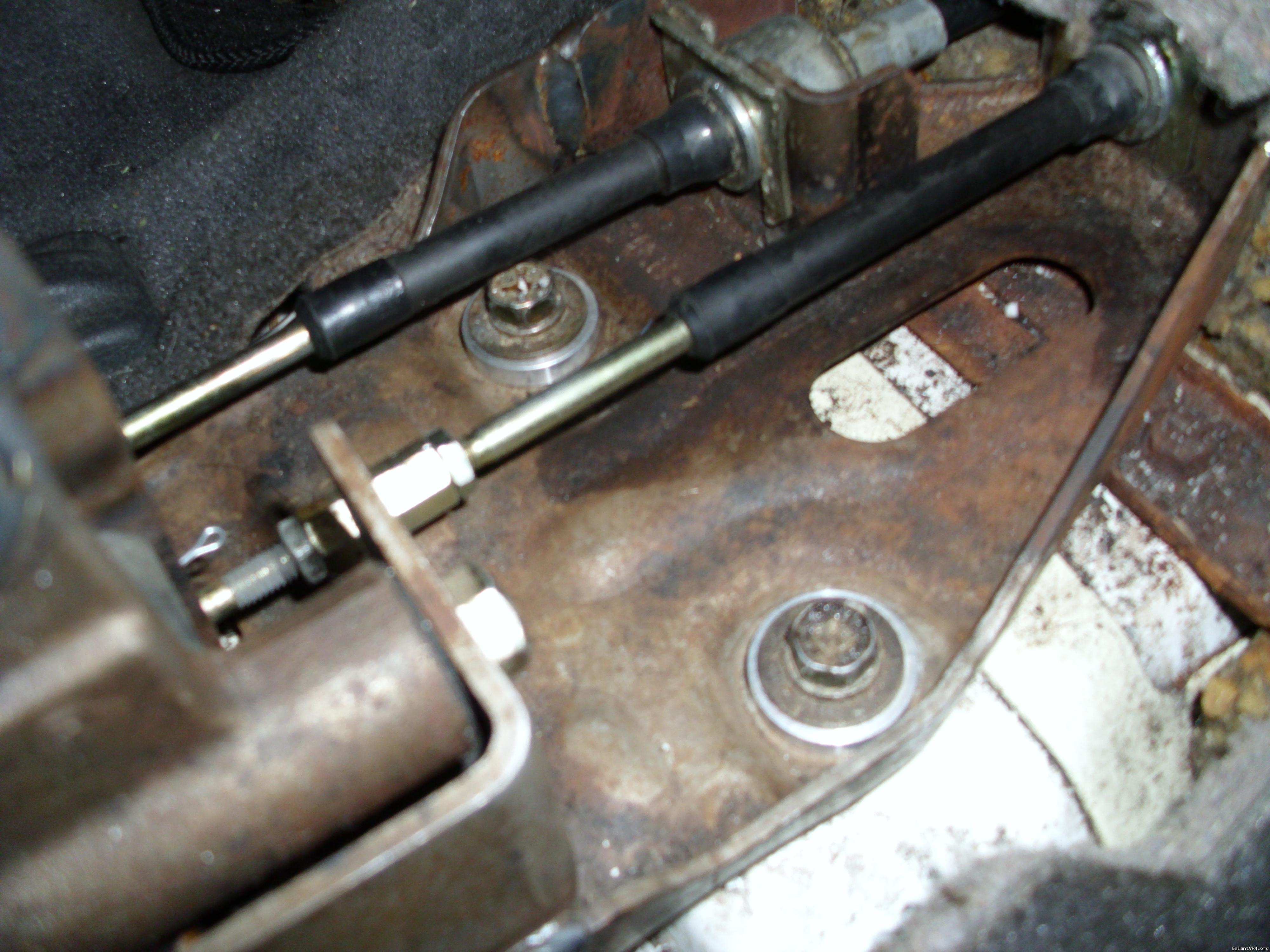

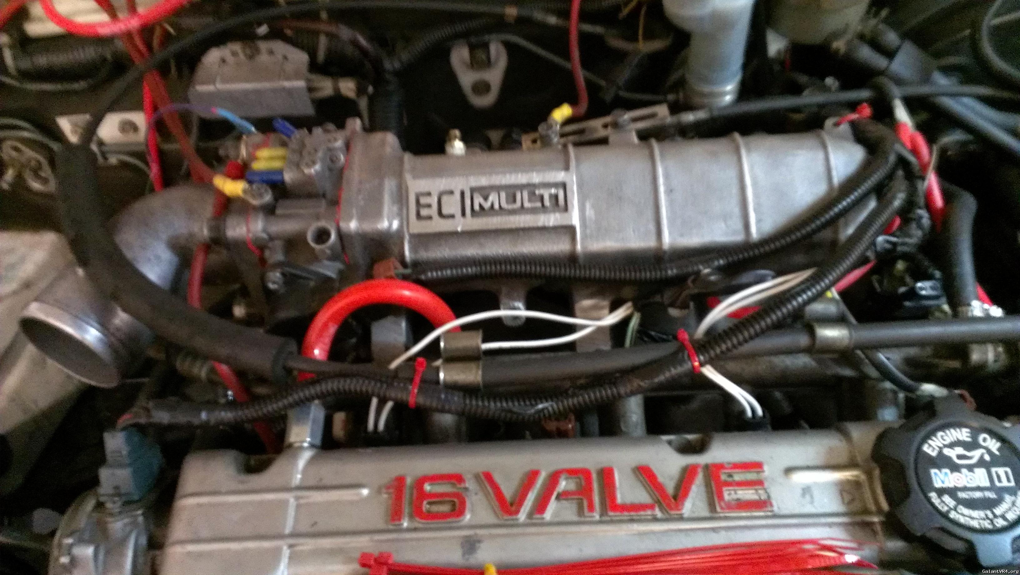

Thanks for all the kind words guys. It is pretty clean for the most part. The passenger side rear needs some work as its kinda crunched. Got the shifter bushings all installed. Now all I need to do is fill the rear diff and flush the coolant. Then some cleaning. Got a few more pics.

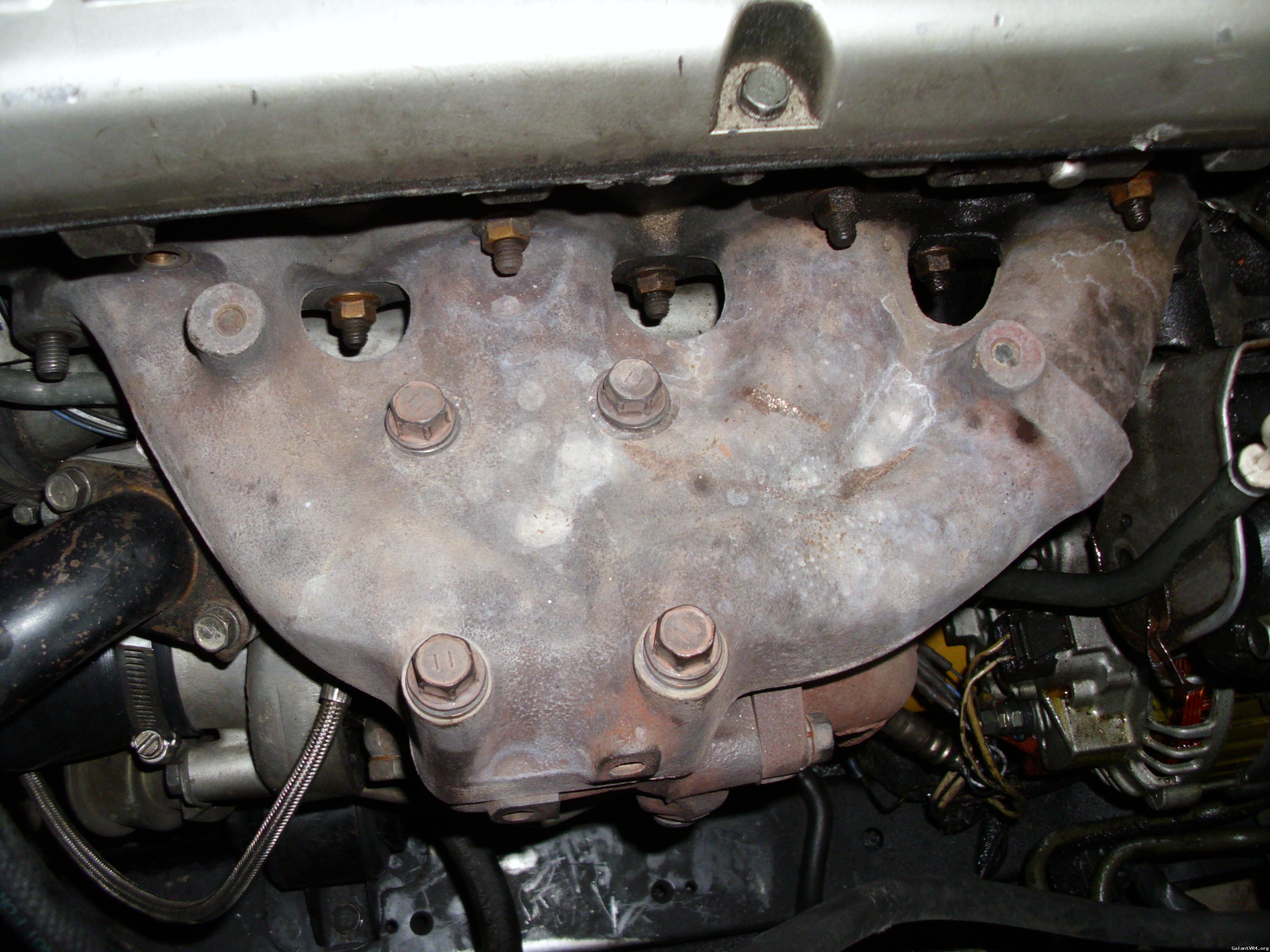

2g manifold?

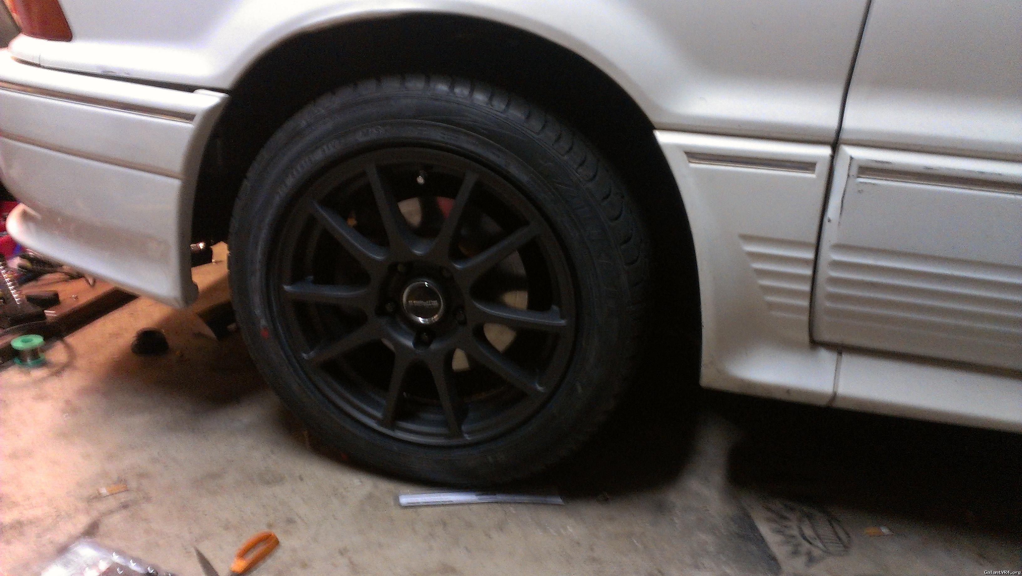

Got a bunch of stuff ordered and waiting to install. Got a front mount, maft with a maf, and a nice fuel rail with -6an in/out. Also replaced the evo wheels with some nice 16s. And some evo 8 struts with hotchkis lowering springs. Still need to het the rears welded up. I'll get some pics up when I get my computer hooked back up, just moved to SLC, and its all packed away right now.

Welcome to the site. Those are either AMG or EDM corners and that's an Eterna grill you got there buddy, and of course 93 glass headlights. I'll buy that grill if you don't Like it? /ubbthreads/images/graemlins/devil.gif

Sorry, think I'm gonna have to hold onto the grill for now. /ubbthreads/images/graemlins/smile.gif I love the way the front of the car looks, now if I could just find some foglights to put on it. Then I can call it good on the front end.

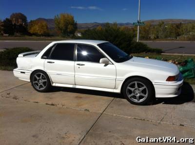

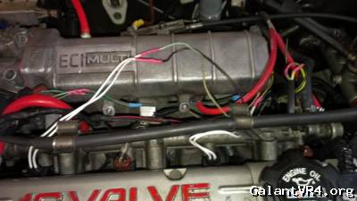

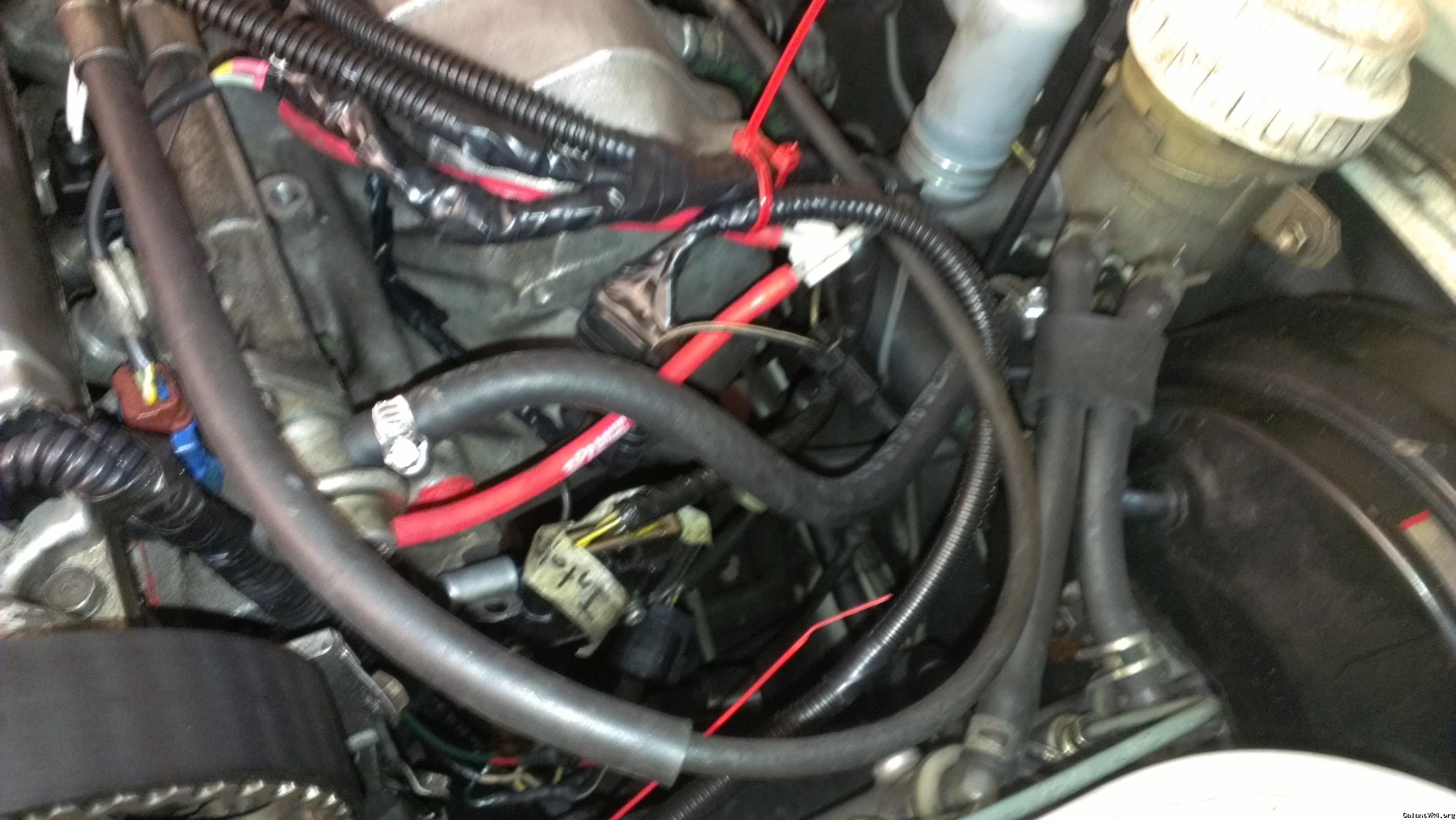

A few more pics. Got some more of the wiring cleaned up. rewired asnd rerouted the o2 sensor harness, The new wheels and a few random pics of the car at red rocks right before I left CO. I'll get some pics of the new parts I need to install soon.

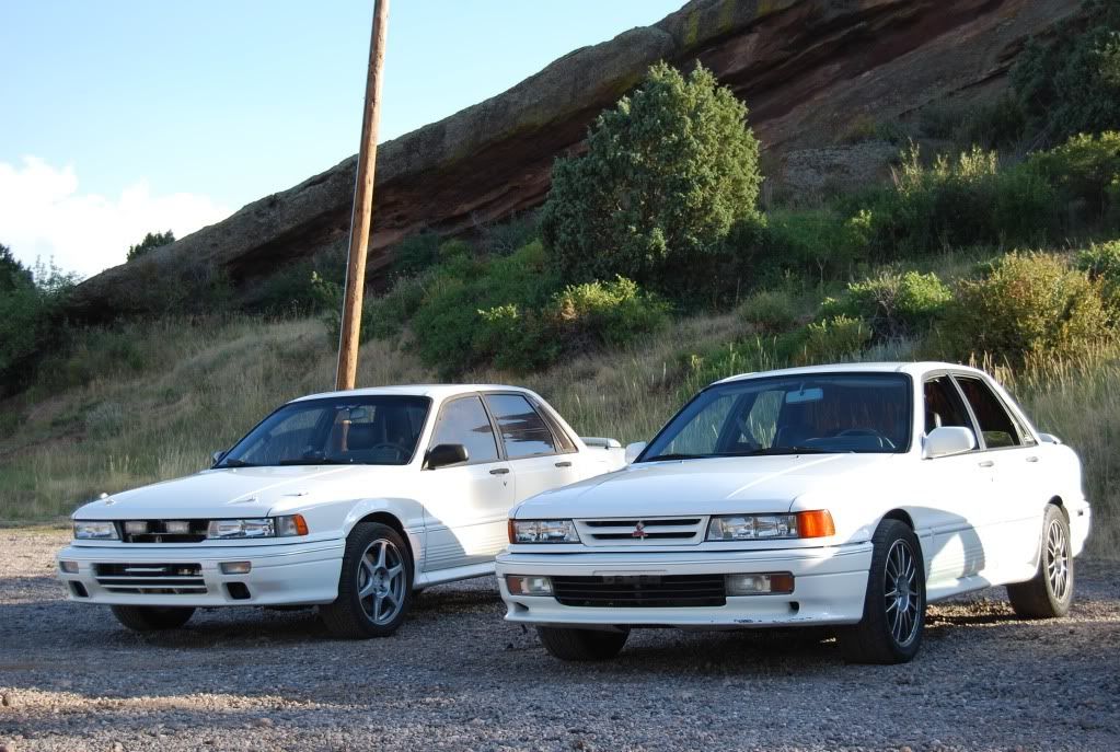

I used to own this car a while back. Funny that I have a pic of it at red rocks also. Here's when I had it and before it got the rear quarter damage from one of the many owners after me.

And in the same parking lot at red rocks to boot. I really hope one day to have it back at the level of awesome you had it. I can tell you this much, if you saw the shape its in now you'd be pretty disappointed. I've done enough to it to make it drivable, but it still needs tons of work. The guy I bought if from said he bought it as a shell, and it looks to me that he just threw it together enough to sell it.
The entire wiring harness is trashed, from the ecu out to the headlights. So many cuts and splices it's not even funny. The body is still fairly straight minus Tue rear quarter. The trans mount was missing the through bolt as was the front motor mount. The front struts were missing the nuts that attach it to the knuckle. All four mounts were completely thrashed. The front struts were so blown it would bottom out ok every bump I hit,likely due to the front springs being cut. The interior is pretty shot too, all the seats are torn up. The battery was tied to the strut tower with some 10 gauge wire. The abs sensors were all cut and ziptied insider the fender wells. And the list goes on and on. But I just couldn't pass it up for the price.
But seeing your pics shows me the potential the car has. I know it can be nice again, just gonna take a little time and a lot of money. I plan on doing it up right.
