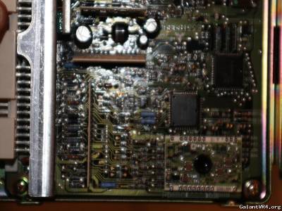

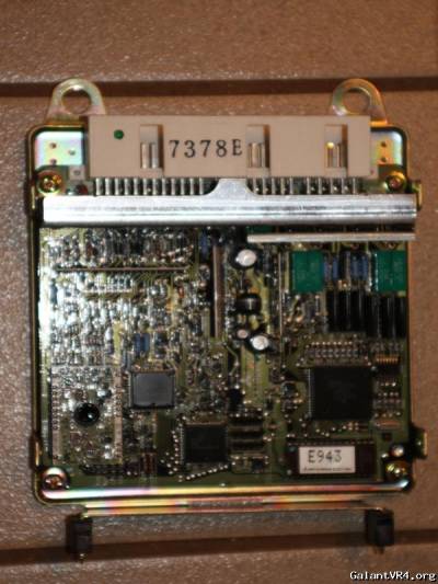

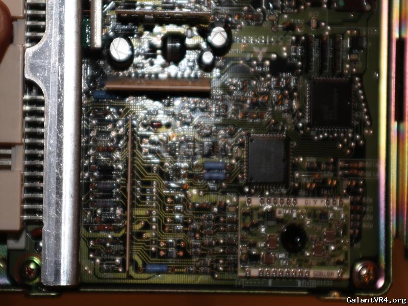

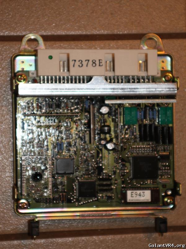

Nice find! Make sure the plug wires are on correctly too. I would start with the simple/cheap things regarding troubleshooting. I'll bet you have that thing running for less than $100!
Oh, and in case nobody mentioned it, check the 3 capacitors that go bad on the ECU! /ubbthreads/images/graemlins/grin.gif

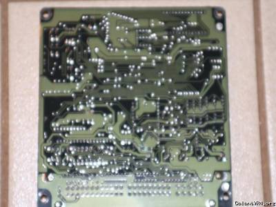

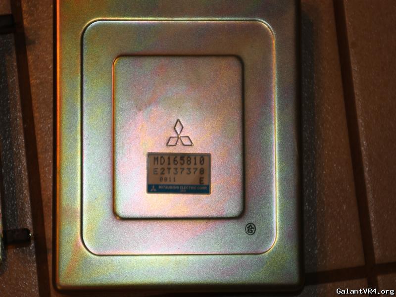

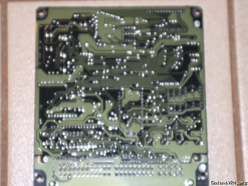

I pulled the ECU today. I lucked out I think - it's an eprom! **EDIT - I guess all VR4s have eproms LOL ** It looks brand new, no leaking, no marks on the board, nothing. I had a rebuilt eprom a couple years ago for my GSX and it was as clean this one is.
