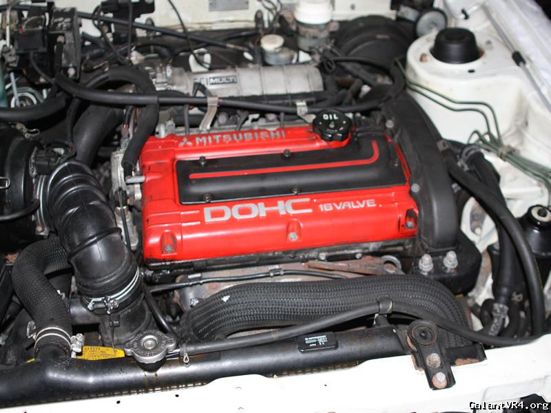

Great color and that engine bay looks very clean. No typical tire shine sprayed everywhere to give the illusion of clean either. /ubbthreads/images/graemlins/grin.gif
