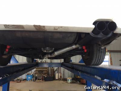

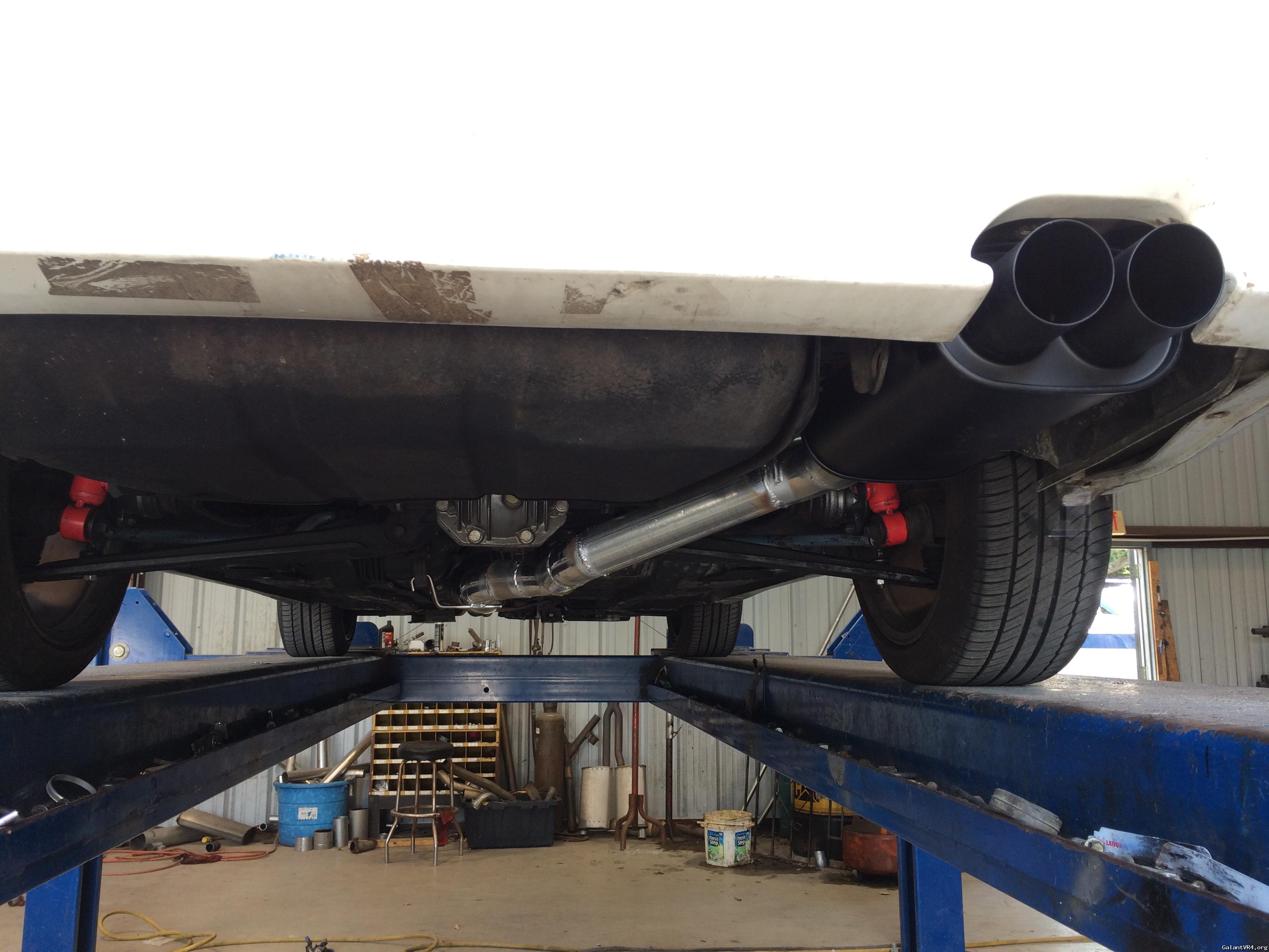

I also used the Vibrant muffler you are mentioned with an 18" (i think) vibrant resonator. Full 3" from turbo back. Running a recirculated wastegate with a bastard 20g. It's much quieter than the magnaflow I removed.
Here's a pic of when I was installing it. You do have to get crafty with muffler mounting though. The tips are much shorter than the stock setup, so the muffler has to be pushed farther back towards the rear to work. I used mandrel bent 45* bends and a 6' piece of straight pipe to complete the exhaust.

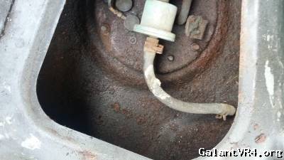

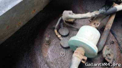

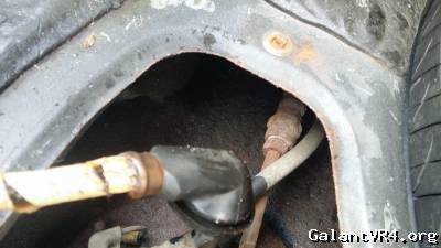

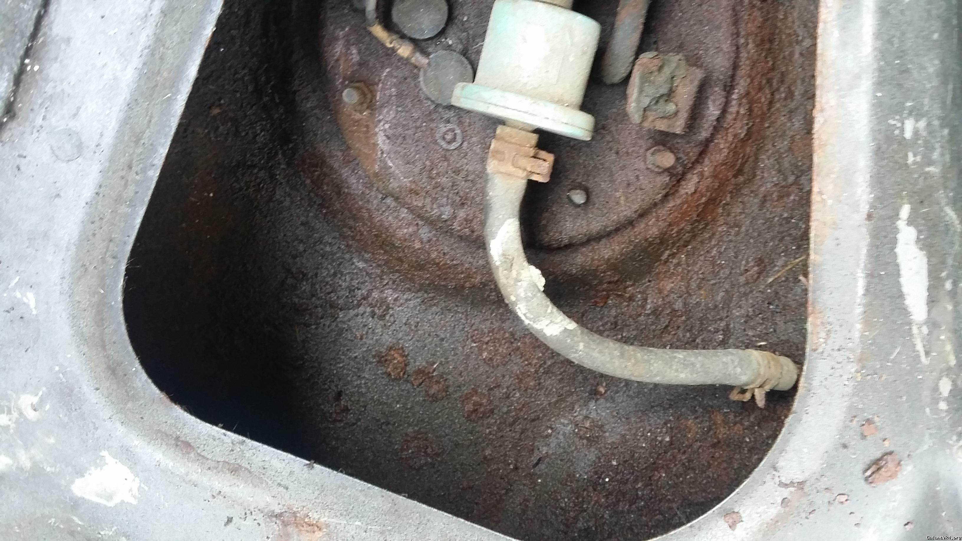

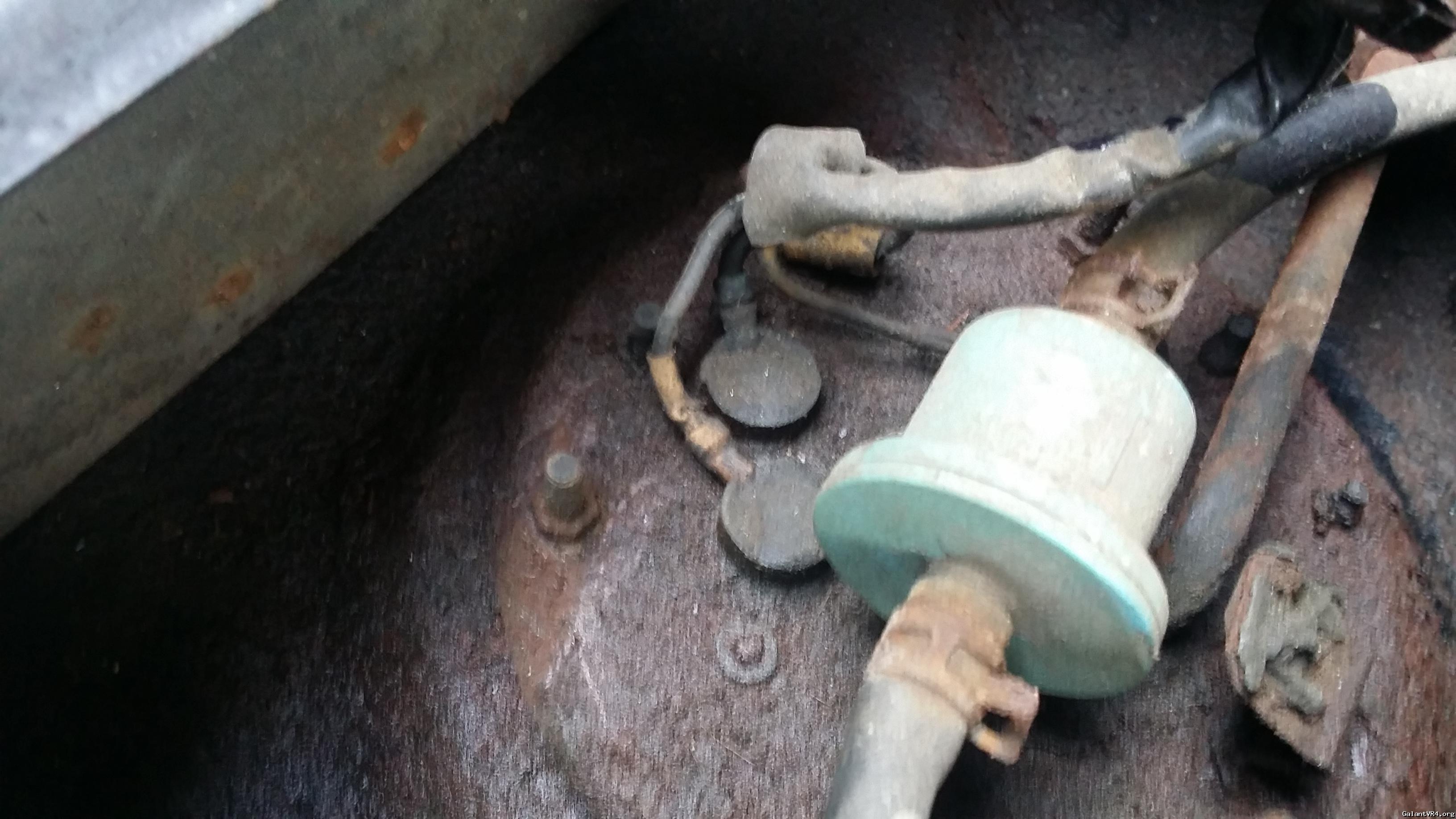

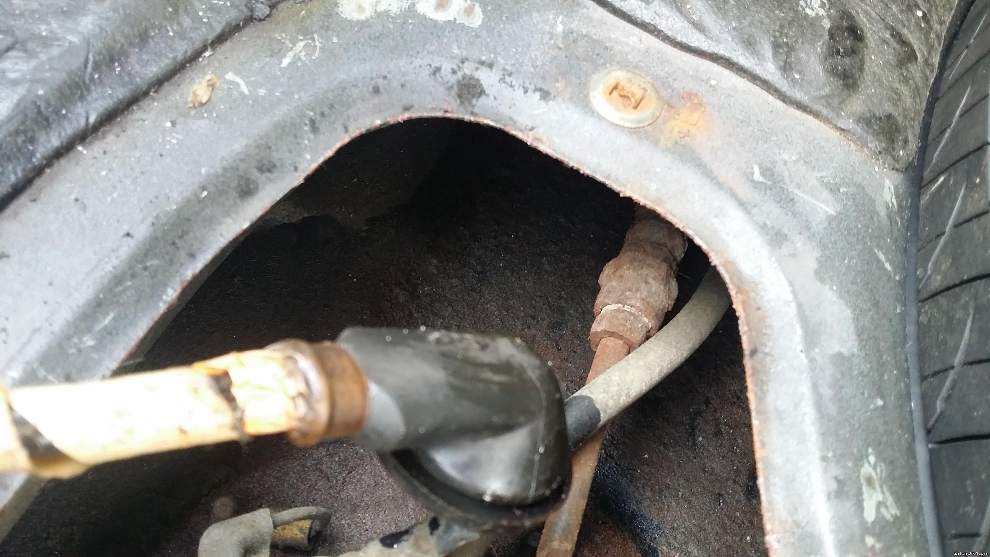

I just discovered fuel odor from the trunk seems like the sending unit has never been taken out I see a lot of fuel seepage around sending unit is that common on gv4? will 1g DSM sending unit fit the Galant vr4?seems like my original is rusted here is some photos any help will be appreciated if anybody has a good sending unit I will buy it Thanks

DSM Sending unit is too tall. There is a way to shorten it (there is a writeup on the for it) or you can find a used one. I think someone has one for sale on here. Soak the crap out of those 8mm nuts and studs with PB Blaster, they love to snap off

I have two sending units. One for $50 that needs a bulkhead for the feed line, and one really nice one for $150 with a Walbro 255 pump
3,479
That sending unit looks mint compared to others I've seen. It would probably clean up just fine with a wire brush and some TLC. Soak the little 8mm bolts in PB blaster or something a few times before you try and remove them. The toughest part is always getting the line fitting to loosen up without twisting the metal.

I can pull it and take a pic tomorrow. I has some surface rust, but sealed fine
