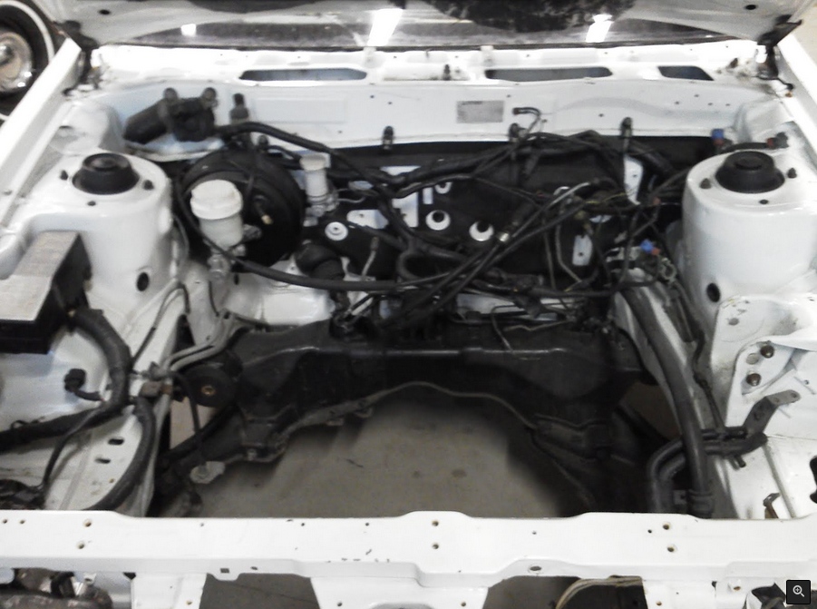

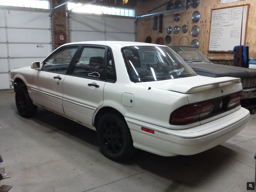

So - Then there is the VR4. You may recognize it as well because it has been around the block (and the entire United States!). It is 1991 #1803. The white one with the partial right hand drive swap. Sadly, it is missing the RHD door panels, console, all the HVAC stuff, parts of the dashboard, etc. So like I said, I'm not entirely sure of what I will do with it from here. The good news is that it doesn't have rust, so that is always nice. Here is what it currently looks like.
So - Anybody got any of the original parts from this thing? Old pictures of it (other than the ones in the old FS thread) or interesting history about it? I would love to know more about it.

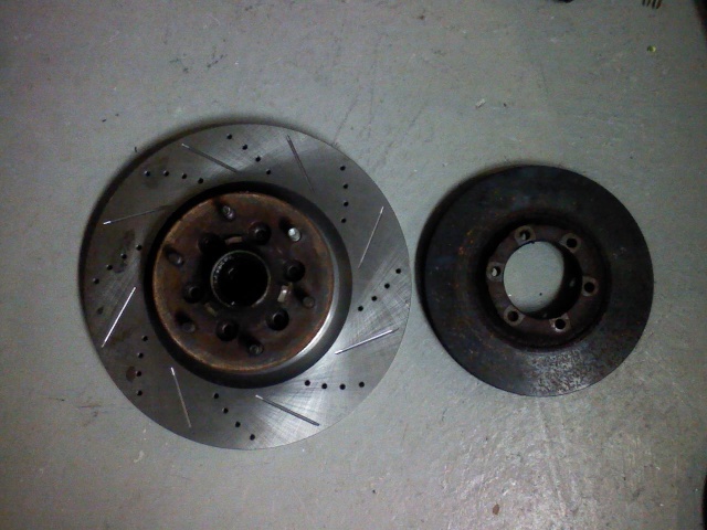

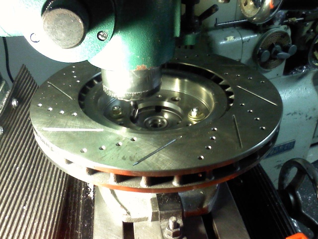

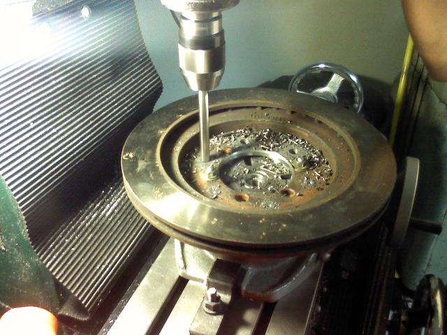

Yes, the Mightymax's, Ram 50's, Escalade's, Viper, and CTS-V's are all 6-lug. Unfortunately they aren't all the same bolt pattern. The other problem was that the mightymax/Ram 50 front brake rotors bolt onto the back of the hub, and the rear came with drum brakes, so the update was a bit complicated, as you can see...
Boring the center of the front CTS-V rotors...
Drilling the new holes in the Viper rear rotors
Ta-da! CTS-V front rotor bolted to the stock hub vs. stock Ram rotor. Overkilled it slightly, I know. Looking back, I would have done it differently.
