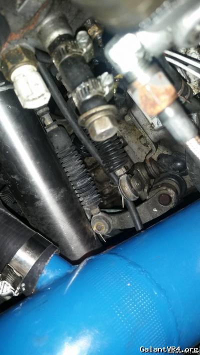

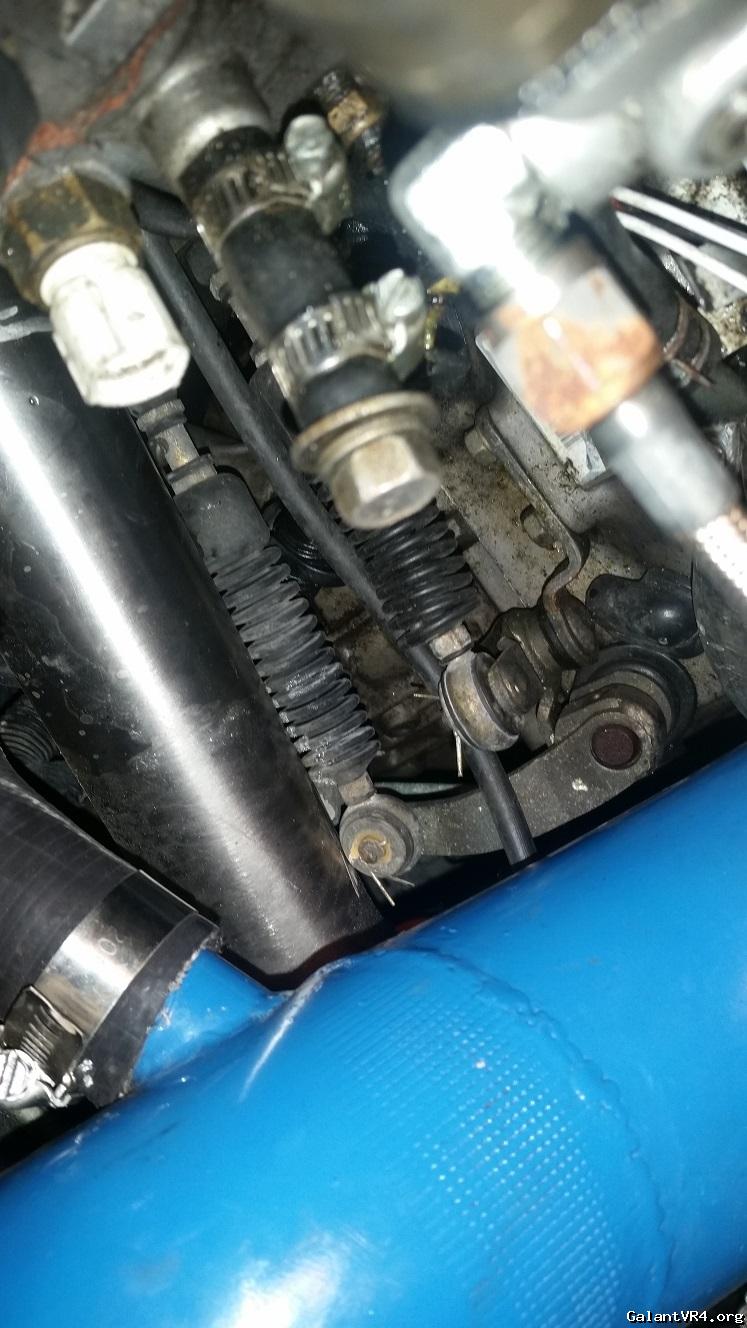

yes i did! got the ets front mount for it and finally got it running good today! On the last test run shifter stuck into gear and i had to ride back in first /ubbthreads/images/graemlins/frown.gif anyone know if there's a kit that relocates the shifter cables or are my shifter cables bad? it seems as if the front mount pipe (2" pipe on ets) is interfering with the cables and today was the day it decided to give up.. If anyone has any feedback on this i would greatly appreciate some direction. I guess i might need to make a new thread on this huh haha.

No relocation kit that I know of. You have to just correct the interference.

do you think a throttle body spacer would give me the clearance? also which tb space is good? P2R is the only one i found so far. thanks for the reply!

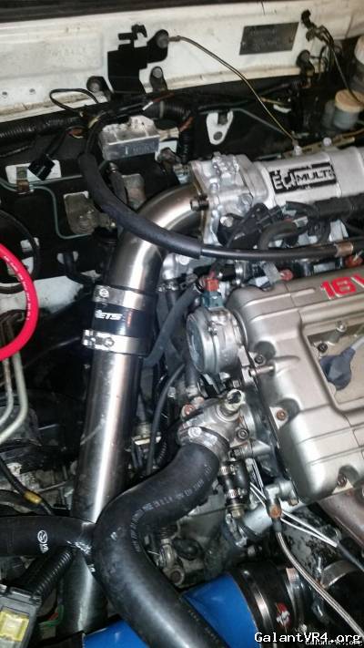

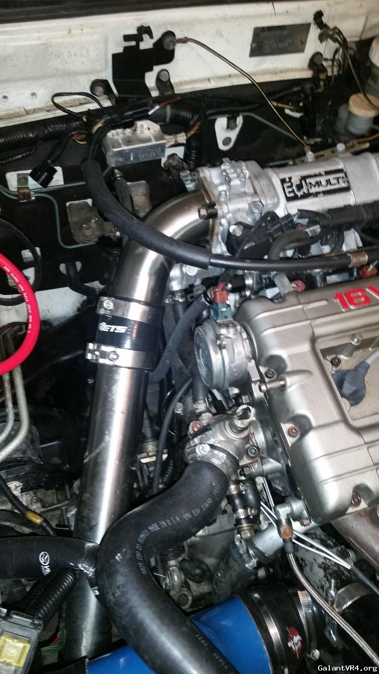

Welcome. THIS picture from ETS website shows plenty of clearance. Notice the blue coupling they are using is longer than yours, which appears to move the other pipe further west. Maybe you can loosen the coupling to adjust the two pipes enough to give you the .25" you need to clear the shifter. If you have one, a slightly longer coupling should do the trick.

i feel like my initial bend coming out of the tb is a lot steeper angle than that pipe is. all the pipes are super tight right there. its almost pipe to pipe if that makes sense. i will try to adjust some more but i did order a throttle body spacer from power rev racing i hope it doesn't give any extra troubles haha

I see what you mean, though the angles of the pictures are different. Did you just pick up that kit from ETS? If so, I would send them a picture and ask if they can explain why when the two pipes are connected the one is right up against the shift arm. It is possible they got the flange angle wrong when they welded the TB piece. Never saw that issue with these kits before.
