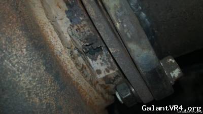

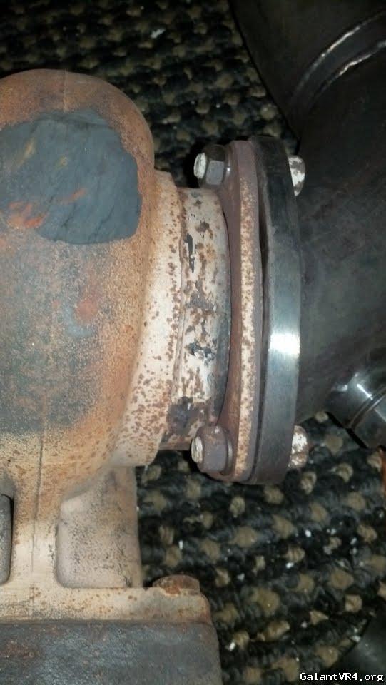

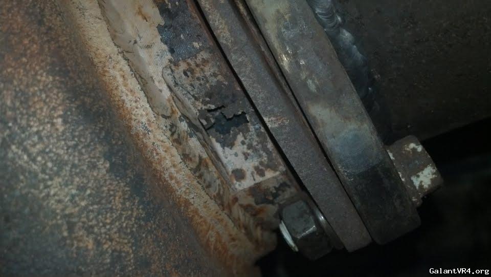

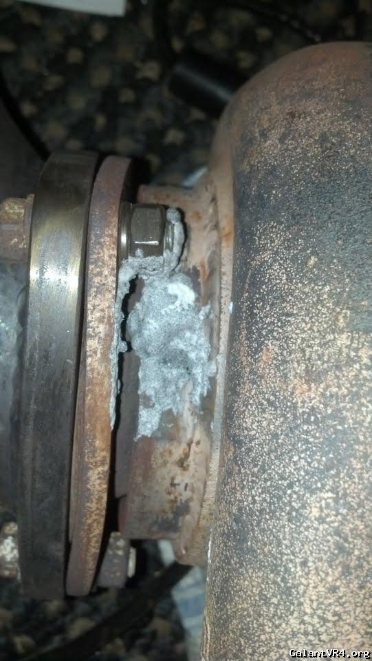

Think I might have figured out the source of my problems.
Two more holes on the turbo. I posted up a pic of the first one a little ways back. I did a quick and sloppy patch job with some high temp cold weld.
It isnt pretty but I wanted to see if that would fix my issue. I was planning on cleaning it up and making it pretty if it did fix my issues. It didnt. So today I pulled the turbo manifold and O2 housing and found the other two holes pictured above. Lovely. So now I am in the process of putting the freshly re assembled HKS turbo kit on the car to see what happens next. If all goes well then it will stay on the car for the foreseeable future. If not, well, then Im basically fucked. Wish me luck. Leaving the frozen hell of the North in just over a week. Hopefully in my Galant.
