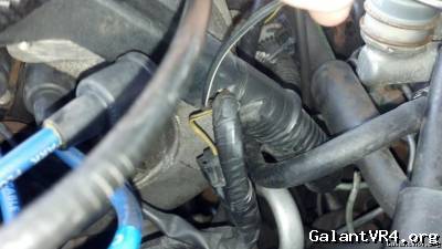

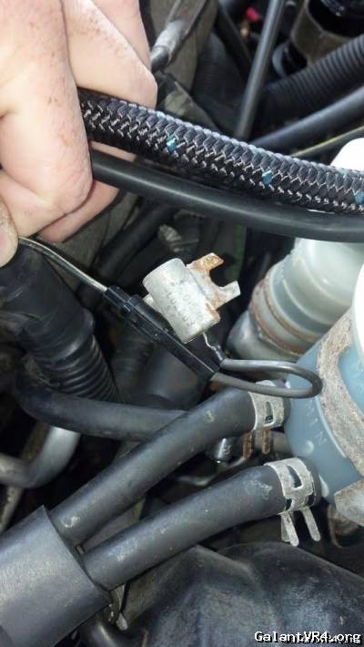

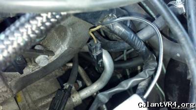

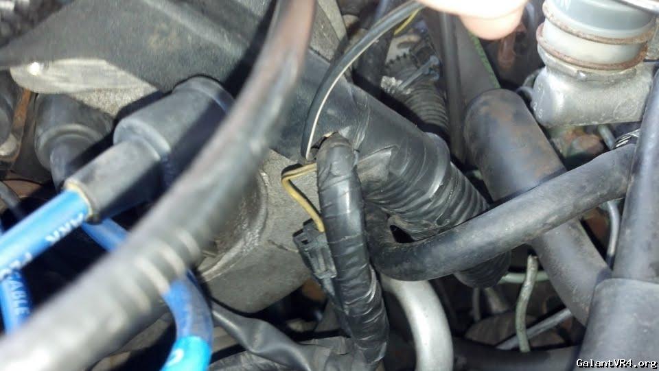

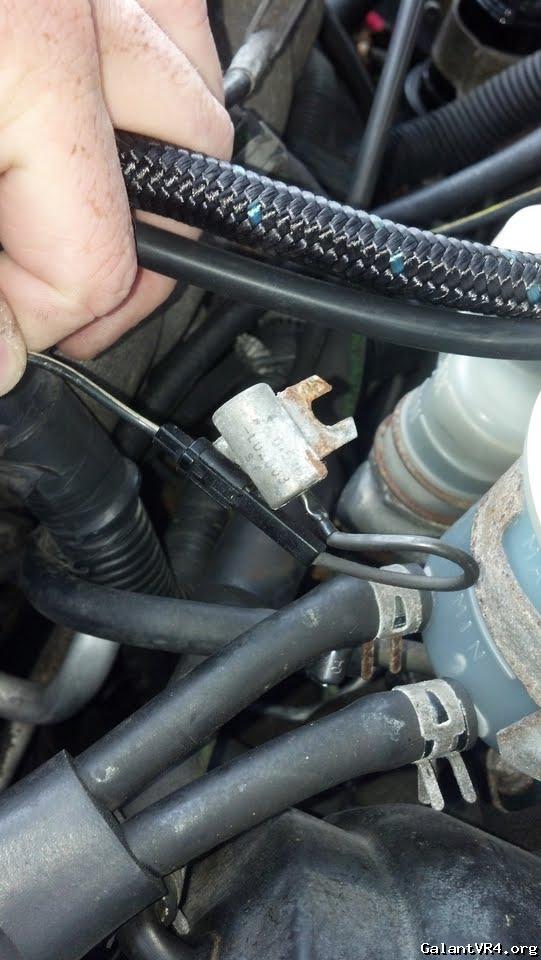

Removed transistor unit today. going to test it shortly. While I was under the hood I took a couple pics of some things I have questions about.
What does this little guy attach to? It was just hanging out.
Followed the wire into here. Not that it was super long, but still.

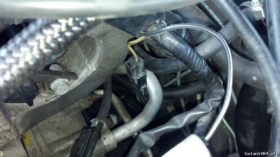

What does this connect to? Also just hanging out. I dont remember disconnecting it.

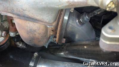

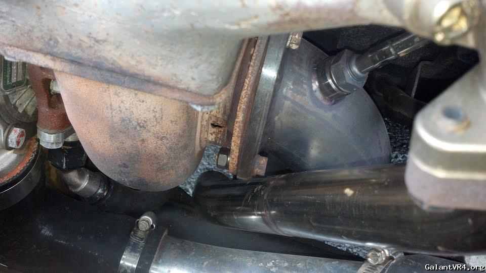

Could this be the source of all my problems? A hole on the exhaust side of the turbo before the flange and what looks to be a big space between turbo and O2 housing. Maybe cause of all issues??

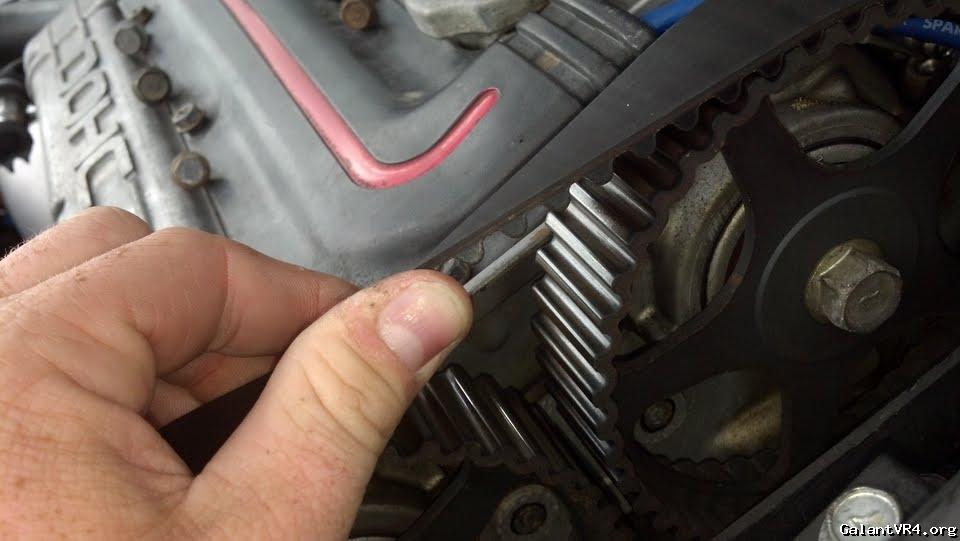

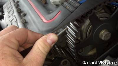

How tight is the timing belt supposed to be? Are you supposed to have a bit of slack in it?

If there sillis actually a.hole.in the.exhaust.side start there..
Also that little guy in the first pic.not sure i do know i didnt remember where it.went and just.put it somewhere attached to intake mani..
Definitely if thats a hole bitch smack stm
pot
Oct 28, 2003
1,577
Fayetteville, NC
The item in the first image is the electrical noise suppressor that attaches to the intake manifold. The item in the second image I'm not so sure but it is intact. I believe it is the fuel pump test plug.
The "gap" in your turbine housing to 02 may or may not be leaking. I do not see any residue such as exhaust soot, but a surefire way to tell is to run Seafoam into a few different vacuum lines and watch for smoke.
