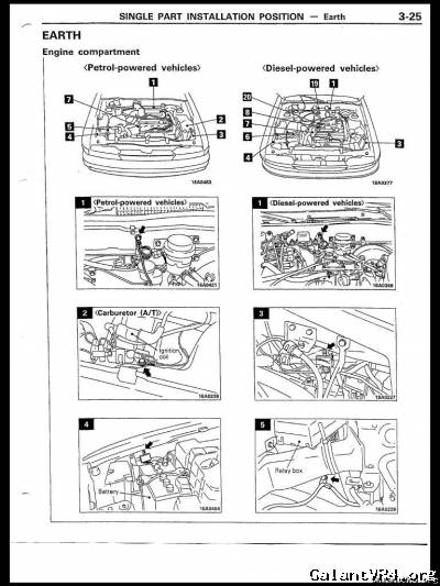

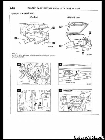

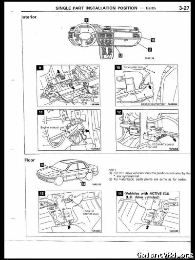

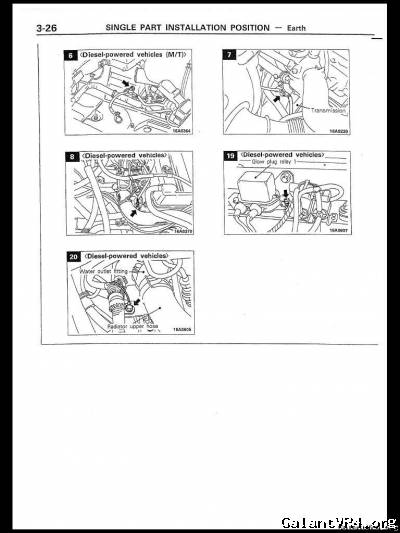

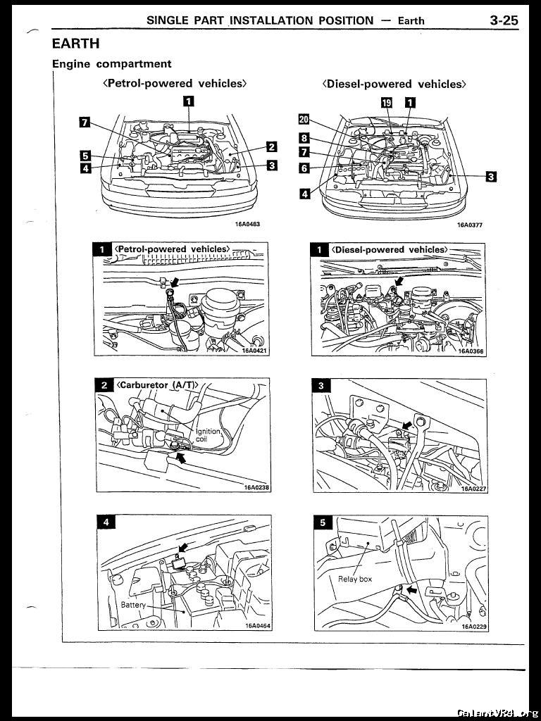

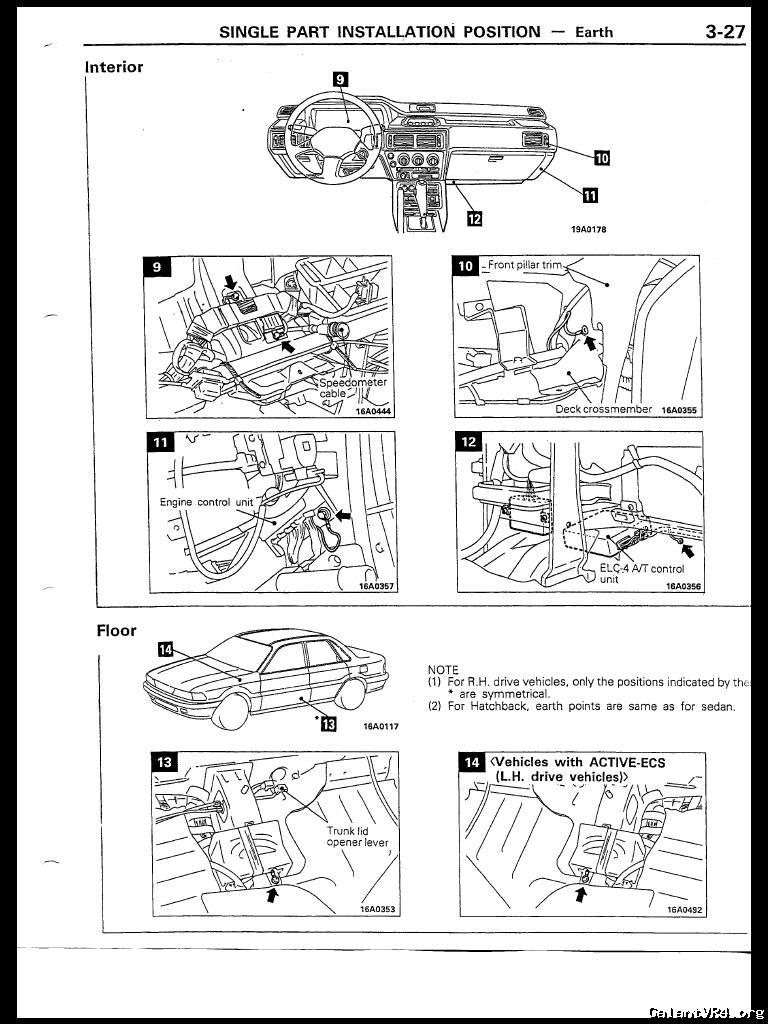

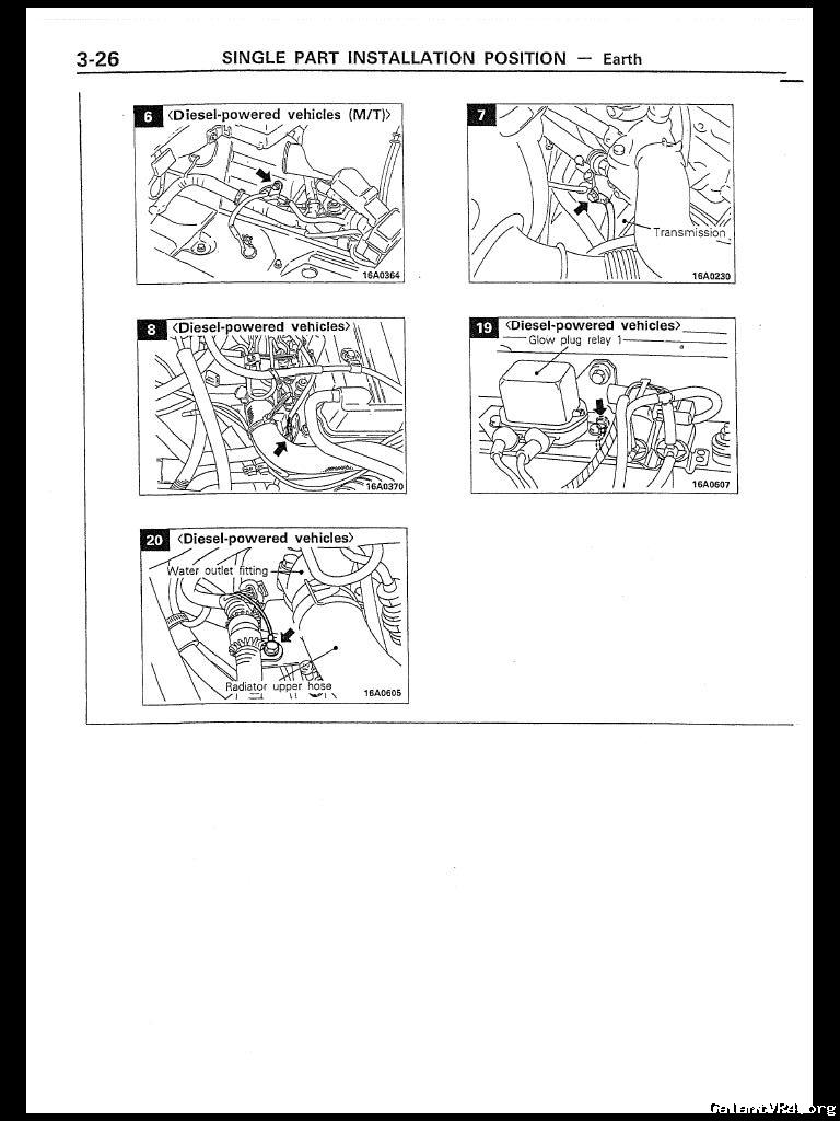

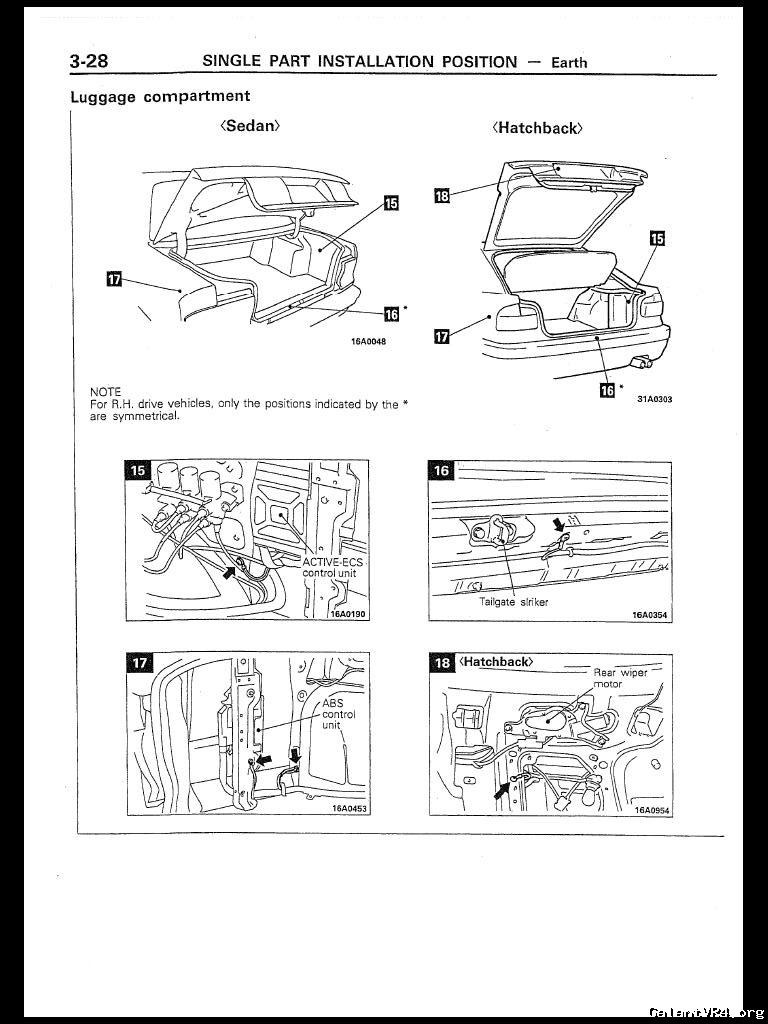

If the car was submerged during ondoy, get all the factory earth points unscrewed and cleaned up with a tap. thenn put copper grease and reassemble. you can have any earthing kit you vwant, but if the electrons can't get into the body then then you are going to have issues.
there are a bunch up in the engine bay (one either side behind the headlights in front of the arch.) hey.. i'll just post up the list from the fsm.
I had mega issuescouple of years back (our winters suck here for salt and sh*t on the road) and after 3 alternators I lost my rag and rebuilt the whole earth system.
back in a bit with the list of grounds you'll have to work through.

Quoting misterfixit:
Rich
here are the earth locations. give em a clean and go from there. Electrons don't like paint and rust!
Rich
wow thanks for this rich. will print this out and check each connection.
chris b

It's good Rich posted those pictures, because that is the best way to confirm that last links in your system. Once you have all the grounds sorted out and have determined that the car is otherwise sound in all shapes and fashion (alternator, etc) then look into some lighting changes if you are interested. I don't honestly know what your car would look like with led's install into the spots where the factory exterior lights would go, but if you want bright lights and less current draw at all times, LEDS's are the way to go. Downside to LED's is no temperature to melt off ICE on light housings, or keep moisture from building up in lenses. Upside to LED's is that they use mA versus A's on whatever circuit they are plugged into. The reason for getting LED's specific flasher units is because they don't present the electrical current load and the flasher will blink really fast or fail to operate properly. It is just an idea, but sort everything else out first.
