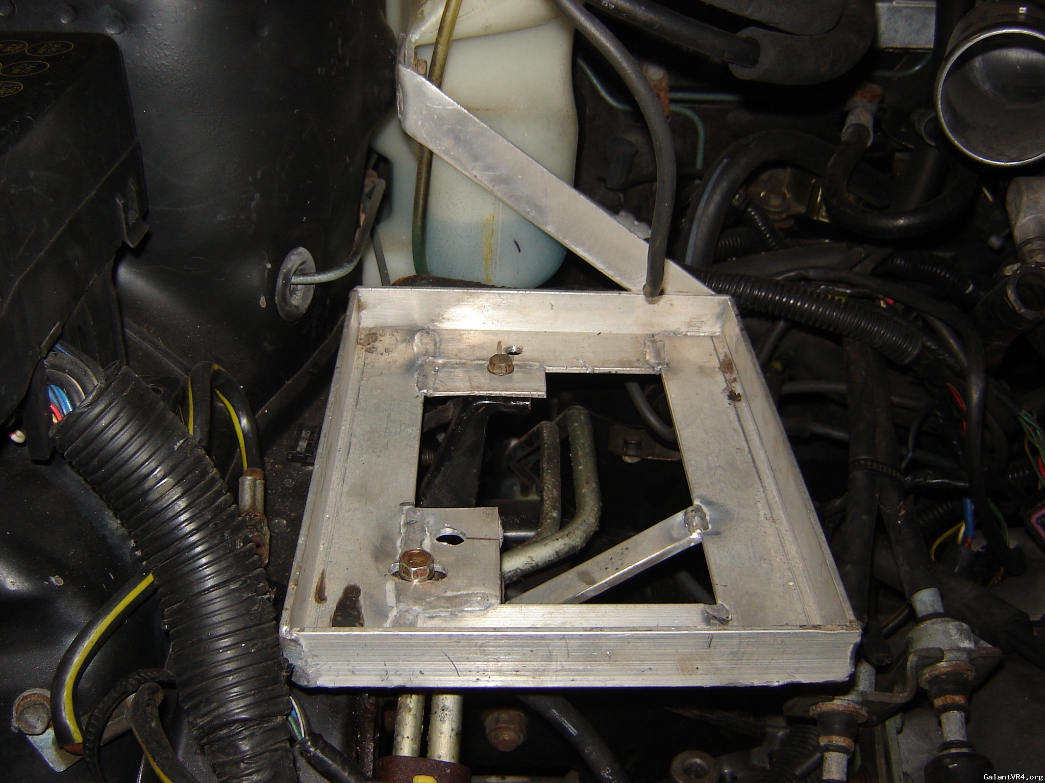

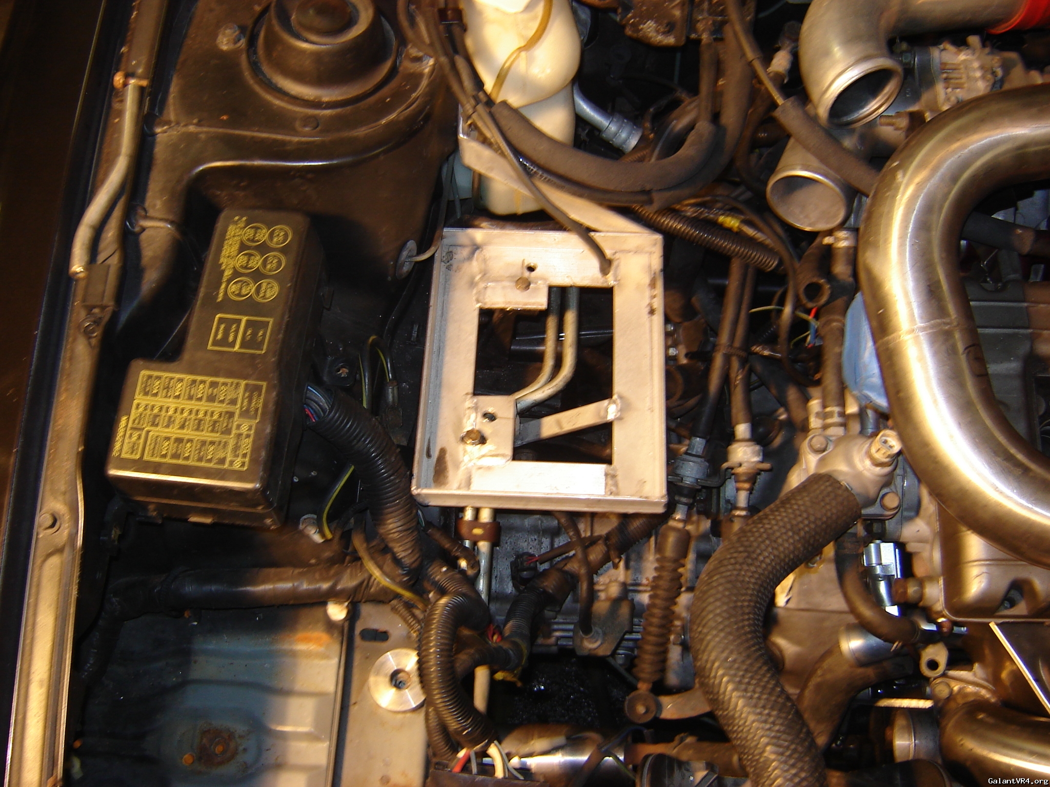

I ended up buying a Miata battery from advanced and making a bracket that set the battery on the cross member below the fuel filter. welded a few brackets to hold it and it works awesome. I also had to extend the battery cables to make it work. This allows me to run a 2g maf with a normal dejon intake pipe. I can snap some pics of you want. Ive also seen the JMF battery kit and its a nice piece if you want to go that way also, I went the cheap way.
Yeah, if you could get a pic, that would be good. Im still not set on which setup for 100%.

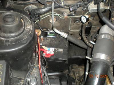

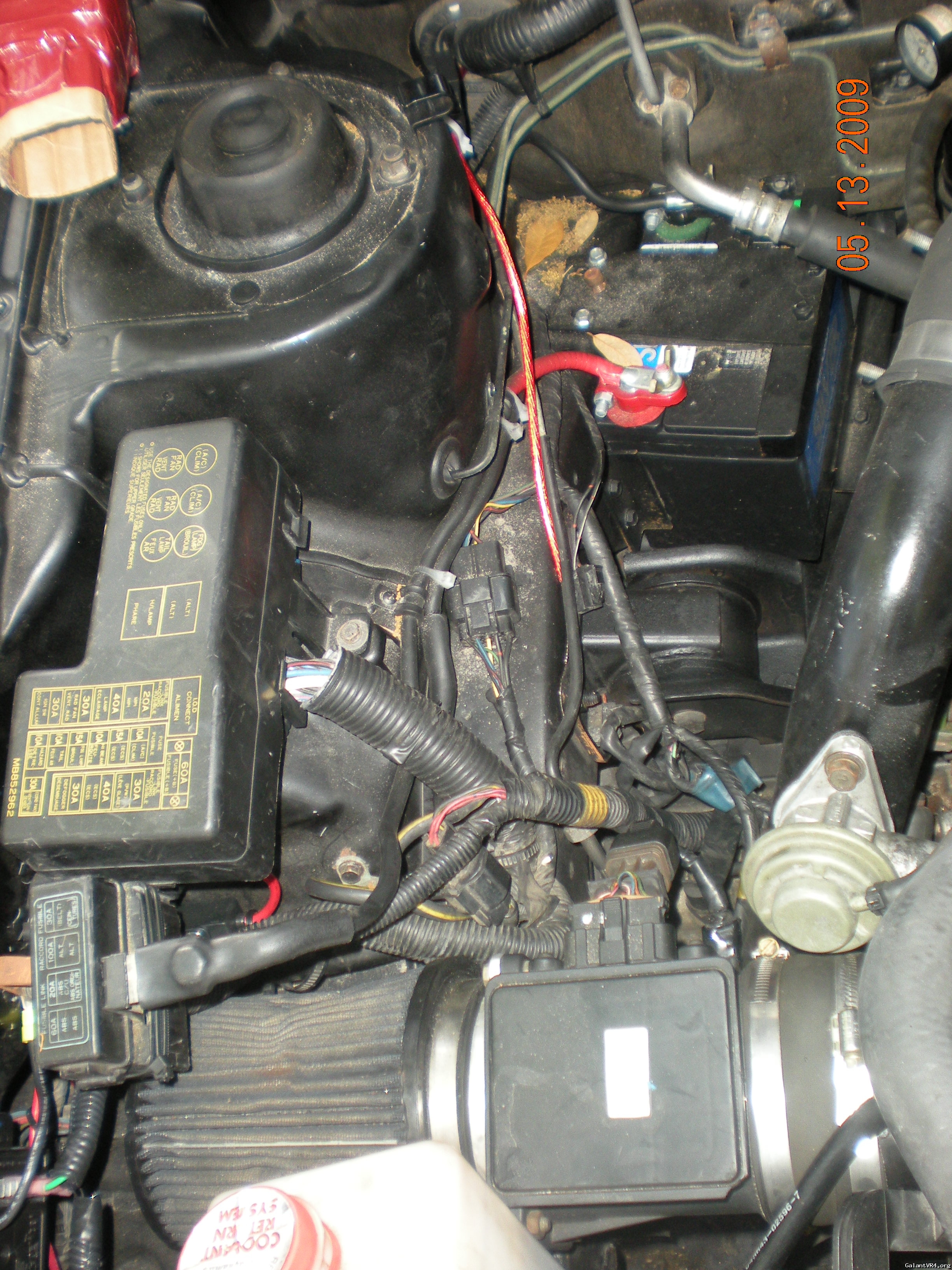

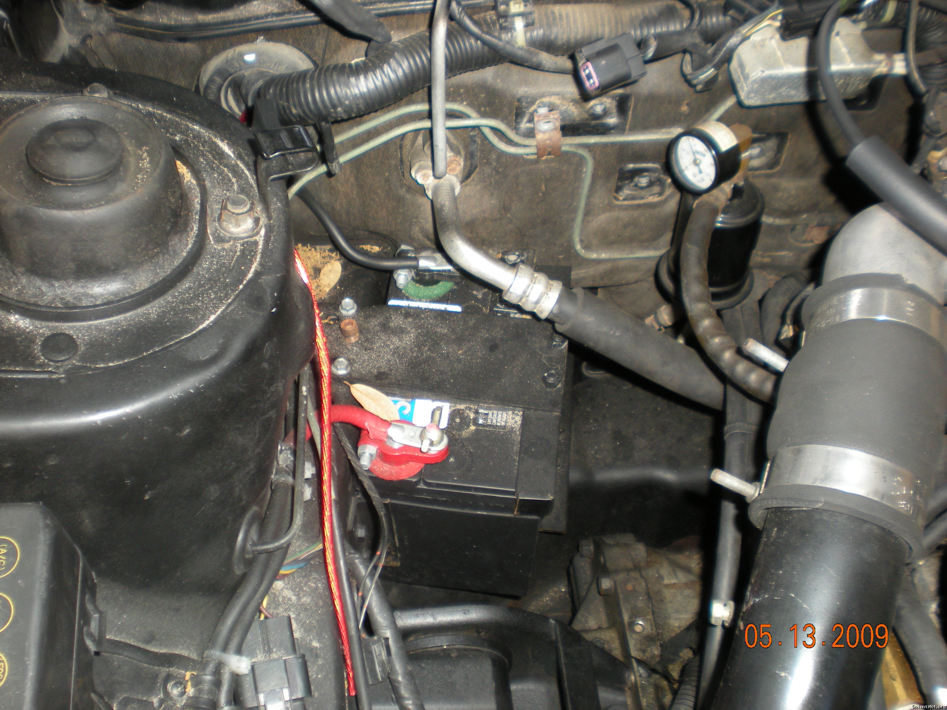

Here are the pictures of my battery setup. Hope this can help. It cleared up a TON of room for me.

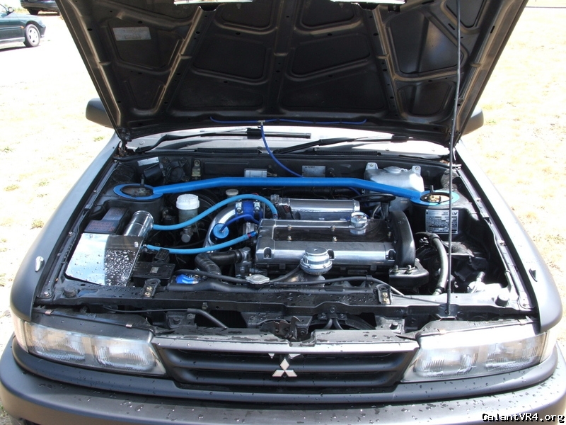

Well guys, I haven't concede'd yet, but after just seeing this picture a moment ago of supervr4's 89 ZR4, I am leaning toward the battery in the trunk. The real selling point is the fact that I just built my intake box, and it looks alot like that one, and I do like the clean looks. Hell, It almost makes me want to remove my cruise! (almost, not quite)
So, I haven't been tottally swayed, so I'll post up some pics tomorrow of what I have with the battery in the bay still and let you all see.
