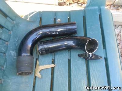

Im just going to write this off as a I f'd up. The ic is cocked because I moved the bolt next to the one i originally had it in. He said this would fix it. This made the pipe going down to the ic push it sideways.I have enough extra ic piping to fix this and there are 2 threads on the bottom I will use to make it straight. I feel that enough damage has been done to his reputation for people to see what they may potentially have to deal with. I have to size up the couplers I need this then ill order them, install and post the results. I did try talking to him to get something back. He did make the effort to sell something even though it took 6 weeks, was wrong and didnt include all the parts. Ill keep it. Its a half fmic kit lol. I asked for a partial refund and he blew up and then told me try this and that which I did. Then I sent him pics and asked to be reimbursed to at least buy the couplers and clamps he didnt send me then he stopped responding. maybe I should be refunded half idk. Im not trying to be hard with this but hes being difficult.

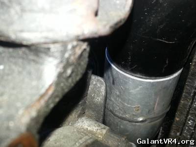

As far as the couplers go, just make sure you used the pipe OD, and the coupler ID when buying replacements. I've used these guys in the past, and they have good quality products. click

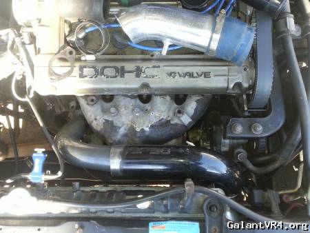

in the picture of it mounted on his car it's still crooked as f***. who would run that on their car like that

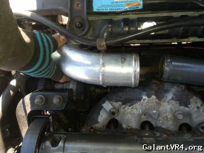

Based on the first pic I'd say that pipe is sitting way too high. I wouldn't even expect it to clear the hood. Whether that's a result of the core being tilted or not, you gotta address that.

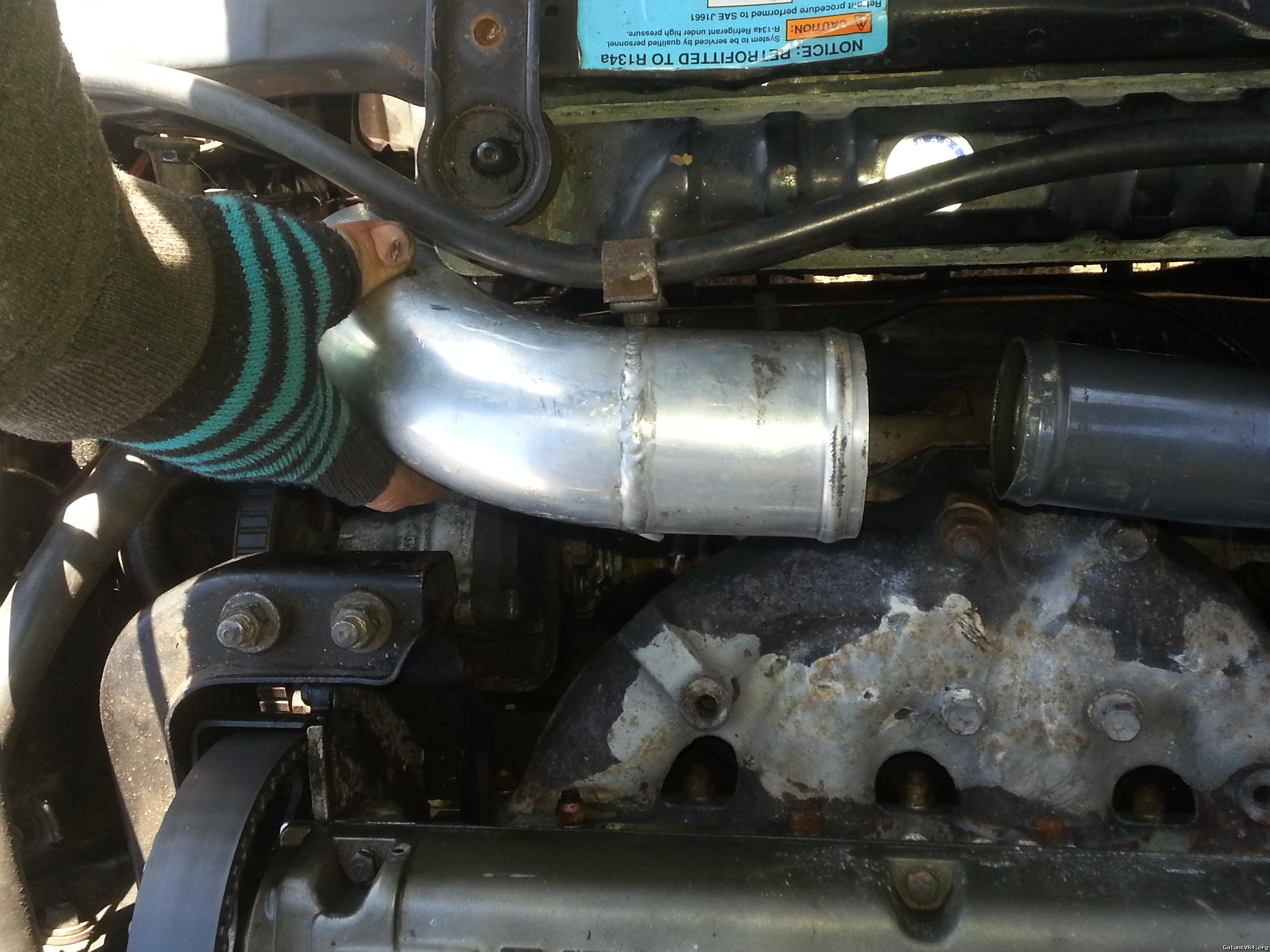

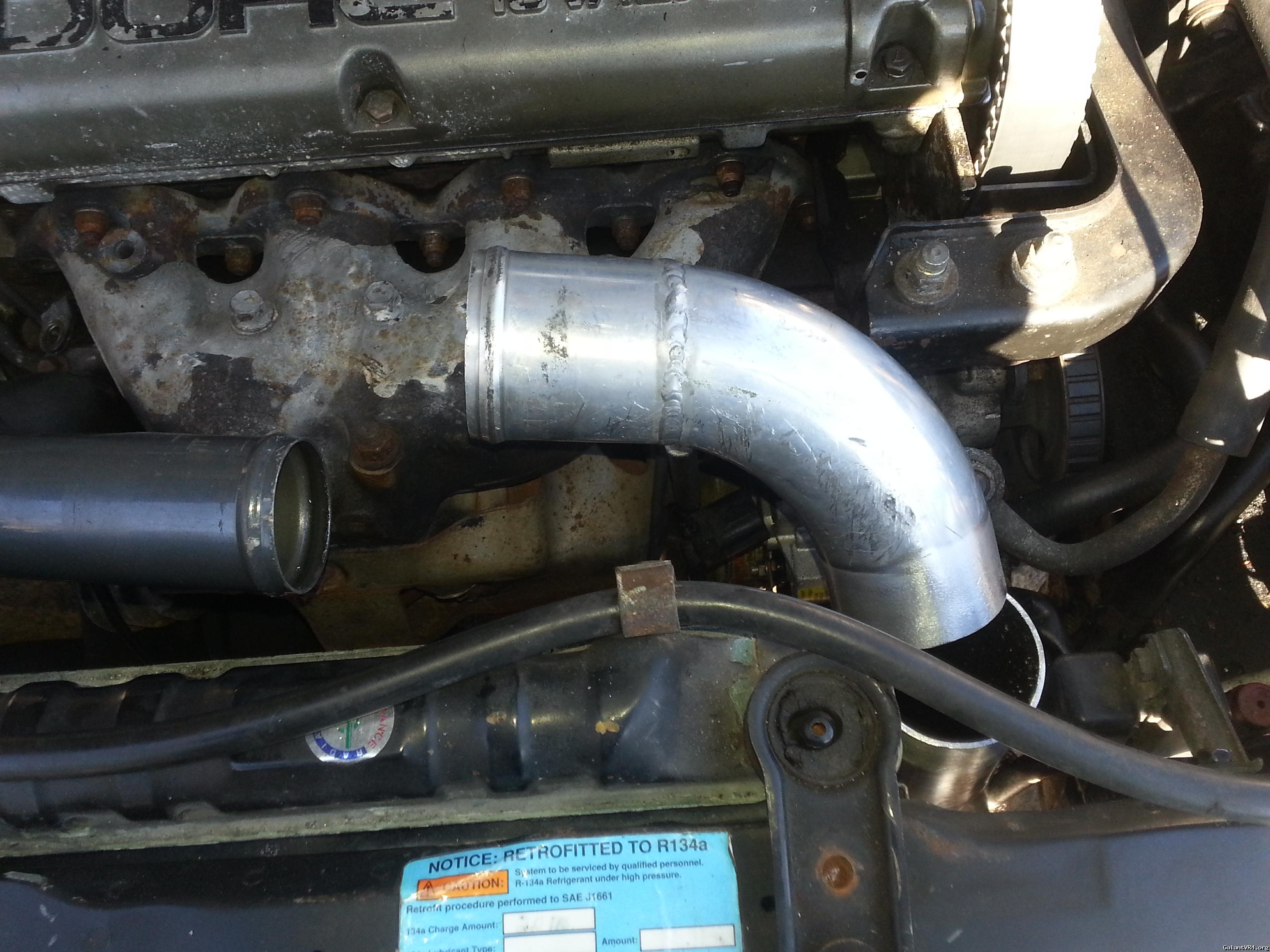

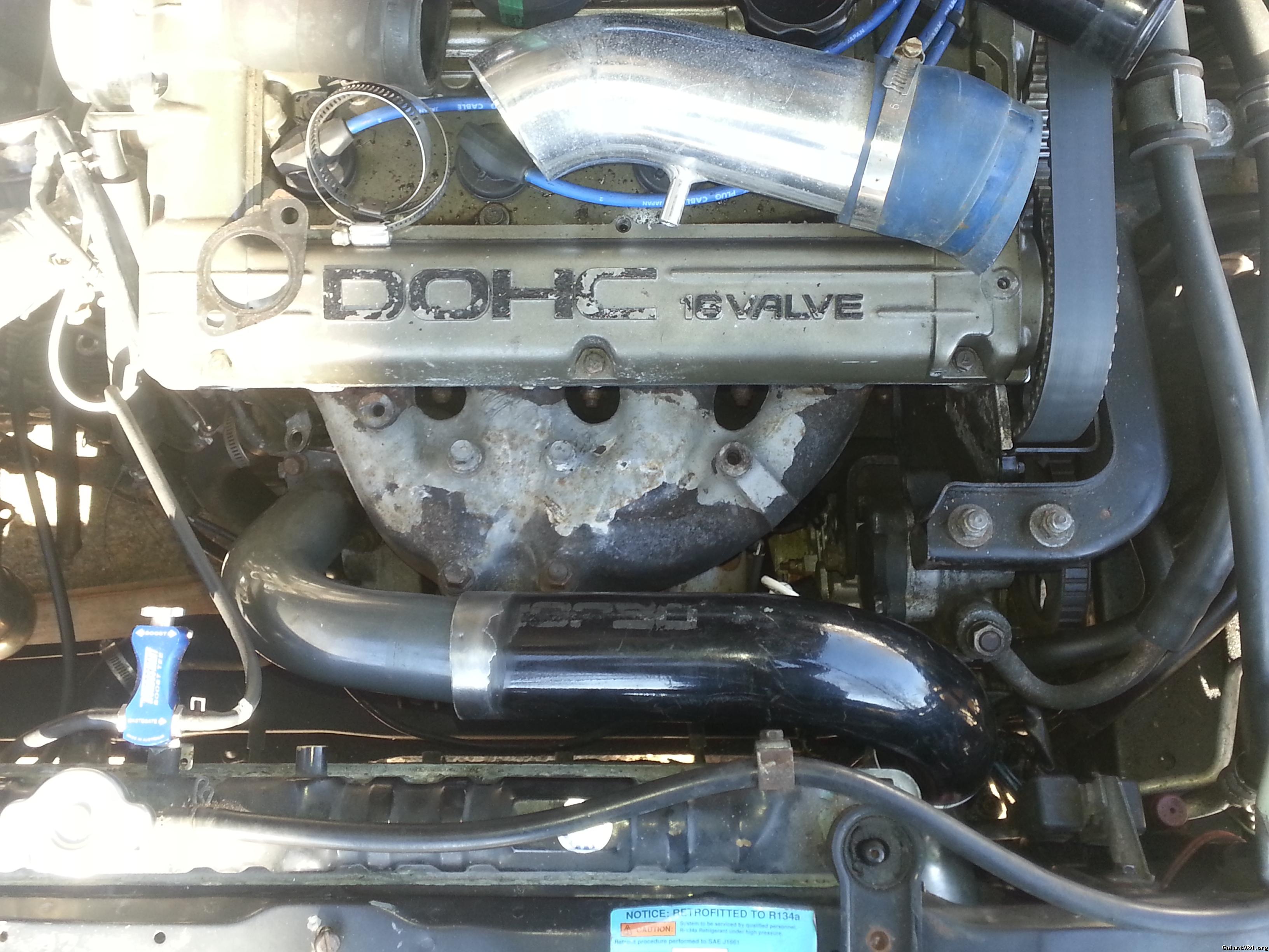

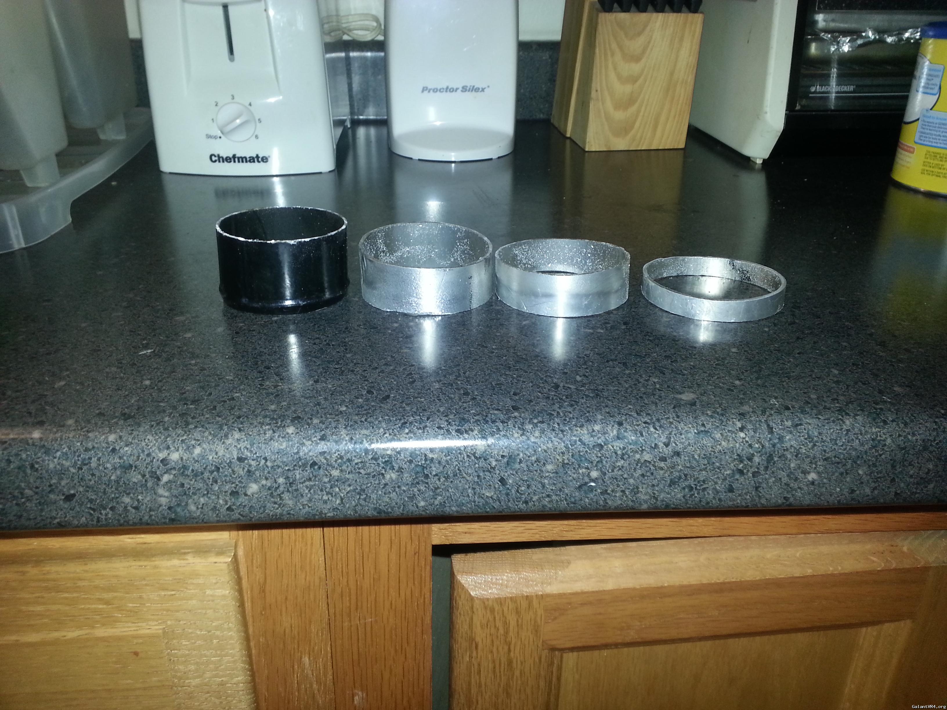

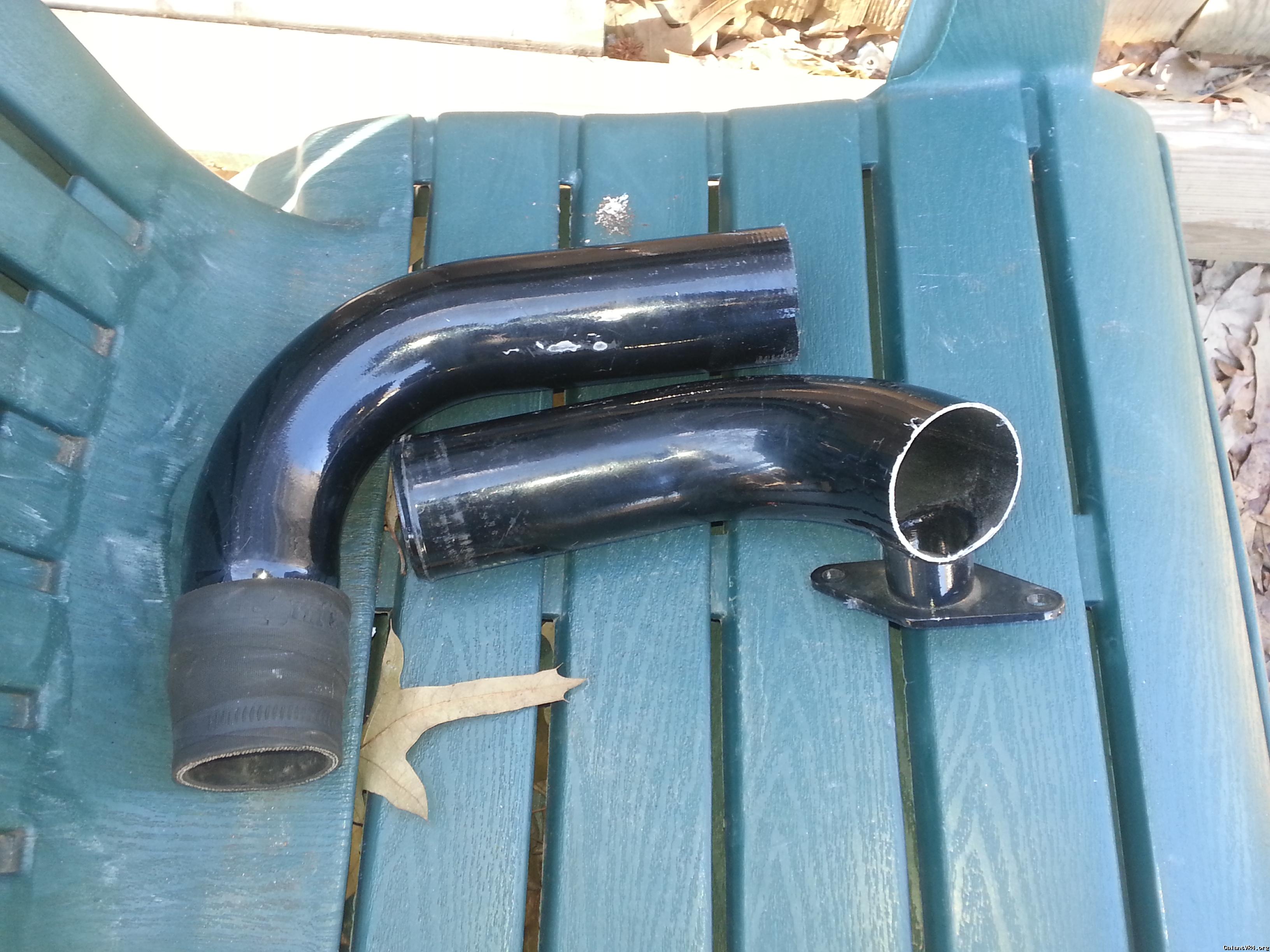

Alright everyone....freeze. j/k. But on a serious note after working on the car for about 2 hours moving turning twisting adjusting and cutting I think ive got it. In the pics youll see I had to cut a perfectly good smic kit up /ubbthreads/images/graemlins/bawling.gif but it did make the kit "connect" I say that becauss I lack enough couplers and a 2-2.5" reducer coupler to make it solid. Im going to try to talk to him one last time and at least get refunded enough to buy the stuff. If he doesnt then Oh well bad rep for him.
3,478

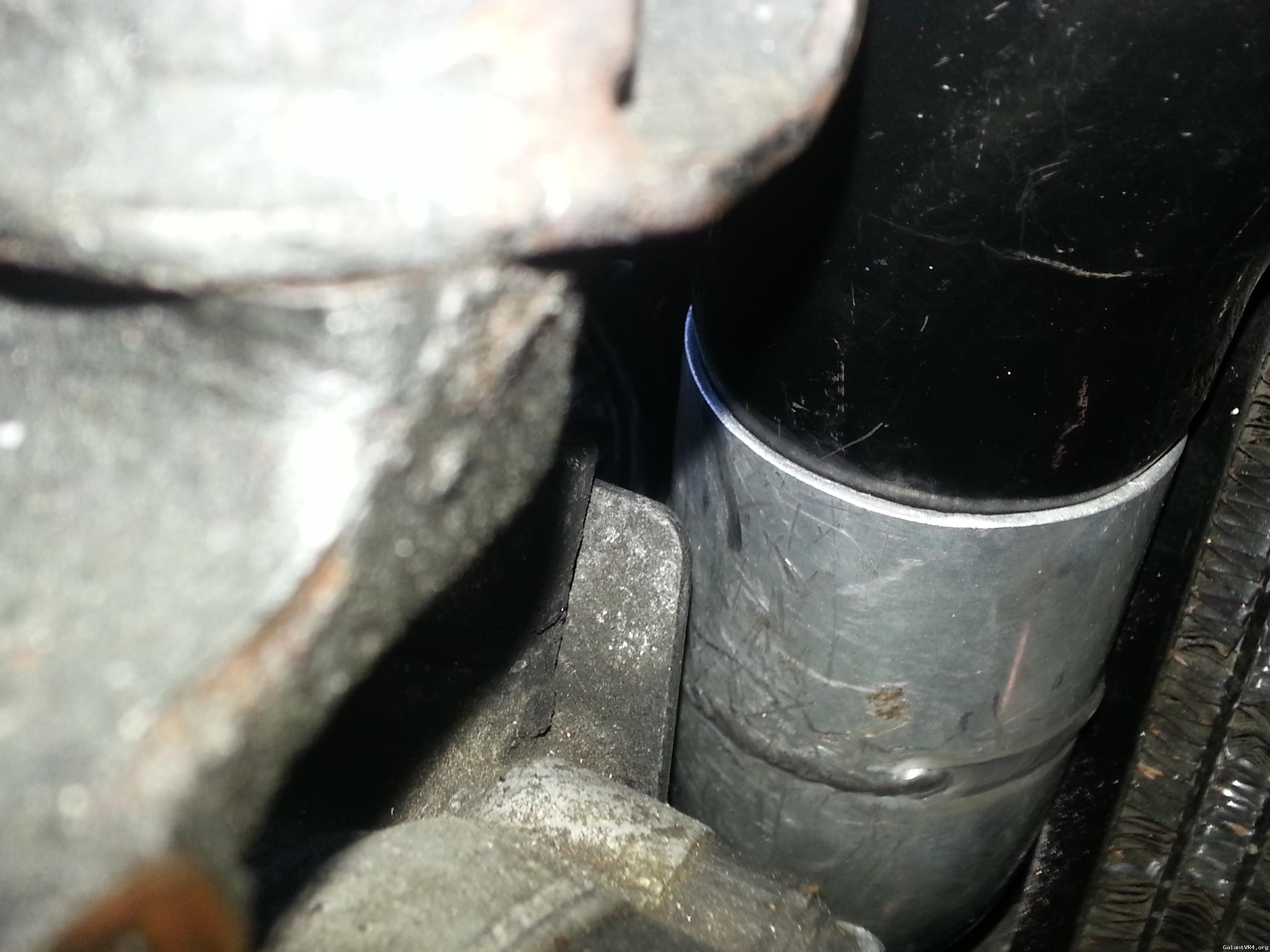

Looks good man. Make sure you roll a bead on each end of the new pipe, or that sh*t will blow off of there. Nice gloves BTW... /ubbthreads/images/graemlins/rofl.gif
Also, if all the couplers look like the blue one in the picture, I'd replace them all with quality silicone couplers. That blue one doesn't even look like a silicone coupler, but rather a cheap rubber one instead. If you look, you can see how the coupler in your picture has expanded and ballooned out over time. Good couplers won't do that.

what i meant was did you striaghten it out before cutting the pipes? i only ask because once you do straighten it out it might change the length of the pipes...
