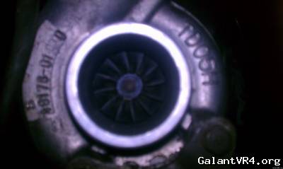

NAME THAT TURBO
dmj
Feb 2, 2008
673
orlando FL
Mitsubishi for sure, /ubbthreads/images/graemlins/rofl.gif /ubbthreads/images/graemlins/rofl.gif
gramkrakr89
Jan 25, 2010
308
Bunker Hill, WV

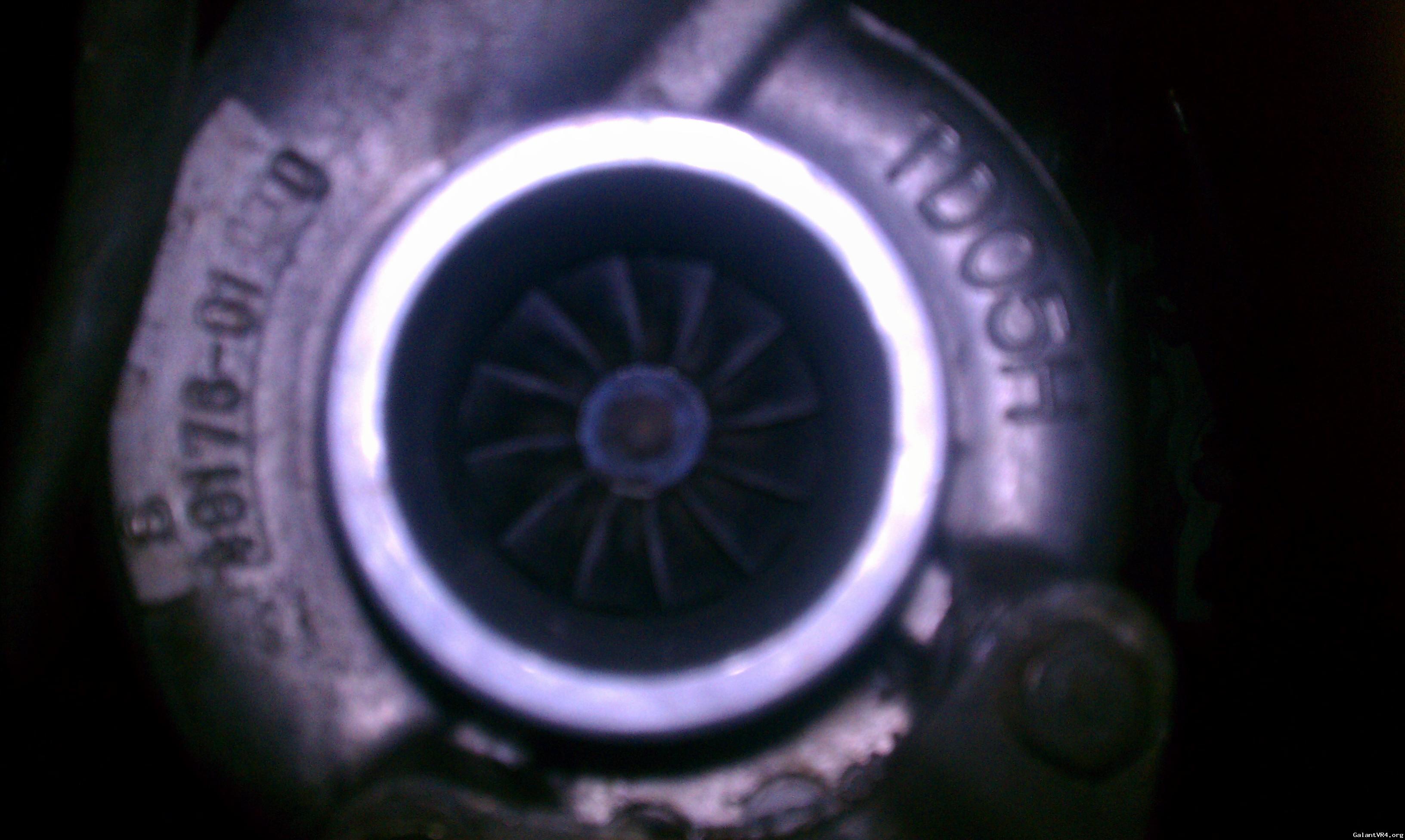

thought the inlet was larger ID on the 16G's, causing the inlet wall to look thinner.... this one looks identical to 14B's that Ive seen... my money's on 14B
OMFGeofffff
May 5, 2006
867
Burnsville, MN
Looks like a TD05H
fuel
Feb 23, 2009
2,166
Toronto, ON, Canada

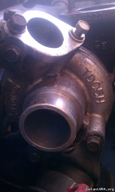

that's definitely a 14B. The small 16G looks similar but you can still differentiate between the two, and the big 16G looks bigger again.
OMFGeofffff
May 5, 2006
867
Burnsville, MN
The second half of the serial number looks like 01020 which I don't think comes up with either 14b or 16g turbos. Obviously its not the best pic so I'm using my best judgment.
EDIT: I waited to long to post this
Okayplayer
Jan 14, 2010
255
Denver, CO
That is definitely a 14b. No doubt about it, a 16g would have staggered blades on the compressor side.
last digits are 030...is that 100Percent accurate...if so every1 who guessed 14b is correct.
Lol all this time I thought the previous owner was running a s16g /ubbthreads/images/graemlins/banghead.gif
