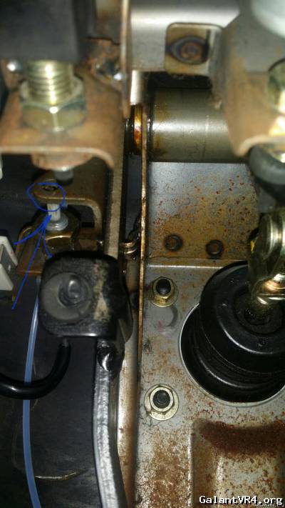

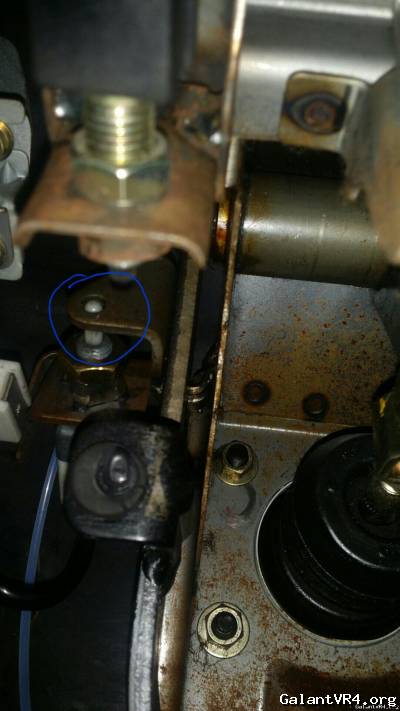

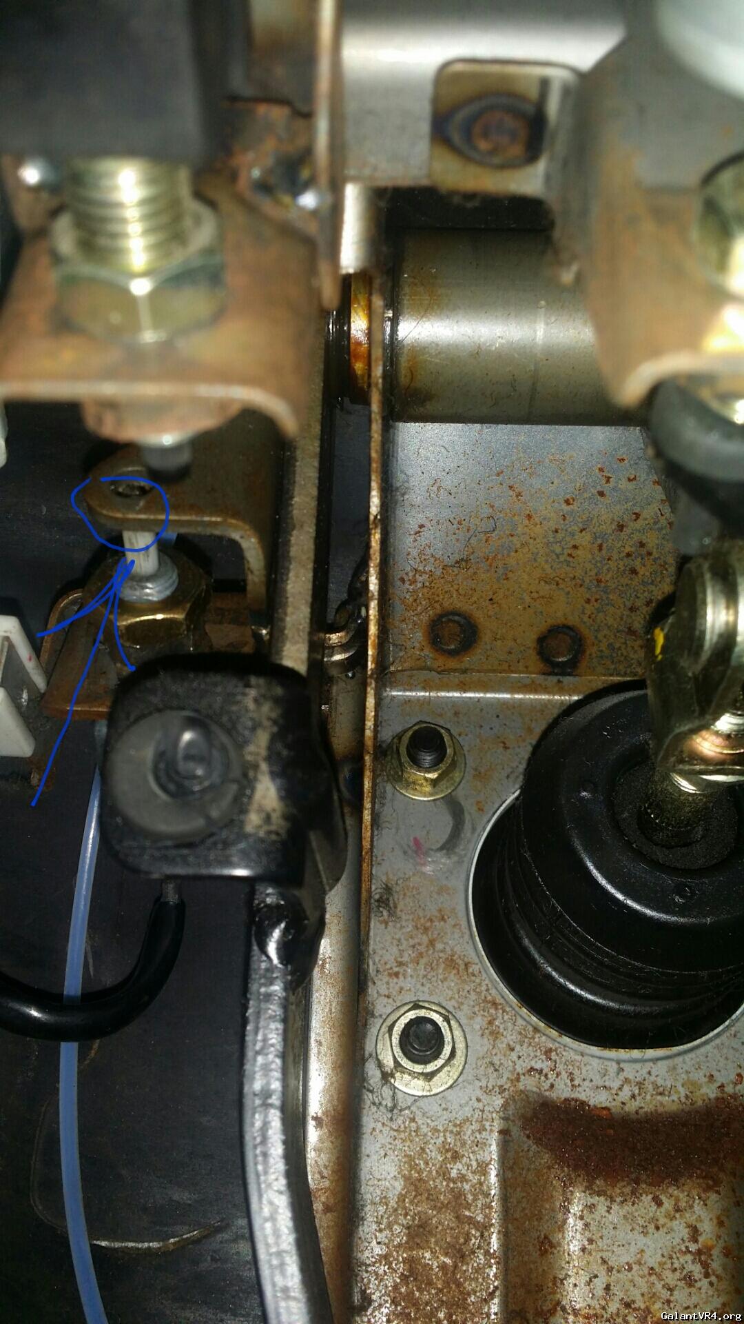

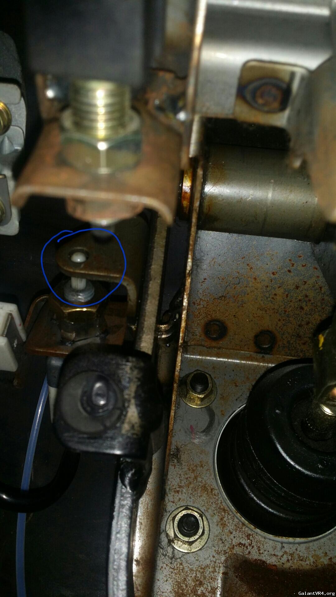

I'm happy you guys bumped this topic back up. Here is my clicking no start issue. Turn the key and all I would get is click from under the dashboard on pass side from ecu area. Look closely at the following pics. My clutch switch is good, however, you can see the switch button is going right through the little hole in the clutch pedal and not being depressed /engaged. The little rubber piece fell out. Lol our cars are getting old, even the simplest things can cause this mysterious no start situation. /ubbthreads/images/graemlins/dunno.gif /ubbthreads/images/graemlins/bawling.gif /ubbthreads/images/graemlins/banghead.gif
11,016
That same thing happened to my wife one day. I explained to her and a friend how to get the car started so she could drive home.

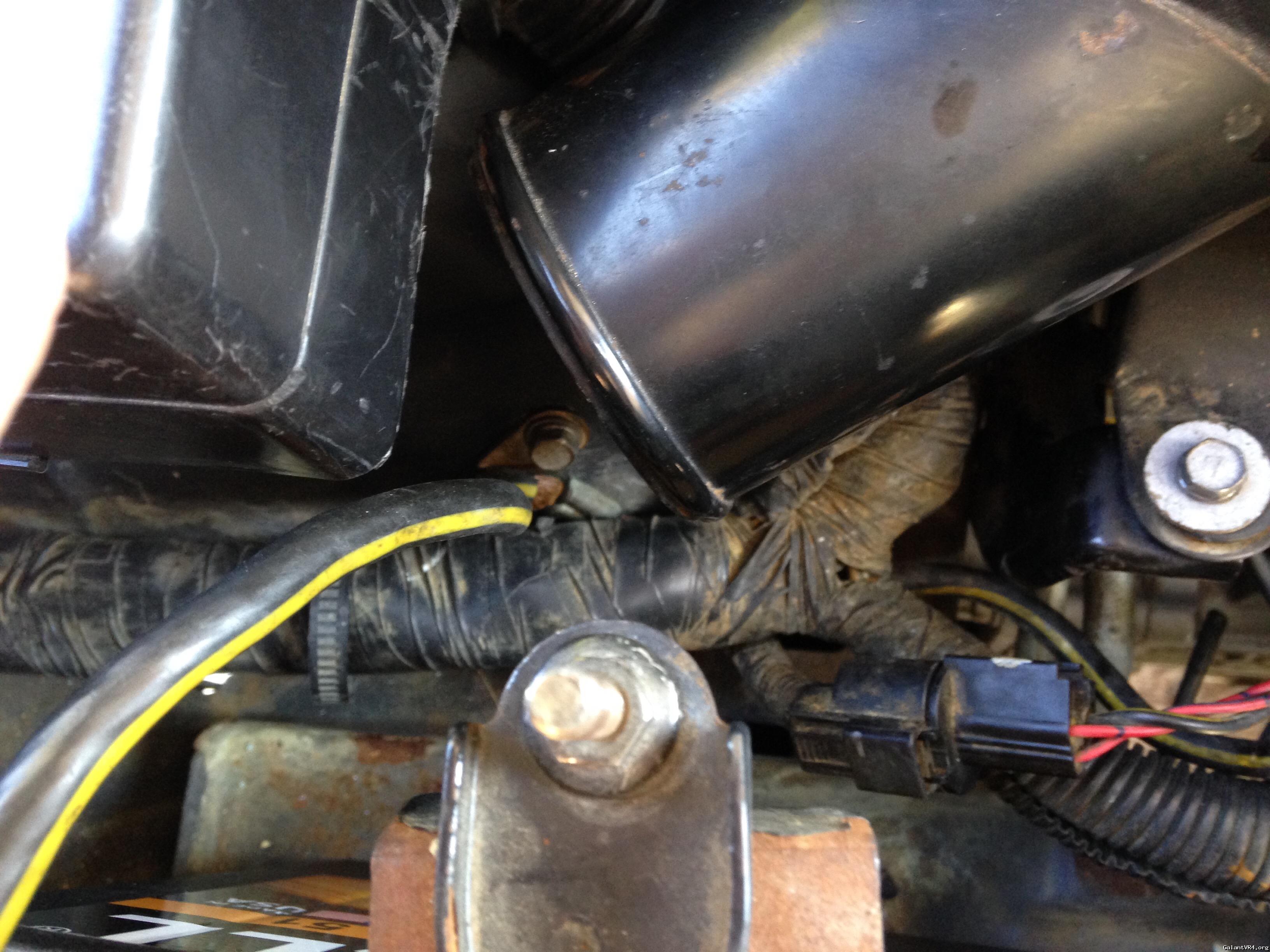

Good news everyone... I figured mine out; here was my culprit:
That little body ground that sits under the fuse box. I tried bump starting the starter this morning and it didn't turn over. So I took starter to autozone to be tested and it passed??? So I got back and pulled the starter harness out and went to checking continuity to every wire, and lo and behold I couldn't get anything from the back side of that little bracket (that sits against the body). I took some sand paper to both sides to shine it up, and his the sheet metal a shame well. Threw it all back together and it fired right up!
Glad my fix didn't cost anything /ubbthreads/images/graemlins/grin.gif
