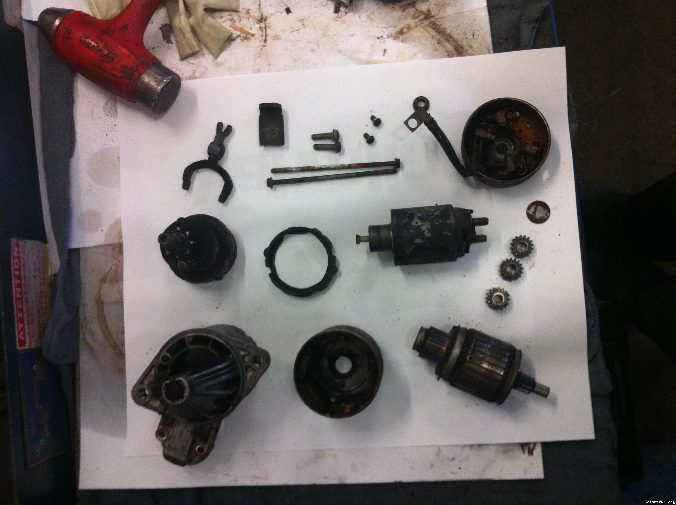

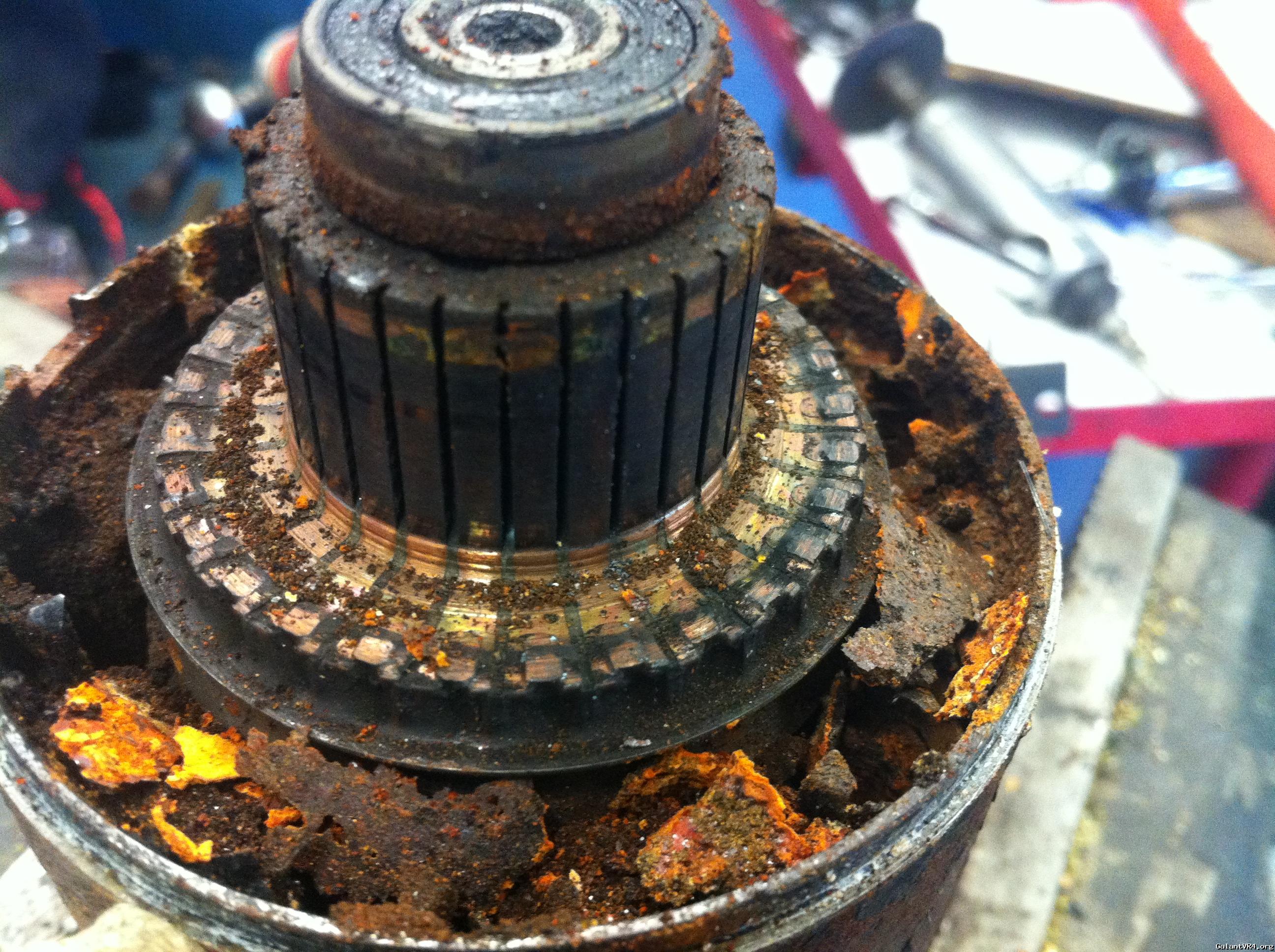

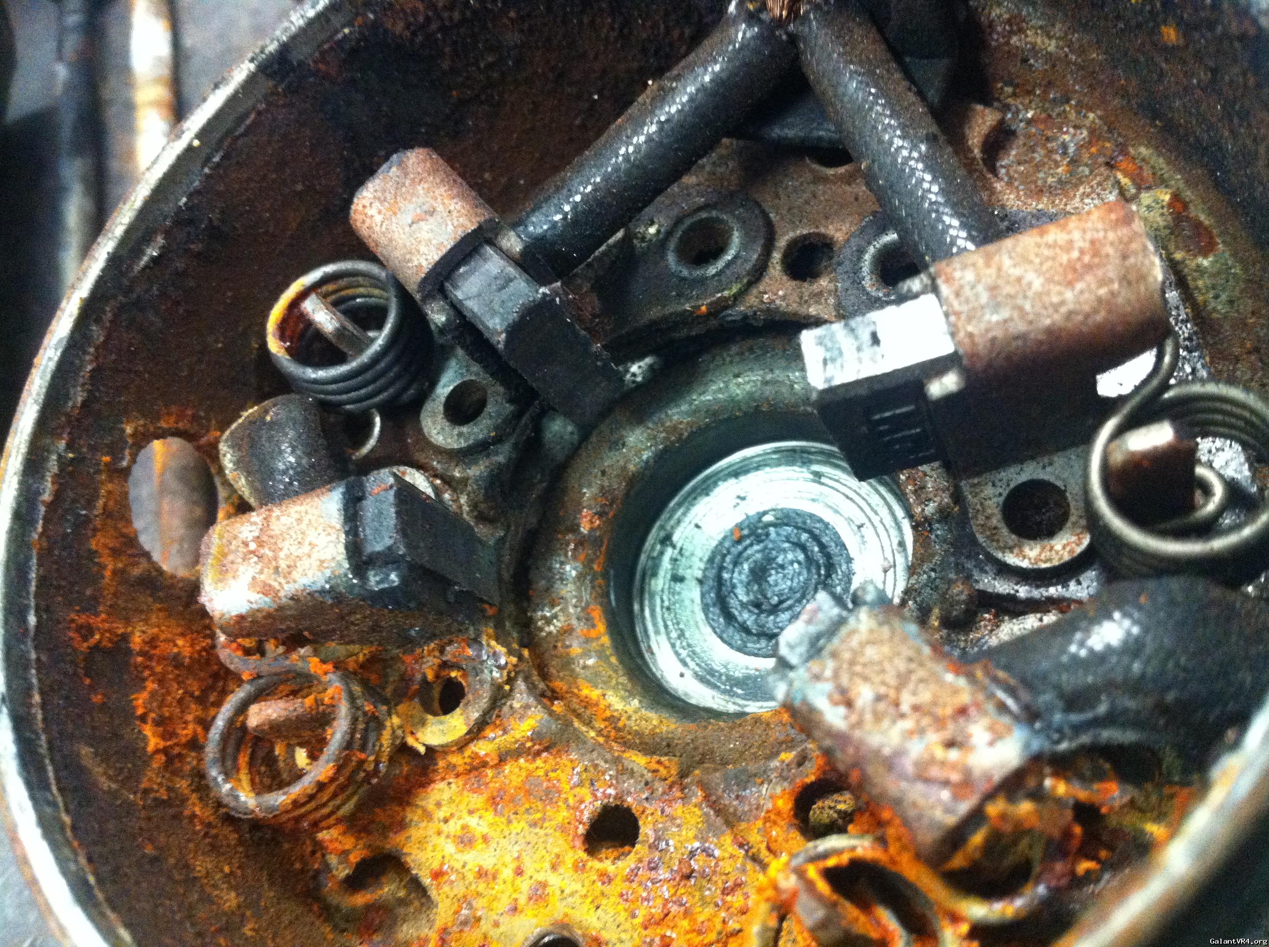

So, this is when you have a moment of reflection and say to yourself that you maybe should not have hosed down the engine bay while certain elements were torn down and just hanging in the way.
Despite good intentions, and cramped quarters, my starter is apparently not water proof.
Who knew?
