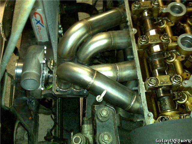

my new exhaust manifold what do you guys think updated!
bob92vr4
Dec 24, 2003
258
littleton colorado

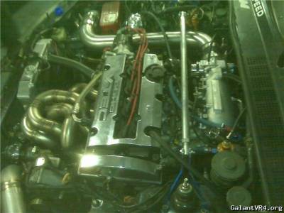

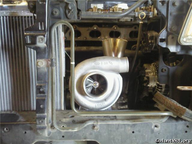

heres a pic of the start of my new exhaust manifold the only down side so far is the ac removal /ubbthreads/images/graemlins/bawling.gif what do you guys think fo far?

yeah lol i will post up some more pics soon. We got cyl number two tied in shoud have it all done by next week i will post up the finished product.

cut a hole in that front bumper and let the cool air flow. /ubbthreads/images/graemlins/smile.gif

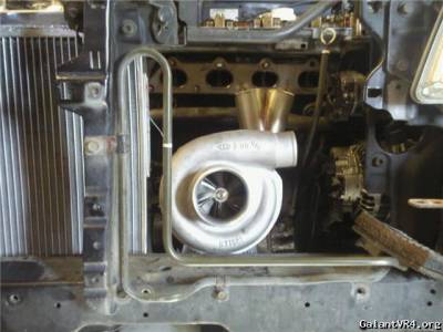

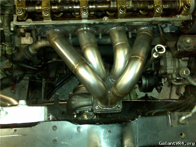

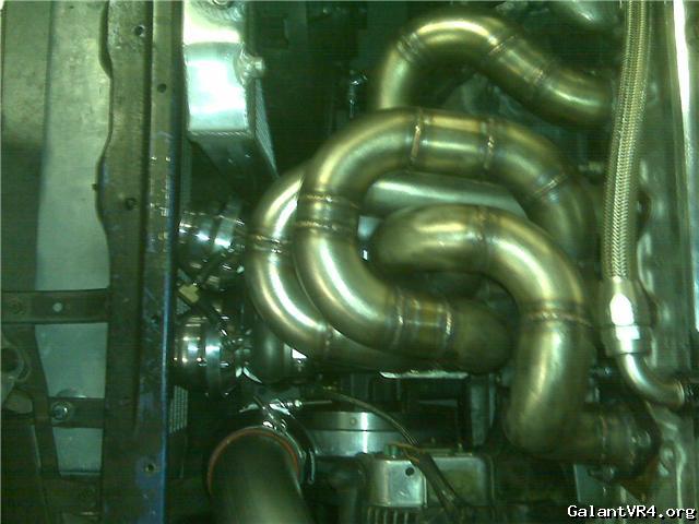

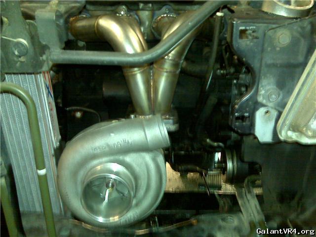

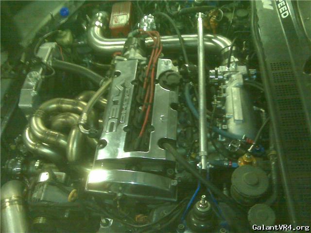

ok so its basically done minus the wastegates wich will be installed when i get them but this is basically the finished product this was built by my friends fab shop here in town who does awesome fab work and custom turbo kits on any hing i have included a few pics of his 700 whp honduh motor compartment. if anybody needs anything like this done let me know and i will put you in touch with him and he is dirt cheap for custom stuff like this including hard pipes etc..

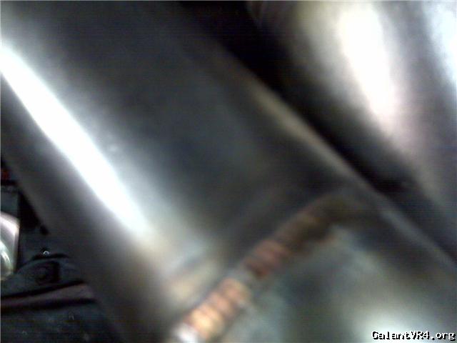

Very simple and straight to the point. The #1 and #4 runners are longer then the #2 and #3 runners, but not by much. The collector looks nice, is that just a fusion weld? Was it back purged or was a flux used? Why did you decide to go front facing turbo vs the "normal" way?

jon no this was done by divulge motorsports owner steve who is a friend of mine its kinda a up and coming shop but hes good hes got lathes and mills the whole set up. this was all done with a tig cleaned up the stainless with m.e.k and clean ss wire brush most of it was fusion welded with some filler rod here and there when needed.

As long as its around 10ga thick (about .125") you could get away with a fusion weld. If a weld is done right it should be stronger then the material being welded, as far as I know this is not possible with a fusion weld.

well it all depends on what you want i.e flanged for mitsu or garret with one or two or no external wastegates my mani he charged about 350 its flanged for t4 with ext wastegate you can go as crazy or as mild as you want. if you want one done let me know he said he would work with anyone from this forum and hook them up. and im not sure on the thikness of the pipe but im sure its over ten gauge cause i work and weld on gas pipeline and these are schdule 20 i belive not like the sch 80 i use at work but very heavy duty ..
