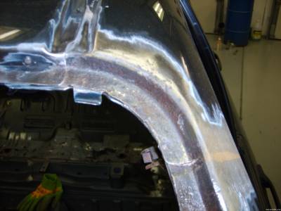

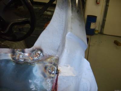

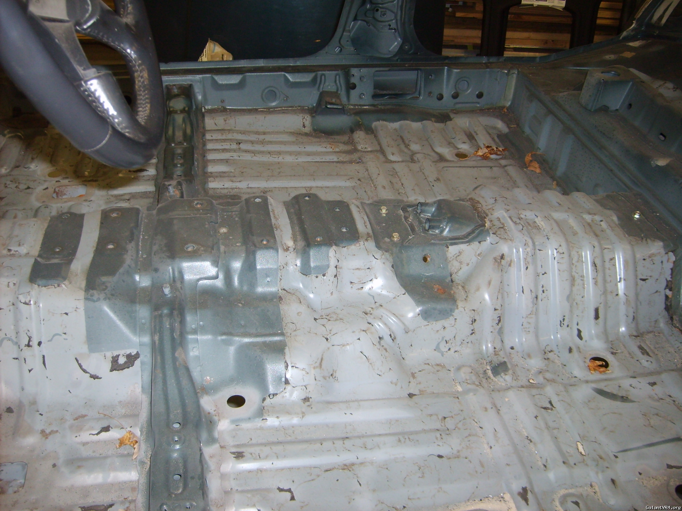

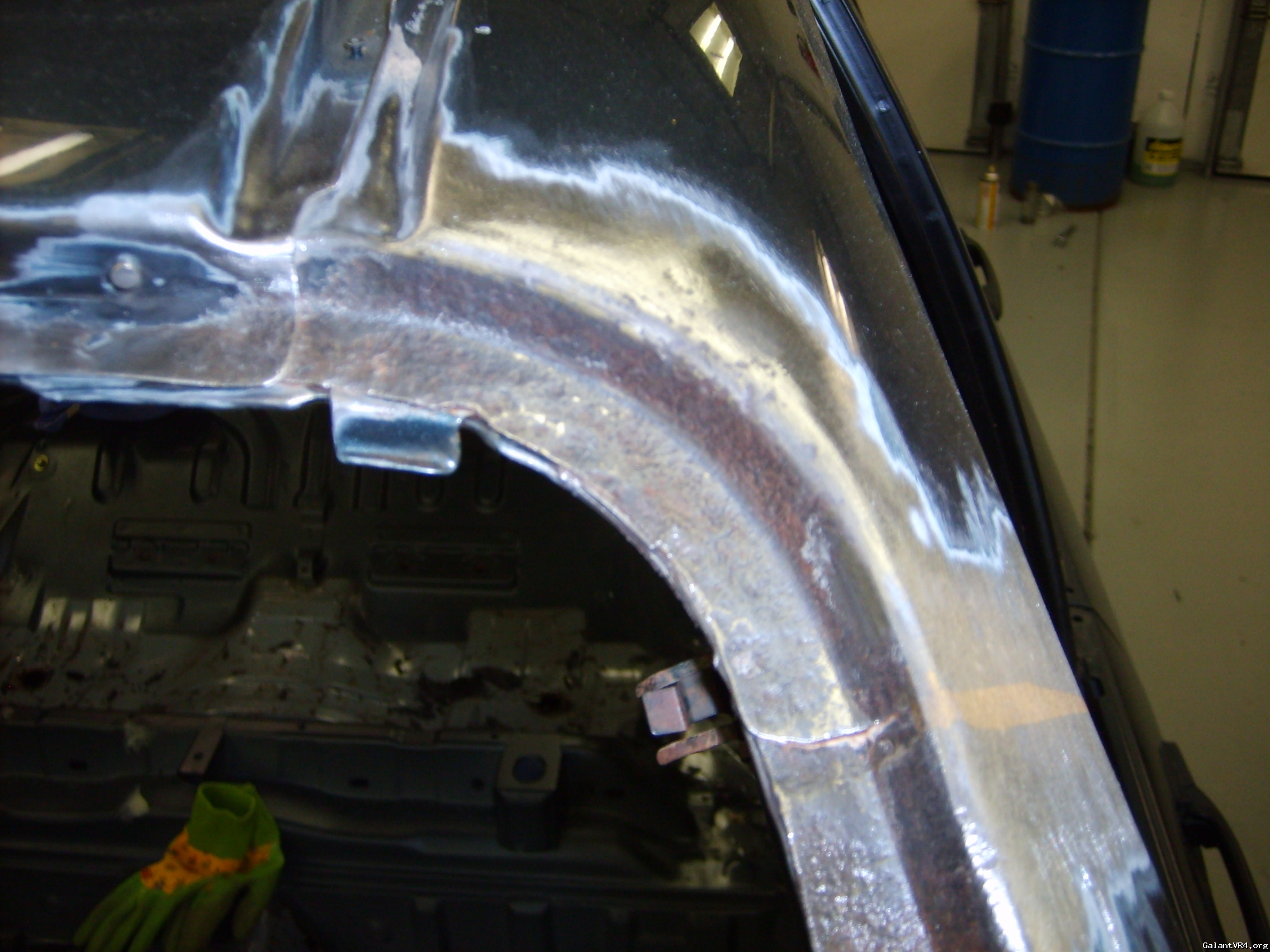

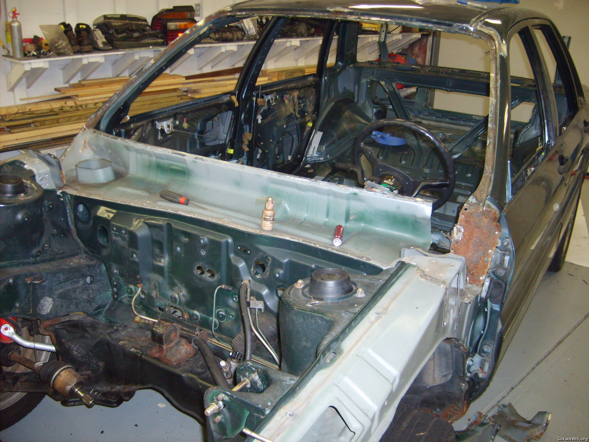

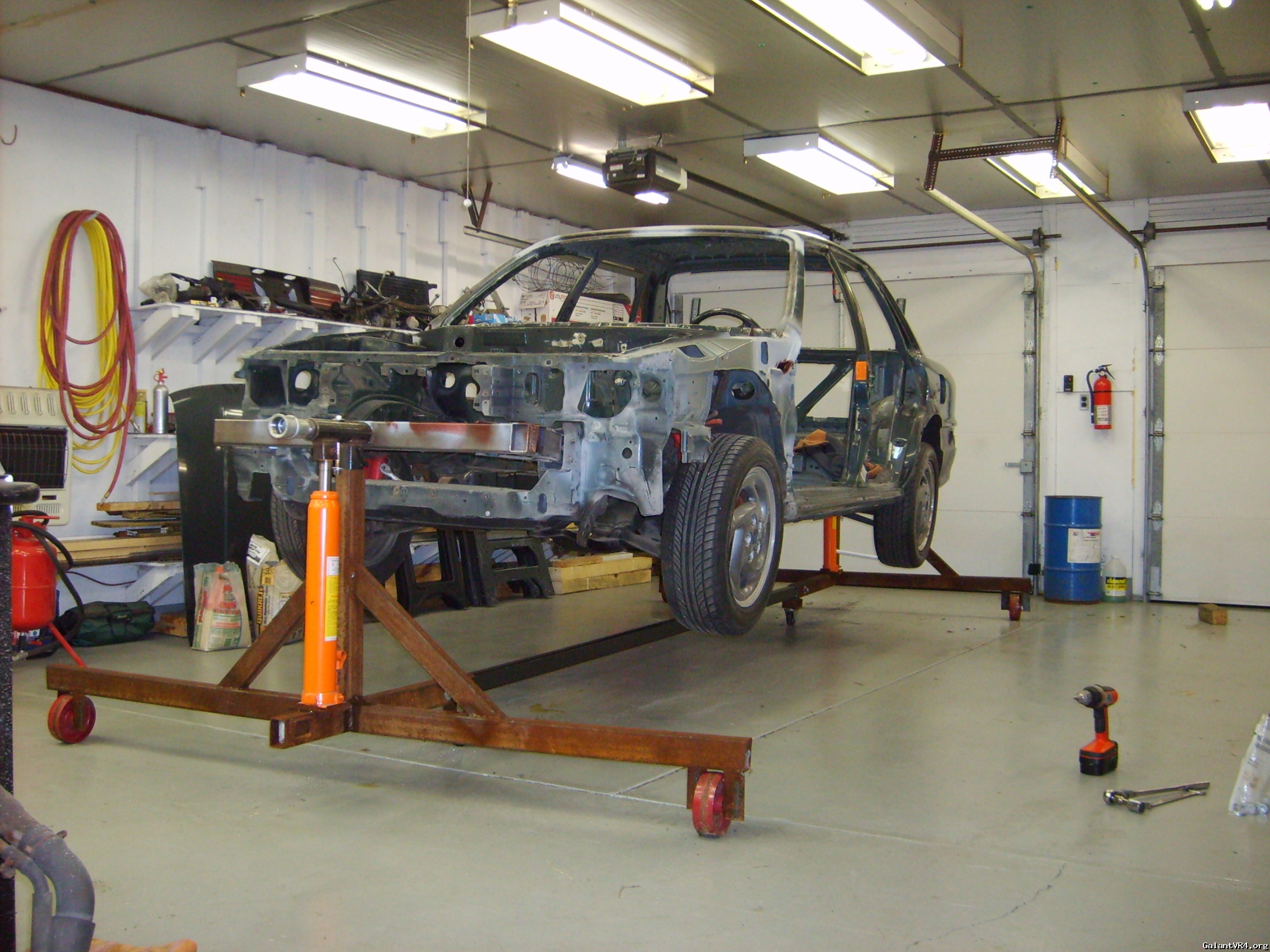

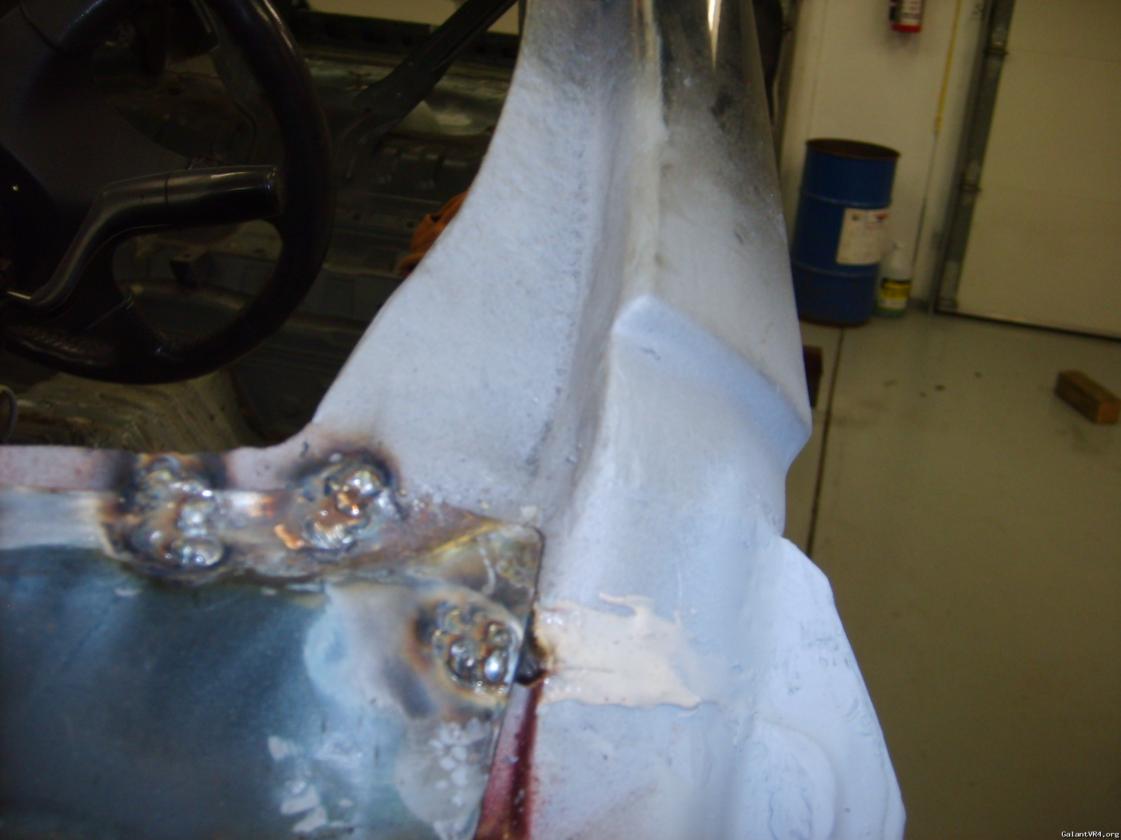

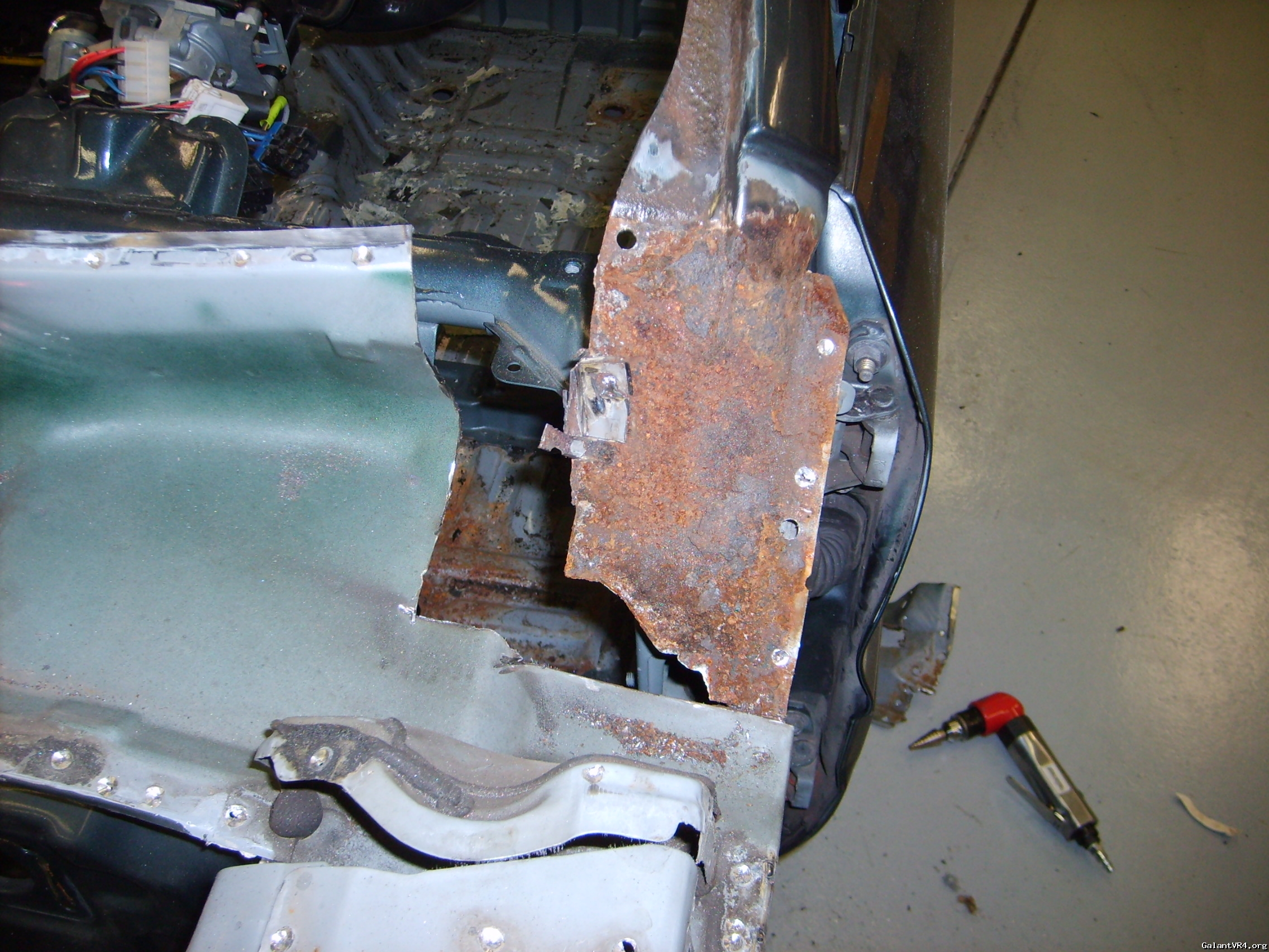

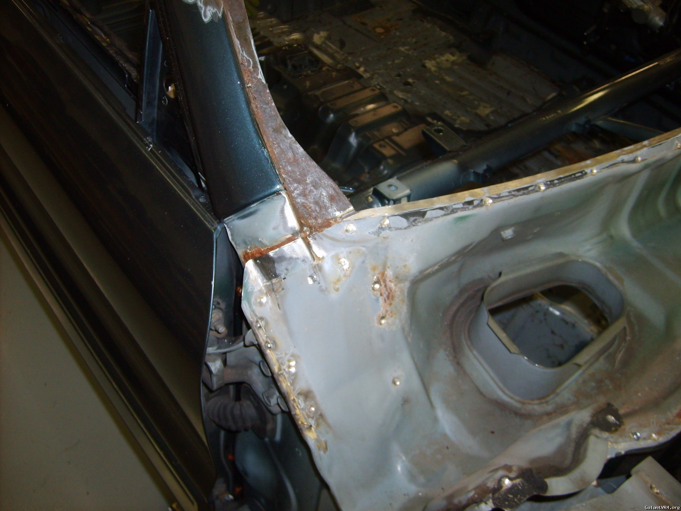

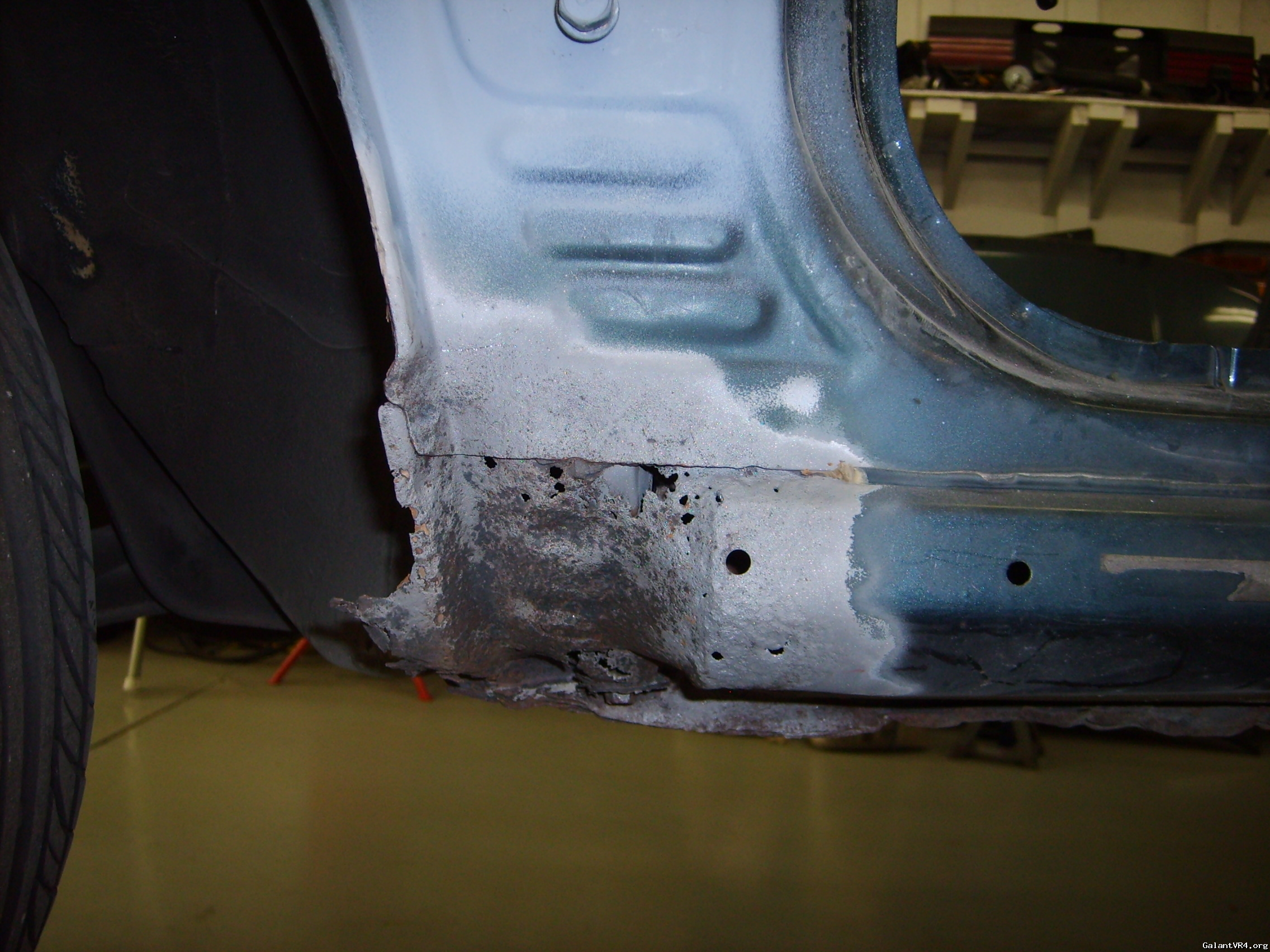

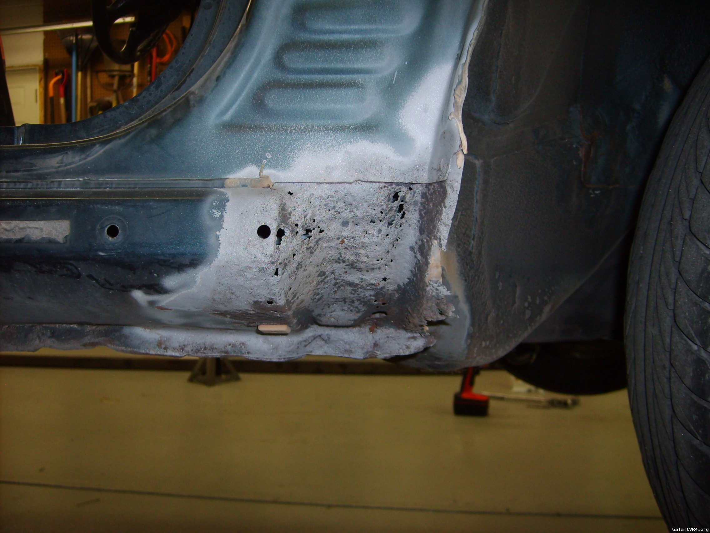

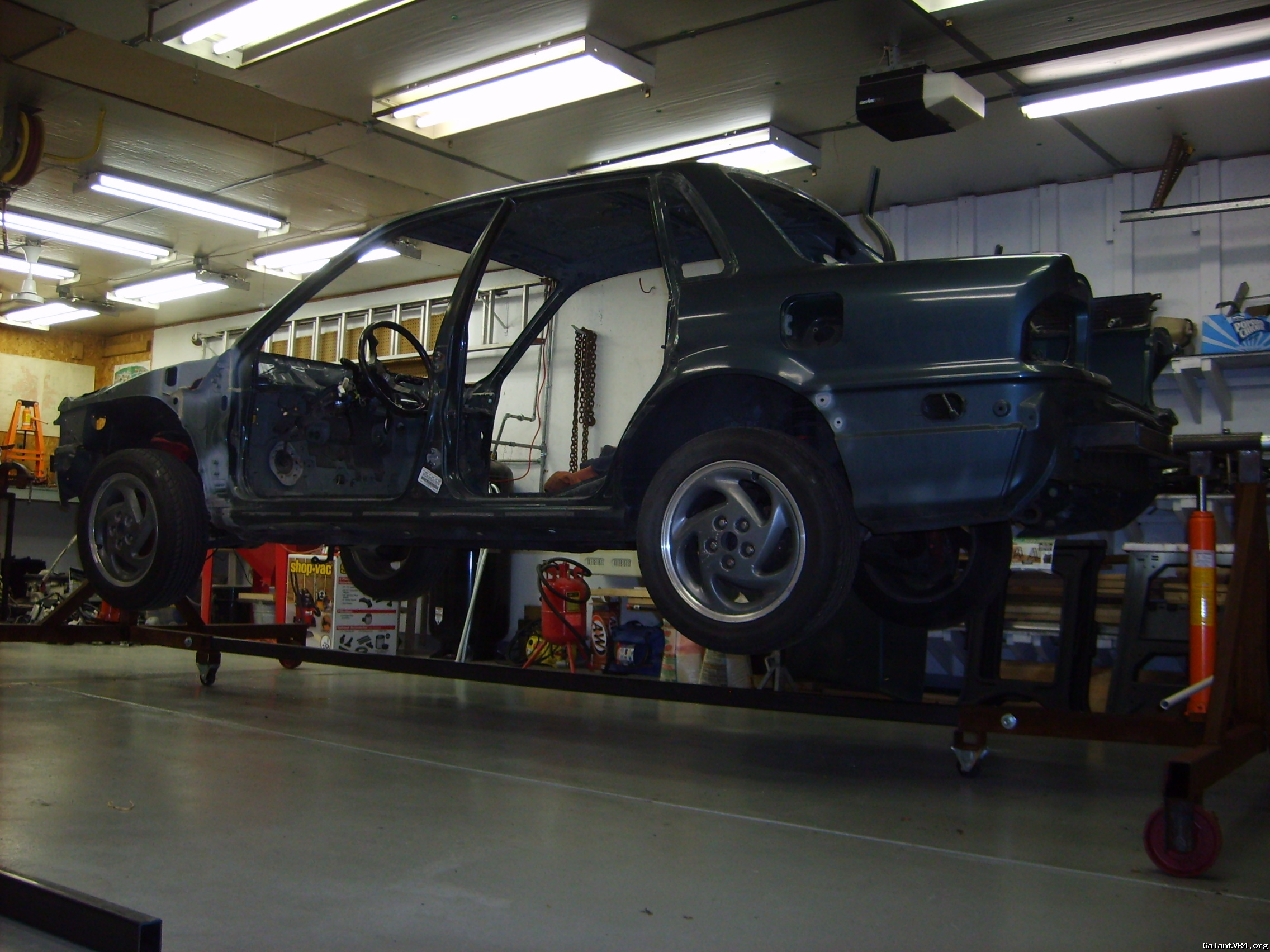

updated photos. Doesn't look like I've done much, but, the rust around the windshield is now repaired. I put a lot of work into that. Now it's up in the sky, mostly to get to the rockers, and a little bit of the underbody. Rotisserie ftw. Oh, does anybody know of a place that makes aftermarket repair panels for vr-4's? Rock Auto lists fenders, I was kind of hoping to get new rockers, maybe just piece in the rusty areas. Or if anybody had a chassis that is rust free in these areas, that they would be willing to hack up for me? Enjoy.
