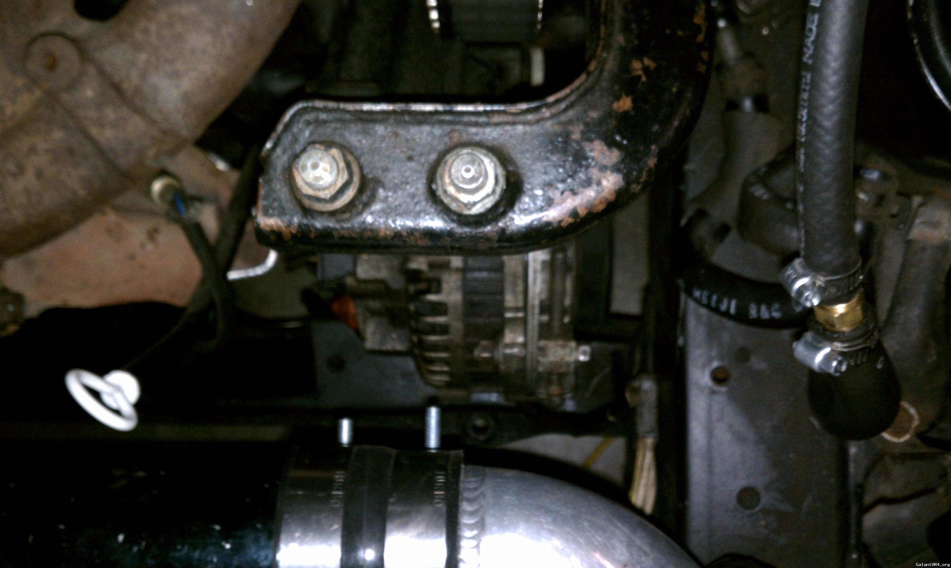

I think I'm missing a bracket...
Or I just have no idea how to mount this thing, Seems self explanatory...

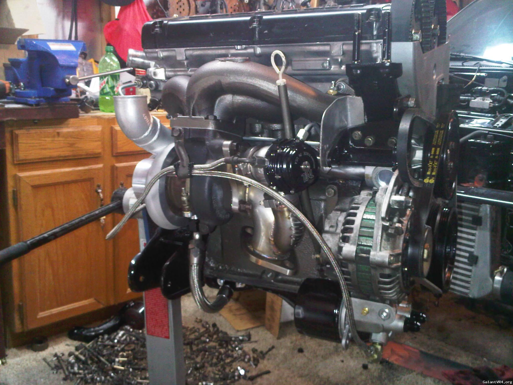

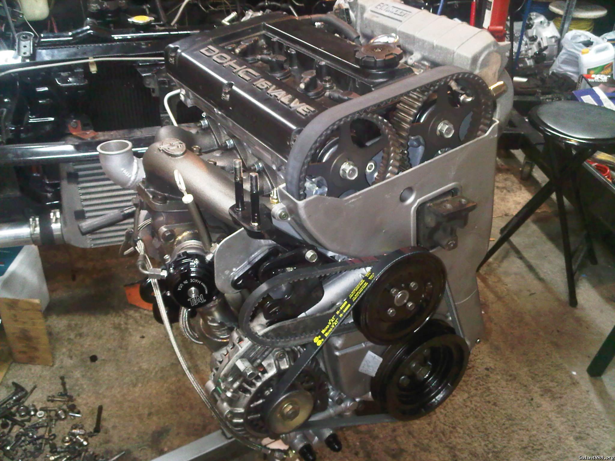

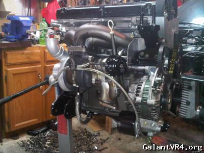

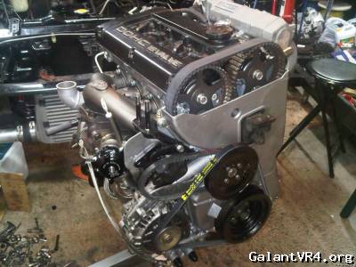

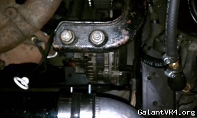

The main bracket is there, but there is a second bracket that bolts to the main bracket:
Thanks to the golfball build for lending this pic.

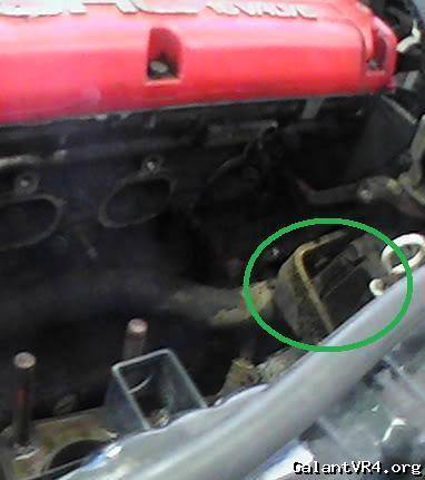

EDIT: Forgot to mention that this bracket and all necessary hardware are available off of DSM's at your local pick-n-pull. They are the same as the GVR4 stuff.
Here are a couple more views of that bracket:
