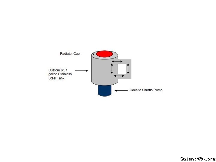

hmmm...the liquid is definitely above the outlet of the breather but half an inch below the top of the tank.
ok yeah i think it would be a wise decision to just seal the tank and not fill it up all the way.
what if i do this? would this allow room for the liquid to expand and help prevent vapors to escape the tank?

If the liquid level was above the outlet in the tank then vapor pressure was pushing liquid up the tube and out. IT would stop doing that once the liquid level drops below the tube. But as I said, the vapors would continue to come out as well.
I do not see a reason for the cup handle. If you fill it leaving some air space at the top of the tank it will have room for the liquid to expand. Now the other problem is if the tank is completely sealed then it will draw a vacuum as the liquid level drops and your pump will have to work against it. The pump may not even prime. So you probably need a one-way or check valve so that liquid or vapor cannot push out but the tank can draw air in as the level drops.

wait, wont a check valve set up just complicate a supposed to be very simple set up? plus, thinking about it more, it might cause pressure inside the tank right?
i got a suggestion to just put a pin hole on top of the tank and it should work because that's how of the shelf tanks from other meth kit brands do it.
that's a simple solution IF it will work. I'd just have to take out that breather tube and seal that hole and put a pin hole on top of the tank.
but honestly im STUCK and dont know how to move forward with this hahaha. I thought that the original design was simple enough until the current issue. dang it! /ubbthreads/images/graemlins/banghead.gif
chris b
A small vent hole would solve some problems. But it will emit alcohol vapors. Methanol vapor could accumulate underhood while the car is hot and stationary. Methanol vapors are not as flammable as gasoline vapors and need a much higher concentration in air to ignite. On the other hand, gasoline vapors are denser than air and will naturally move toward the ground and away from the car, while methanol vapors are about the same density as air and will just stay under the hood until the car starts moving again. Maybe that is why those systems are usually put in the trunk: fewer sources of ignition.

i think i have solved the problem. I took out the breather tube and plugged that hole in the tank then placed a pinhole on top of the tank. I pulled a hard run earlier boosted around 1 bar for about 8-10 mins and when i got home, i saw no signs of leakage from the pinhole. i guess that if there were any seepage, they turned into vapors.
however, when i took out the tank earlier, i discovered that the tank was sitting on top of an A/C tube that goes into the firewall which was heating up the tank and the meth inside. I raised the tank about an inch or so to have a good clearance and holy crap! after my run earlier, i touched the tank and it wasnt hot at all (unlike the previous set up where i can feel it hot but not enough to force me to not touch it). I touched the other two cans beside the tank and they were as hot as before (no surprise there).
so i think the seepage in the initial design wasnt a design flaw, i'm almost sure that the meth vaporizes more quickly than it's supposed to be because of the extra heat generated by the A/C pipe where it was sitting on the whole time! but of course, the breather could still be a potential fire hazard because it traps a lot vapors in there.
anyway, the tank will still be under investigation.
