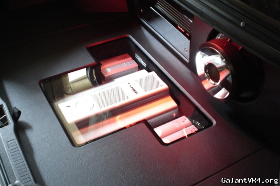

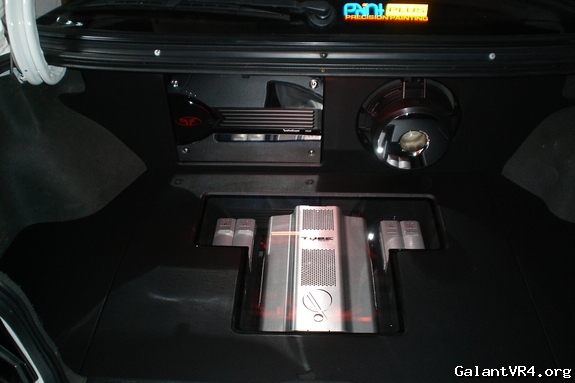

sadly yeah. like i said in my first post, in my excitement i cut my dang hoses and wires. plus i cant really put them in the trunk coz i have a sound system installed there. dont want to mess up the clean install /ubbthreads/images/graemlins/smile.gif

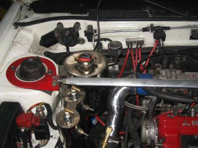

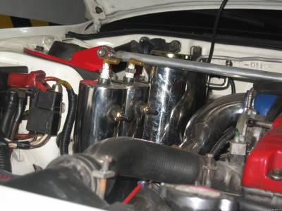

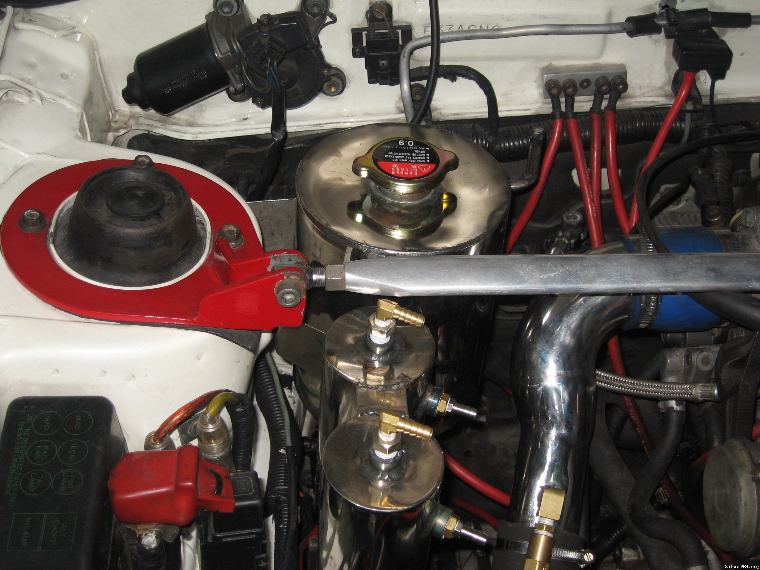

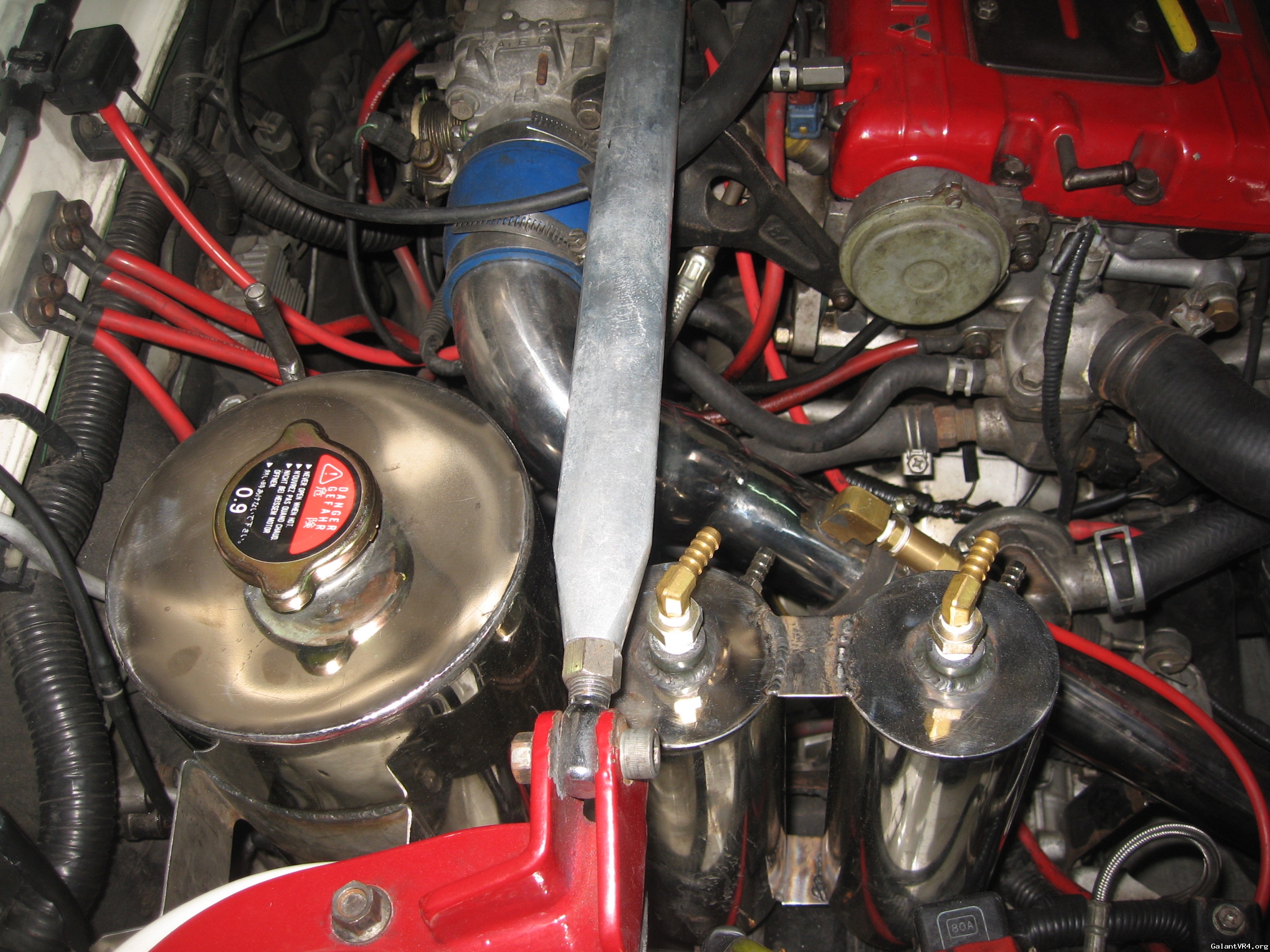

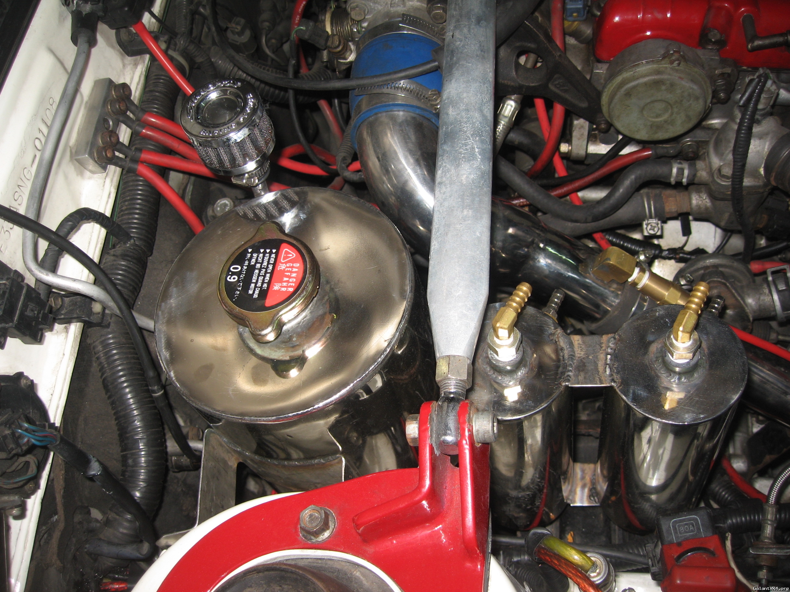

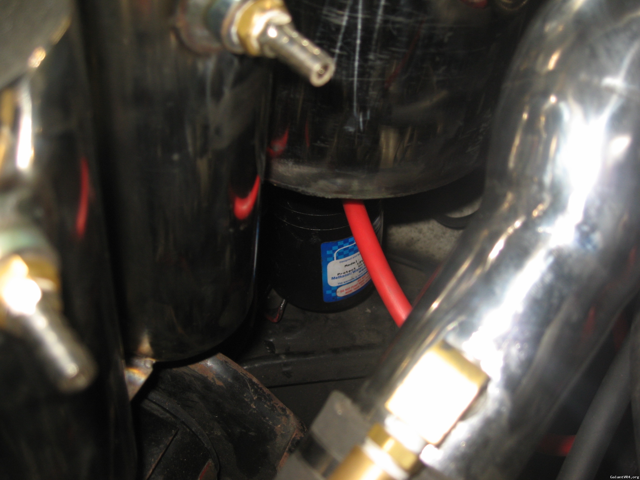

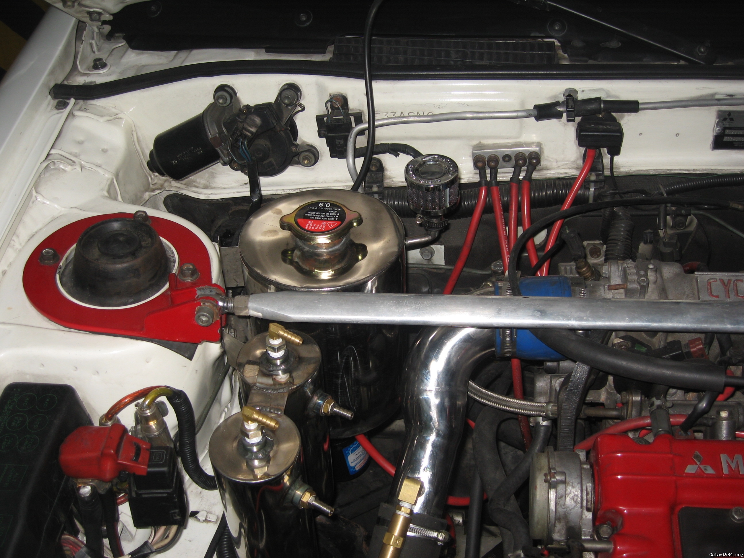

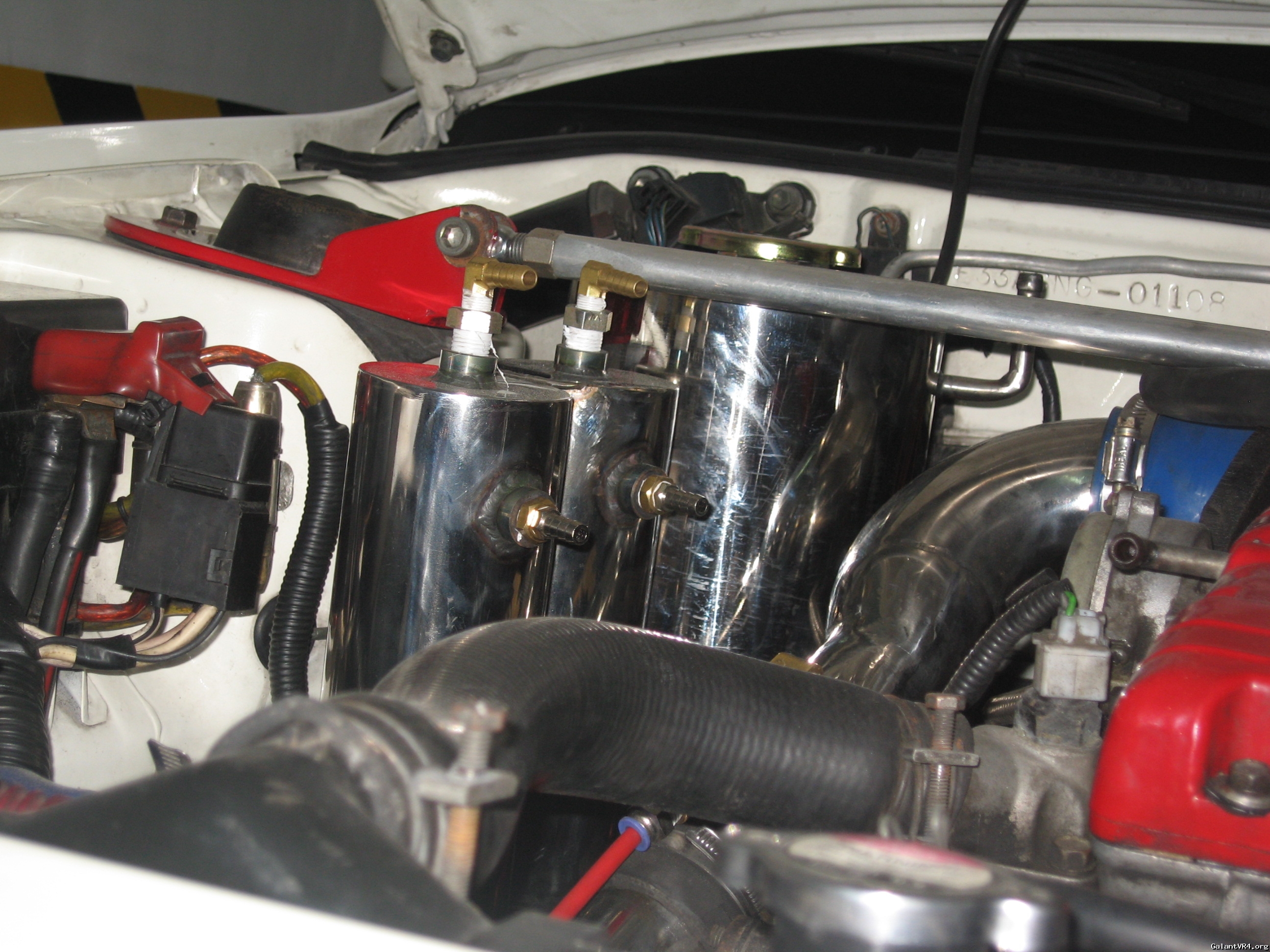

ok my custom meth tank is complete!!! it's the big can with the radiator cap. it holds a gallon of meth. Initially when i started the engine earlier, some meth were spilling through the breather. the metal hose where the breather sits is higher than the top of the tank so i was wondering why it was spilling there?! and the pump wasnt even running yet.
so i took out the breather, cleaned it up, and plugged it a bit higher for more breathing air. seems like it solved the problem. it will be under observation though.
here are some pics. sorry im not good with the camera so im sure the pics sucks, but it's more impressive in person hahaha!
Together with the custom dual catch can set up
shurflo pump underneath (hope it's far away from heat!)
meth injector connected to the up pipe
more shots of the tank

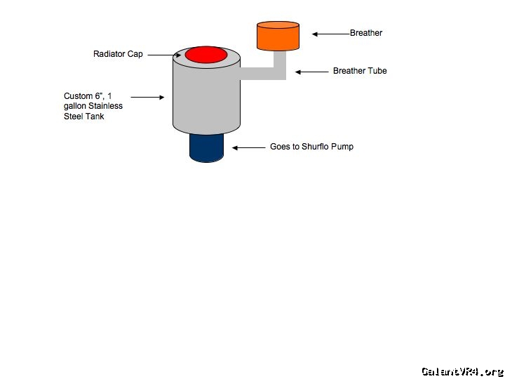

ok ive had the meth tank under observation and meth is still seeping out of the breather. Im really wondering why this is happening because it does so even when the car has just been started up and the hood is popped up so i doubt if it's the heat.
here is the simple design of the tank.
should i get rid of the breather? and just seal the tank?
