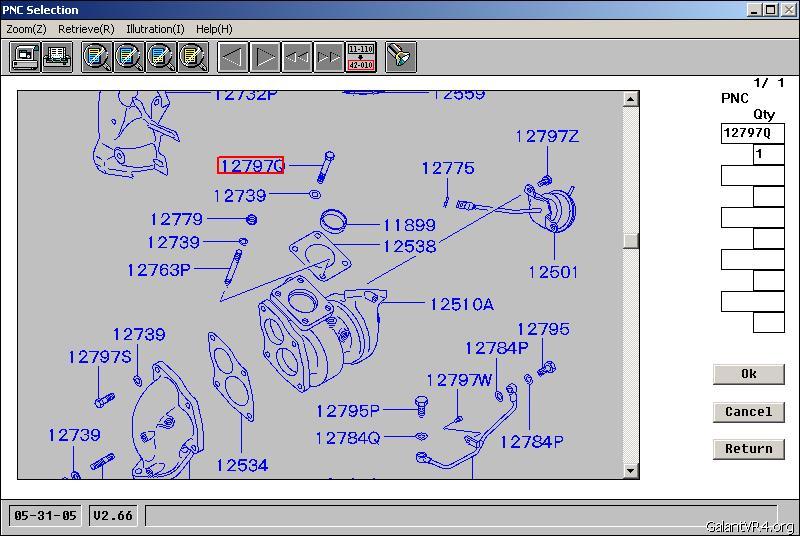

Manifold to turbo bolt part # ?
Does anyone have the part # handy for the M10x80 bolts that hold the turbo to the exhaust manifold?

bolt, t/c md132656
washer, t/c md132933
To be sure, this is what we're talking about:

Rather than get the stock bolts that were used on our cars, it would be better to upgrade to the 2g bolts and washers. The 2g setup uses coned washers that face each other and once torqued down keep the bolts from backing off.
Coned washers - MR187848
Bolts - MR187699
The 2g ones are also $1 cheaper per bolt than the 1g bolts. /ubbthreads/images/graemlins/wink.gif
