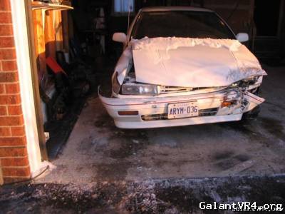

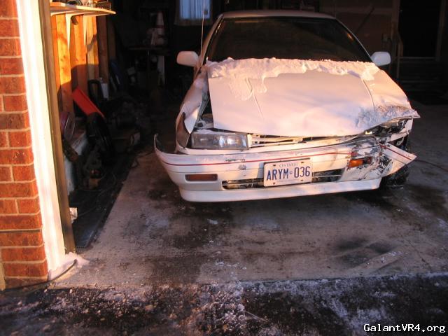

FlyingEagle
Mar 5, 2005
1,636
THE Ottawa
C50 series CSM
Right angle crash, 50 KMH, met a 95 Buick Regal.
Full US/CAN bumper support intact unlike my current car with bumper mods for the Starion intercooler.
No windshield damage or any twisting past the firewall, doors opened fine.
This is a side angle front corner impact, maybe somebody has pics of another front end collision, but straight line? /ubbthreads/images/graemlins/dunno.gif
The C50 is not that much different from the Galant in terms of engineering, frame rails being a bit weaker on the Colt of course.
I must say that I am a big fan of front bumper support/frame rail connectors. /ubbthreads/images/graemlins/grin.gif
Hope you get those rings solved, and permanently.
