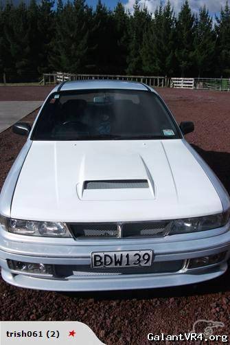

Goodnes me /ubbthreads/images/graemlins/ooo.gif This topic has turned out a bit different than I had hoped. I've been doing a lot of thinking for ya. Why not essentialy seperate the two sides of the engine bay along the bellhousing line on the exausst side using a piece of polished stainless or ally. Then use a half width, but thick radiator on the exaust side and have the fan infront of the rad? then the air filter could get direct airflow from behind the front bumper. It would be in a high presure area and the intercooler would get a very cold air stream too.
I was talking about this with a friend and he happened to have photos of an RX7 scoop on a gvr4, if ya interested /ubbthreads/images/graemlins/wink.gif
BTW I'm trained in collision repair and fabrication. People might be suprised at the difference with and without cut/modified bumpers. Though I think what realy suffers is the ability for the car to be repaired rather than ocupant safety since you still have the motor infront of you.

Justin, that RX-7 hood scoop looks nice. I had the exact same thought on bringing in fresh air from the right side of the car (driver's side on your end of the world). I will be retaining the A/C so I'm not sure how much that would effect the air charge coming in. I'm sure it would be some. I will experiment with these setups in the fall when my hand heals and my shop workload goes down. I have done a lot of racing in the past, but this is my first turbo'd car so it's going to be fun to find what works and what doesn't.
