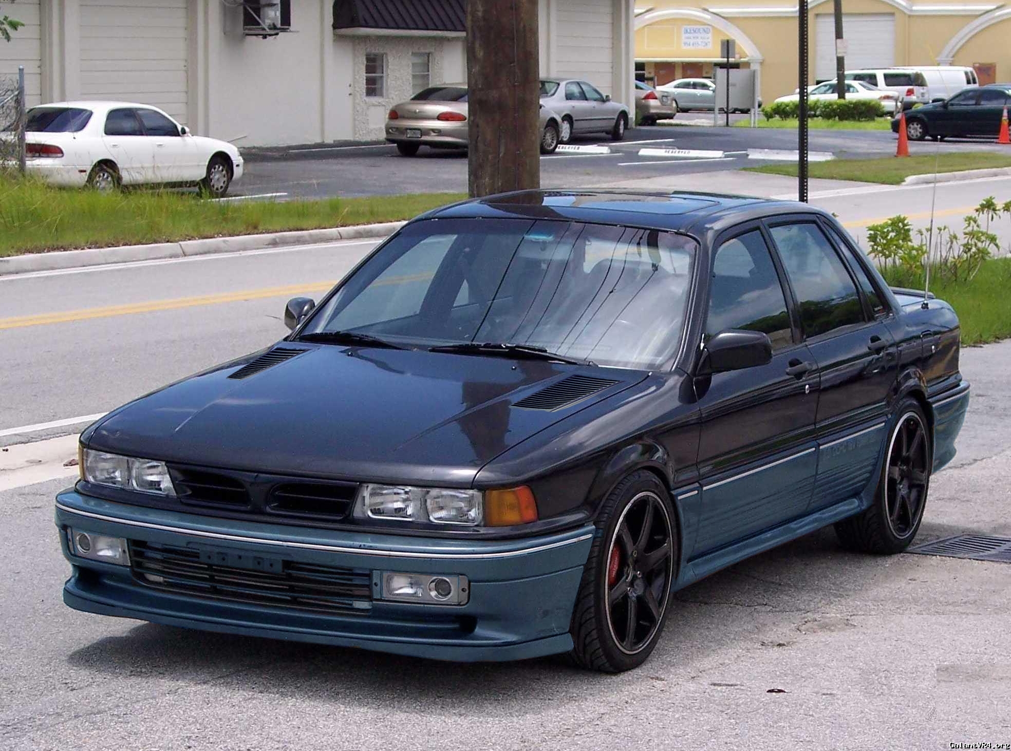

As far as hood vent, check this out:
CutlassJim
Jul 17, 2006
1,699
Manchester, NH
Having the vent that close to the top is killing flow. The high pressure area at the base of the windshield doesn't want to let the air come out from under the hood. You should keep a good 12" away from either end of the hood. Evo location is usually considered best as %90 of engine bay heat is coming from exhaust/radiator and there is nothing to inhibit flow from these areas with the vent right above them. On cars with engines mounted the "normal" way (front to back) fender vents ala GNX or late 70's firebird style are best. Looks good though. /ubbthreads/images//graemlins/wink.gif
