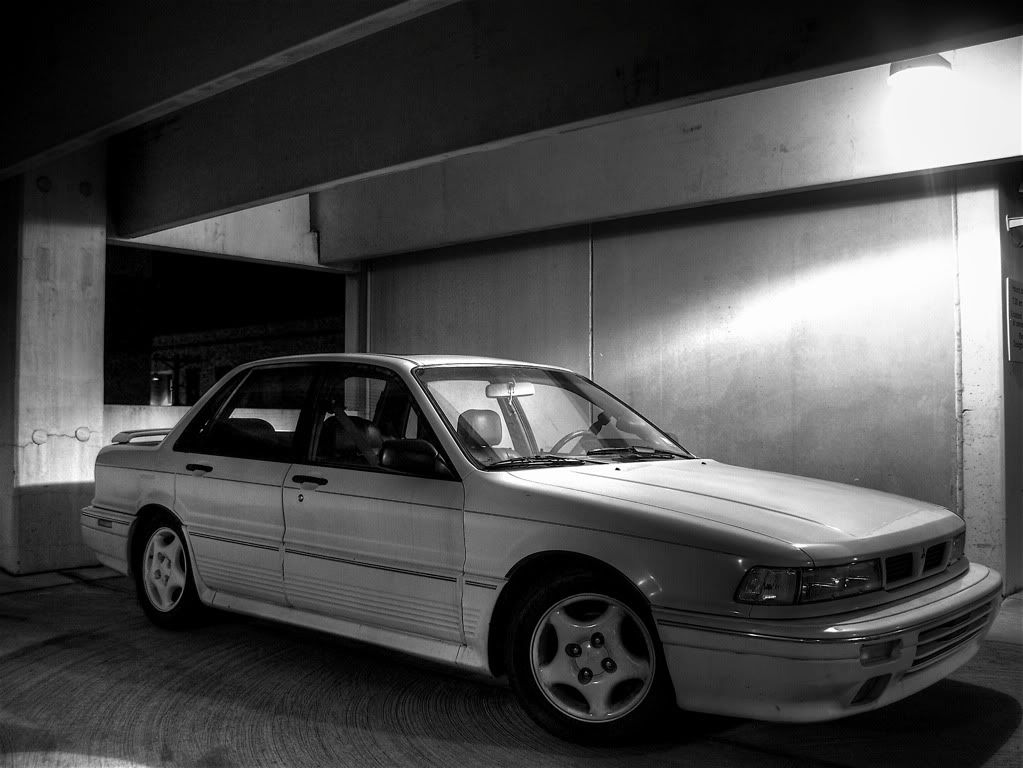

I have KYB AGX and DSM megan springs, absolutely am not happy with it. I want something higher and that rides way better and sits even. Here are pics of mine
Sorry the closest side profile pictures I have.
