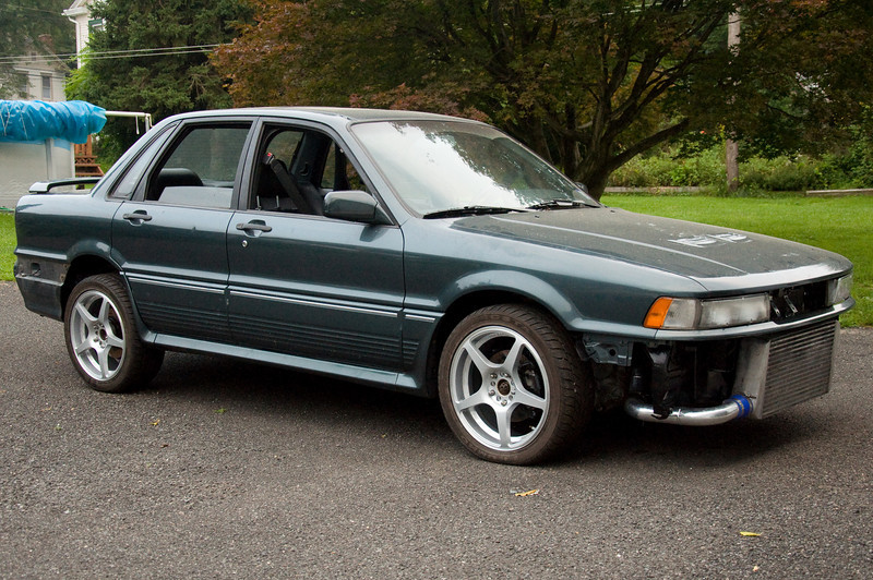

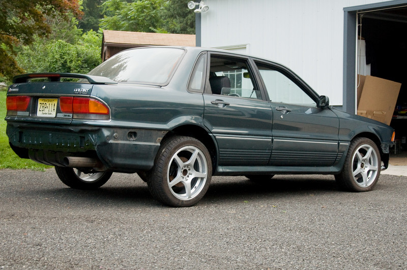

D2 coilovers. 17x7" wheels 215/45/17 Kumho Exsta tires. Alignment is still "eyeballed".
I have the ride height set on the taller side so I didn't have to change anything to fit 26 x 9.5" slicks, which just barely fit.

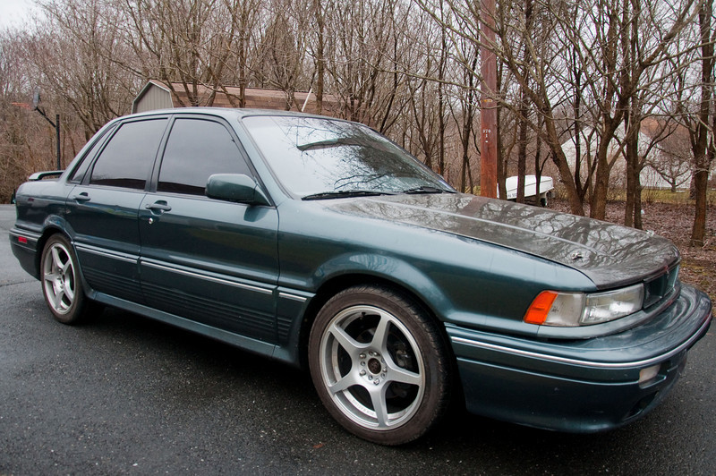

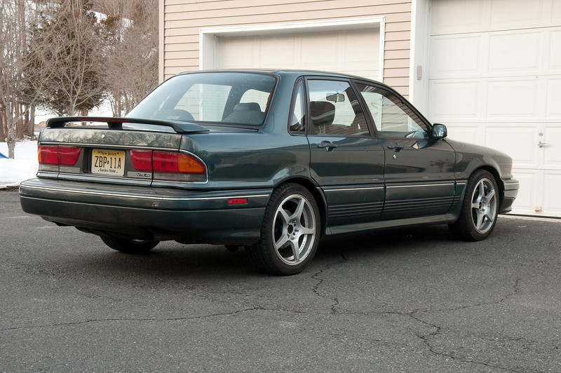

Here is what the ride height looked like with AGX shocks, Eibach Pro-Kit 1G front springs and H&R gvr4 specific rear springs (prior to getting the coilovers)

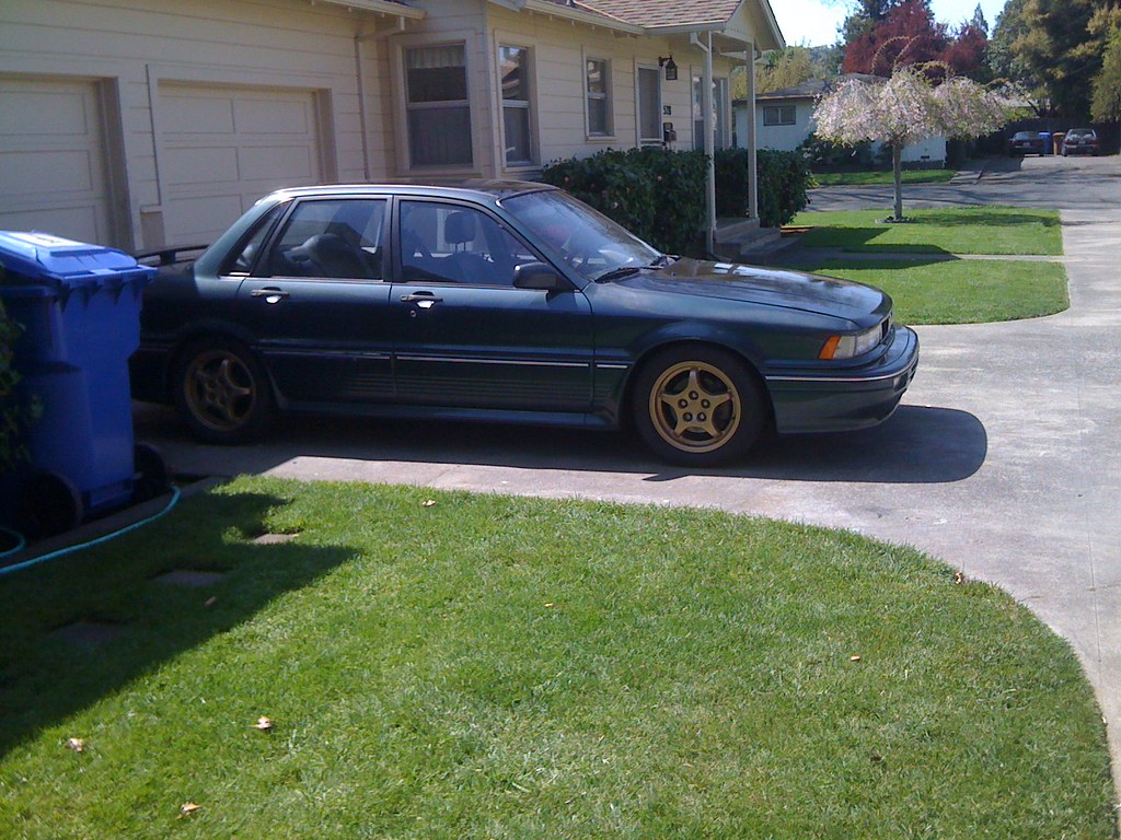

Quoting CutlassJim:
AGX/Eibach in the front and Evo9 KYB/Tein in the rear. Stock size(195/60?) snow tires on stock rims.
Perfect Height!

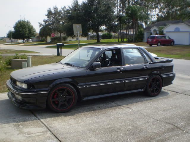

I am currently running KYB's W. 1g Sprint 2inch drop Springs in the front, and eibach Rears. Ever since I changed the front springs, nothing but problems. The car sits nice and low, but just the slight of bumps and low mph will make you clench your teeth, the ride is too hard and very, very uncomfortable. Can someone tell me a cost effective setup that will not hit as hard with a nice drop? Do Drop zone coils ride hard? thank you for any input
11,982
As low as that is sitting, the front is probably on the bumpstops. Upward travel in the front is the limiter on how low the car can sit.

I don't have bumpstops, if I add the would that make a diff and cause a smoother ride?

Yeah with a GVR$ slammed like that...it looks about 3 to 4" lower than stock, Id bet you have at most 1 inch of shock travel in the front. There is no way to get a comfortable ride when the suspension is at rest with the vast majority of the shock travel already used up. Comfortable and smooth riding Galants look like trucks....ones that look low ride like ass and are super stiff. Nature of the beast.

Thanks A lot Guys,I figure the eibachs were 1inch drop, and the sprints are 2.2. So I am just going to get coilovers and try to get sumting of a drop in the middle..mayb 1.6-1.8 inch drop. My friend has agx w. Groundcontrol coilovers for 350, what do you guys think that should hopefully look decent? Or ride smoother?
