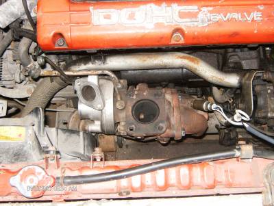

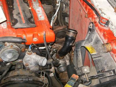

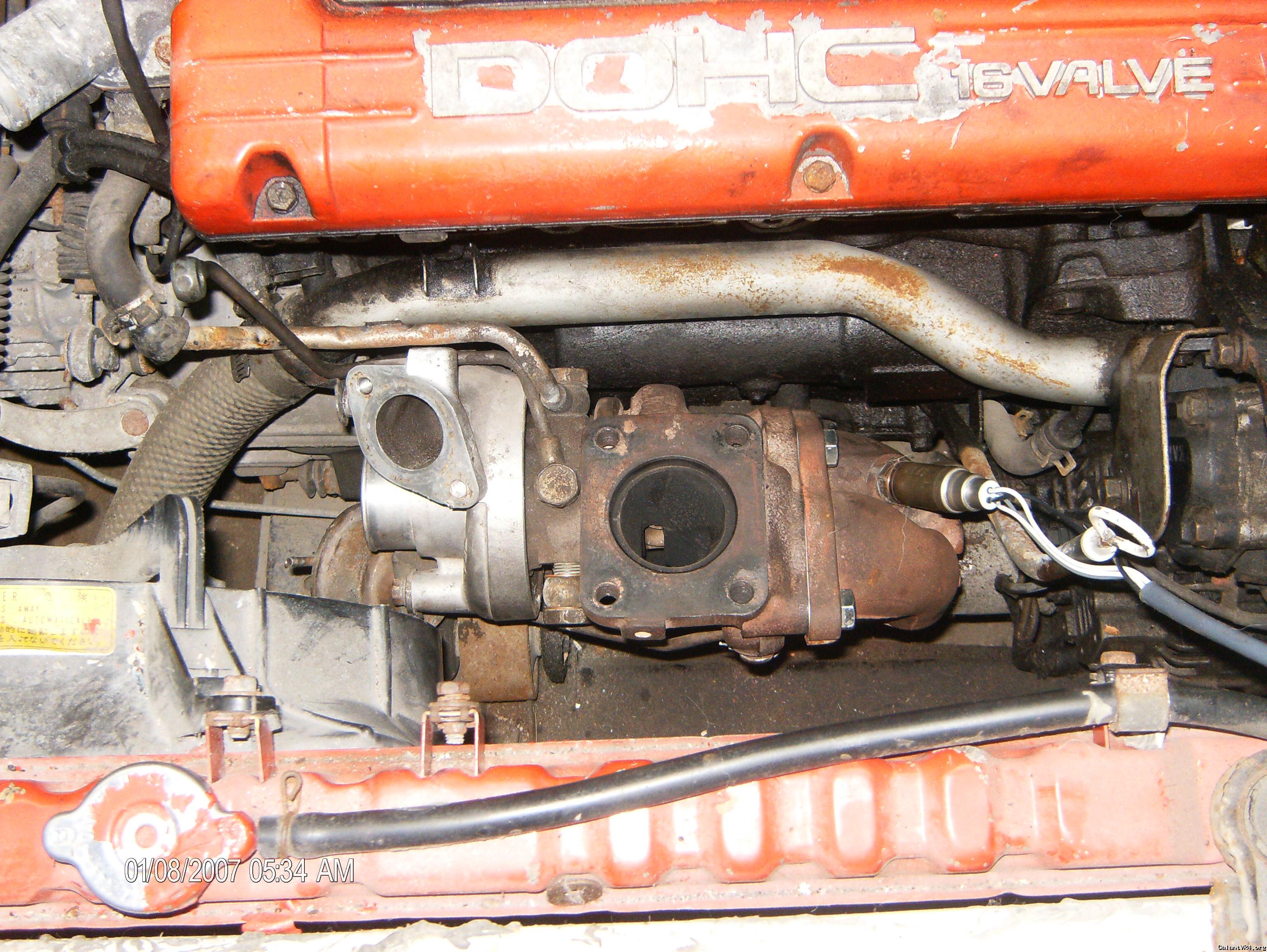

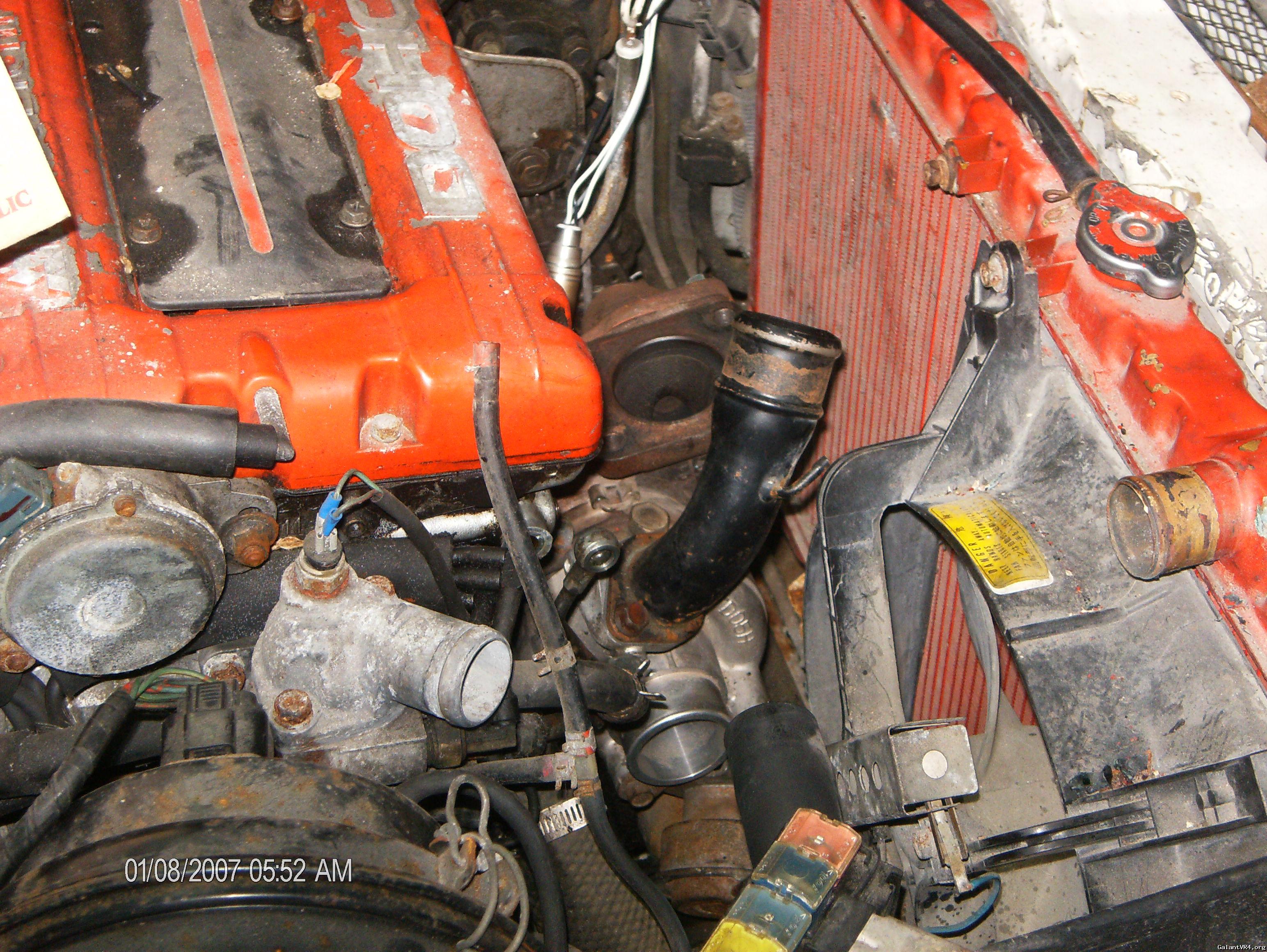

Just thought I would post some update pics since I worked on the galant for a bit tonight. I got the O2 houseing and turbo installed. Connected all the oil and water lines to the turbo, except for the one that connects the oil line to head. I am missing the bolt for that one, does anyone know what size that bolt is and is that something I can get at autozone. I also decided to clean out the trunk and in doing so buried in the back I found my missing intercooler hose /ubbthreads/images/graemlins/smile.gif. Here are some pictures of my progress.

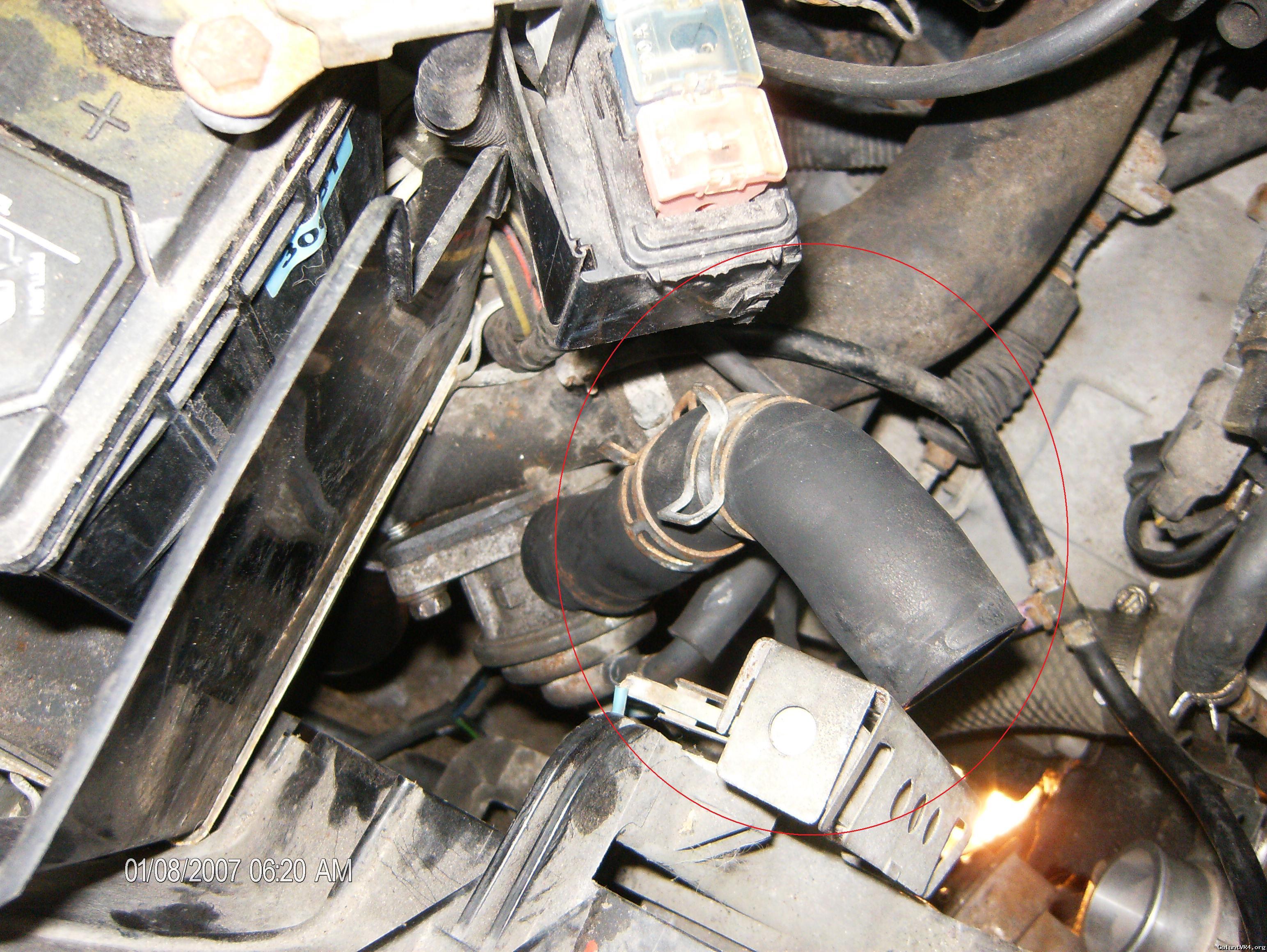

I have two questions for you guys now and I have pictures to accompany the questions. My first question is where does the hose that comes off of the blow off valve connect to? The hose in question is circled in red.

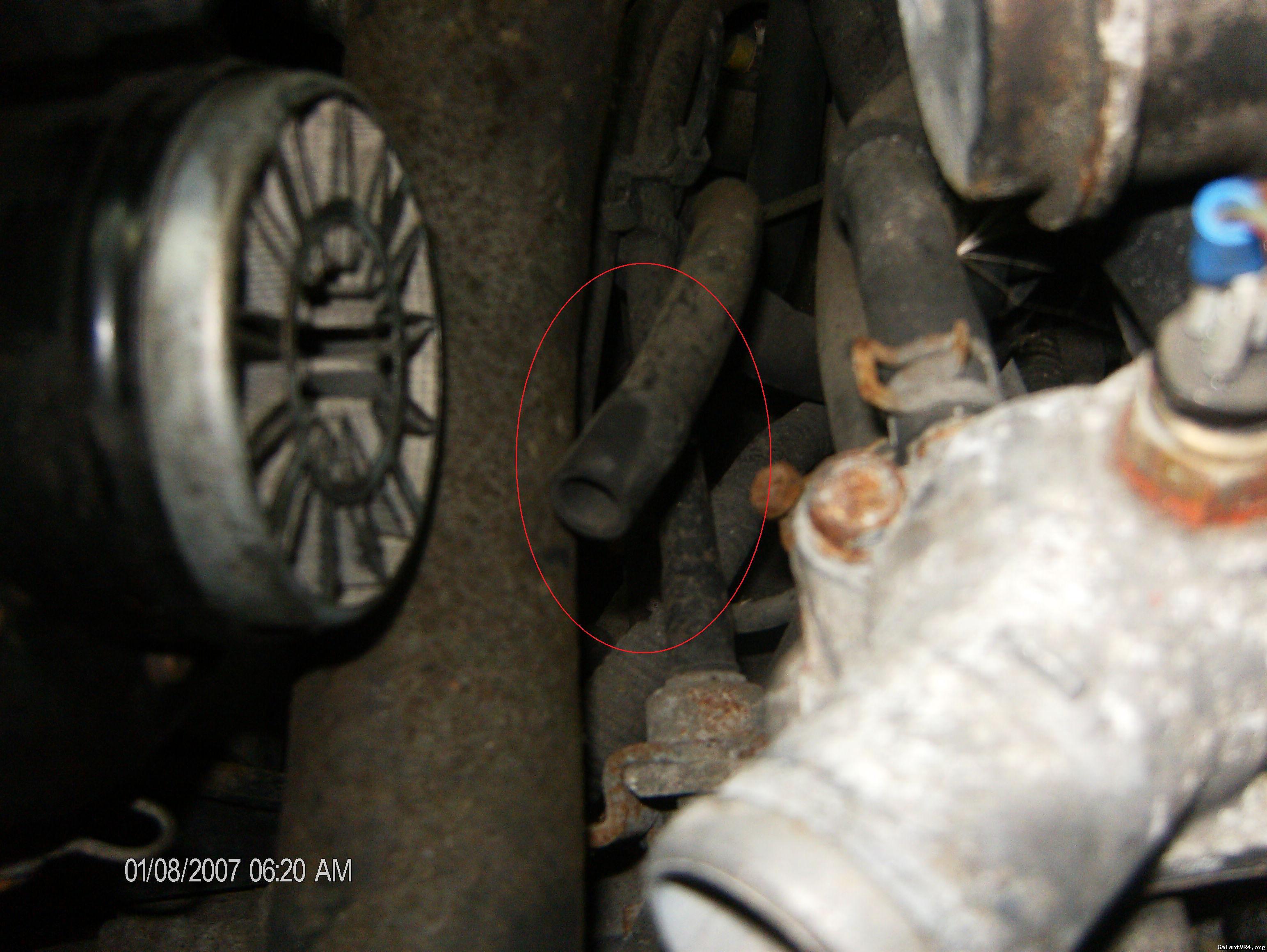

I found a hose towards the back of the motor that I can not figure out where it goes. Here is the picture I took of it the hose is circled in red.
If you guys want me to post any more pictures to help you help me I would be more than happy to. Thanks in advance for your help.
The BOV hose connects to the intake pipe.( recirculation hose)
The other hose looks to be one of the charcoal canister hose's. Not sure about that one from the pics. /ubbthreads/images/graemlins/dunno.gif
Hope this helps a little.
