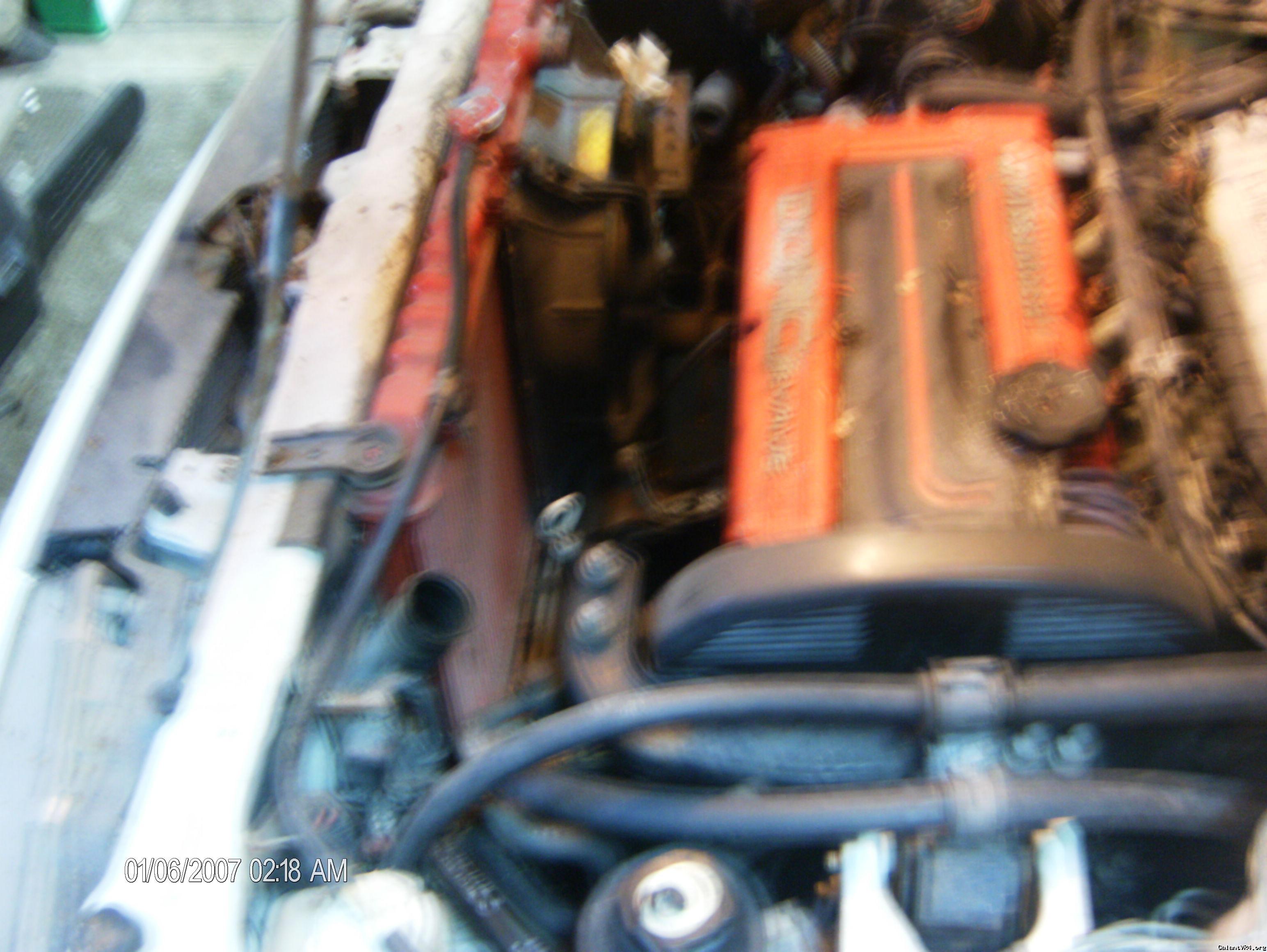

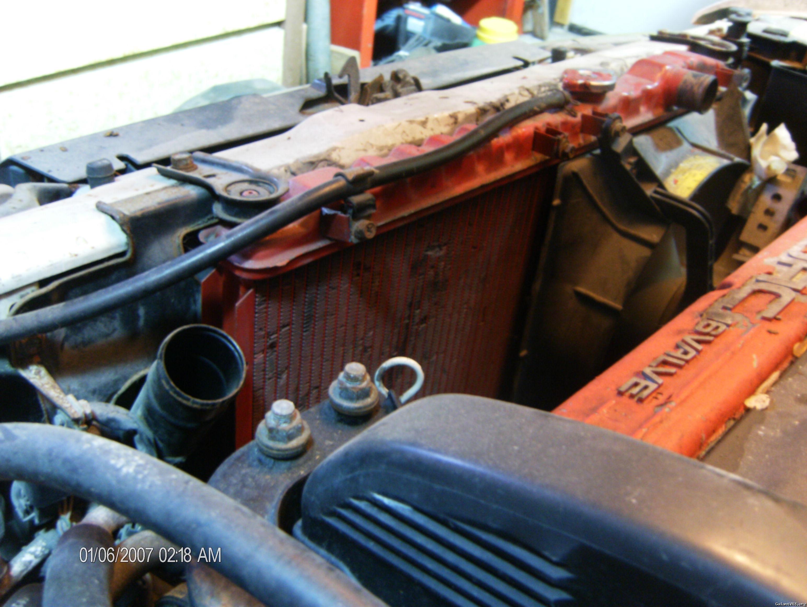

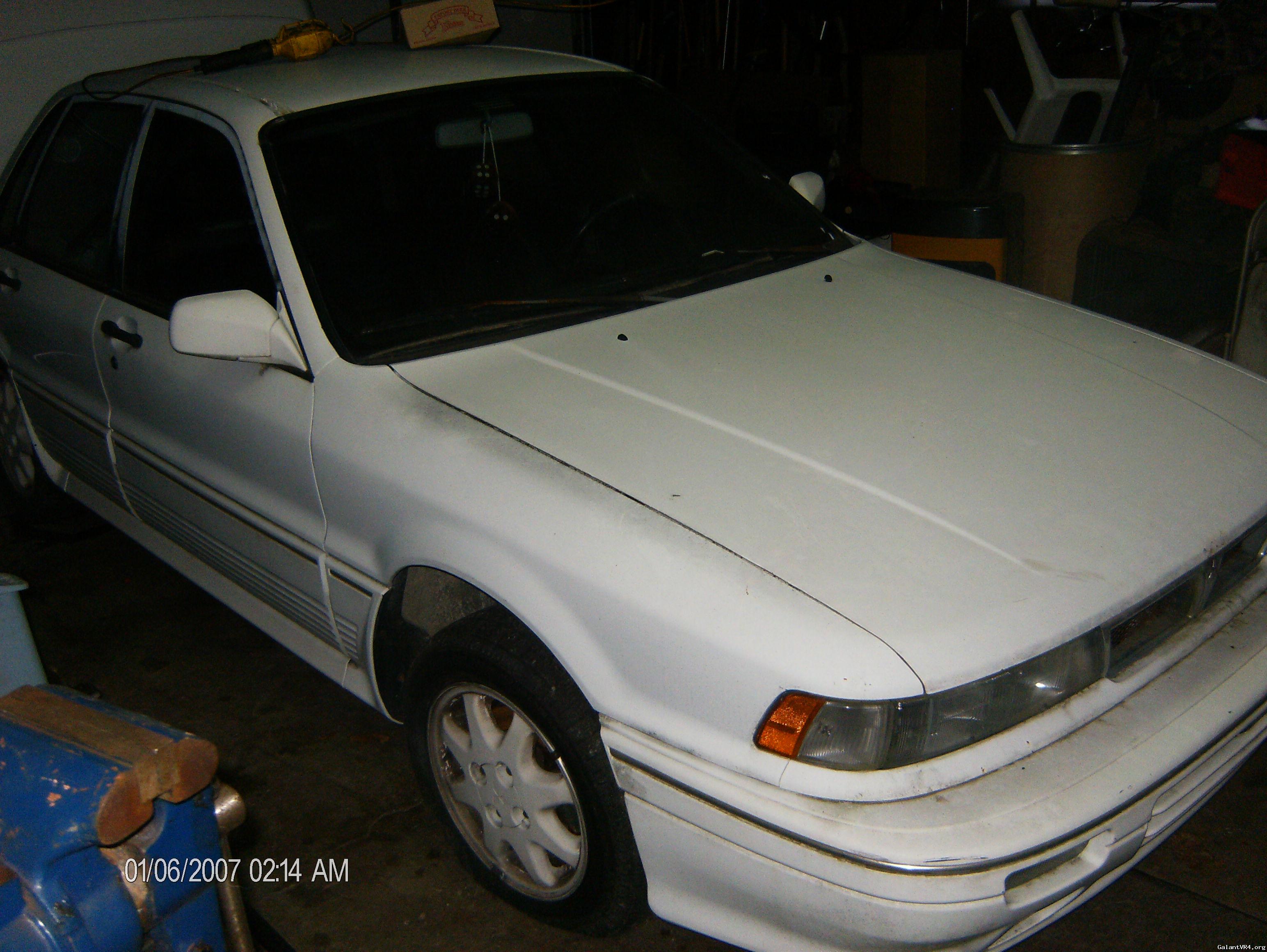

The piece I need comes out by the radiator on the drivers side of the vehicle from their I beleive it goes to the turbo. So far I have purchased a 14b turbo and a 1g bov for the car. I ordered all the gasket I need from rockauto. The only thing I'm still missing is the above mentioned piece. My gaskets should be in tomorrow and I will start getting her back together. I will post up some pics later tonight.

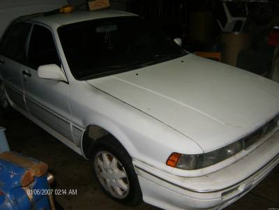

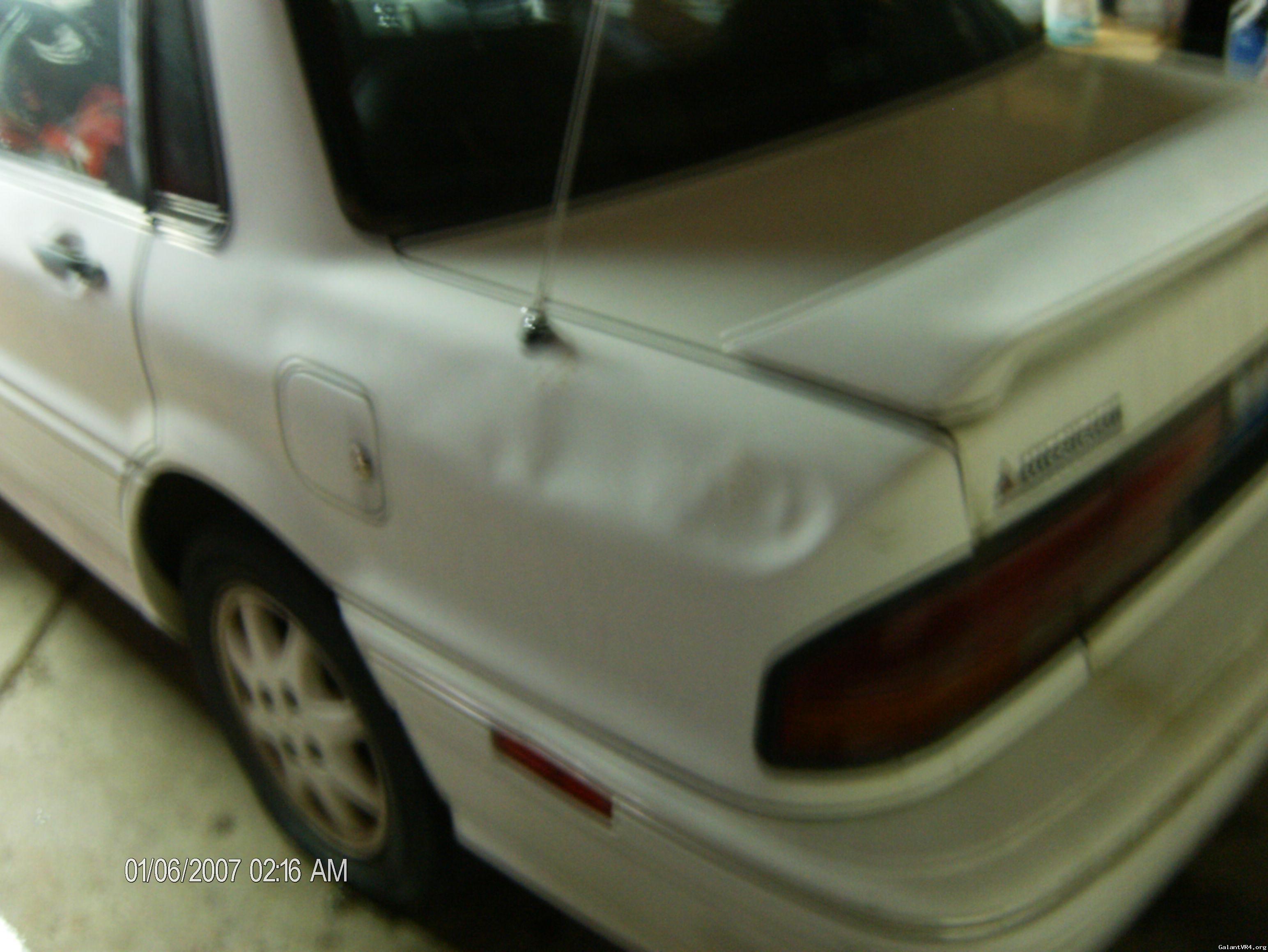

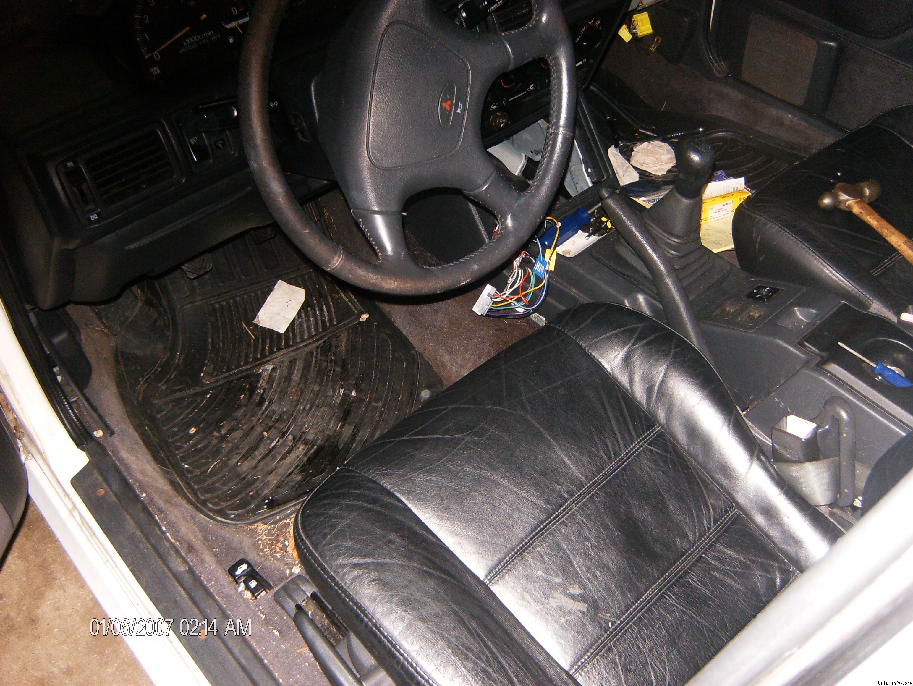

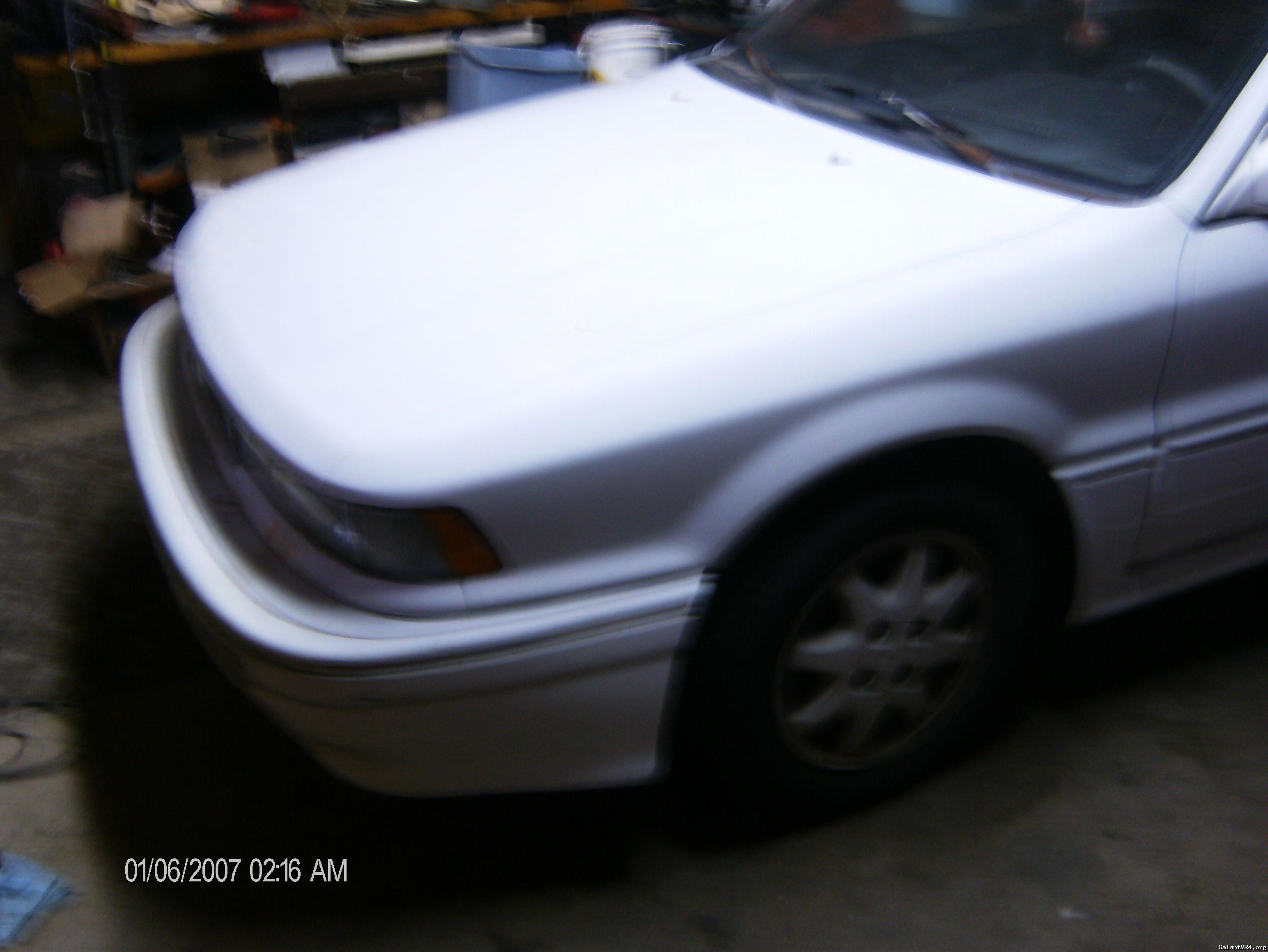

Here are some pictures I took earlier today.
The following pictures are the spot where I'm missing the intercooler piping.
a lil rough and yeah its missin some stuff, but for the price thats a steal!
