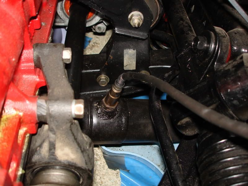

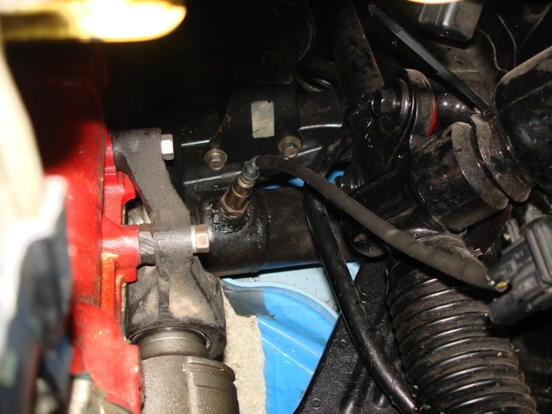

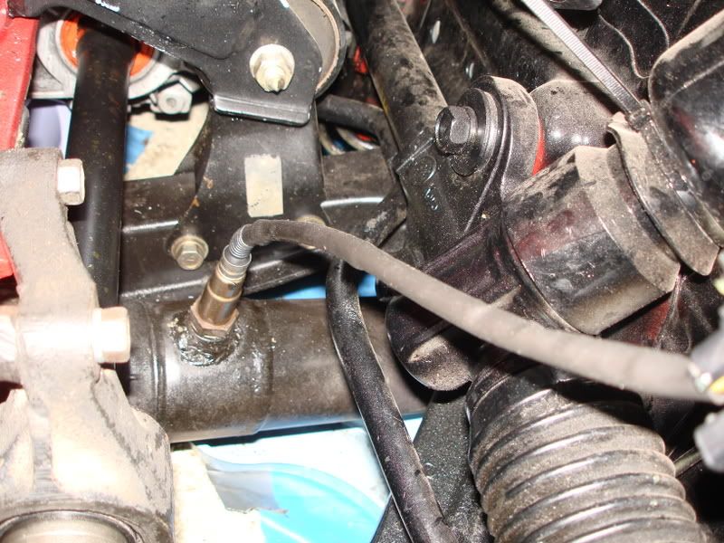

mine said 18-24" from the turbine exit, so it's right just ahead of the steering rack on the drivers side, relatively convenient location. I'll second what Terry is saying about the angle. Mine is at like 1:30-2pm if you're looking towards the back of the car.

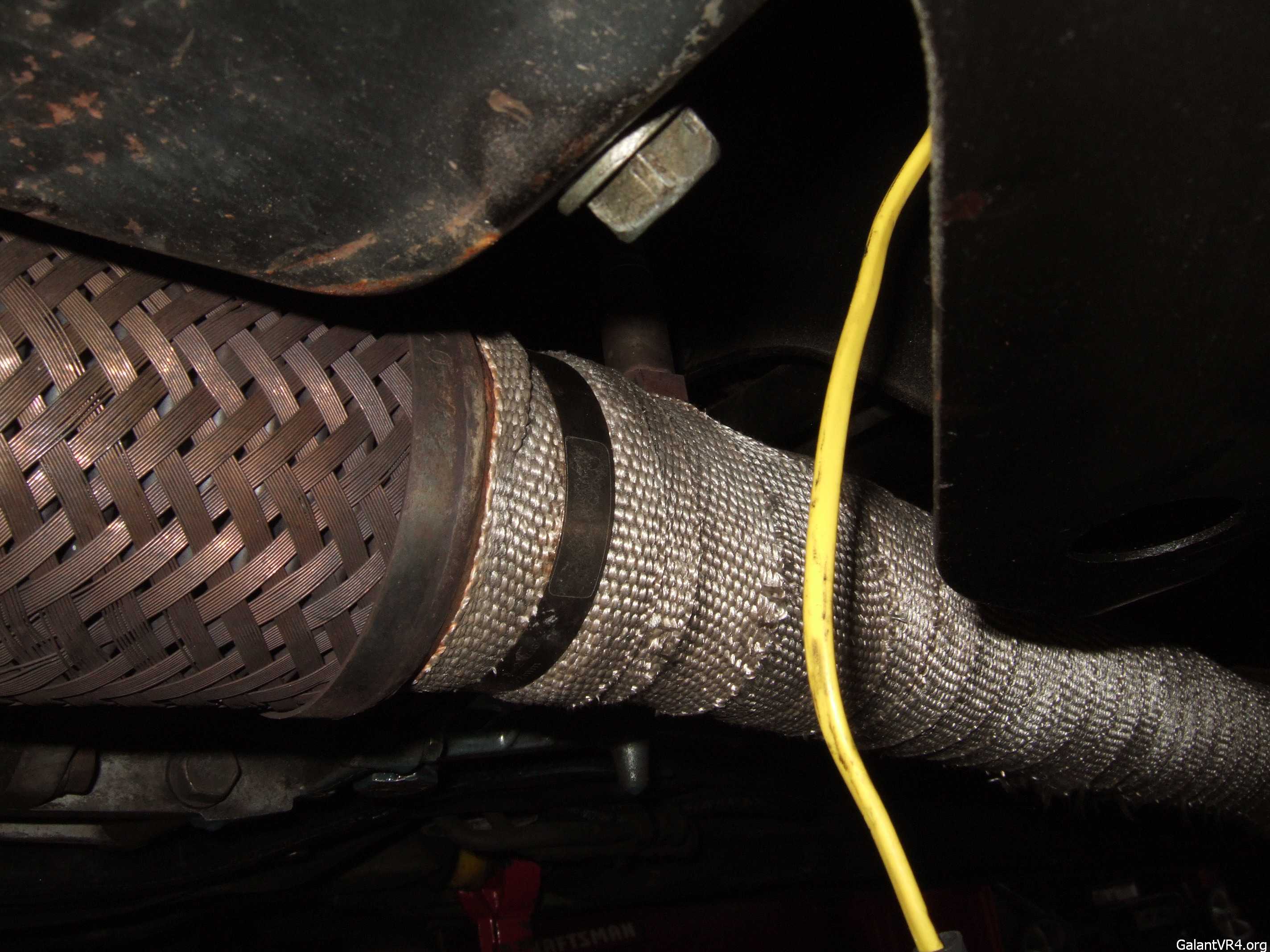

On a 4G63 powered colt, fwd car but still. AEM UEGO wideband
