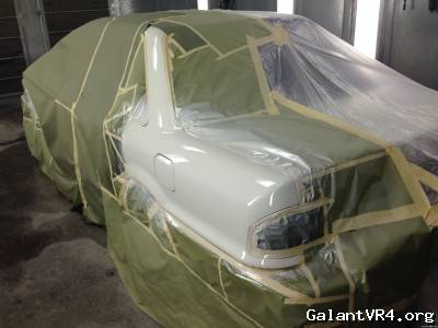

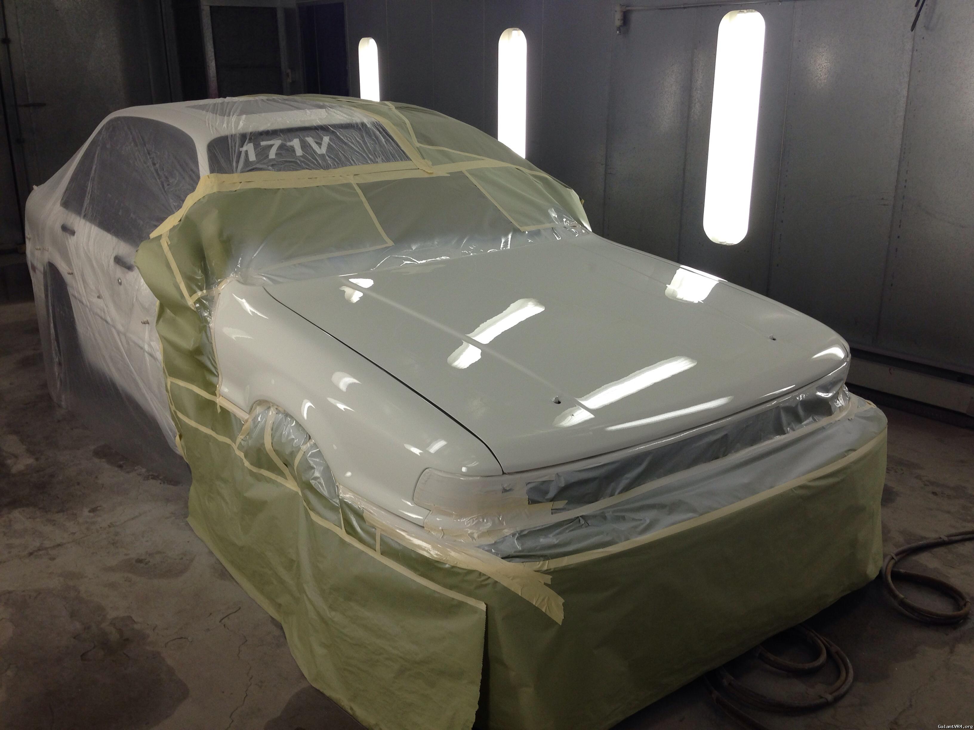

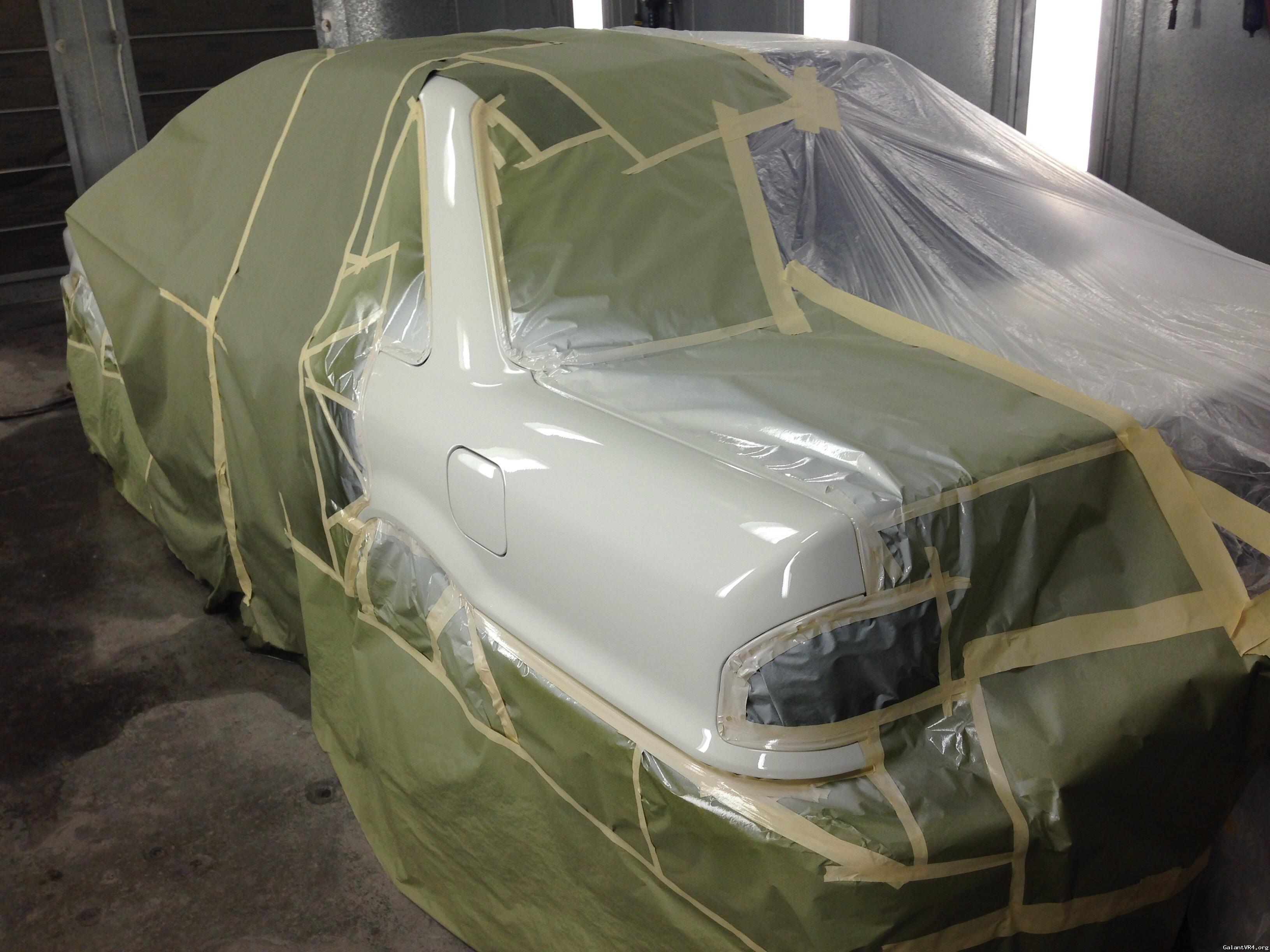

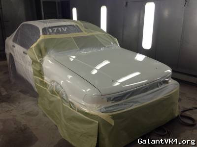

Since a few motor parts decided they wanted to try and leave thru the carbon fiber hood - I took the time to repair the hood, take care of a few minor dents on the top of the fenders (from people leaning on them- you know who you are /ubbthreads/images/graemlins/grin.gif ) . Since I was doing bodywork anyhow - decided to shave the antenna at the same time !! 431 is super mint again /ubbthreads/images/graemlins/devil.gif

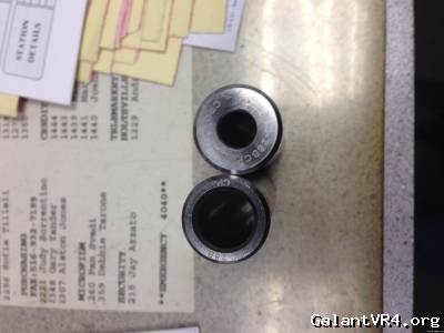

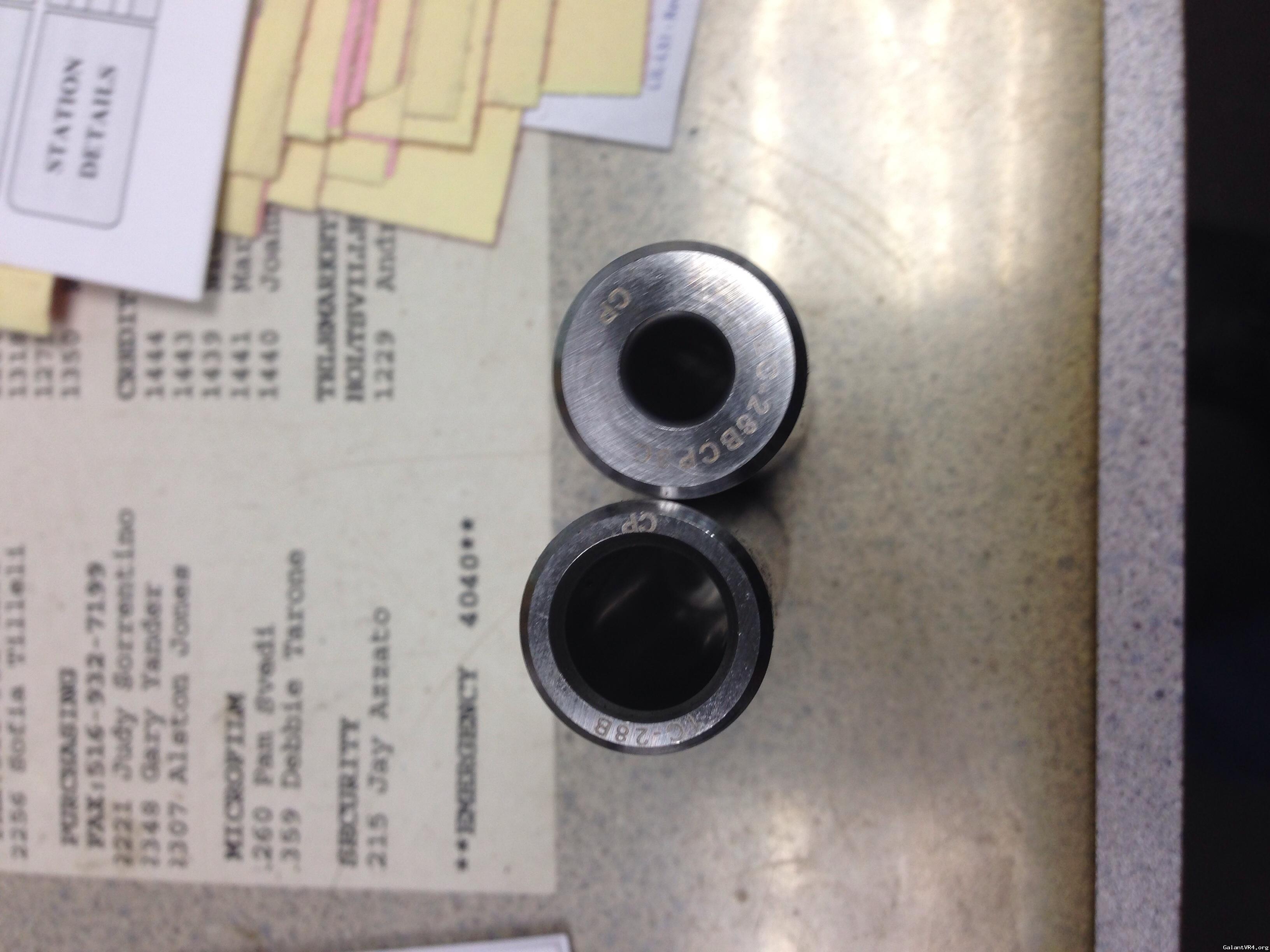

John,
After breaking down the motor - I found the 3 other wrist pins were bent. This was confirmation that the wrist pin in cylinder 1 did fail !!
Hopefully we can figure out this wrist pin issue !
Here is a video showing one of the wrist pins on the lathe
Gizmovr4
Nov 18, 2009
366
andover,NJ
One of the old wrist pins vs one of the new pins !! Let's see if we bend these /ubbthreads/images/graemlins/grin.gif
