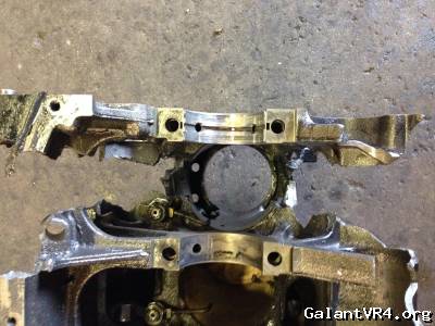

Curtis, the wrist pins were standard tapered pins. I talked with CP tech guy today to discuss pin options. Turns out the pistons/pins we were running in 431 were only rated to 650-750 max crank HP. According to CP the off the shelf production pistons come with the Non-heavy duty wrist pins. 431 had a set of off the shelf stoker pistons – guy was surprised how long they held together !! Guess 431 made more than 751 crank HP <img src="/ubbthreads/images/graemlins/wink.gif" alt="" />

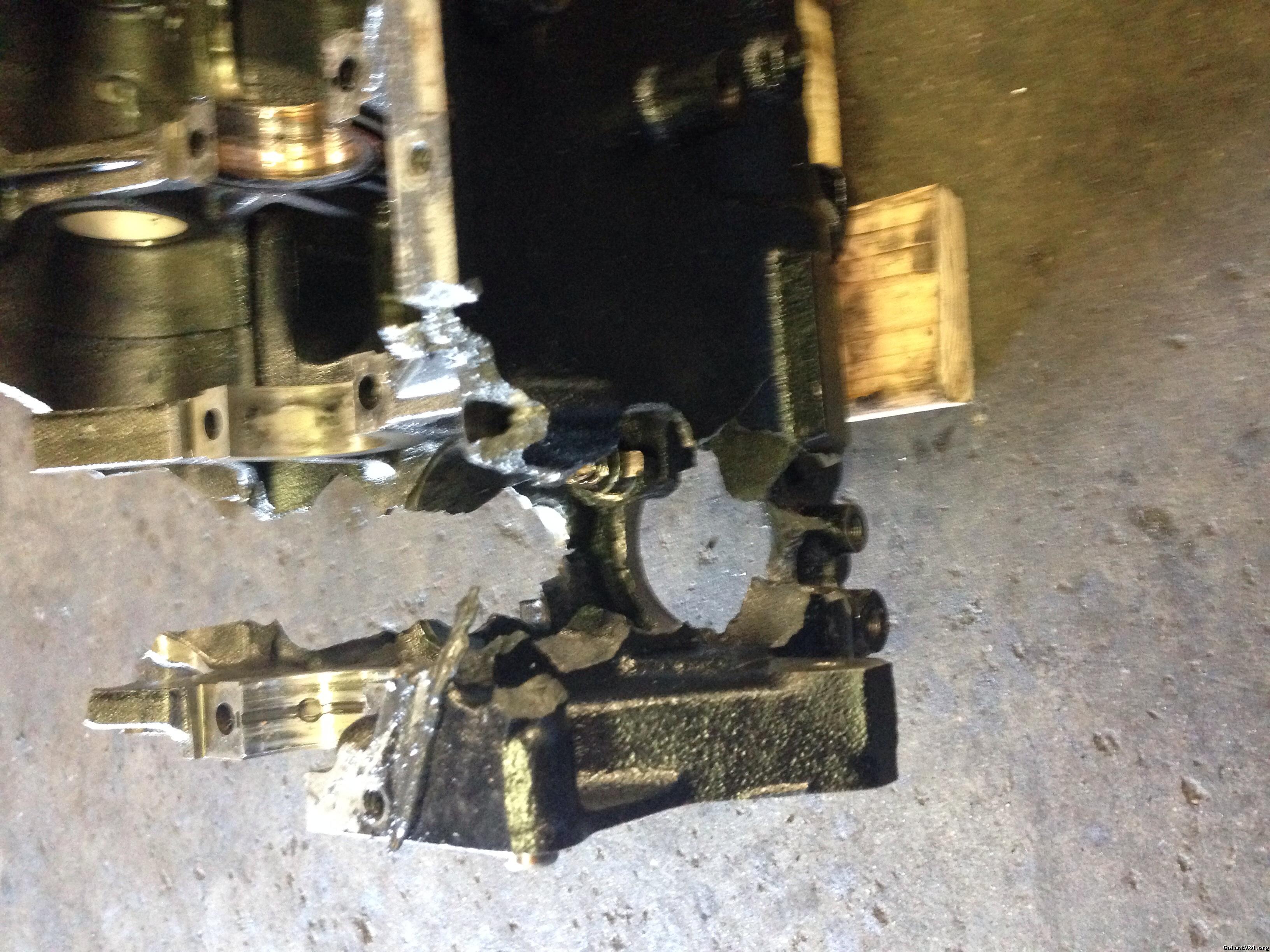

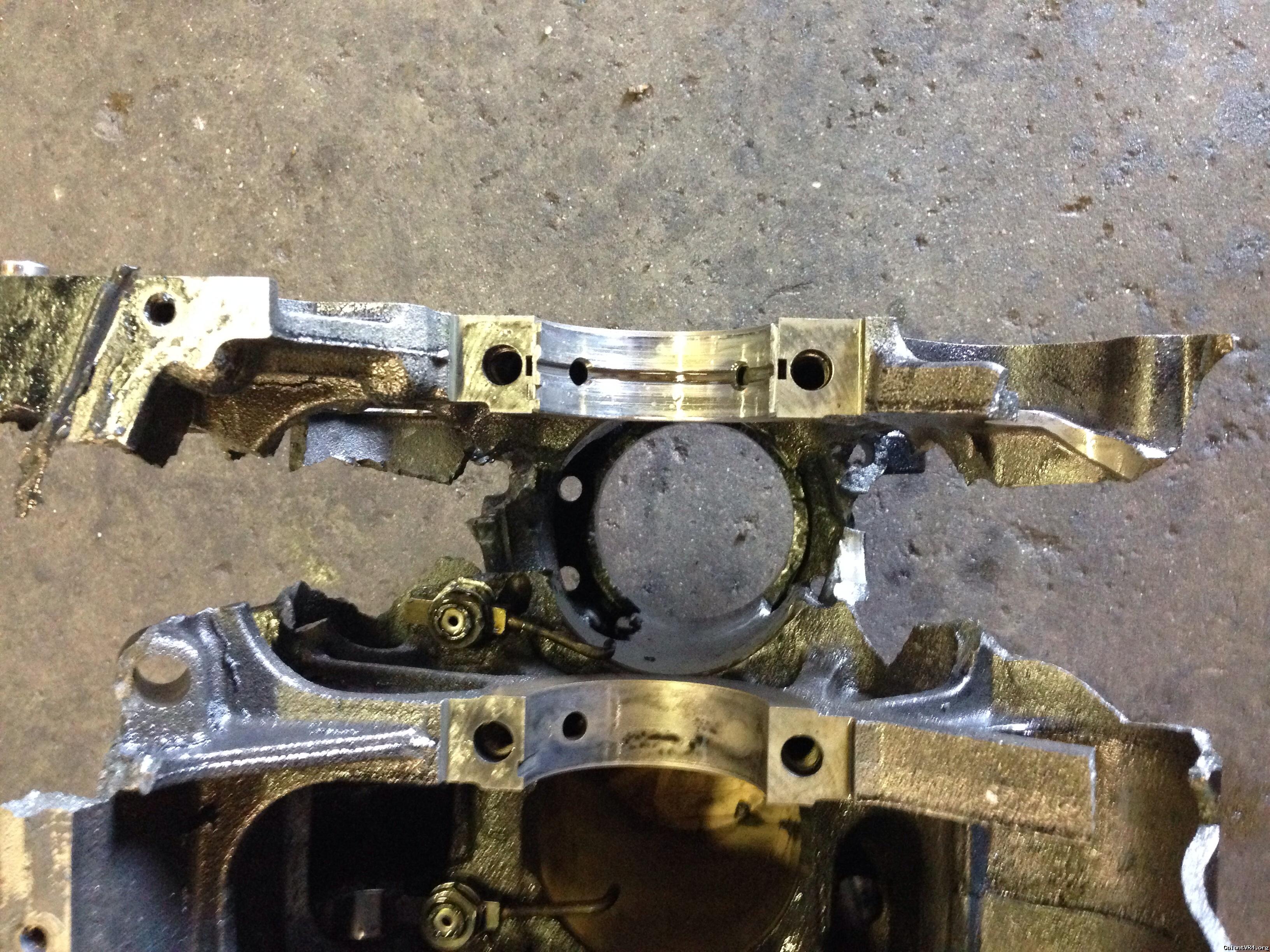

Damn Nelson. I think you surpassed "windowing" the block and went straight for windows, doors and a skylight! Sucks to see, but glad you have an upgrade/rebuild plan already in the works.

All I can say is WOW! Too bad, but you have to expect interesting results when pushing the envelope this hard.

man sucks to hear about her popping on you! that is some carnage tho! Glad you are ok and nothing else catastrophic happened!
