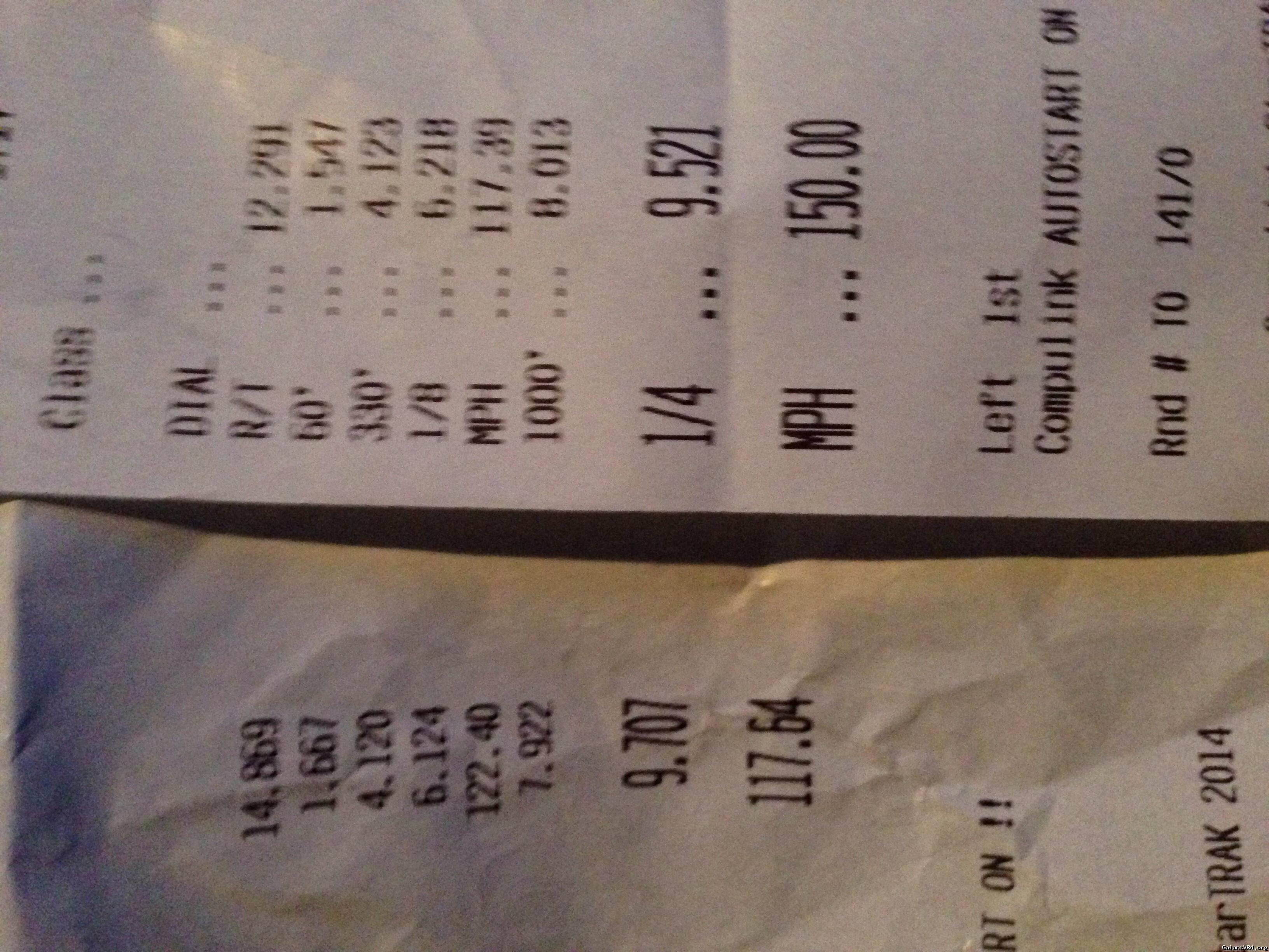

Recap of the day :
First run - 10.2 @ 138 no launch just second and third gear pull @30psi to test boost control
Second run- 9.521@150 mph soft launch - car pulled hard up top - thus the 150mph trap and only 117mph at the 1/8 mile
Third run - 9.707 @117 mph car left hard !! 1/8 at 122mph ( 5mph faster than run#2) when the car shifted to 3rd we suffered the engine failure !! Still went 9.7 breaking at half track /ubbthreads/images/graemlins/devil.gif

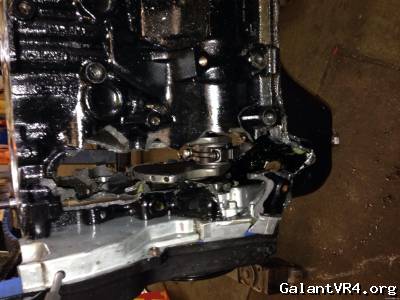

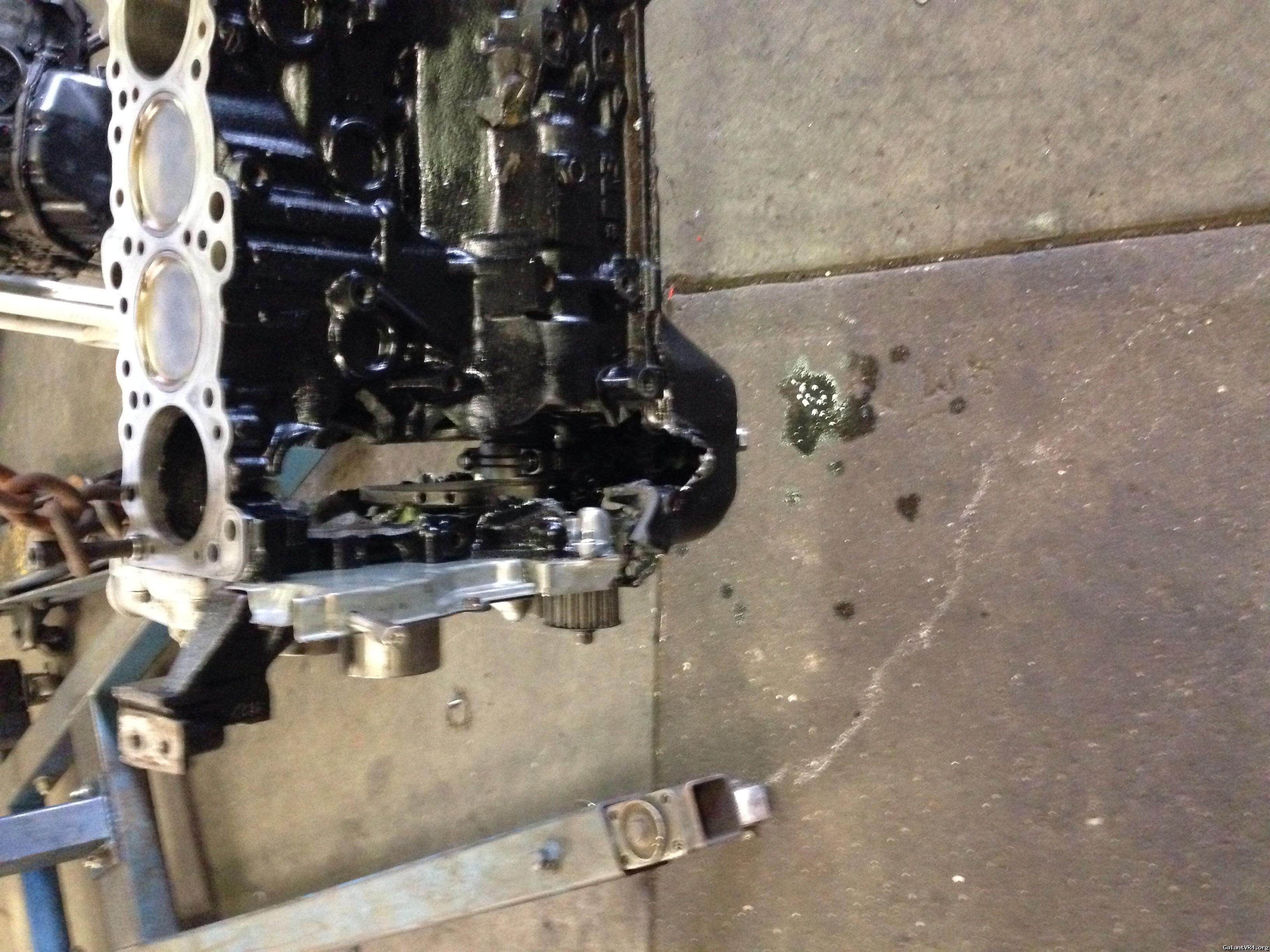

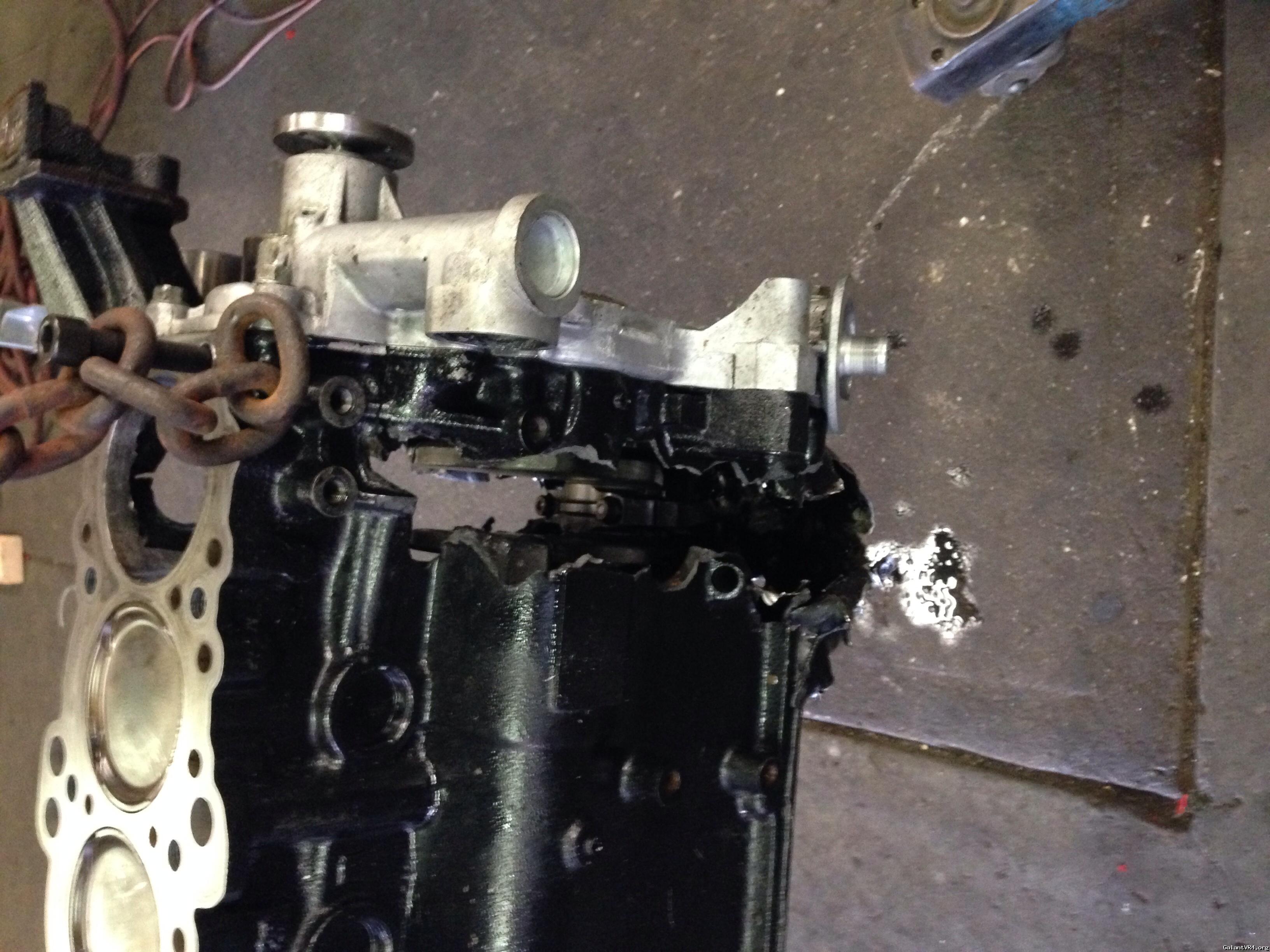

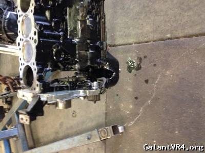

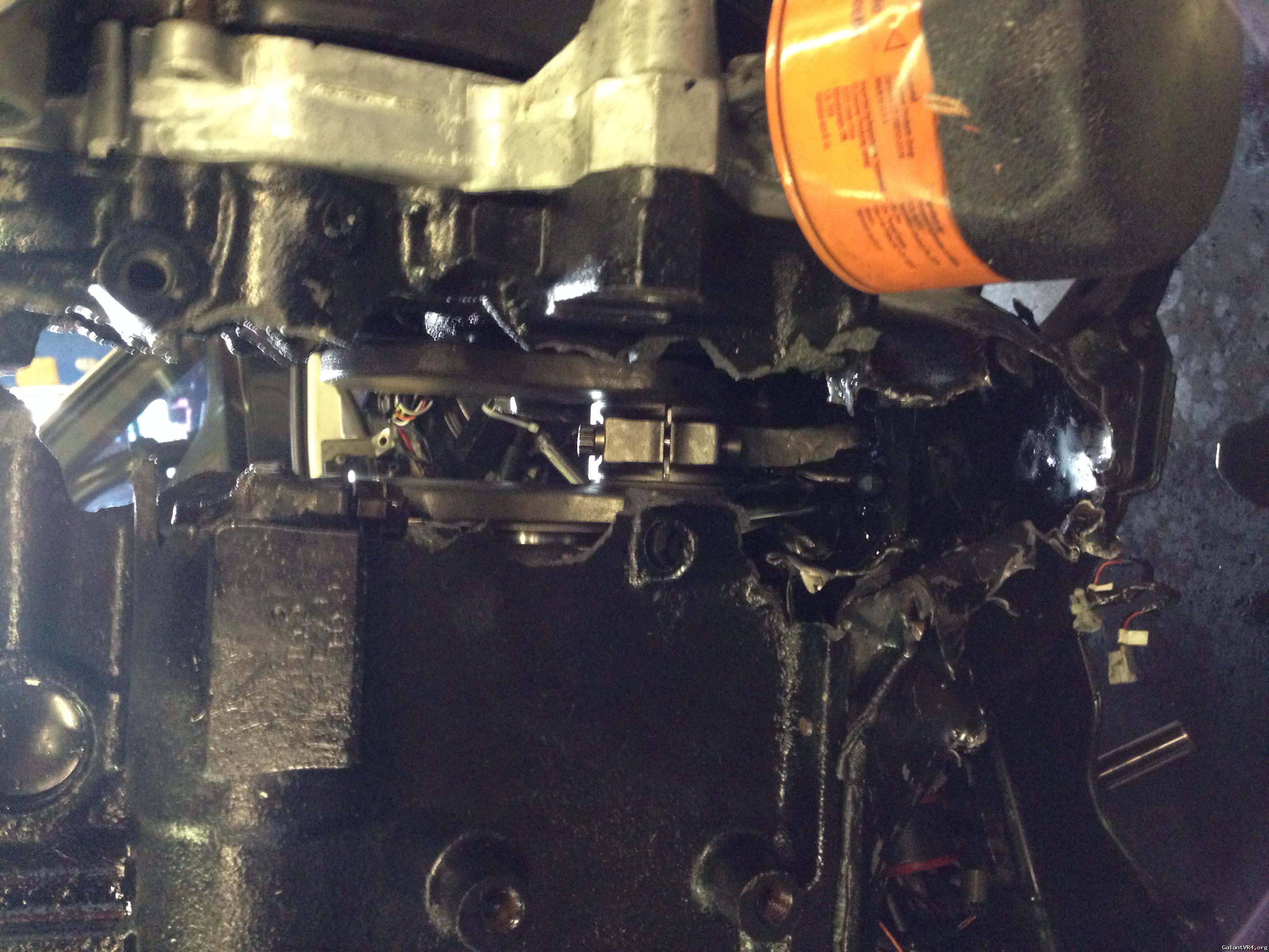

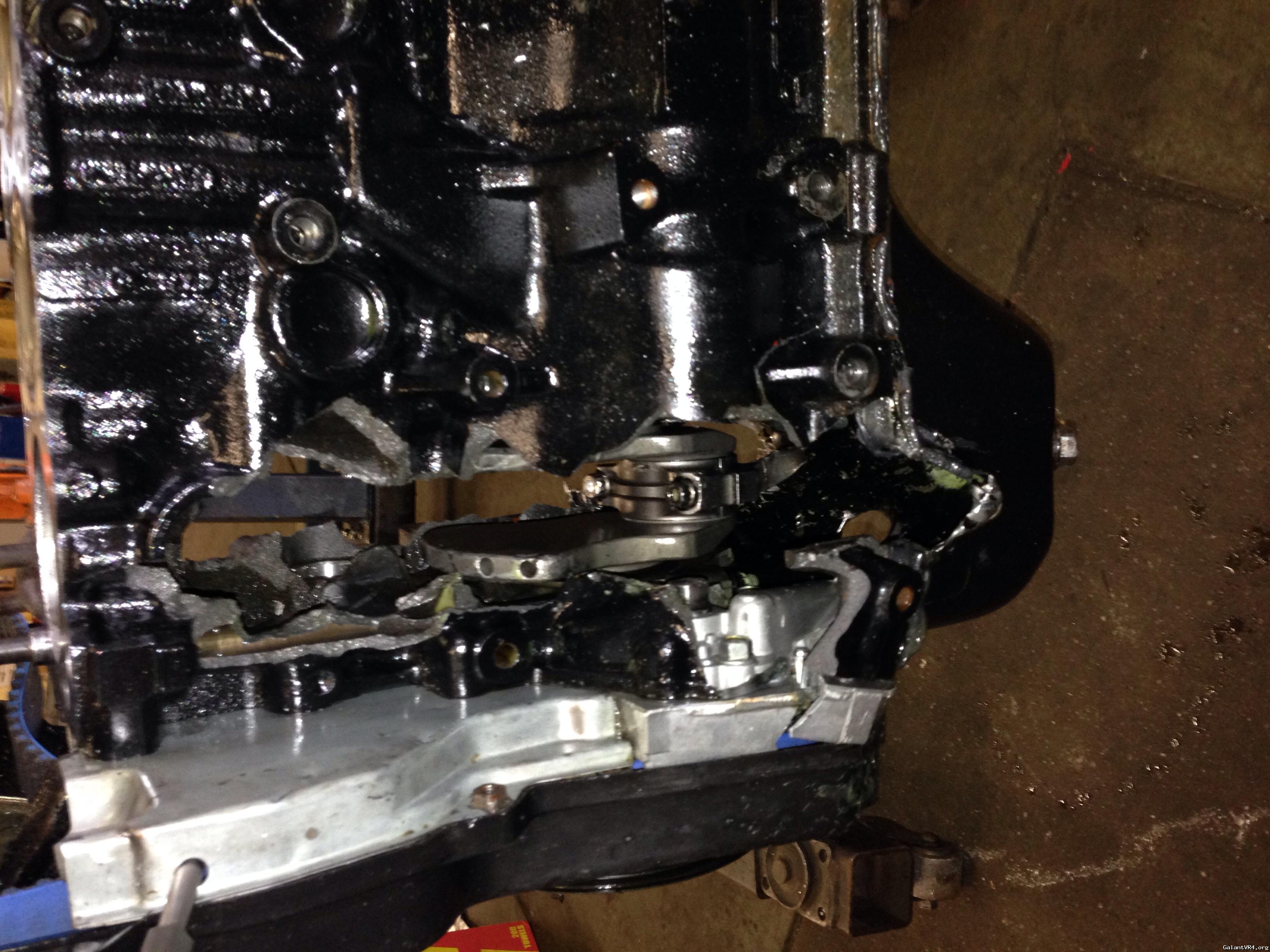

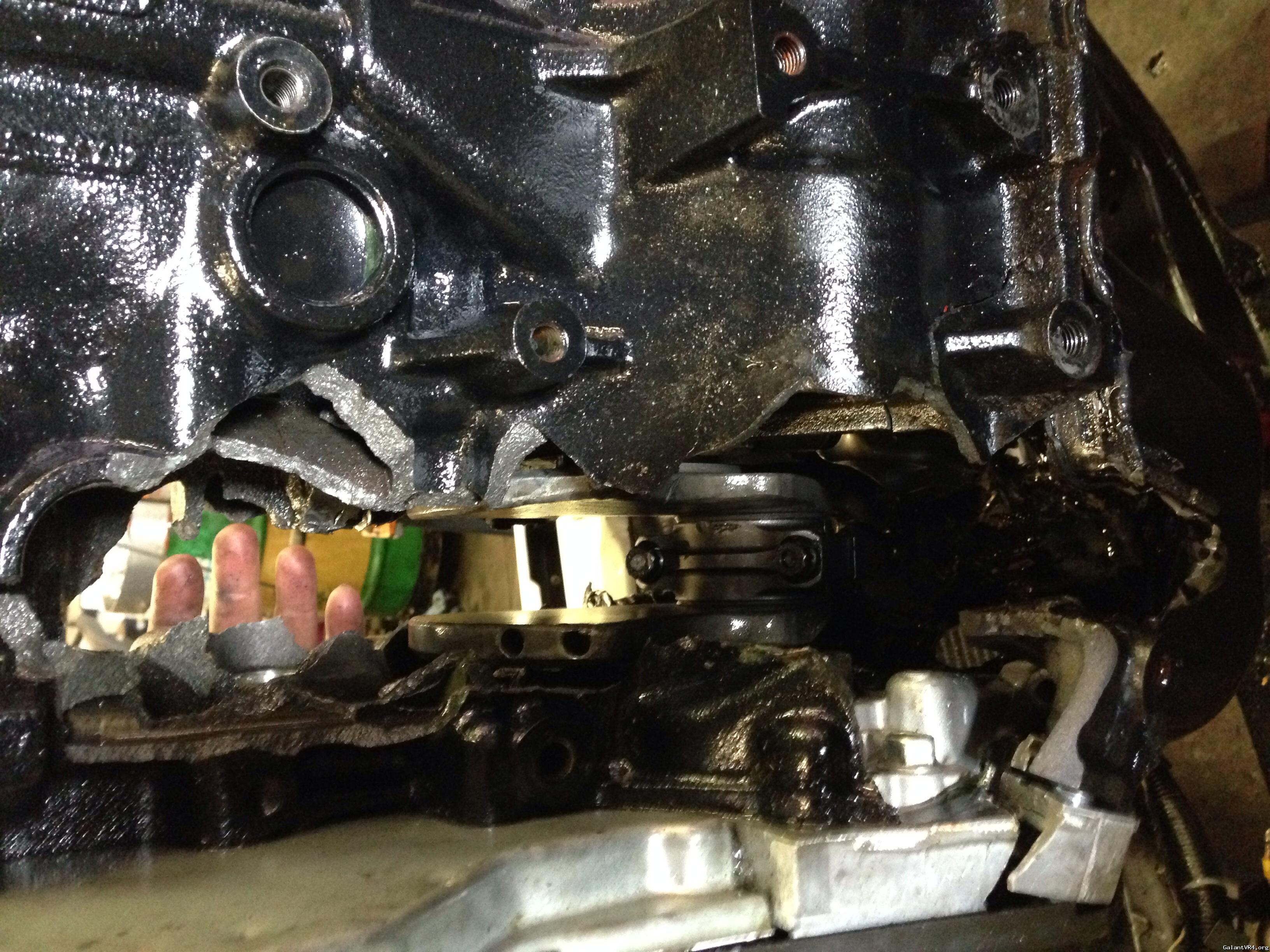

Here are pictures of the engine failure ..... Rod nearly split the engine in half - only held together by small piece on the deck !!
After reviewing the parts and block .... The remainder of the pistons and rods look great including the spark plugs and valves. The damage is isolated to #1 cylinder only ! This was at 48psi - most boost we have run thru this 2.3 liter combo.

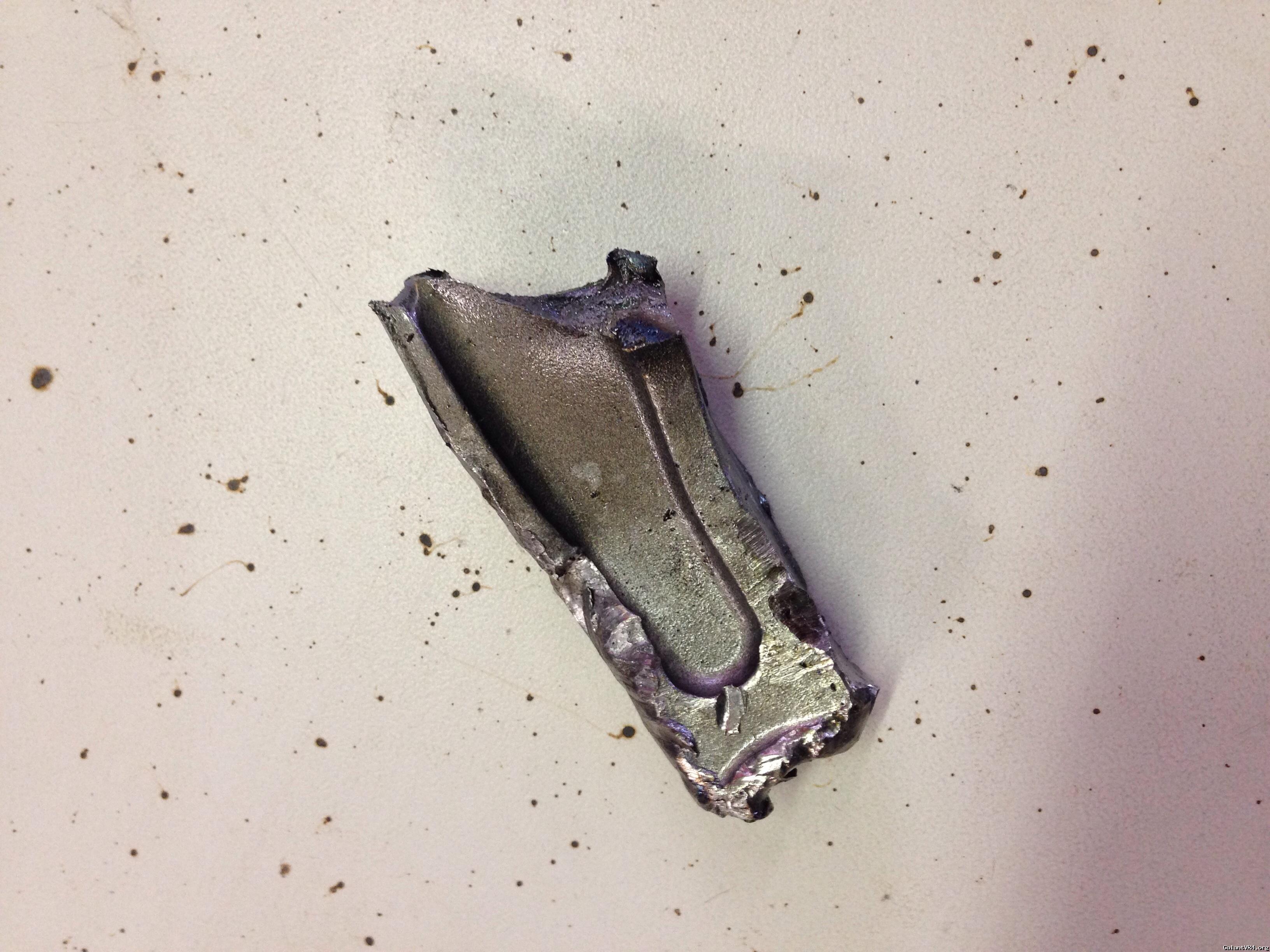

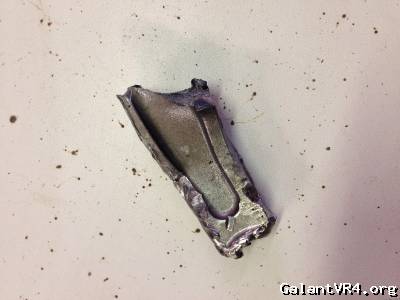

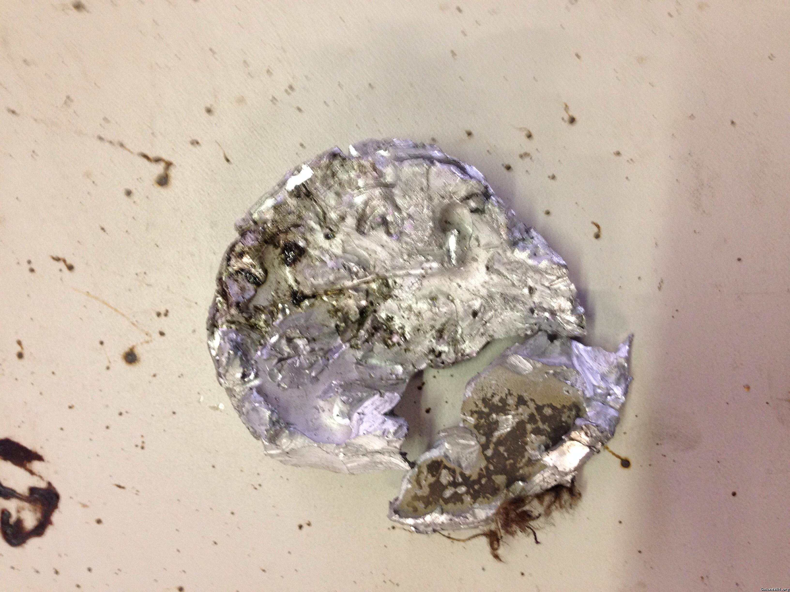

Due to the height and extent of the damage we believe the wrist pin may have failed - causing the rod to spin out both sides !!

Found the piston on top of the transmission !!!

literally, the connecting rod cut the block in half! We are assuming the wrist pin shattered...leaving the piston at TDC (to smash up valves). Then the rod just swung around free and smashed all the black/oil pan and anything it could touch. smashed the coolant water pipe and the #1 runner of the tube header, oil dipstick tube, smacked up the driver's axle jack shaft. utter destruction in 360* path of a full length con rod on a 100mm stroke crank! flying parts also cut through the nitrous feed line, and some wiring/hoses behind the motor and beat up the front/hood of the car.
funny thing: 2,3,4 pistons/rods look salvageable as are all the 2/3/4 valves and likely all the valve train parts. Nelson also thinks the crank is fine (Manly 100mm) as the big end of the rod still spins free on the journal!!!! /ubbthreads/images/graemlins/devil.gif

Hate to hear about engine failures especially this close to the goal. I have to ask....tapered wall pins or full size across the id???
