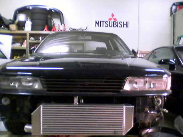

just put my ETS FMIC on

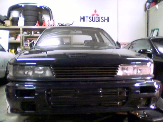

crappy camera phone pics. I didnt attatch my bumper cover. i just hung it there.
mine hangs a little low, there is about an inch of it below the bottom of the bumper opening and i could barely get the lower piece of the bumper to bolt back up to the core support

yeah im not too happy about that. the intercooler is great but i want it to be as hidden as possible, without contorting the fascia. /ubbthreads/images/graemlins/banghead.gif
I wish the core were taller or the usdm bumper was lower. I just picked up a jdm bumper so we'll see how that works but that inch of gap got on my nerves between the ic and bumper.
I think the jdm bumper has less open area if I remember CP's correctly. I hope so.
