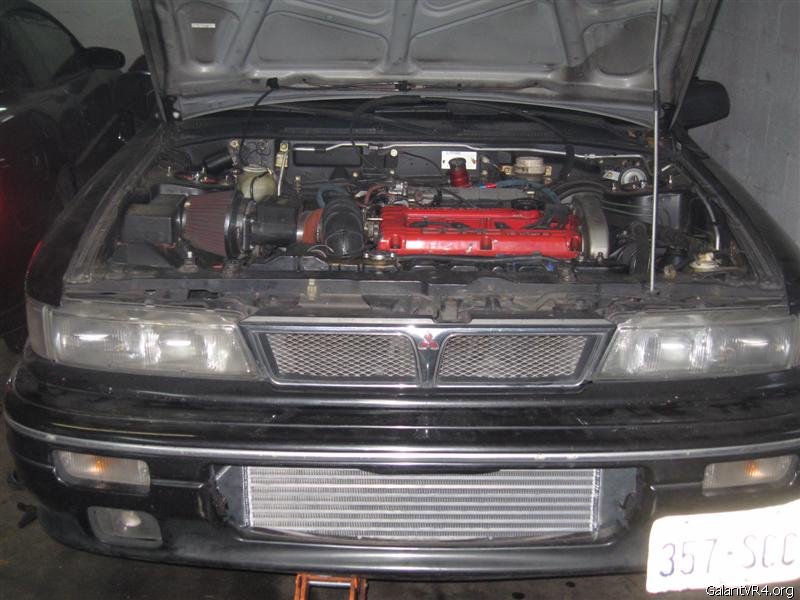

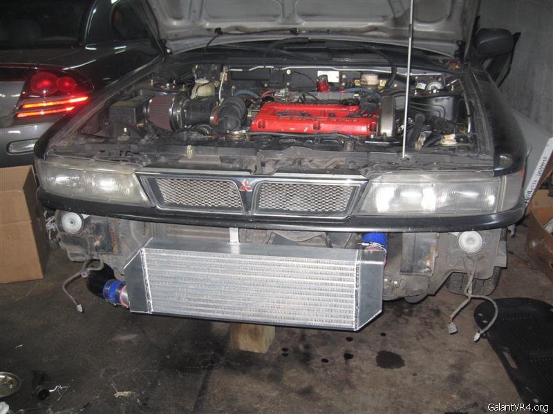

just put my ETS FMIC on

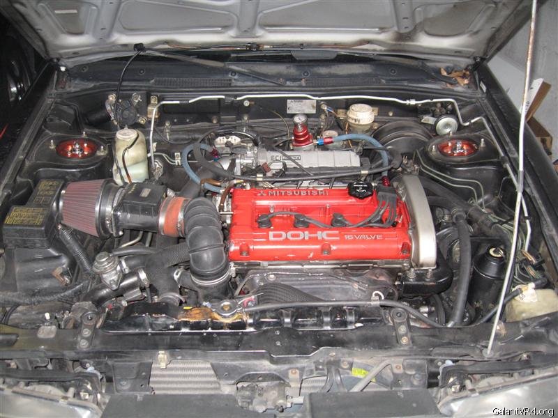

Old starion setup

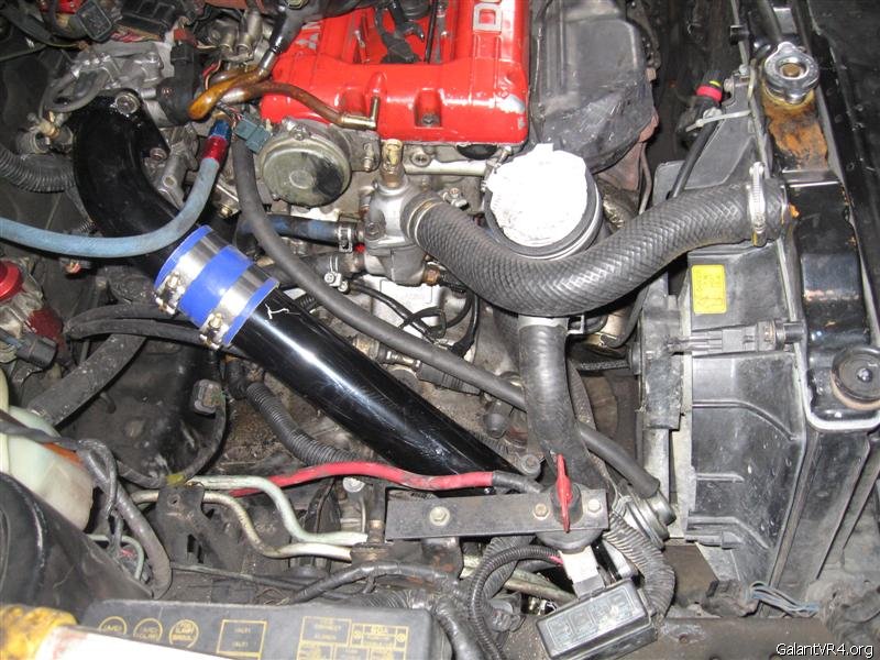

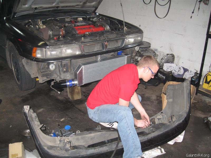

mostly radiator hose and hacked tubing
No the block isnt holding up the car
some of the new piping BOV fit pretty nice

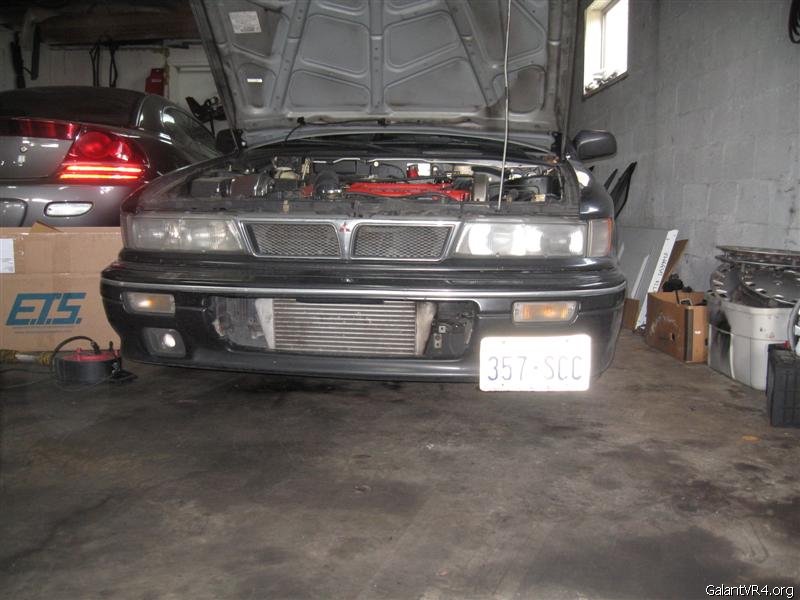

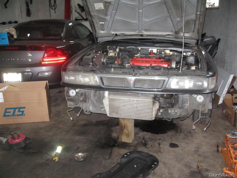

Intercooler finally installed

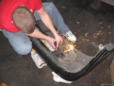

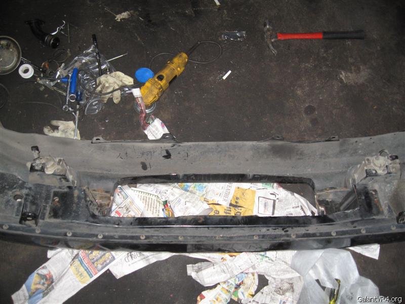

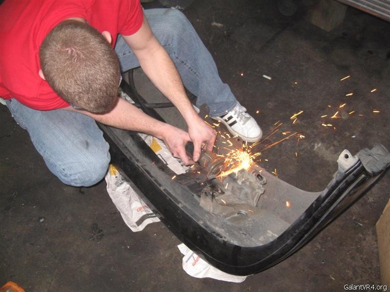

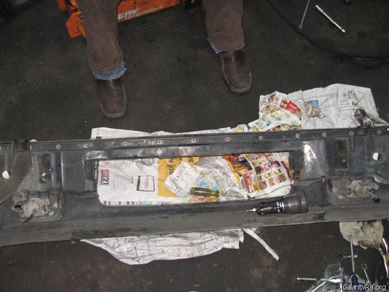

had to do more cutting on the ends of the bumper support
Only caught the paper on fire once
all mounted up

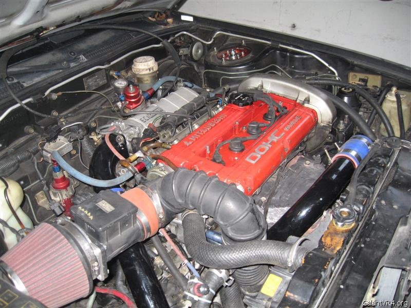

New piping

looks good, dimensions on that intercooler? think i will be picking up a bigger one soon, one of the many things on my to-do list.
Looking good! The core is 24x10x3 and you can get thicker cores if you need to.
it does pull a little harder now and the BOV is louder but i mostly like he piece of mind knowing that its all sealed up instead of the old setup.

hmm, i rememeber installing one of those a while back, and the intercooler bolted to the bumper support. did they change their design? is the only thing holding that on the piece that bolts to the hood latch support?.
Yea the mount design has changed. It has 3 tabs that mount to the core support instead of the bumper support.

I couldn't get mine centered. It sits over towards the passenger side by a few inches. I couldn't care less, as it's still very functional and the intercooler can't be seen with the black misted paint.
Pic poster doesn't seem to be working tonight...
you might have it in the wrong holes. i think i saw a few that were next to the ones i used and i just guessed which ones to bolt to

The piping can only get to the intercooler on each side by very specific routes /ubbthreads/images/graemlins/dunno.gif
yeah now that i think of it the drivers side pipe pretty much dictates where the intercooler goes but i think the other holes were like an inch or to away, might be enough play in the pipes to do that /ubbthreads/images/graemlins/dunno.gif

I already messed with them all and you're right, that driver's side pipe dictates where the intercooler sits left to right.
