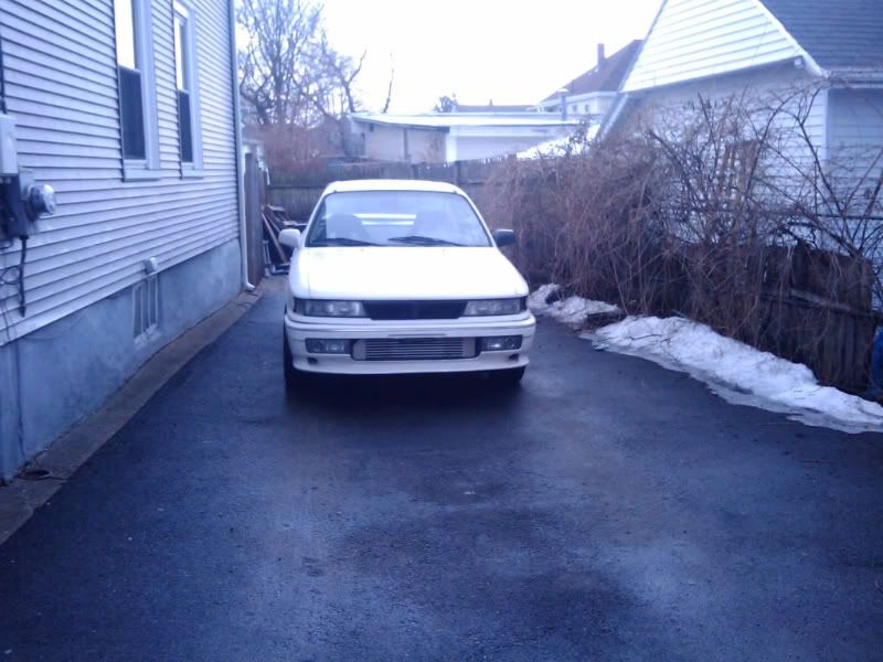

Did all pre-facelift come with projectors fogs or not? Looks like my bumper is a jdm pre-facelift with projector fogs, maybe someone replace it with projector fogs?

Quoting TakumiJr:
For the jap spec bumpers, there is no difference between pre-facelift or facelift bumpers.. yours is simply a jap spec bumper with facelift projector spotlamps, suggesting it's come from a facelifted model (october '89 onwards) VR-4, VZ-S, VX-S or 91 onwards E35A Vientos. VR-4s weren't the only one to get that bumper.
As mentioned above, the extra vents are only on the Evolution, Monte Carlo and some RS models. Same goes with the bonnet (hood) vents. There is no pre-facelift/facelift bonnet (hood) also, they're all the same.
There were only two cosmetic facelifts (ie pre-facelift/facelift which took place in October '89), but there seems to be three mechanical facelifts.
Nikk, I would say that extra 15hp comes from the 16g as opposed to the 14b.

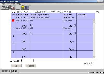

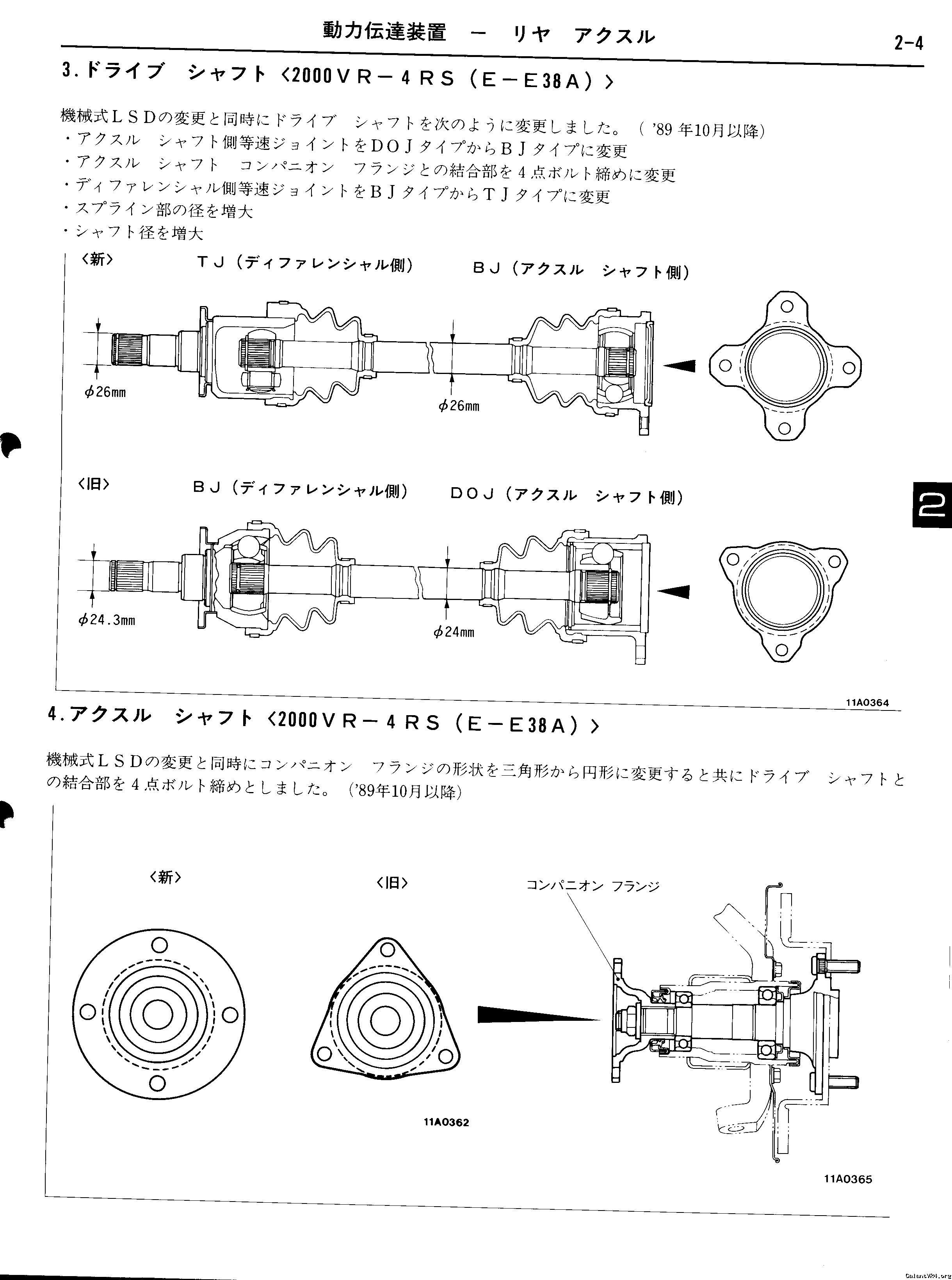

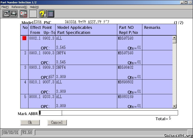

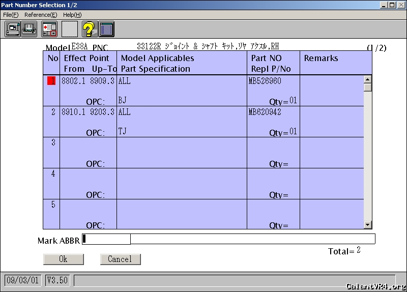

Another word or two between 'went up' and '8802.1, 8910.1 and 9008.1' would have made it clearer. I guess that's one more for proof reading! /ubbthreads/images/graemlins/laugh.gif
Yes, you would expect the RS to have the same driveline as the ones they put on street cars, but then again it's at the forefront of their motor sports program and CAPS tells a different story:
Sorry for those that can't read Japanese, but you can match the PNC numbers to CAPS USA /ubbthreads/images/graemlins/smile.gif
1: E38A SNPF4 Rear axle options;
8802.1-8909.3 BJ (equal length)
8910.1-9203.3 TJ (equal length)

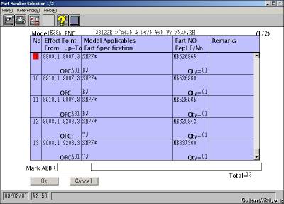

2. E39A SNPF Rear axle options;
8809.1-9007.3 BJ (Viscous LSD)
8910.1-9007.3 BJ (equal length)
8910.1-9007.3 BJ (Viscous LSD)
9008.1-9203.3 TJ (Equal length)
9008.1-9203.3 TJ (Viscous LSD)

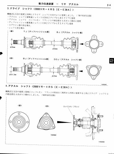

3. E38A SNPF4 Rear diff options (for shits and giggles check out #3 - a 3 bolt 3.909 ratio rear diff assembly as factory option)
The way I read that is the E38A switched to 4 bolt axles and 3.909 ratio in 8910.1 - a full 10 months before the E39A received them.
The E39A SNPF4 is a strange one. A brief check comes up with saying it came with an open rear diff and the standard gearbox but had no ABS and has manual windows.

Quoting fuel:
Quoting TakumiJr:
Actually Pre-facelift bars do differ slightly from facelift. The Pre-facelift has a vertical piece of reo behind the spotlights which needs to be cut out if you want to fit facelift projectors.

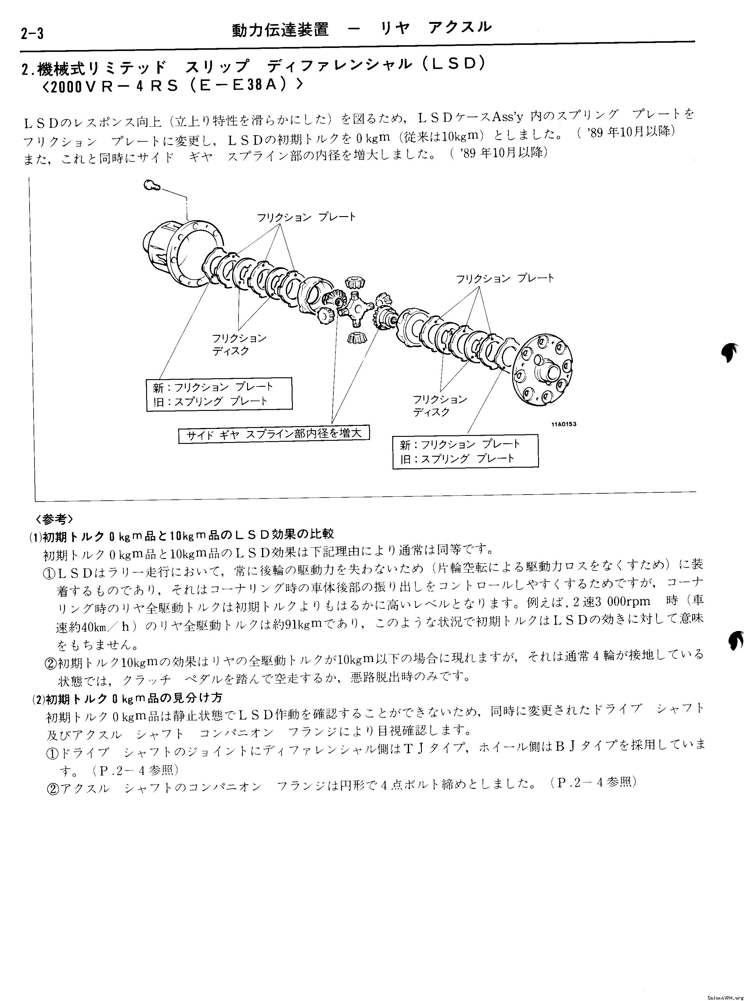

Qoutong red two
"The way I read that is the E38A switched to 4 bolt axles and 3.909 ratio in 8910.1 - a full 10 months before the E39A received them."
not true.
90.03 was the changeover for the vr4 rs.
Thats from the tech information manual.
Richard

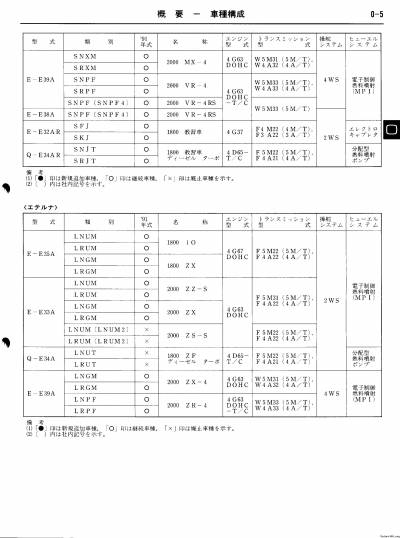

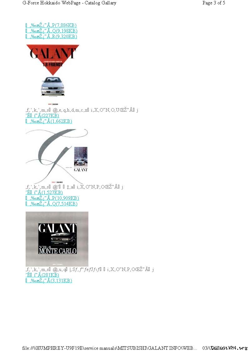

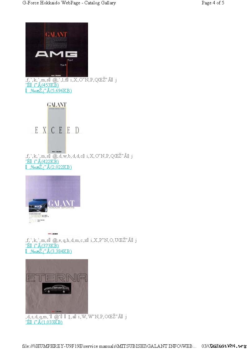

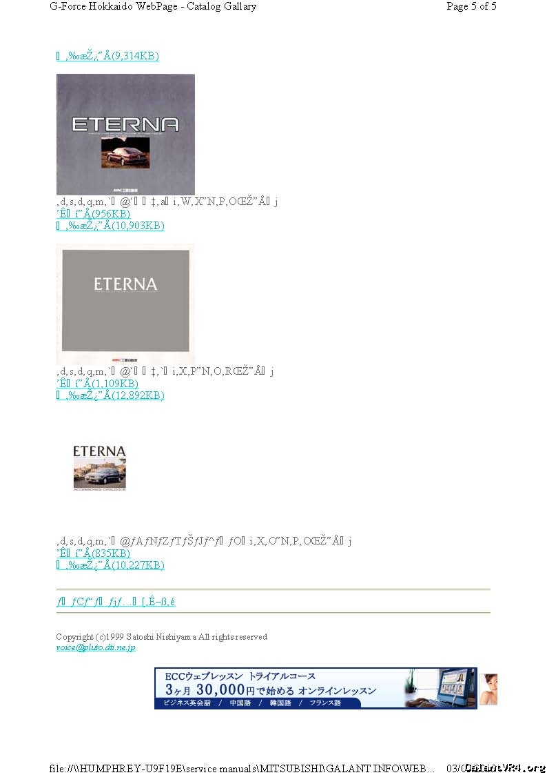

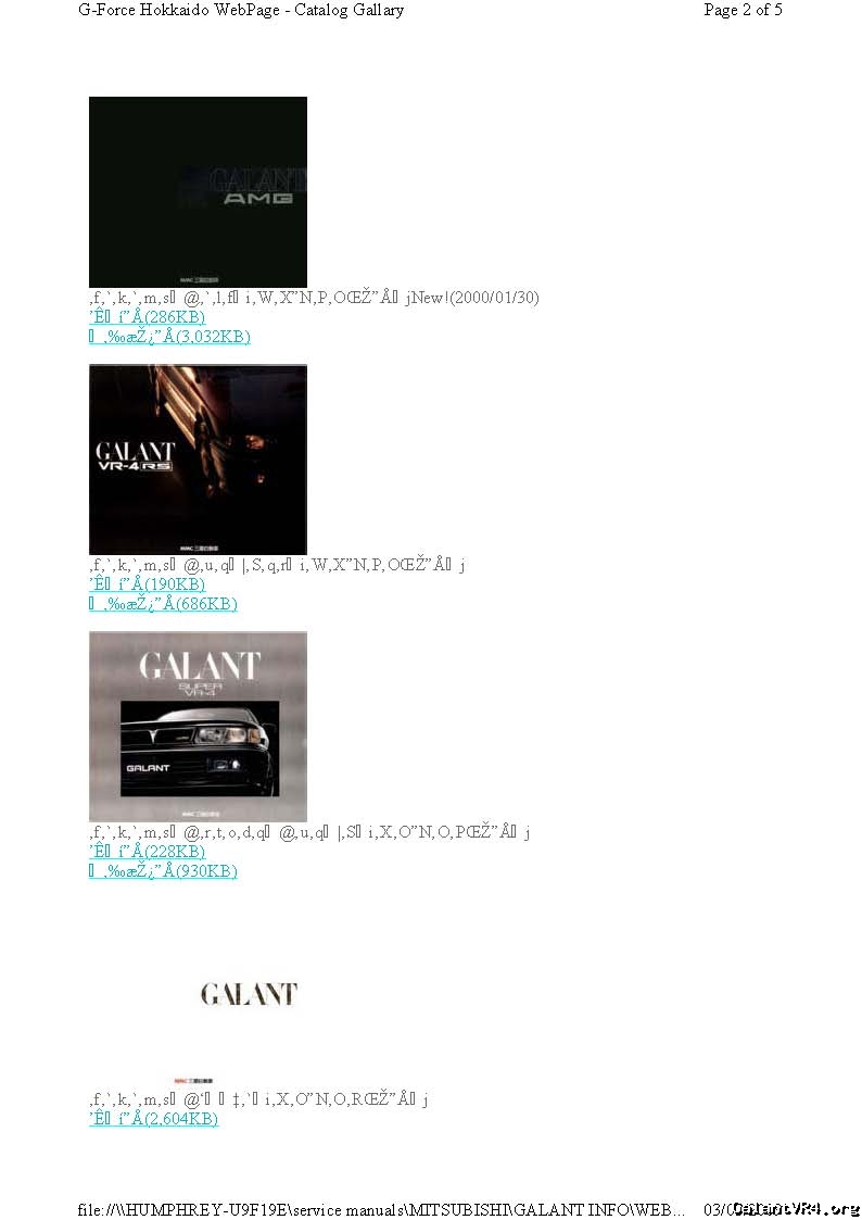

Well i think we need to clear up some stuff.
You may have had the brochure for 7 years, but it came off the archive at g force hokkaido. the brochure you have is a 1989.10 car.
here's the g-force archive page.
so credit to G-force hokkaido.

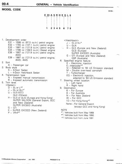

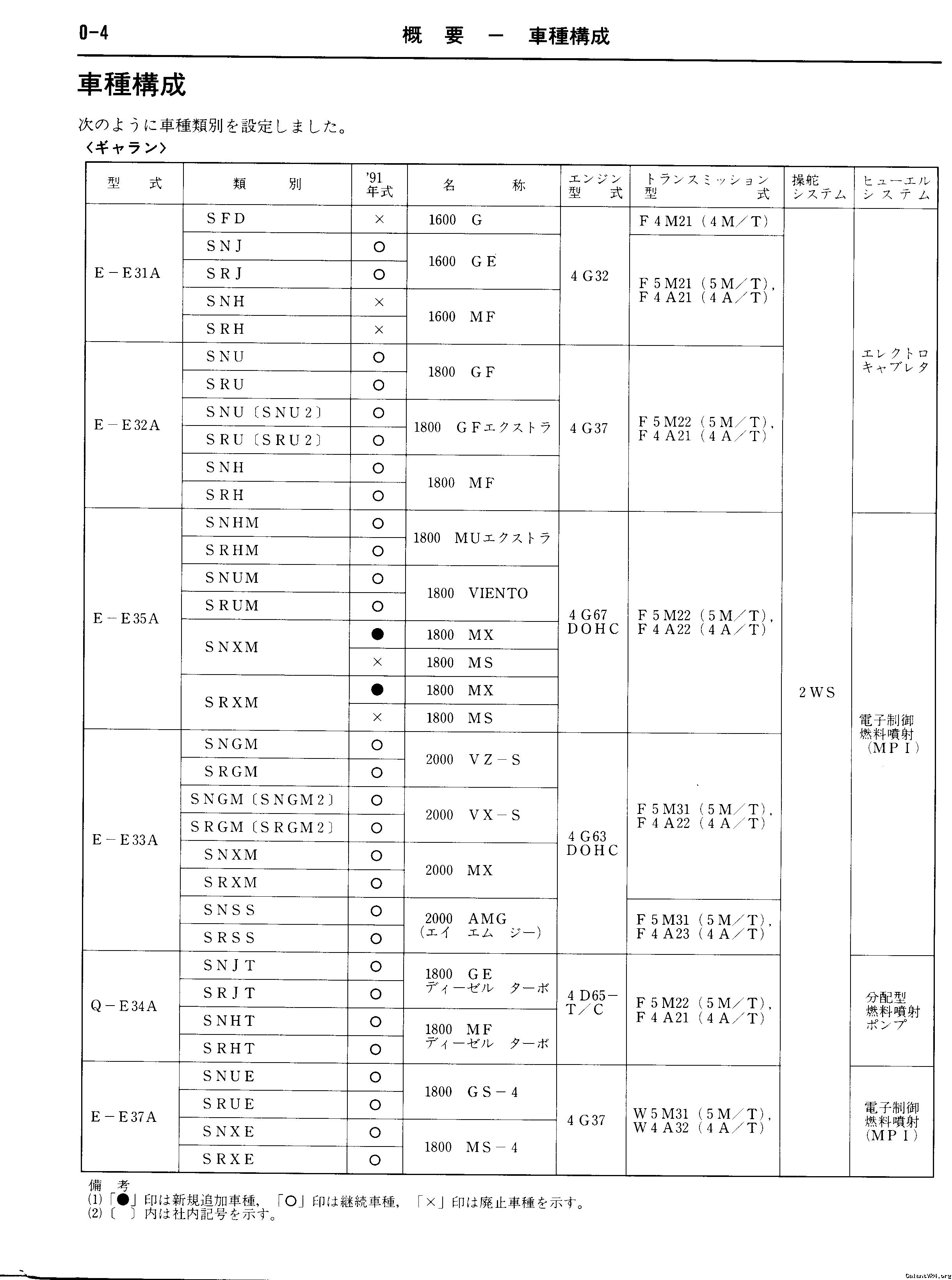

Now number 2. vr4rs = e38a?
No here's why.
Look at the names and chassis codes! vr4 rs is e38a and e39a. but you will also see that e37a is 4wd also!
Now else where in the world there were many instances of different drivtrains mated with different bodies. As the next post said E38A refers to CHASSIS, but also to engine SIZE only. Ie e38a =2000cc 4wd, e39a = 2000cc 4wd 4ws, e37a = 1755cc 4wd e35a = 1836cc 2wd.
Here to illustrate from the shop manual (not the us one, but the one that covers everywhere except jdm land)
and to help decode the model code (this really tells what a car IS)
So after all the miss information. Please only post with evidence. this discuission hurts my head it happens so many times.
